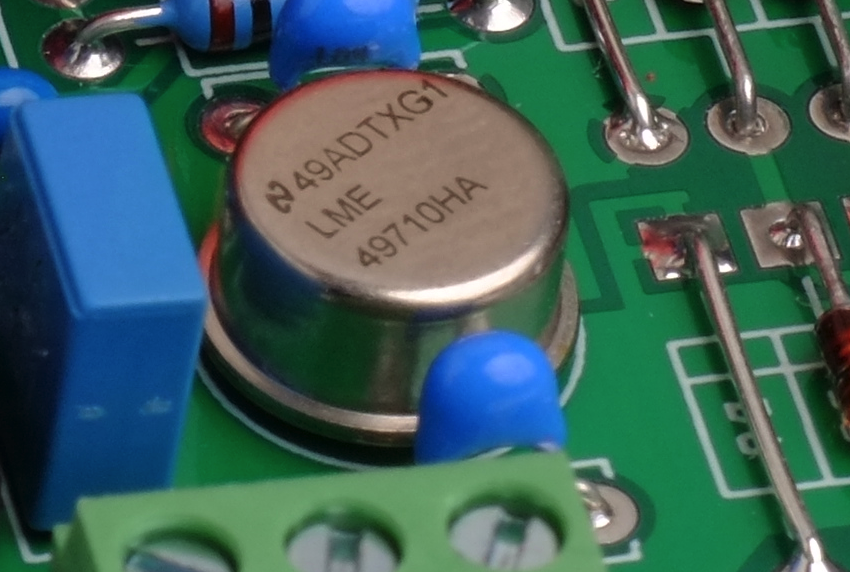

Historically -- i.e., back in the day when the TO-99 can was common, one didn't generally place the can flush with the board. Usually a little room was left. You could also buy little plastic spacers that did the job nicely. Google tells me someone is selling them on ebay.
Spacer or not, standard industry practice was to NOT mount the can flush to the board. First off, it risks solder bridging to the can. Secondly, it is nigh upon impossible to remove the can once soldered flush. If Tom's construction manual doesn't say this, it should!

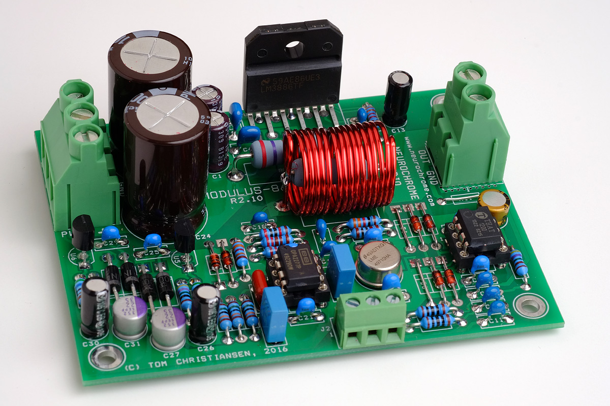

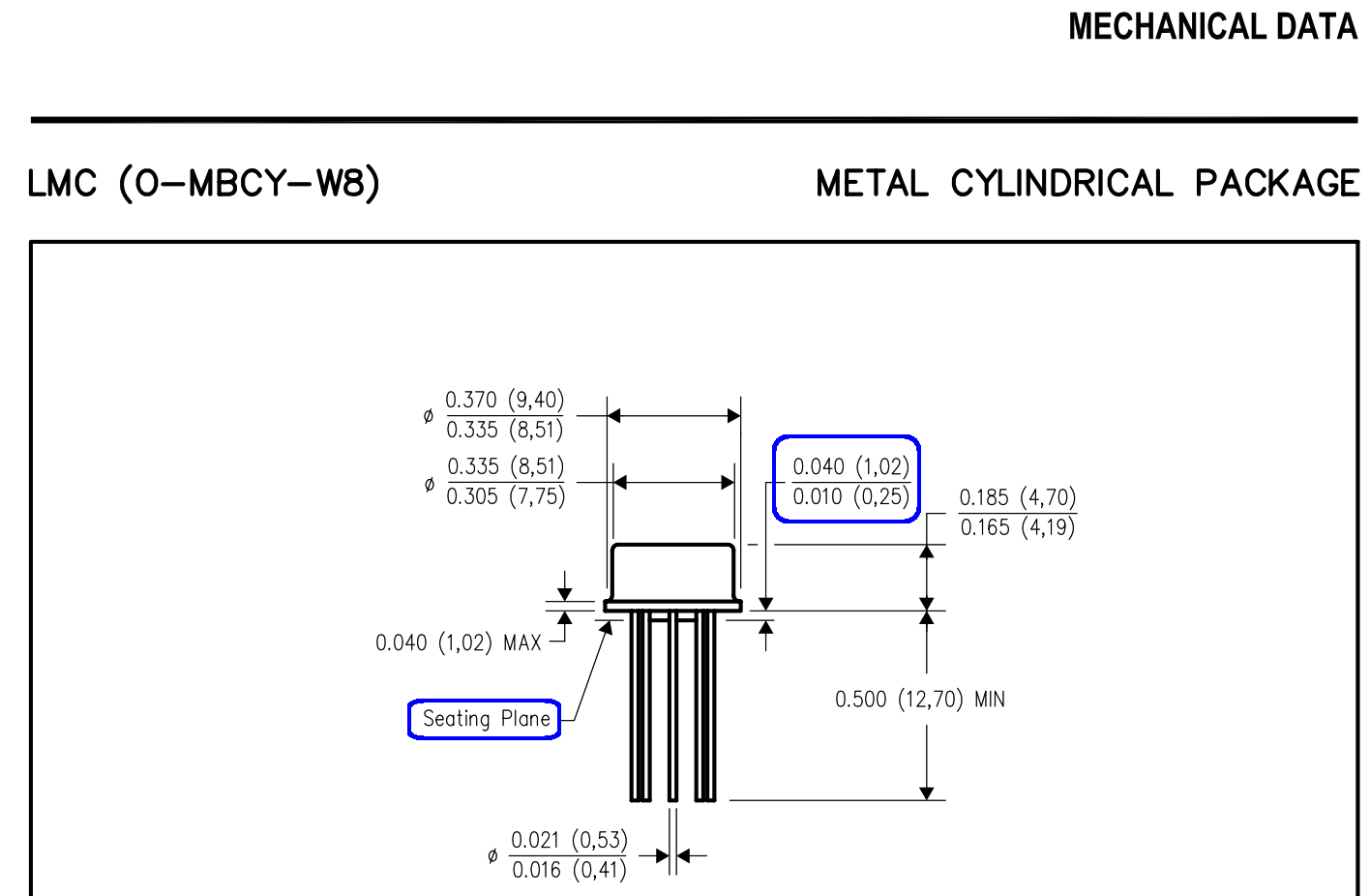

Actually, TI (or National) has thought of that already. The TO-99 from TI has a bump on the bottom to prevent the can from sitting flush with the board. It leaves about 1 mm of gap, thus eliminating the need for additional spacers.
It's a bit hard to see, but you can make it out in the picture of the completed MOD86 Rev. 2.1 board (attached). It's also mentioned on the package drawing in the data sheet. They've thought of everything... Must be a National product. ;)

I poked around a bit and found many pictures of TO-99 cans. All but one had the bump in the middle. I wonder if someone recognized the issue and fixed it once and for all.
At least I haven't had any issues with solder connecting to the can. Nor have I heard of any MOD86 builders who had that misfortune.
Of course, anything is possible if you apply enough solder. I did once bridge two pins on the THAT1200 by feeding too much solder into the joint.

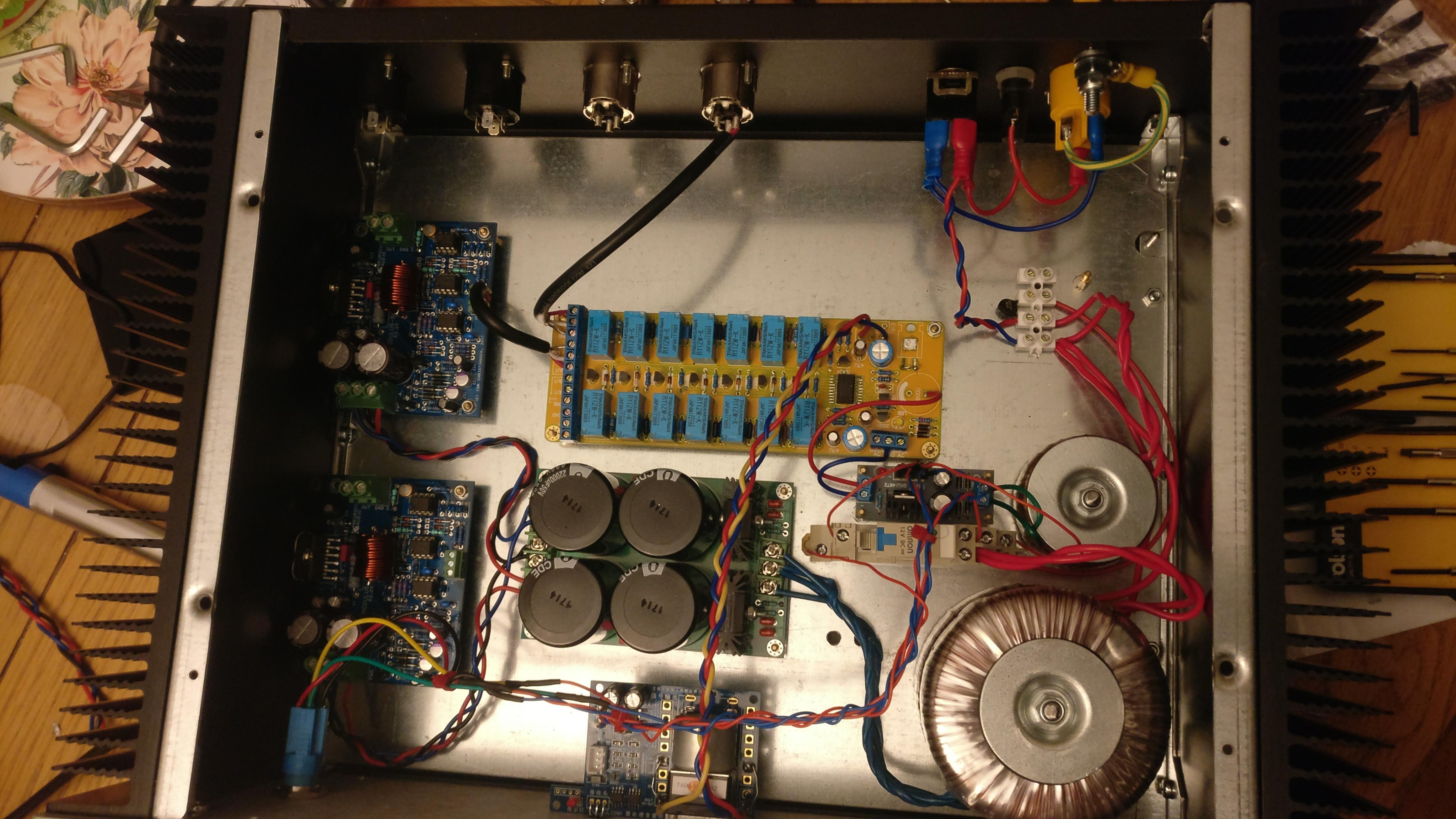

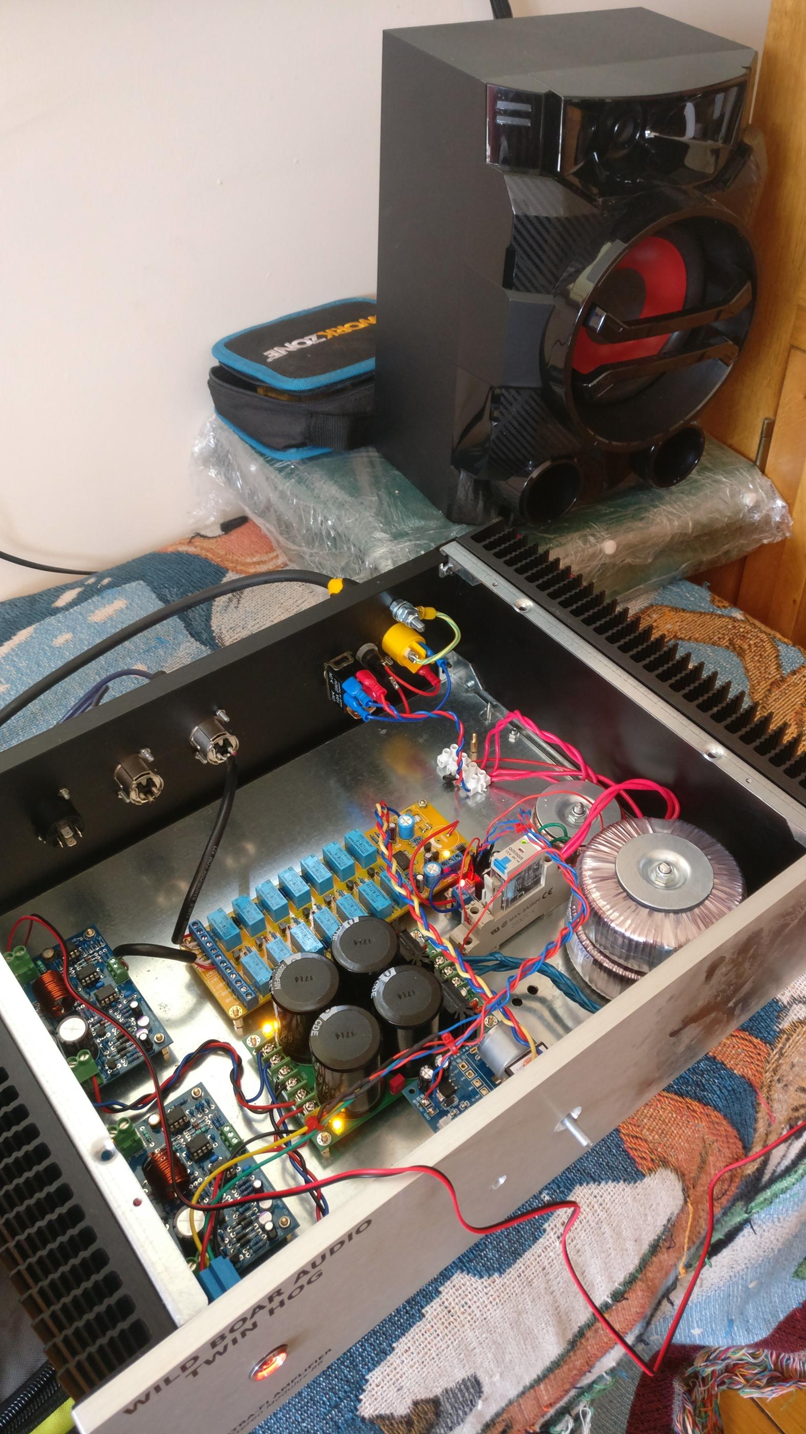

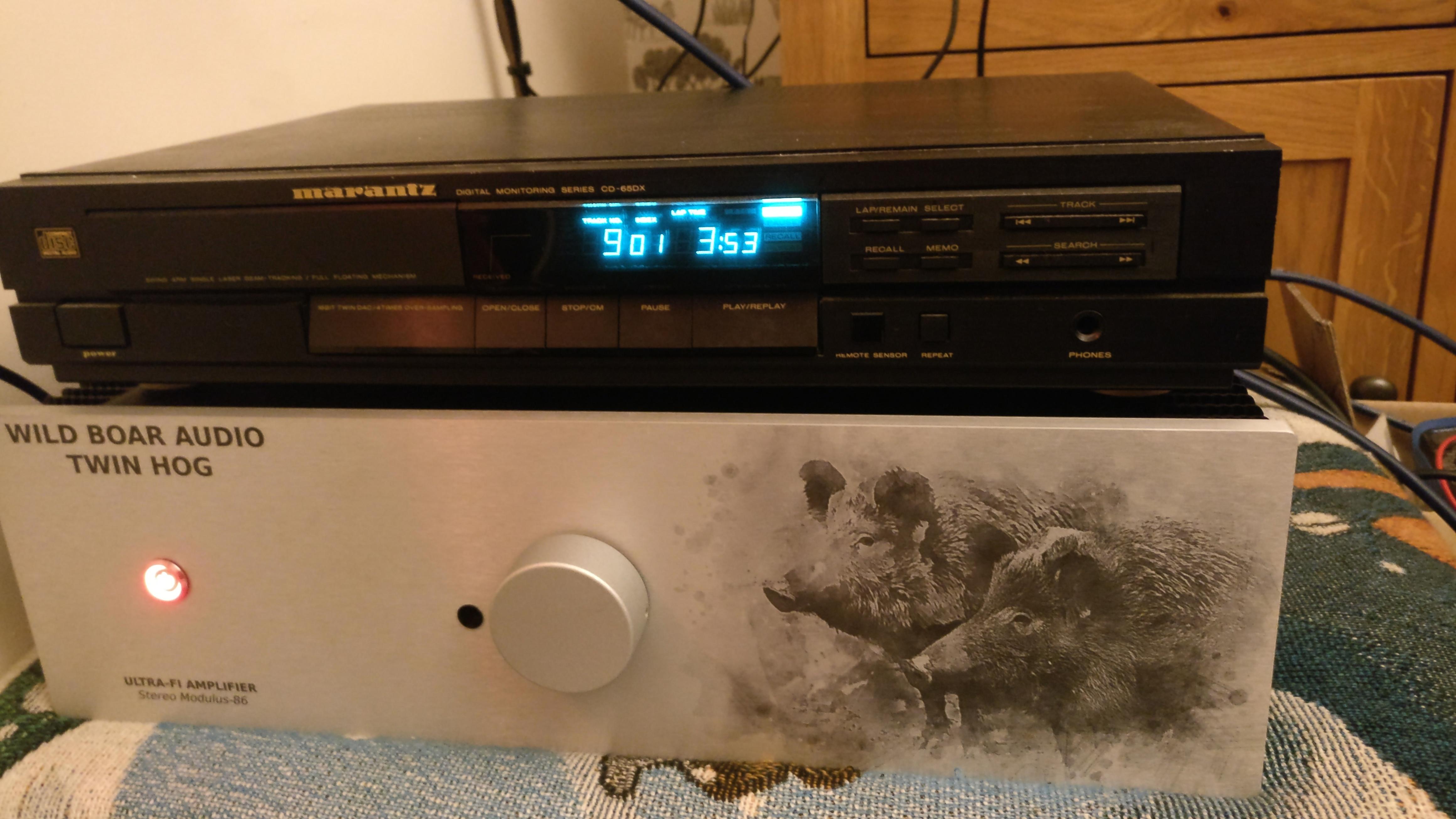

And the next step, connected the Modulus-86 units up to the power-86 one at a time and powered up with the light bulb thingy.. just like with the power-86 alone, bulb comes on and dims straight away. Could feel the LM3886's get warm very, very slowly.
So, all seems OK so far I presume.. now for the sound test...
Build photos

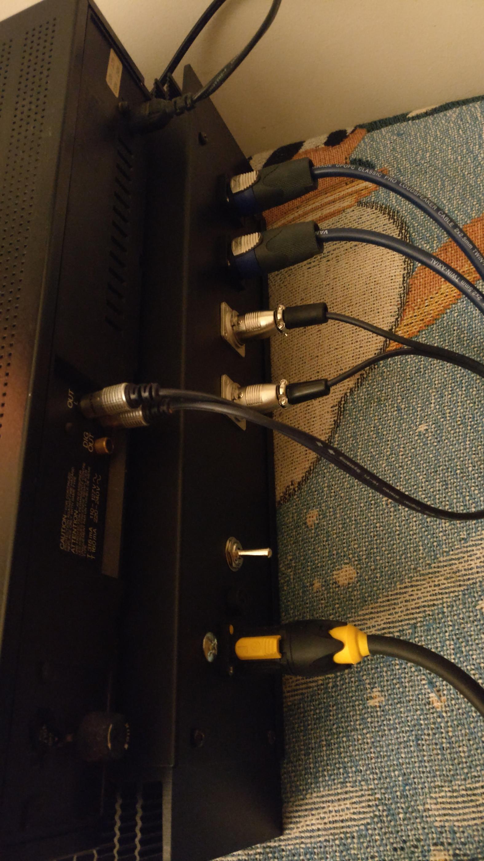

Right, I promised some photos of my build a while ago and finally here they are. I got my van Damme speaker cable today and made up my Neutrik to spade cables (when I build my next speaker project in a year or so I will use speaking on that too, and re-terminate the cables) so it's mostly complete. Only change still to be made is to replace the binary ladder relay attenuator, which doesn't provide enough attenuation at the quiet end, with one of Neutrality's logarithmic R-2R designs (see the thread elsewhere on diyAudio). I'm testing it with my Mission 750LE speakers and it sounds very, very good (listening to Led Zeppelin). Looking forward to cranking it up when the baby isn't sleeping....
I should add that the horrible plastic speaker in the third picture is the cheap sacrificial speaker for initial testing!!

:) thanks! The graphics were printed by the good folks at ModuShop. The absolute worst bit of the whole build was filing, by hand, a small square chunk of 3mm plastic IR window material into a round shape to exactly fit the hole just left of the volume knob. That was an absolute bear on my fingers! The Modulus-86s on the other hand were great to build.
