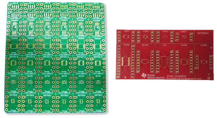

Adapters and some little bit of research 🙂 even TI stock these kind of passive parts and below are few copy of examples from their site.

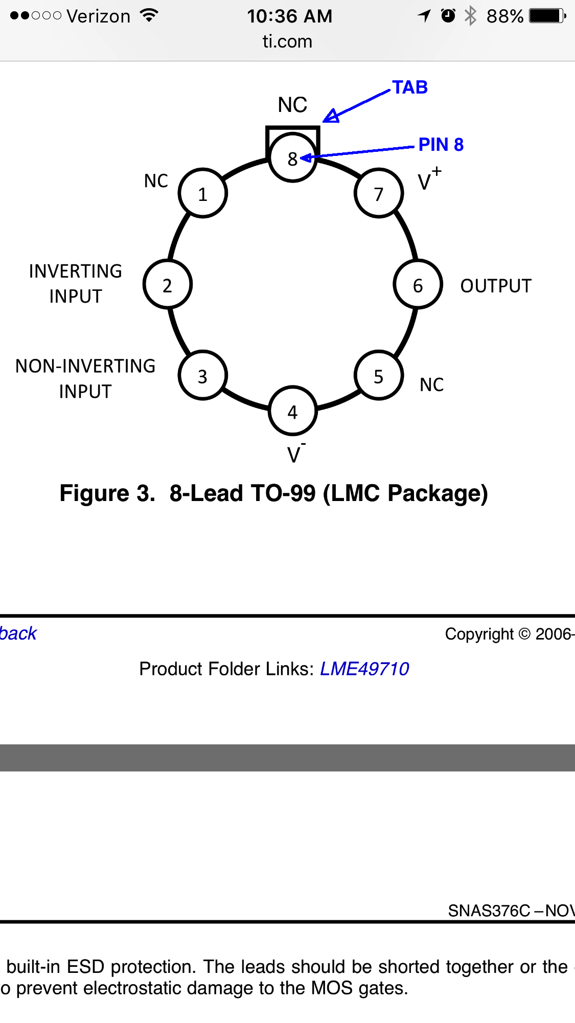

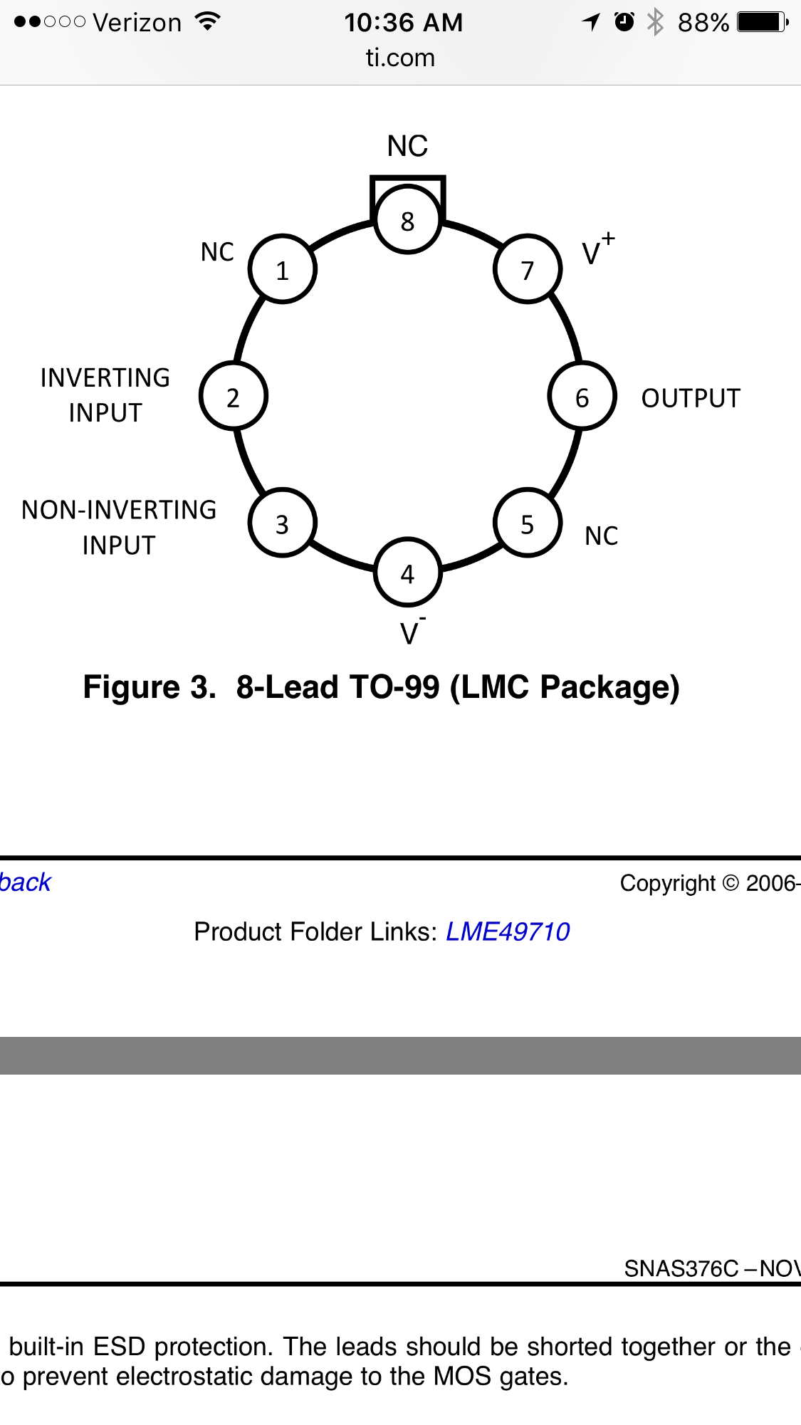

Ok, finishing up a R2.1 build with the TO-99 can.
I understand that TI deviated from normal practice by marking Pin 8 instead of Pin 1 on the Can.
Did I understand correctly that Pin 1 is marked on the board, therefore when "Looking down from the top", I should rotate the Can "Clockwise" one pin, then drop in and solder in place?

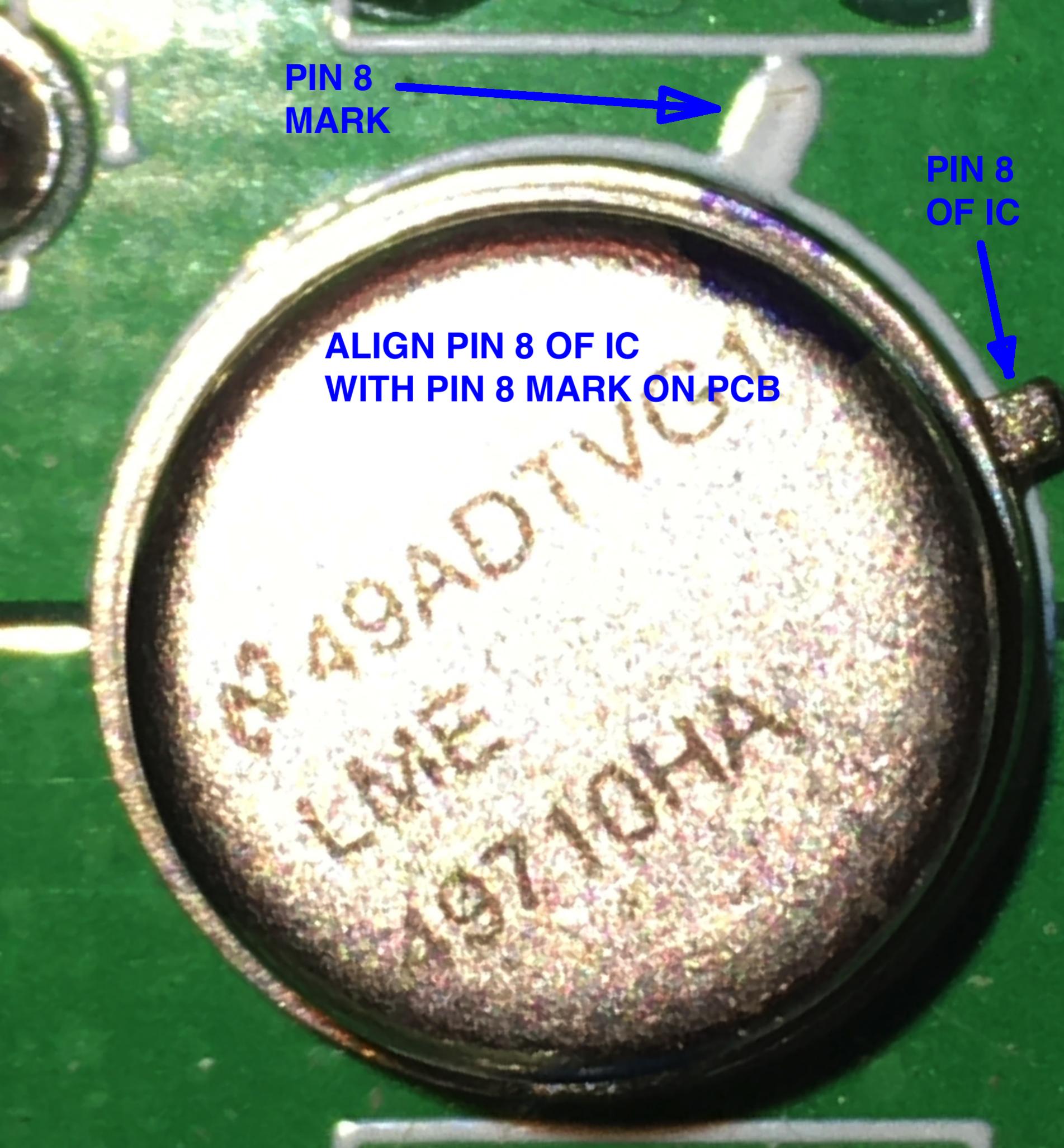

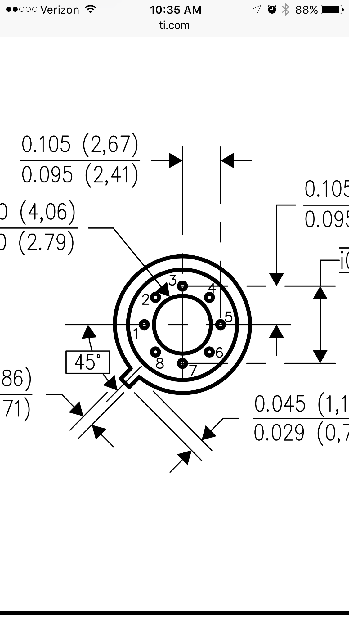

This is why we don't use the LME49710HA anymore. 😉 Normal practice on the TO-99 can is to mark PIN 8. TI follows the same convention as everybody else on the TO-99. This convention is to mark PIN 8.
I follow this convention too and have marked PIN 8 with the drawing of a tab on the silk screen outline.
Thus, the TO-99 in the image above (and attached here with text) is off by one pin. You need to rotate it 45º CCW such that the metal tab of the package aligns with the tab drawn on the silk screen outline.
Tom

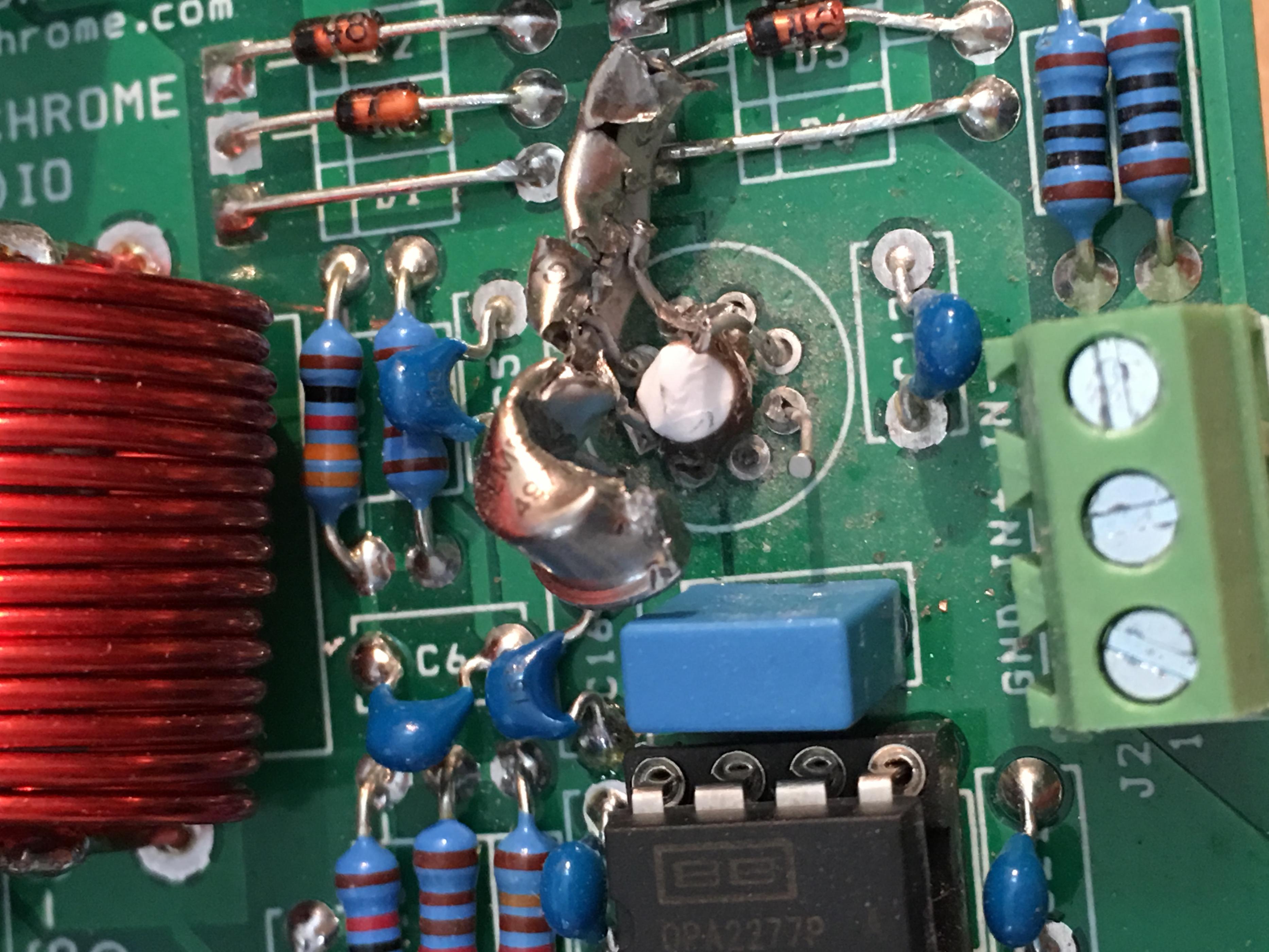

Yeah, tried heating two pins at a time, while pulling gently from the other side, working around in a circle.
The can opener worked�� Just attacked the Can with a pair of dikes, each Pin desoldered individually after that.
Sorry I was impatient.
