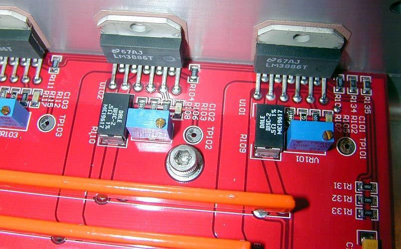

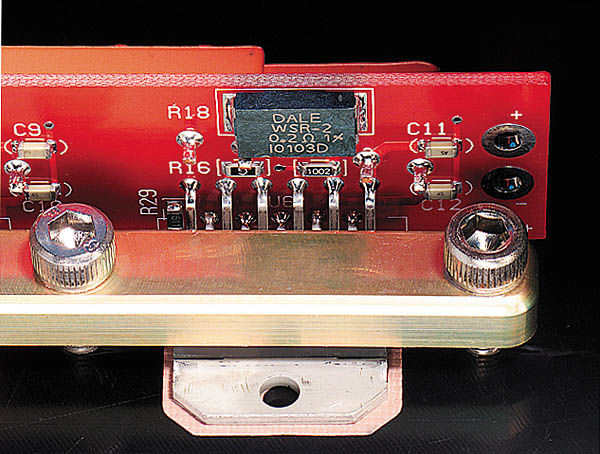

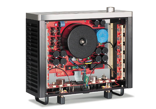

I believe the Jeff Rowlands using 3886's were the Concentra integrated (first 2 pics) and the model 10 (second 2 pics) which had a separate regulated psu... there may have been other but those are the ones I remember. Looking at the claimed specs - Concentra 100W/8ohm, 150W/4ohm and Mod 10 150W/8ohm, 275W/4ohm...

JRDG Company Special – Model 10, 12 and 112 | HFA - The Independent Source for Audio Equipment Reviews has some more information on the amps.
Would make a nice chassis for a mod amp.

My impression was also that they are bridged. Busbars are available as double conductors.

Not to deviate too much from topic, but where do you find those bus strips like Rowland used? In my previous life we used ones without the insulated coating. I've not been able to locate either at Digi-key, Mouser, etc. I may have to resort to thumbing through an old catalog looking for the correct picture as searches of the web site have been fruitless.
These guys make a product like them:
E-FAB Electronics Bus Bars Copper Busbars & PCB Stiffeners | Photo Etching, Photo Chemical Machining & Micro Milling
Rogers Corporation also make something like that (ROLINX).

Thanks, Soundchaser. It looks like they take credit cards; maybe they don't mind small DIYer purchases.
Not the exact same thing, but Protocase makes bus bars: Copper Bus Bars, built in 2-3 days
They can even powder coat them for you.
