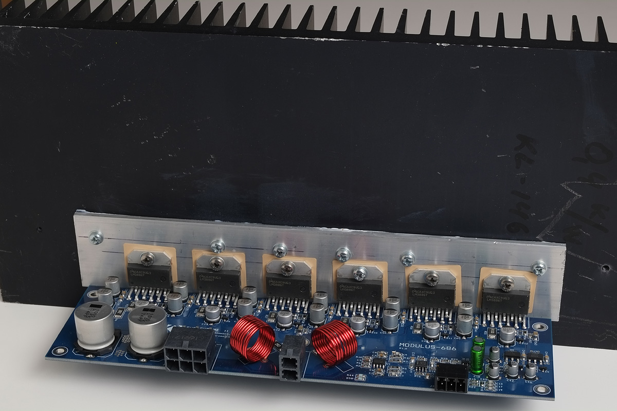

Well, a month from the 3rd anniversary of starting this I've got ready to make swarf. Progress report (well rejig report as initial fit test failed). But I have a question. Using a 200*160*40 heatsink for each pair of channels would 6 M3 bolts be enough to hold that in place? Into metal no issue, but using hurricane nuts into MDF which is first for me...

I'm a bit concerned that those nuts will rip out if one grabs the amp by the heat sink. M4 would offer more grip due to the larger circumference.
Alternatively, long machine screws could go through the heat sink and chassis wall and be fastened with lock nuts on the inside.
One could also entertain the thought of adding some adhesive between the chassis and the heat sink. Then the smaller threaded inserts could probably be used. Of course, if you even have to take the amp apart in that case, you'd be hating life. Tradeoffs, tradeoffs. 🙂
Even something like double-stick tape can be surprisingly strong. I don't know how well it handles the heat, though. With that size heat sink, the heat sink won't get terribly hot, though. Maybe 40 ºC when you really crank the tunes. Probably 50-60 ºC during continuous sine wave testing at the worst case dissipation.

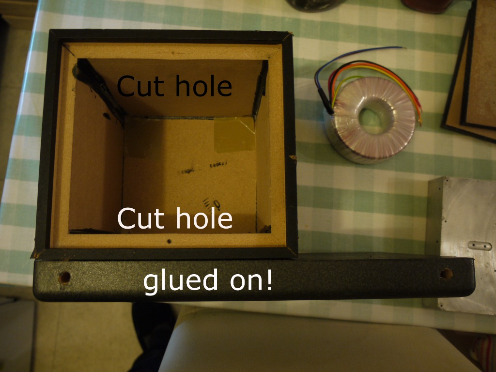

Well it's easier to pick up via the front support which is not only glued on, but glued to the vinyl wrap! Lasted 25 years. No more nails is an option. It will be on spikes as well so I will be able to get fingers under it to pick up. All options. More later...

D'oh. It was the knock ins that go smaller. Ah well, that's that one sort of sorted 🙂. A re-inspection shows I can only drill though on the flat panel so might as well go all the way through and use M4 knock ins from the back Zinc Alloy Inserts - Headed Knock-in Inserts/Type B. If that fails then glorp.
As for other challenges in the first fit test I discovered that the capacitor board is too big so I need drop back to Tom's recommended 22000uF. I was seriously considering mounting the transformer outside the box (nice flat section there) for a few minutes. Getting at the power connections to the boards will be impossible once installed which is another minor pain to fix.
This is what happens when you try and do something no one else has ever considered (and for good reason 🙂 ). Next time it's standard boxes. But this will be nicely stealth and I think one more check and I can drill the first hole 🙂.

Indeed. If you look at attached you can see the stand/plinth from the front. All you actually need is the front section and something at the back for the speaker to rest on. If plan 'A' fails then there is a modushop box that will fit and give me some more and studlier room to play with.
Ah! So the enclosure you have to work with is the plinth. Ya know... Something like the Connex SMPS300RE (or my SMPS-86) would fit nicely.

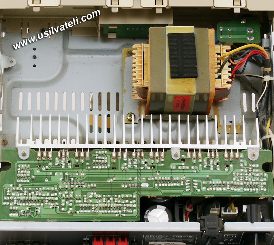

Tom: Have the transformers (12 months now 😱) but will be using SMPS on my next project for the kitchen. There I have the box already (Denon POA-F100 I bought for a surround experiment that never happened). I have more space in there esp as will be lower power.
