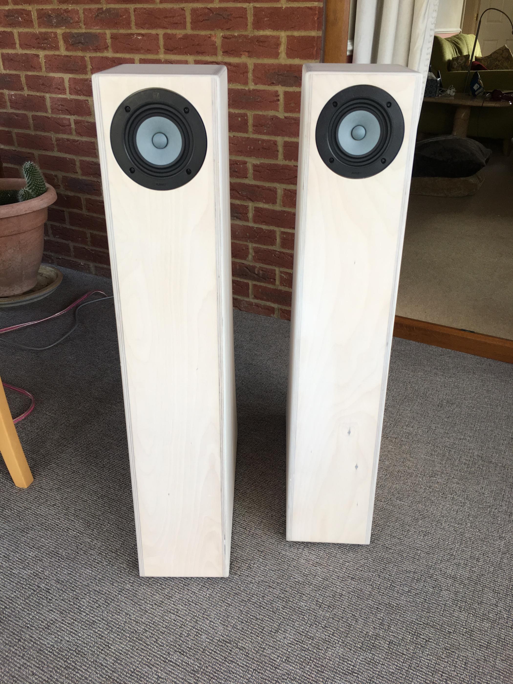

So I'm finally getting some listening in given that I have finished another project, a pair of Frugal Horn MK IIIs with MarkAudio Alpair 7P drivers.
What this has immediatley done is revealed the deficencies in the rest of the system. Namley my MP3 collection that was ripped for maxium device compatibility. So my first port of call is to re-rip the CDs to FLAC and find an improved media player over the current Squeezebox.
Gary

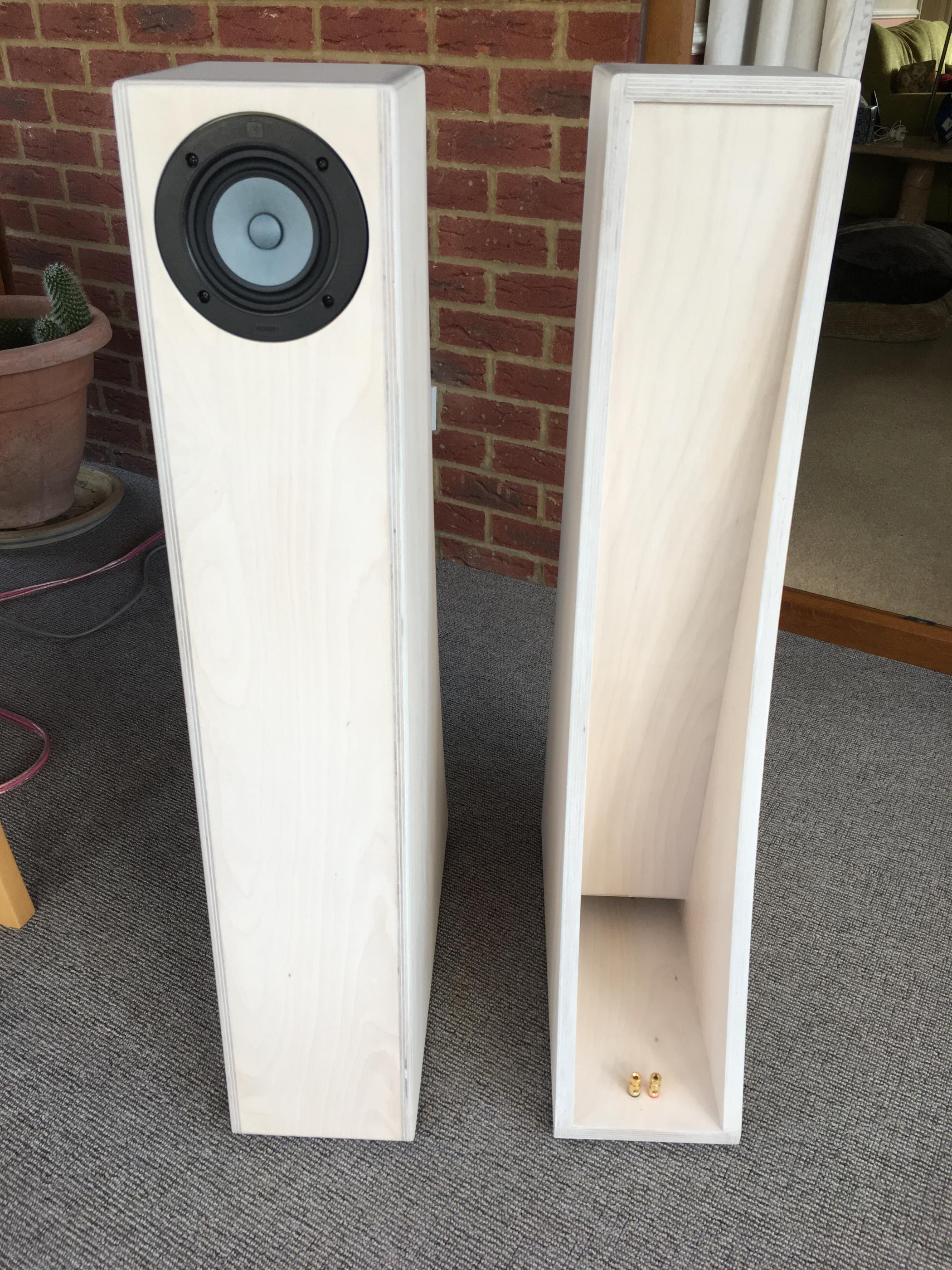

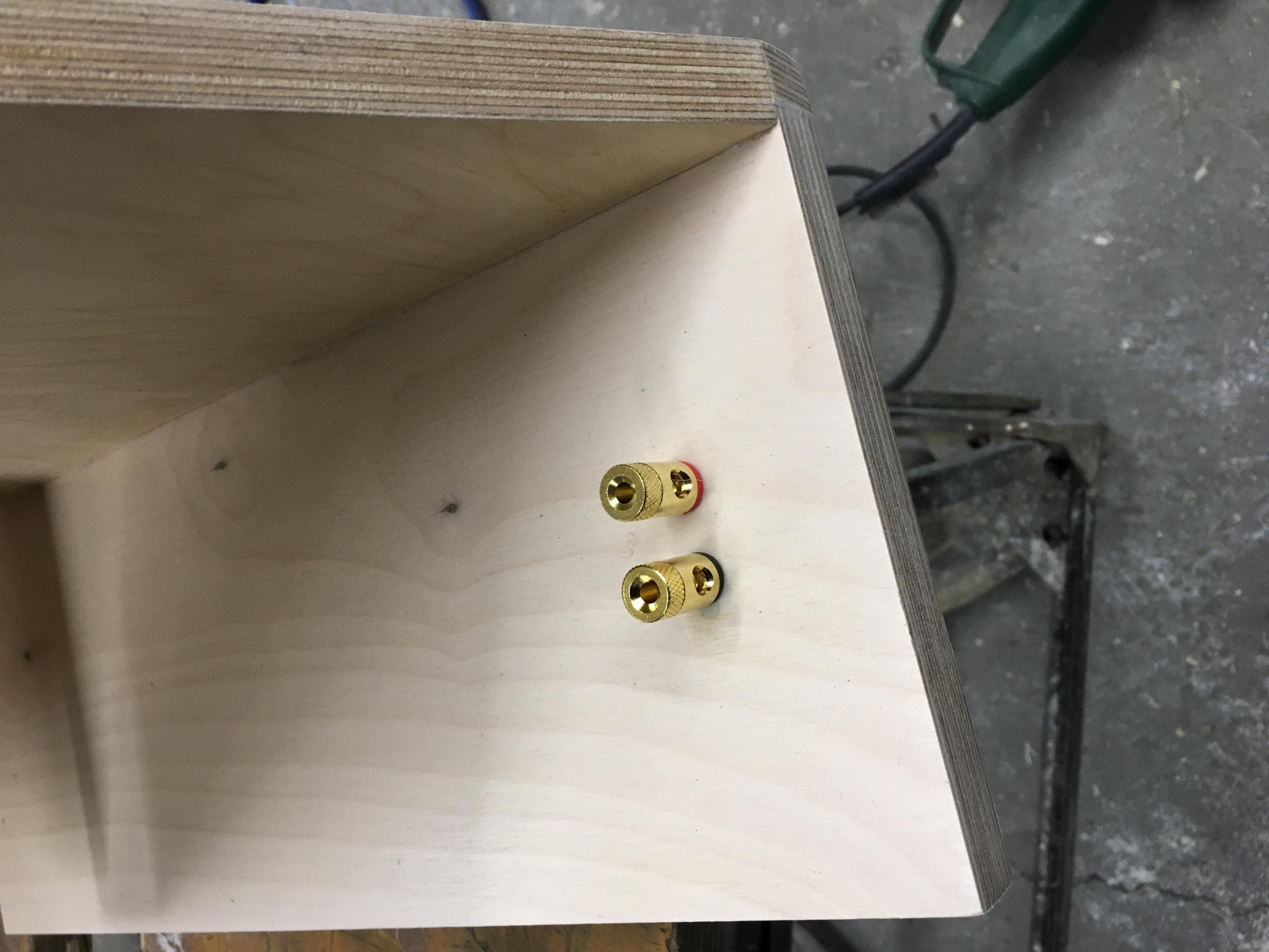

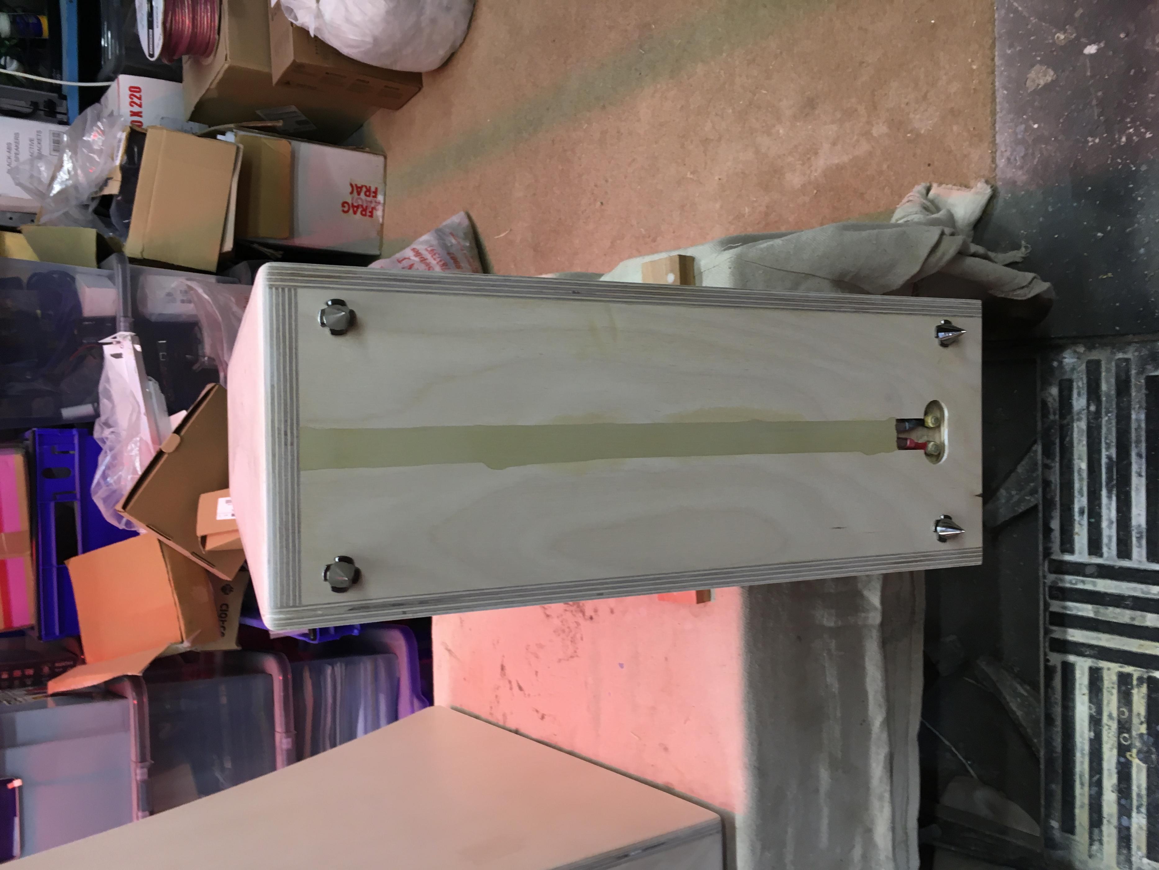

How did you route the wires from the binding posts to the speaker?
I got my router out an created a slot on the underside and then filled it.
Very neat job!
Nice to see a well-used B&D Workmate like mine too 🙂 They don't make them like that anymore.
Was the Frugel Horn a kit or did you do all the wood work from scratch?
The workmate was a family hand em down and still going strong. Was even used in the build of the amp. The Frugel MkIII horn was a precut from CustomCans, good quality 18mm Birch ply.Very neat job!
