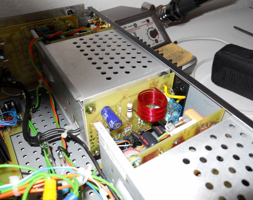

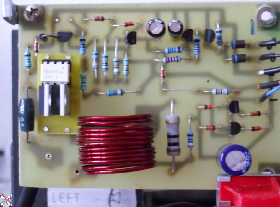

I made my solid state relays to be a direct drop in replacement.
Looks interesting, do you actually hear a difference between the two? I see power supply solid state relays around, but feel kind of doubt using solid state relays in the signal path since the signal path adds active components which may not be optimized for high current signals.
Sent from my iPhone using Tapatalk
Solid state relays for mains switching duty are invariably triac based and totally unsuited to audio signals such as speaker feeds.
The two back to back FET's that make up a relay such as the one I showed above have a low Rds, typically just 4.5mΩ per FET for the IRF2907's used. The big advantage now is that the performance will be the same 5 months, 5 years or 50 years down the line. The mechanical relay just can not compete with that.
Do I hear a difference ? Hard to say because it was initially hearing the gross distortion on a low level sine that prompted all this. All I can say is that I am happy in the knowledge that that problem (and any doubts over it affecting low level detail on music) are removed.
And how many times do we read on the forums of switches (and relays) being treated with Deoxit and similar because of very audible issues that the old contacts are causing. I would never go back to those days now.
Who's the li'l DIP-8 MOSFET driver dressed in white? Does he have a name or a part number?
