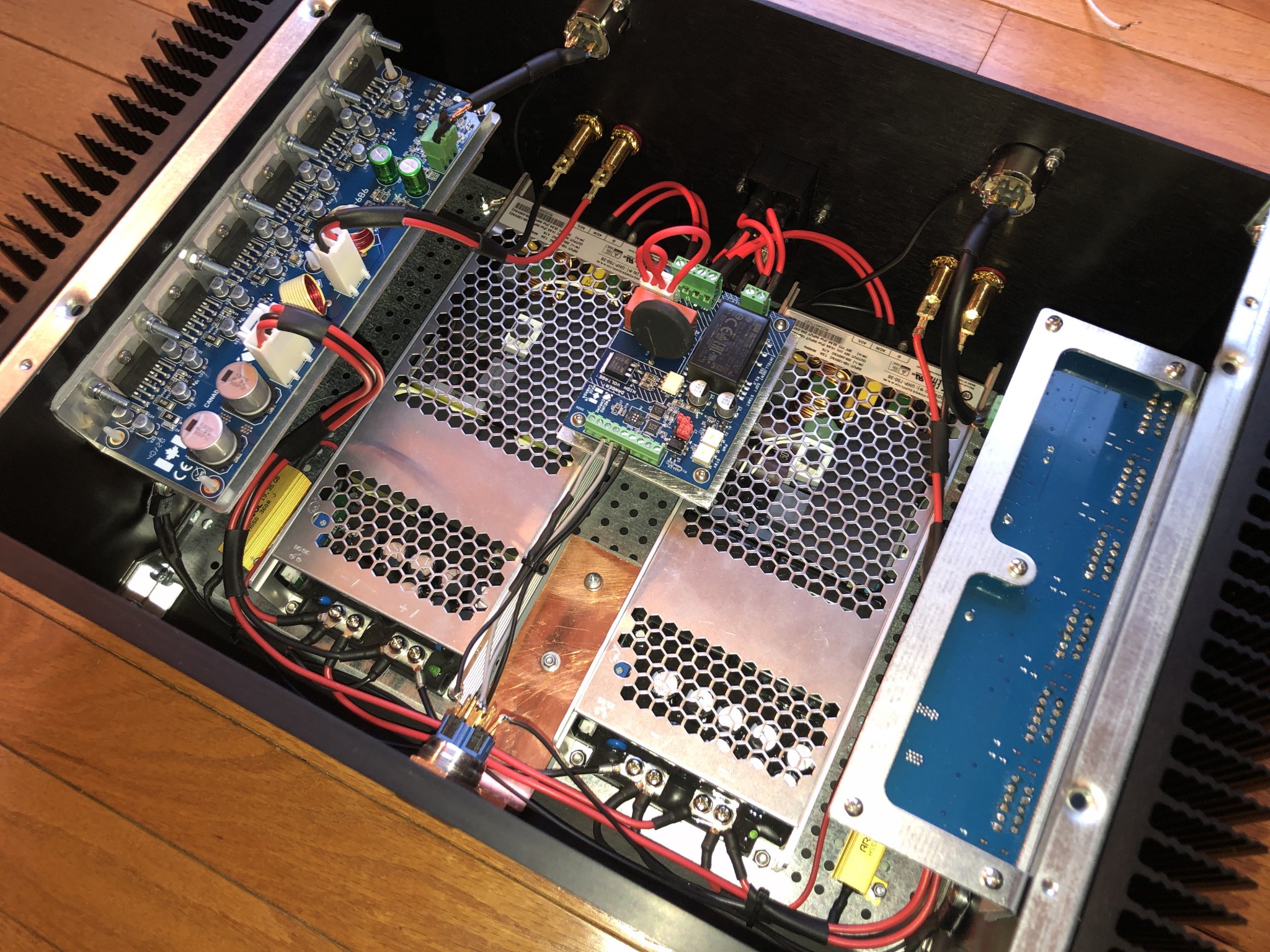

I would expect the UHP-750 to be fine. Mean Well recommends a sizeable aluminum plate (3 mm thick) in the data sheet. Granted, they also assume one power supply per plate, so I wouldn't expect your supplies to be able to deliver the full output current continuously.
Thankfully they won't have to. The crest factor of music will ensure that the supplies only have to deliver a relatively small fraction of the max output current even if the amp is driven to clipping.
Another trick that you can employ to get more mileage out of the power supplies is to run the two channels in opposite phase. Invert the phase on the input and the output of one channel. That'll balance the load on the power supplies.

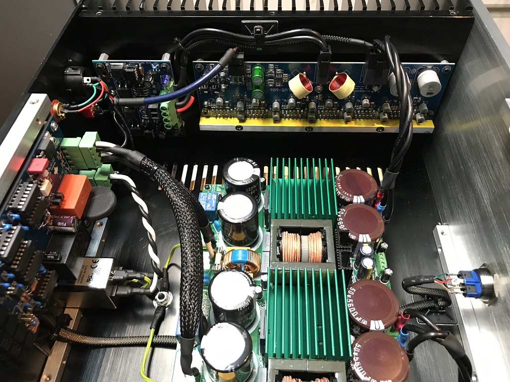

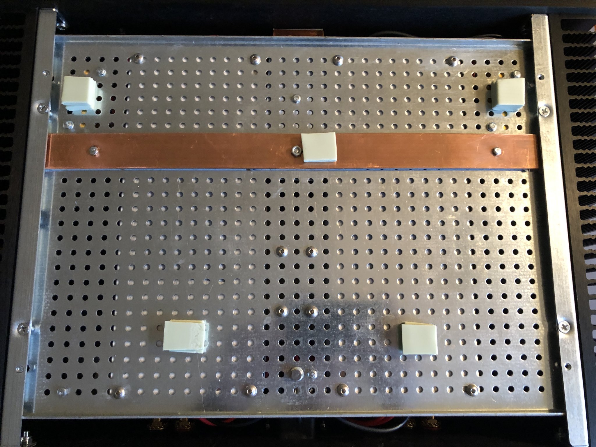

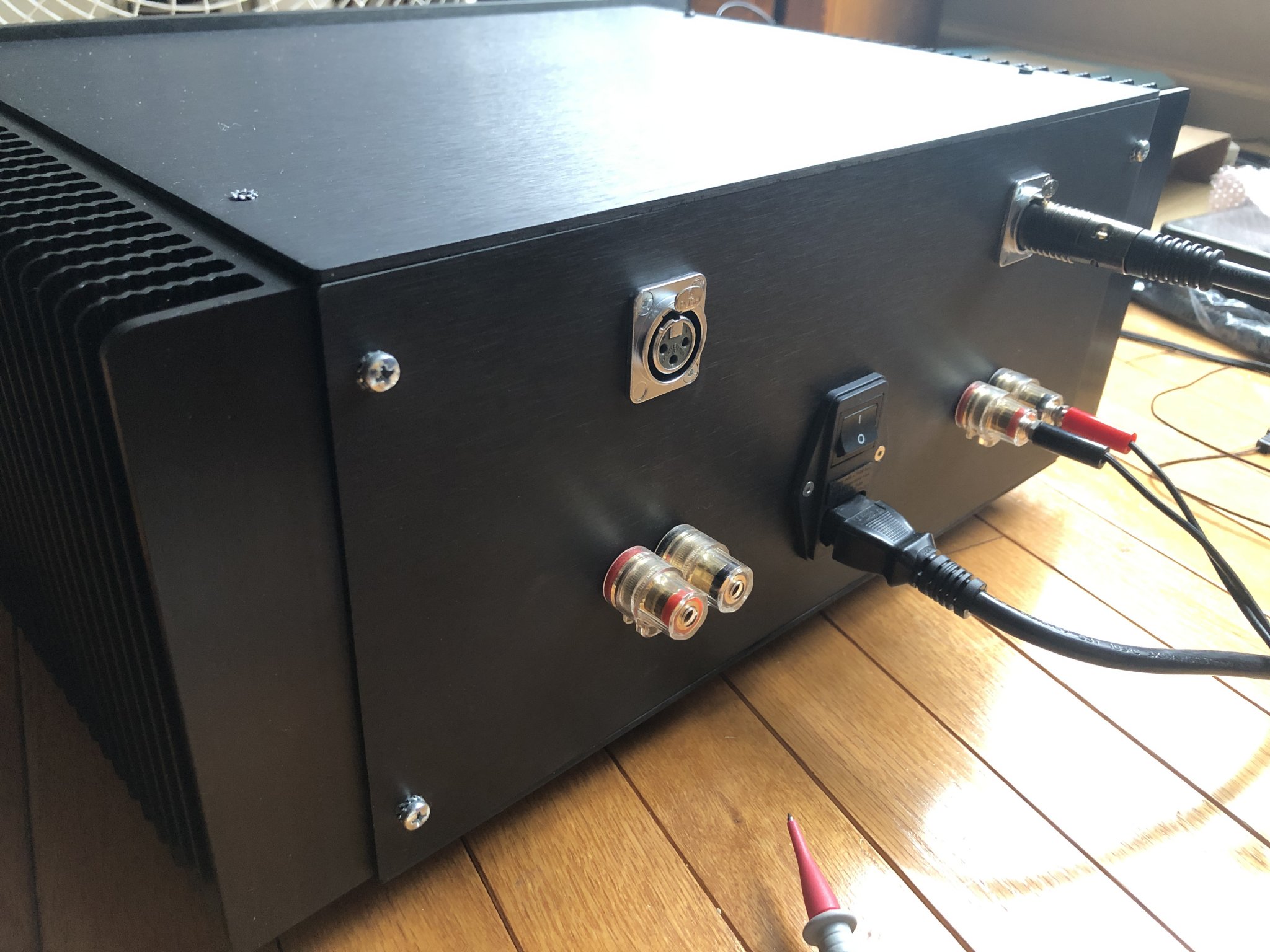

I FINALLY got around to finishing my build. Two Modulus-686 boards in a Deluxe 4U chassis with heatsinks CNC drilled/tapped to my custom spec to mount the boards and a thermal cutoff switch on both sides. The Modulus-686 boards are powered by dual Meanwell UHP-750-36 power supplies. Unfortunately, the idle current draw of both Mod-686 was JUST below the threshold required to keep the power supplies out of "frequency skipping" mode, so I had to add a couple of ballast resistors to keep the supplies awake. No big deal - it works out to only a couple of watts.
I had to do some tweaks to help dissipate the heat from the bottom plate to the outer chassis better. I added a copper bar to couple the bottom plate to the front panel, and some thermal gap filler pads on the bottom to couple it to the outer bottom cover. With these mods, the power supplies sit at around 40C after idling for an hour, and the resistors get to about 45C. Interestingly, the power supplies don't really get any hotter when the amp is under load. My guess is that they're really inefficient at idle, and much more efficient under load.
Power is controlled by an ISS module, with 65C thermal shutoff switches in series with the power switch.

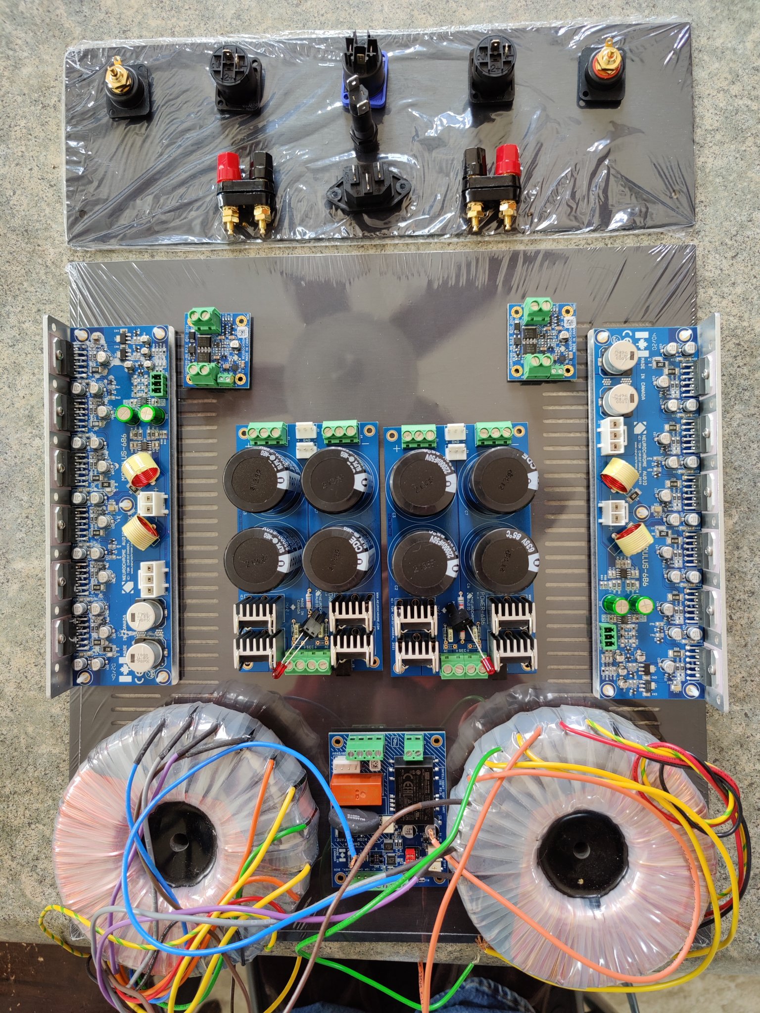

I've received the package from Tom, with everything appearing safe and sound. Here's my tentative layout:
I think this layout allows for enough space around the various connection points to make wiring a straightforward task.
The last amp I built for him had a big DPDT rocker switch to toggle between power inputs, but this time I've decided to alternate by swapping the wires internally. It's less holes to cut, and fewer connections inline. Both the powerCON and IEC plug use the same size Fast-on spades, so swapping two connectors is a simple task. The earths for both will be connected permanently to the chassis.
Any thoughts or concerns?
- As you can see, it's a dual mono, with a shared Neurochrome Intelligent Soft Start module and Power-686 boards. The input power will run straight along the bottom of the case to the ISS, with a pushbutton switch front and center to control it.
- I'm using a Modushop Dissipante 3U/400mm case, so the heatsinks should handle it. My mains often drift as high as 125VAC, so I'm using 400VA 2x22VAC AnTek transformers, just in case. The transformers are stand-ins, as I wait for the AnTek (which might be a bit smaller).
- I haven't decided yet whether to include thermal switches to shut off the amp at 65°C.
- I considered using a single Guardian-686 module, but decided that It would be easier for the layout if I had the two smaller Guardian-86 boards.
- Neutrik NC3FD-LX-B XLRs are on order, so I used RCAs to hold their spot.
- After discussing it with Tom, I'll likely forego optional RCA inputs, but that could change if I determine a "good" way to do it.

Take Tom's advice and just make a pseudo balanced cable to use with anything that has an RCA plug.After discussing it with Tom, I'll likely forego optional RCA inputs, but that could change if I determine a "good" way to do it.
Yeah, that's my current plan. I just ordered some Mogami 3173 cable and Neutrik XLR and RCA connectors to do that (as well as build some interconnects between my Benchmark DAC2 and the Modulus-686).Take Tom's advice and just make a pseudo balanced cable to use with anything that has an RCA plug.
I hadn't considered that, so I'll ponder it. Tapping holes is much more work than drilling holes, so I tend to prefer using the bottom or back plates.You could put the Guardian-86 above the Modulus-686 on the heat sink. That's what I do in my (ongoing) MOD686 build. It makes for a nice and compact module.
Tom
Yeah, but it makes wiring more of a hassle. I drill press and a tapping block makes quick work of tapping heat sinks. It is more work, I'll give you that.
Either way is good. You could possibly also squeeze it in on the rear panel.
BTW: Are you planning for both Neutrik PowerCon and IEC mains inlets? That seems like a peculiar choice. Be careful you don't end up with energized IEC power pins if you do that. Or is it a 4-pole speakON in the middle and 2-pole speakON on each side? The blue collar on one connector has be thrown off.
BTW II: If you don't need/like the LEDs on the Power-686, just solder a short piece of wire across the LED terminals on the bottom of the board. Or connect the two terminals in the plug with a short wire staple.
Tom

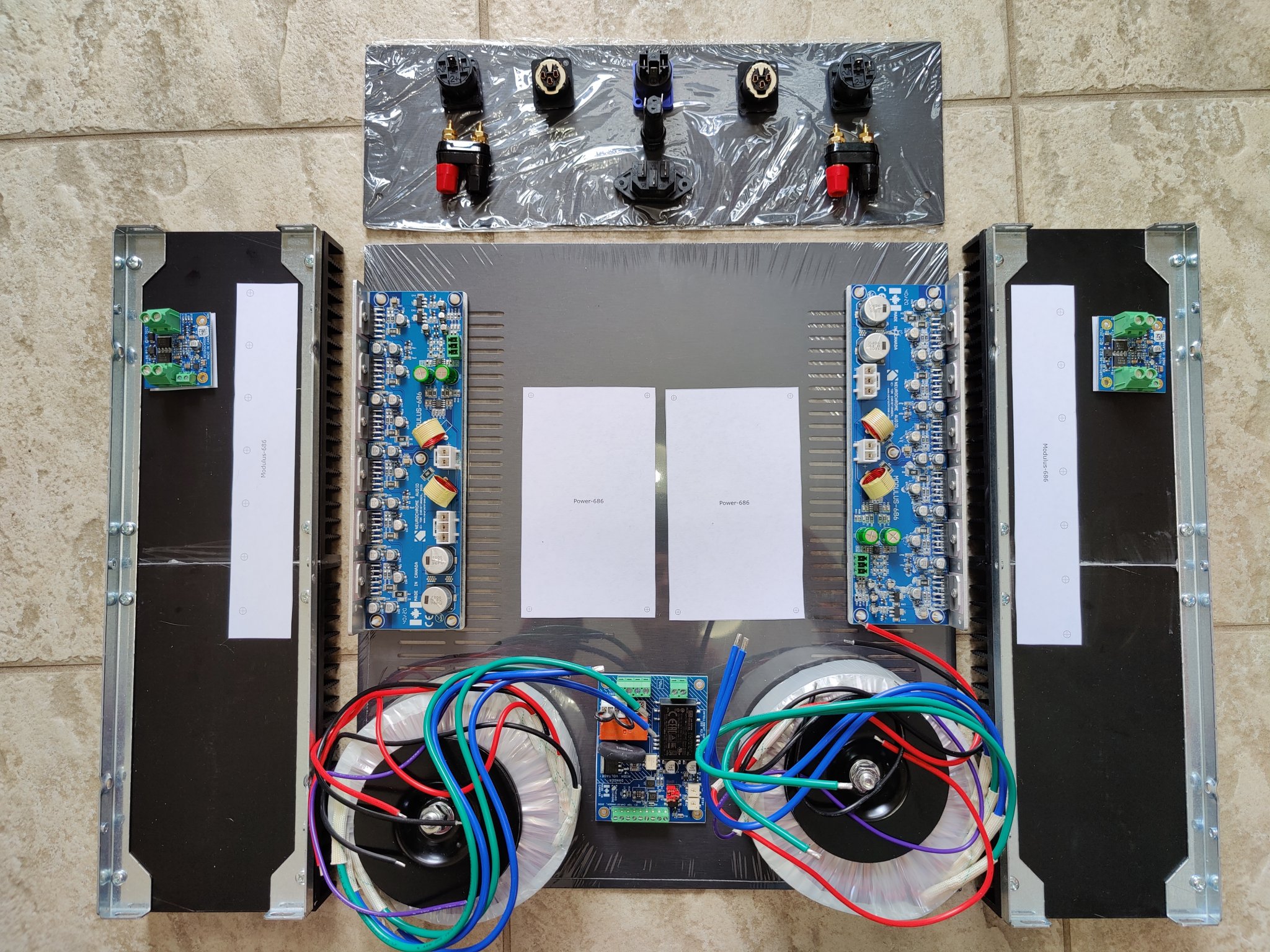

I decided to create some drilling templates to make my life easier. Tom provides one of the Modulus-686 itself, but I didn't spot any for the other components. I went ahead and wrote a little software program to create them, rather than using a drawing program. In case anyone's interested, here they are. Be sure to turn off scaling and double-sided printing.
The AnTek 400VA 22VAC transformers and XLR input connectors (Neutrik NC3FD-LX-B) arrived, and I think I've settled on the layout:
I'm going with Tom's suggestion: tapping a few more holes in the heatsinks to host the little Guardian-86 boards. (To make my tapping job easier, I decided to get a tap guide.) This location enables the speaker outputs in the middle of the Modulus-686 boards to run straight over to the sides, then into the speaker protectors. From there I can run two pairs of wires to the two speaker output connectors (Neutrik NL2MP speakONs and Keystone 4109 binding posts), which I've shifted to the outside of the back panel.
Given the distance between the two channels' speaker outputs, plus this being a dual-mono amp, I'm breaking my tradition of keeping the black binding posts toward the center of the amp. Instead, I'm configuring them as they seem to appear on all of my speakers, with the red post on the left. This also maintains orientation with the speakON connectors above them, so there's less chance of me accidentally swapping polarity.
The XLR signal inputs have shifted toward the center, for a fairly straight run back to the inputs on the amp boards. I'll be using Mogami 3173 cable, which I'm also using to build a set of interconnects to go between my Benchmark DAC2 and the new amp. I just received some Neutrik connectors for those (NC3MXX-B and NC3FXX-B). I'll also build a set of "psuedo-balanced" RCA-to-XLR cables, using Neutrik Profi phono plugs.
The only bit of assembly I've done so far is jumpering the Intelligent Soft Start for 120VAC and my toggling power switch with built-in LED. I'll try to squeeze some time in to continue before the weekend, but it may have to wait for that.
