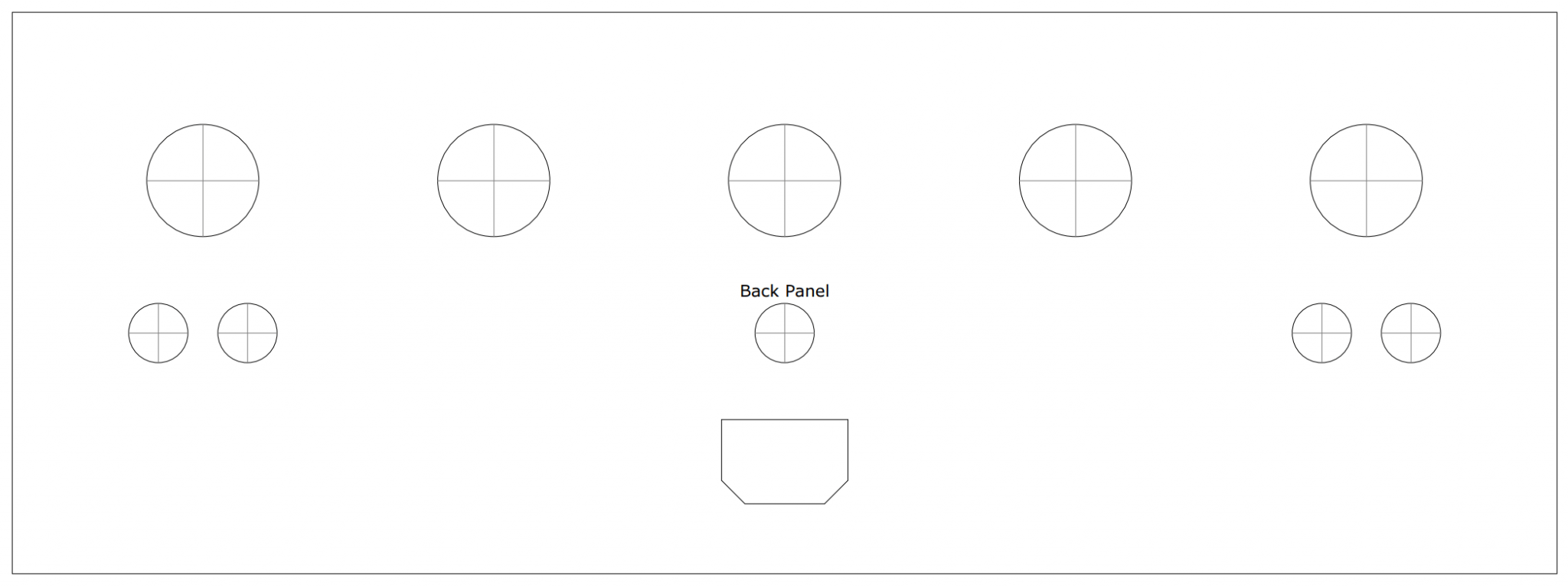

I've just created the drilling template for the back panel. It's a bit narrower than the actual panel, which is fine for me to tape it on. I'll use a punch to mark the centers of each hole and six "corners" of the IEC C13 socket.
- I've got a 24mm knockout punch that works really well for the various Neutrik connectors along the top.
- I'll use a half-inch bit to drill the holes for the Keystone binding posts and fuse holder in the middle row.
- I'm going to try the IEC socket using a Dremel with a cutting disc. In the past I drilled starter holes, followed by a jigsaw, but I was never happy with the result. We'll see if the Dremel works better. I've also heard a coping saw can do the trick.
Most IEC inlets - including the Bulgin PF0001/xx that I like - can drop into a rectangular cutout as long as the corner radius is reasonable (check the data sheet for the inlet). They usually leave a fair amount of overlap from the edge of the cutout to the edge of the connector, which allows you to hide imperfections as long as you mount the connector from the outside of the panel. It's really only if you mount the connector from the inside that the cutout has to be perfect ... or if you're a perfectionist. 🙂
Drilling 0.5" holes in sheet aluminum can be tricky. Carbide tipped hole saws are quite affordable at Bezos' Bookstore. I have one for drilling 24 mm holes and it works great! A stepped drill bit can be another option.

Hi Mike, I'd be particularly interested in how you make out with that Dremel, so I'm wishing you the best of luck and hoping to see your report.
I ended up using a Diamond Wire Saw, and it worked quite well. Just a bit of filing after resulted in a fairly clean and snug fit.Hi Mike, I'd be particularly interested in how you make out with that Dremel, so I'm wishing you the best of luck and hoping to see your report.
Thanks, I’ll check that out. 🙂I ended up using a Diamond Wire Saw, and it worked quite well. Just a bit of filing after resulted in a fairly clean and snug fit.
Depending on the panel thickness a regular coping saw can work too. Use the finest toothed blade that you can find. I bet the diamond wire is even better, though.
I generally drill a bunch of small holes just inside of the cutout. Then I punch out the centre and file to the edge that I want. It's annoying work but I can usually make a hole for an IEC inlet in maybe 15-20 minutes. One drawback is that the drill bit tends to wander a bit unless you centre punch, which I don't as I'll be filing anyway. That can make it a bit difficult to get the centre out of the cutout. I've often wondered if a centre drill would be better.

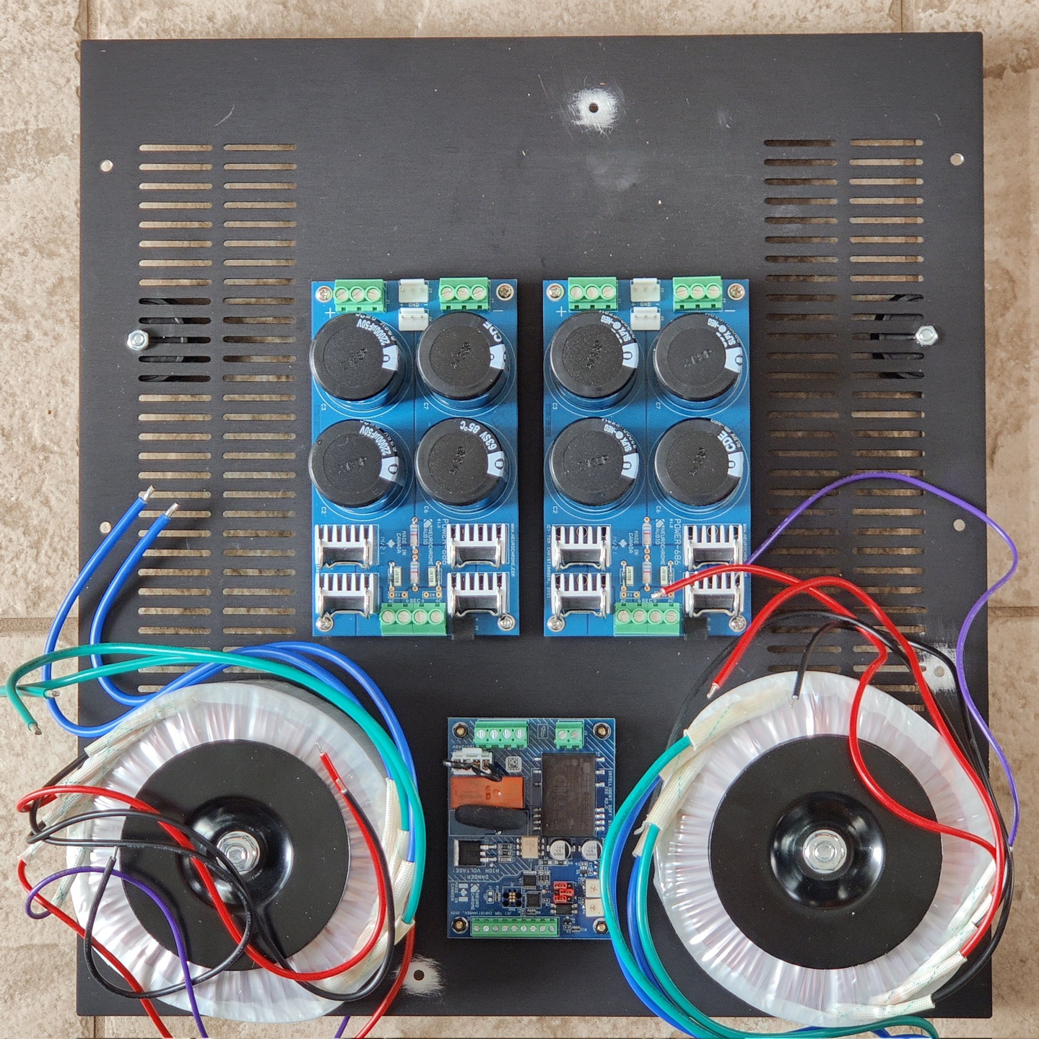

I've proceeded on with the base plate, drilling all the holes for the Intelligent Soft Start, two Power-686, and two transformers, plus three chassis grounding holes (with sanding), and four holes for the feet. I've just finished putting all that together:
I just noticed that the left transformer needs to be rotated 90°CCW. From what I understand, toroids are good at minimizing EMI, but they have a bit of "turbulence" at the wire exit points. Therefore, I'm trying to aim those two points away from the Modulus-686 units, which will be sitting quite close to the transformers.
Additionally, the preferred position for the transformers has them mounted to the "grill" area of the Dissipante, and I'm concerned about the strength of those little slats. I had an old 1mm steel plate from an earlier Modushop Pesante build, so I hacked a couple of chunks off to use as large washers to spread the force over a wider area. That should improve vertical strength, but the horizontal strength still depends on two little grill slats, which were lessened further to make way for the bolt hole. Consequently, I'll probably use some epoxy to affix the "washer plate" to the bottom, and I might even fill the grill gaps to solidify it further. That should help with horizontal stresses.
Finally, the front feet are near the corners (hidden behind the transformers), but the rear feet are a fair distance from the back. Here's my thinking:

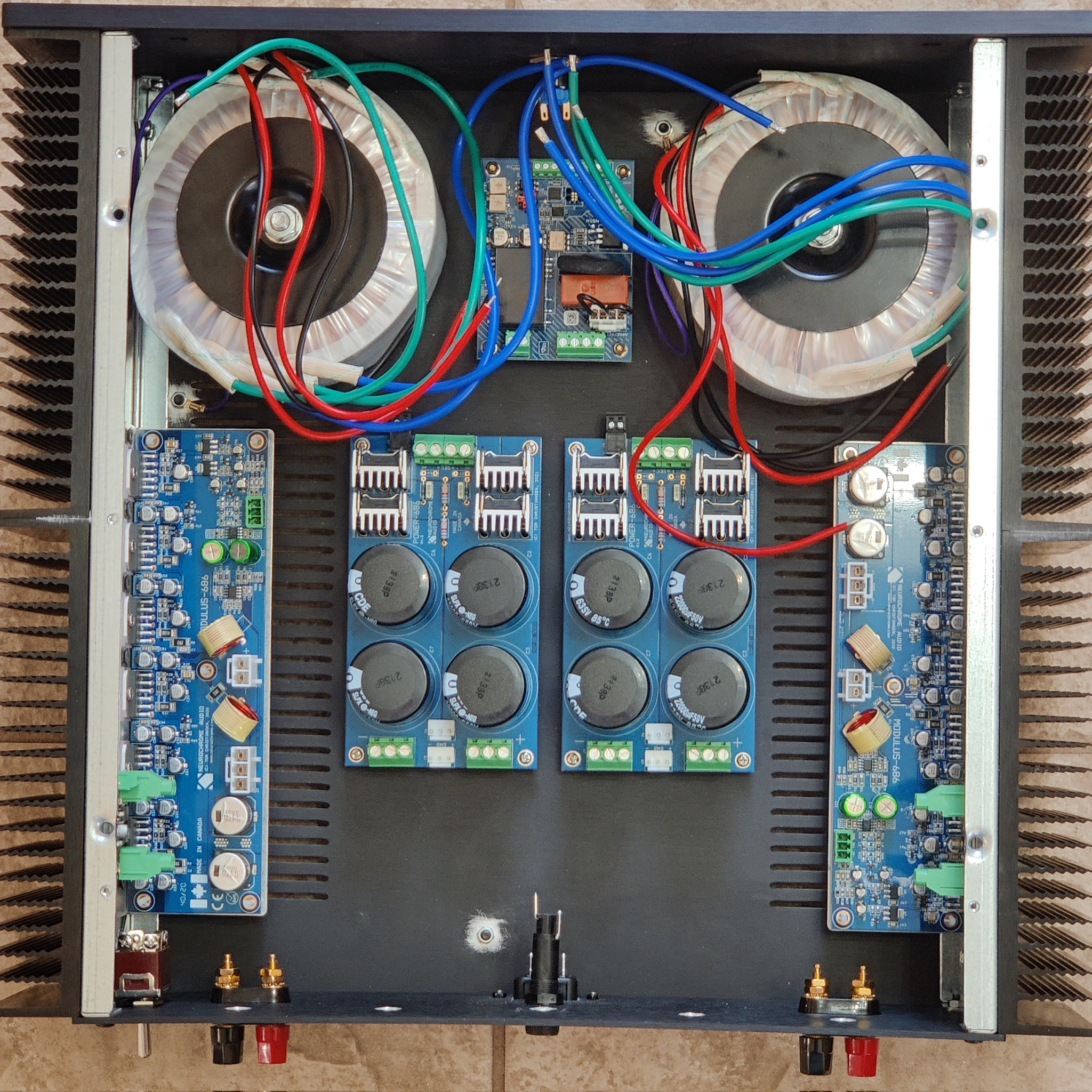

All the modules are mounted, including the four in the side heatsinks, and the Dissipante case is mostly assembled:
- The little Guardian-86 mono speaker protectors sited above the Modulus-686 boards are on M3 standoffs. I had intended to tap those into the heatsink, but I accidentally used the drill bit for the M4 taps. Fortunately, I could easily recover by fixing the standoffs in those holes with a bit of epoxy.
- The Modulus-686boards come mounted on heat spreaders that accommodate seven M4 screws.
- I had hoped to bottom tap those, but I didn't have the necessary taps to make it work, so I ended up drilling through and threading the entire hole.
- I managed to break one of my taps, rendering one hole useless. Fortunately holes are closely spaced, so skipping one wasn't a big deal.
- I discovered that in spite of what I've read, WD-40 doesn't work half as well as Tap Magic (for both tapping and drilling).
- For thermal paste, I decided to use some new stuff from Tech Ingredients.
- I've added a toggle switch to the back panel. It's double-throw, like the LED pushbutton switch in the front panel. I'm connecting them in a 3-way configuration along with the switching circuit in the Intelligent Soft Start, so that the amp can be turned on from the front or the back. If this unit ends up at my friend's place, he has his amp tucked behind his TV, and reaching the front switch is a hassle.
- None of the Neutrik connectors are mounted yet, as I stripped the threads on my 24mm knockout punch, and the replacement hasn't arrived. Fortunately all those connections can wait until the end of the wiring job. I can proceed with wiring and testing the power supply, switches, and switch LED in the meantime.

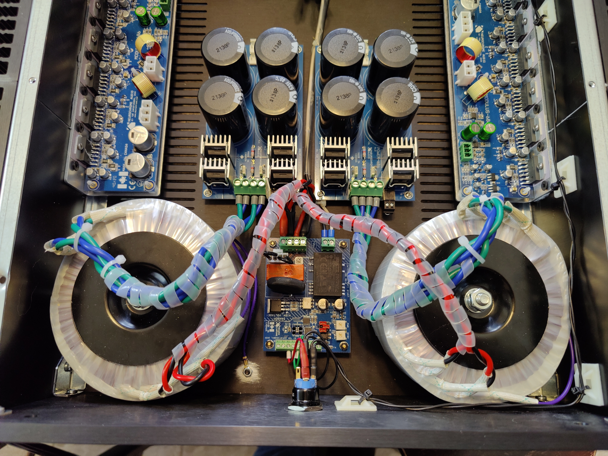

I had a bit of spare time, so I’ve hooked up the two transformers between the ISS and their Power-686 modules. With my mains at 124VAC, I’m getting ±32.5VDC from the 2x22VAC secondaries of the AnTek AS-4222. I choose the lower 22VAC, because I was concerned about my high mains, but I’ve never seen them hit 125VAC. Given the Modulus-686 can take ±36VDC, I could have probably gone for a transformer with 2x24VAC secondaries. I don’t expect to drive this amp to its max output, though, so ±32.5 should be sufficient.
This evening I'll wire the power supplies to the Modulus-686 boards, and then the amp outputs into the Guardian-86 Speaker Protectors. After that I'll switch over to building the quasi-balanced interconnects, while I wait for the replacement knockout punch for the Neutrik connector holes.
- I twisted all of the transformer wire pairs, then did minimal trimming to get the paired wires even.
- I used ferules to keep the strands together. I had to remove the ferules' plastic shoulders for the doubled primary wires, because the bulky insulation from two wires wouldn't fit. I added heat shrink to those.
- I used spiral wrap to keep pairs of pairs neat and tidy.
