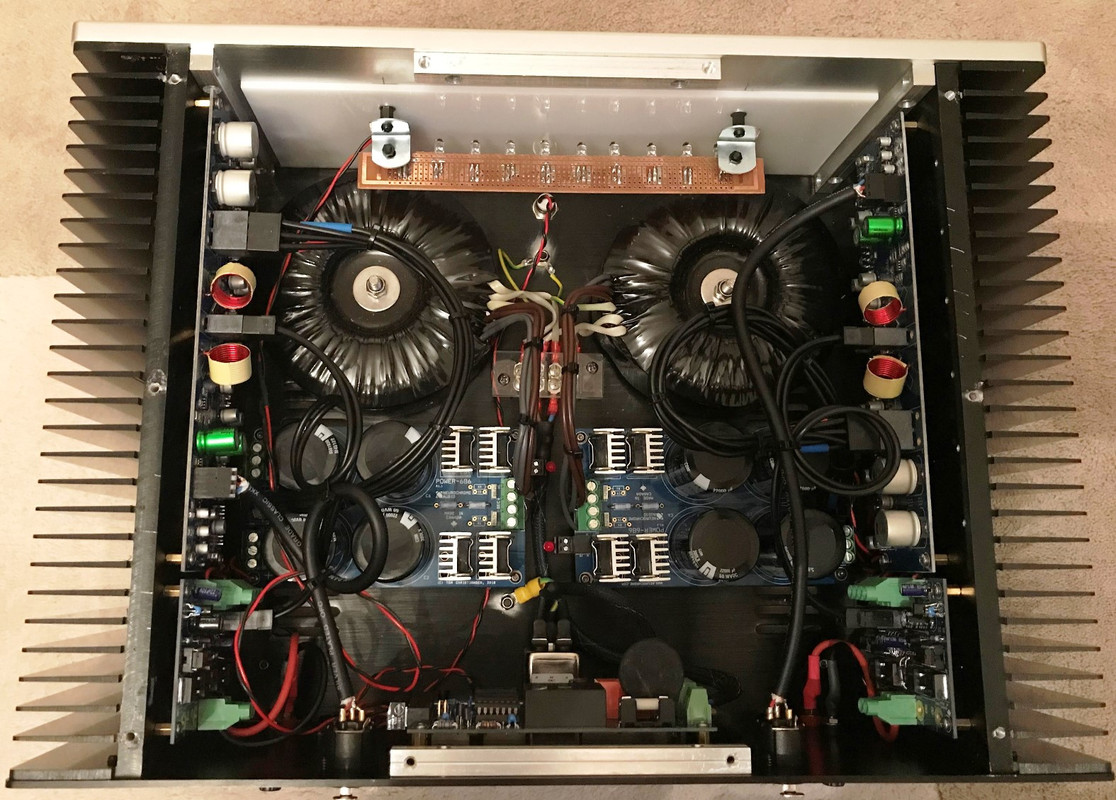

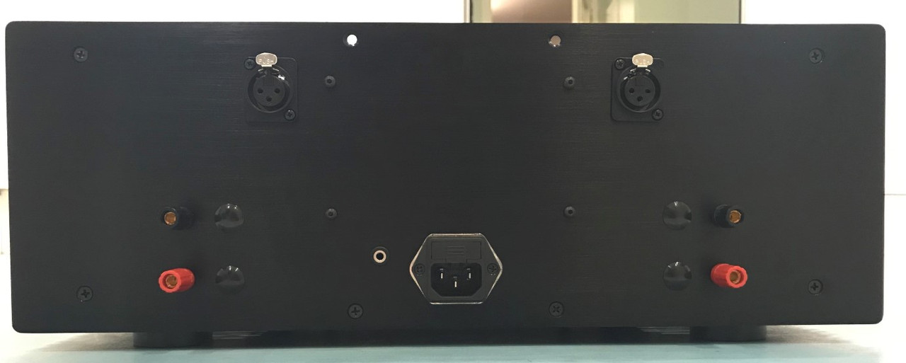

Here are a few of the photos from the build.
As you can see, the ISS V2 is much smaller than the ISS V1. Unfortunately, I missed this point when I did the CAD files for the case, so my ISS V2 was never going to fit.
So, I made a mounting plate out of an old PC case of the right colour to avoid drilling new holes in the case.
After wiring all the power cabling up, I powered the amp up, to check the voltages on the Power 686 boards to make sure everything was correct before connecting the amplifiers to the power supply.
hen I connected up all the cabling, and checked it all worked. Then tidied the internal cables up a bit, but I forgot to take a picture of that stage, so you will have to make do with the picture of the untidy case instead.
What can I say about this amp? My previous amps were a set of Modulus -86 mono blocks I bought on here. The 686 does what the Modulus -86 does, but it just does it better. It is certainly better suited to my Triangle Esprit Antal EZ speakers. It is certainly one of the better amps I have heard. I am looking forward to the end of this pandemic, so I can go and see a friend who owns a Benchmark ABH2 and see if there is a detectable difference between the two amplifiers.

- Mattattnet's build: Post #818
Full set of measurements found in Post #252 and Post #254. The transient response is shown in Post #331.
- Mono construction.
