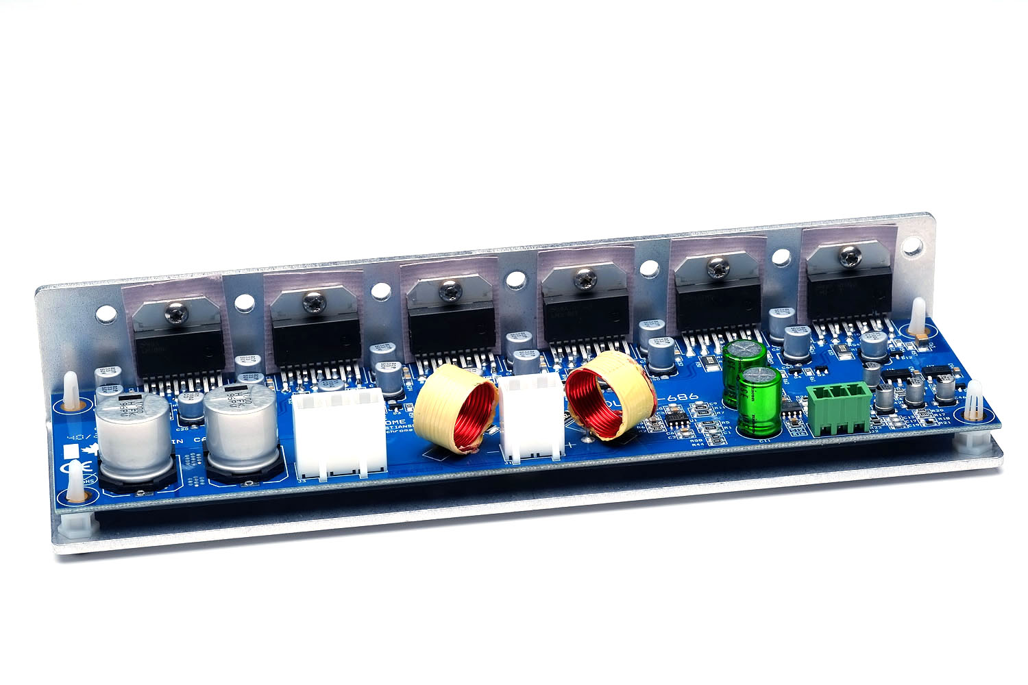

I've noted that there was a bracket revision on the 686 recently. It lit looks to be a nice simplification. Are there any circuit changes that you might have implemented with the latest batch of boards and its effect on performance?
Yep. I made some improvements in the input section, which lowered the noise and THD+N by about 2 dB. I also improved the 1+5.5 kHz IMD at 1 W.

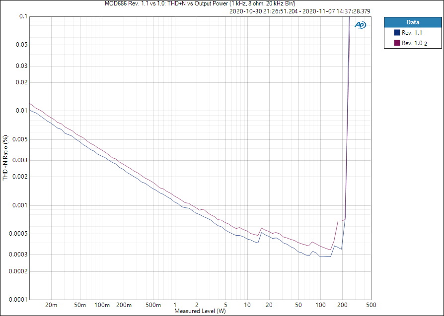

Tom, how does the rev 1.1 measure up against the benchmark amp? Have you taken the numbers crown back?
We're neck-and-neck. The AHB-2 is lower noise. The 686 provides higher output power than each channel in the AHB-2. Benchmark doesn't specify IMD of any kind for the AHB-2.

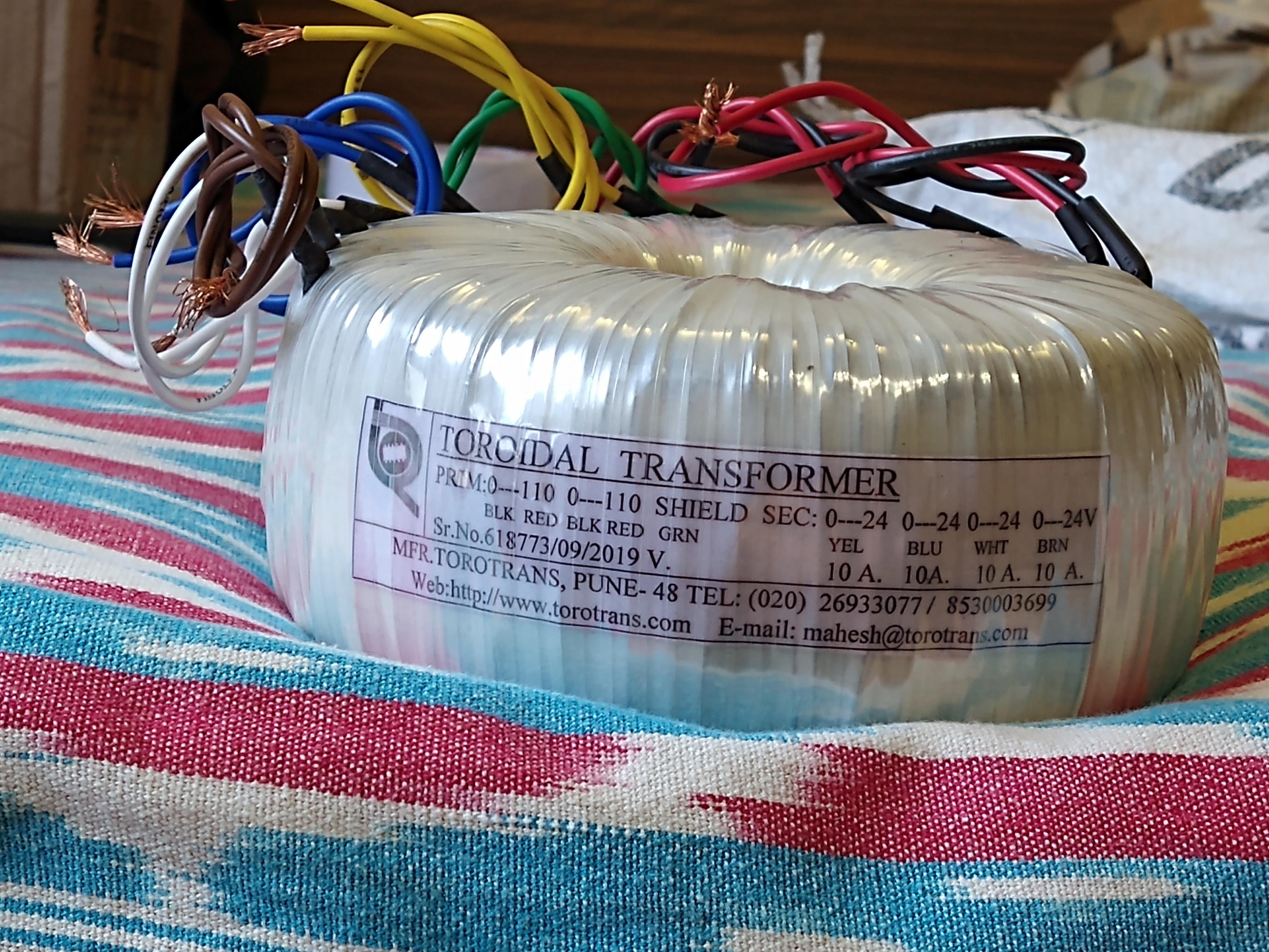

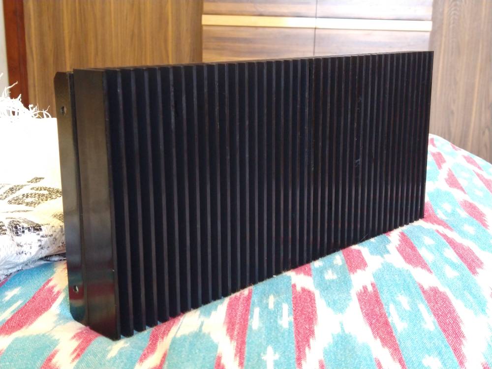

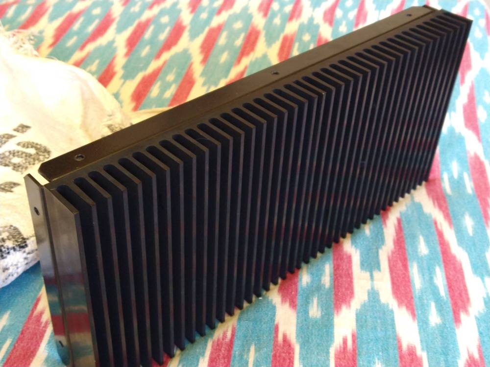

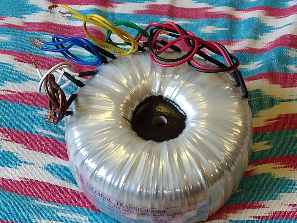

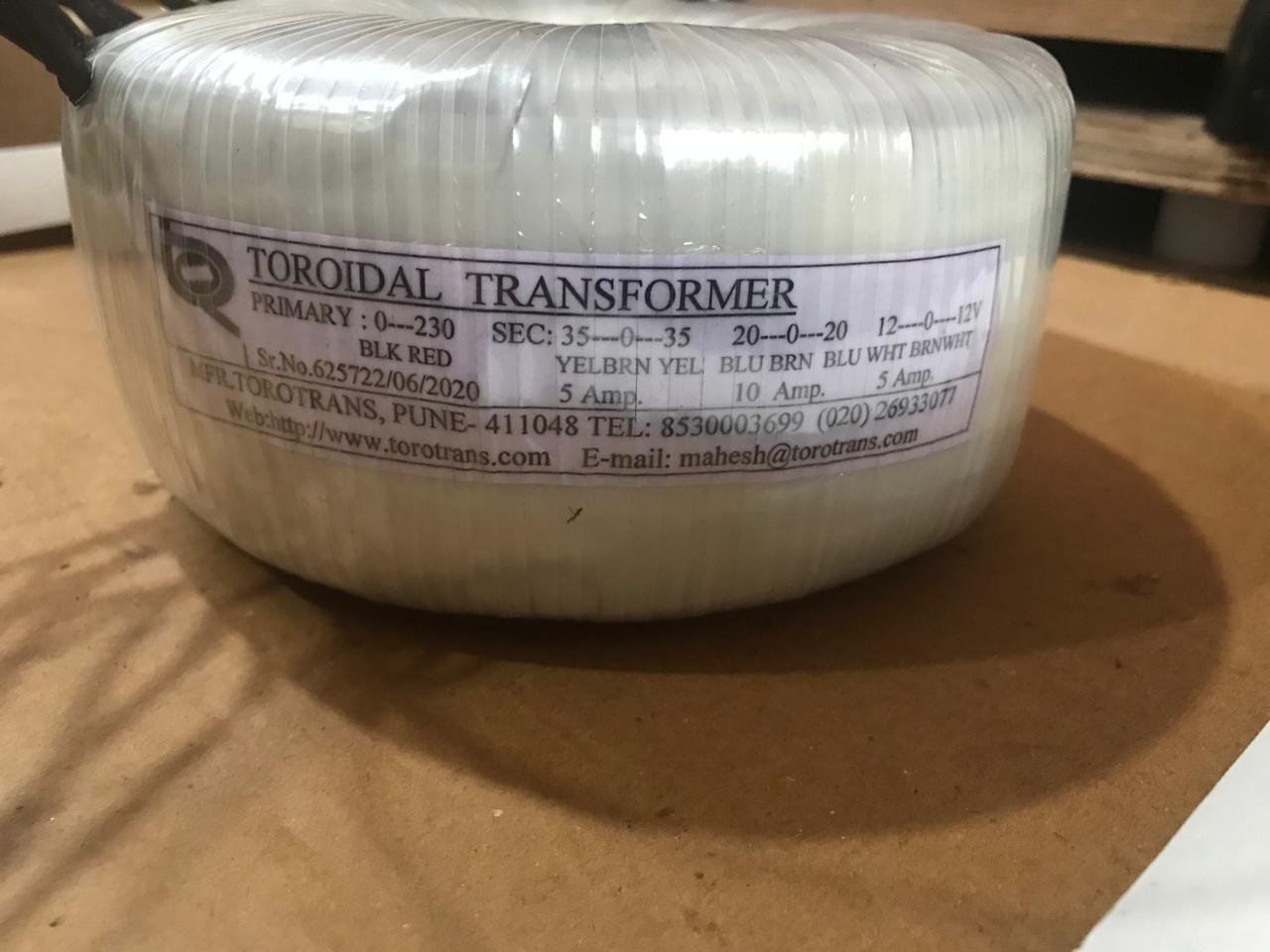

After several months of delay and waiting, I'm getting some of the parts for my stereo power amp build. Will take me a few more months to get the rest. The Modulus-686 modules have been in Bangalore for a few months now. I intend to drive down and get them when the world normalises somewhat.
View attachment 894072 View attachment 894073 View attachment 894074 View attachment 894075
