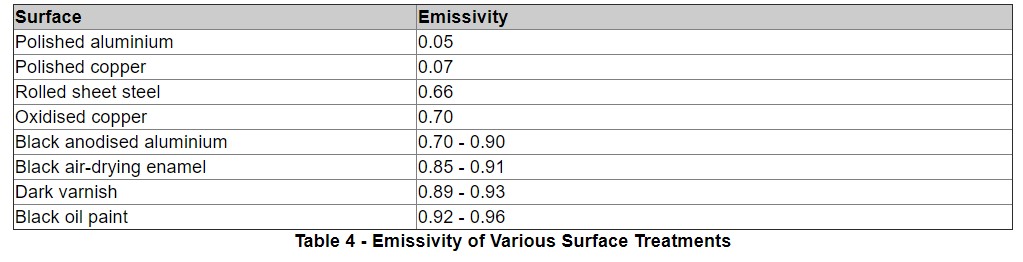

This is the table of emissivity from that link which is the part that is improved with the colour.
Right. Black anodized aluminum: 0.70-0.90. Then here and here it's simply listed as "anodized aluminum: 0.85" with no mention of colour.
By contrast, extruded aluminum and untreated aluminum sheet has a relative emissivity of 0.09.

The microscopic texturing is from the anodizing process itself. The colour is just a dye that's introduced to the anodization soup. While the emissivity does depend some on the colour, it seems to be a rater weak function.Emissivity improves as a result of its microscopic texturing and increased surface area.

I was trying to point to the emissivity being the improvement but made it sound like it was directly due to the colour which is not what the table shows. The change from polished copper to oxidised copper shows the big change clearly, 0.07 to 0.7.
Black paint being better than black dye would seem to be for the same reason an increase in surface area from the texture of the paint.

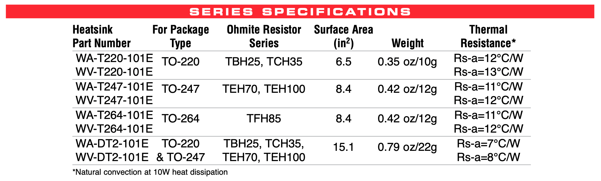

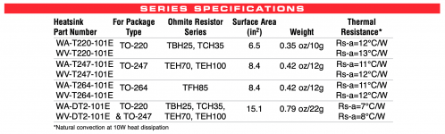

Does this mean that WV-T247-101E should be avoided for the Power-686? I've already got them soldered on the board - I guess i could pull them and try to get the black versions from the EU.
edit: digikey has them in stock.
There's hardly any difference between the black anodized and the natural aluminum. The first page of the data sheet gives the thermal resistance for the two types.
If the black heat sink is available when you build the board, get that. But if it isn't, get the degreased natural aluminum one. There's certainly no need to swap them out now that you have them on the board already.
