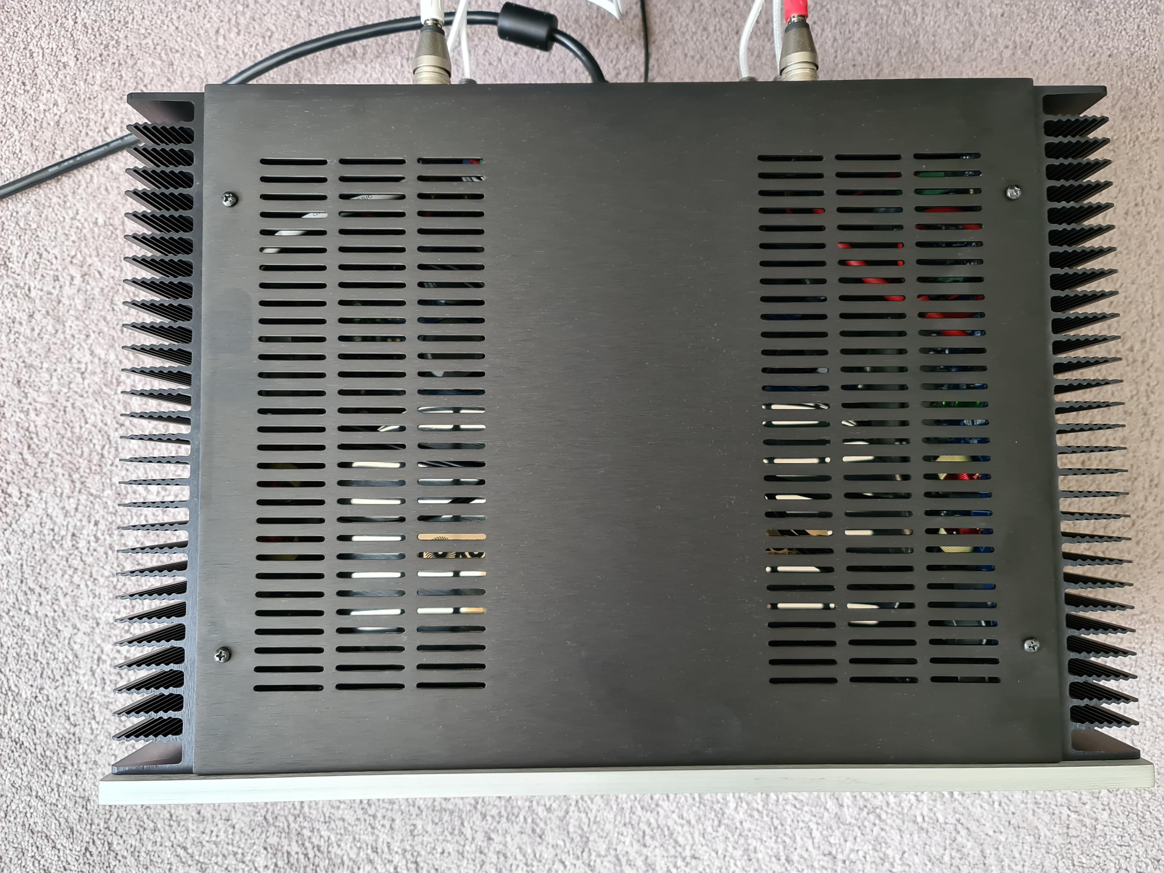

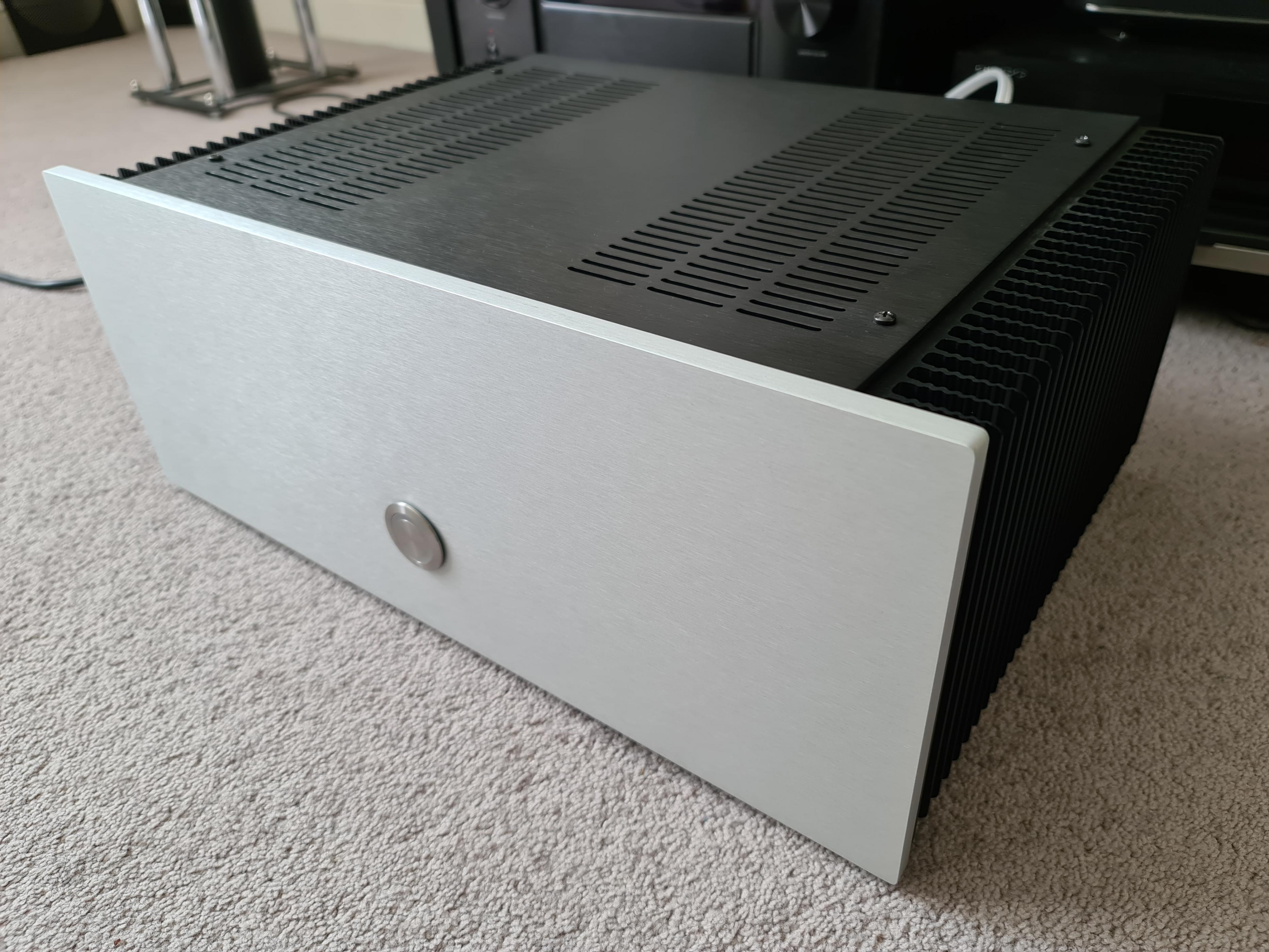

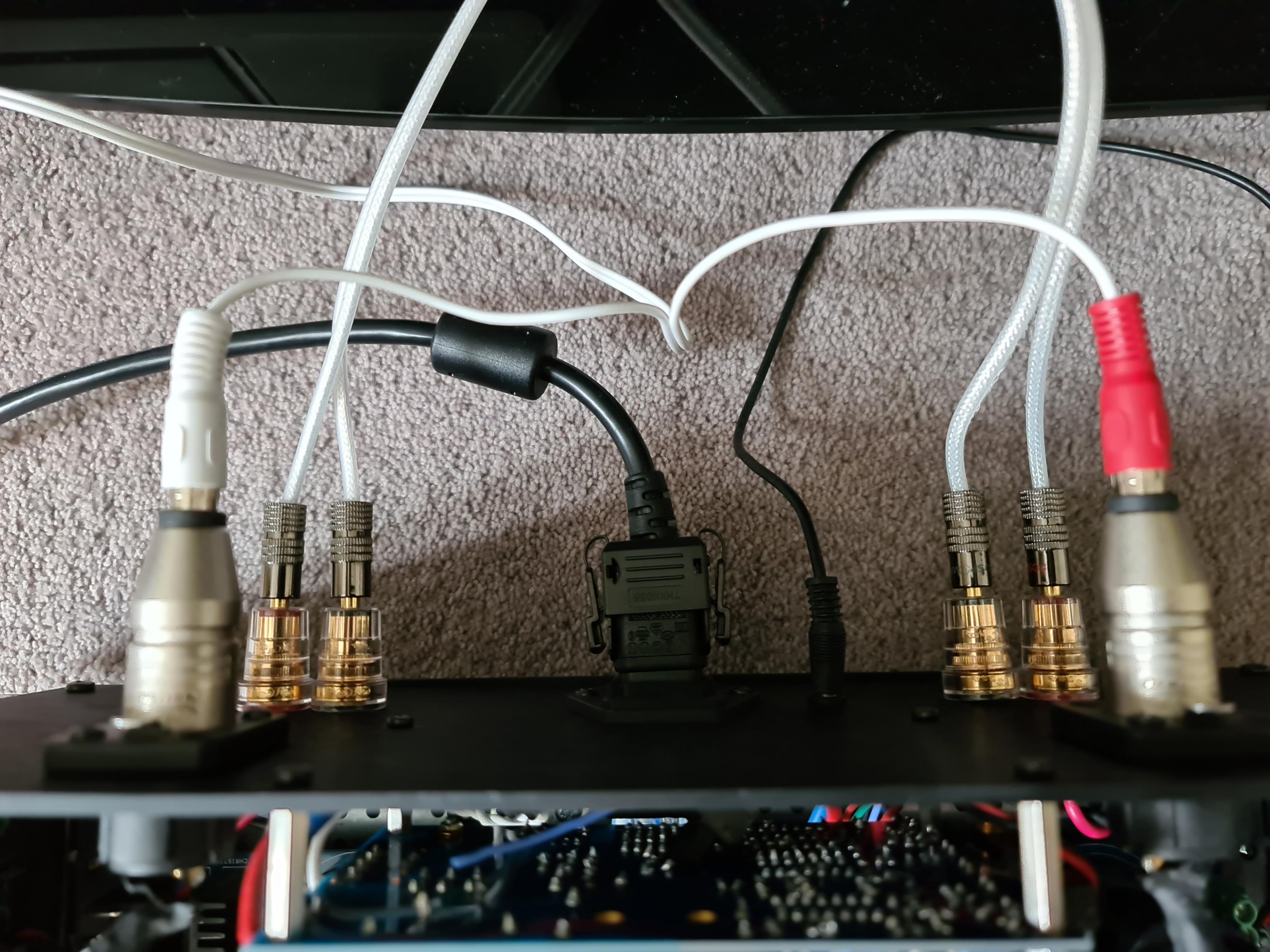

Where did you get the transformer mounting plates, I like them. edit Ah, found them on Toroidy, can't see how to buy them separately though, looks like they are only available with the supreme audio transformers. Also, what case did you use?
I had ordered one of these from China but it appears to have got lost on it's way to me and the price is now £40 more than when I ordered so looks like I'll be getting one from Modushop instead, pity as it's a nice case.
My case was the Deluxe 4U Aluminum ( DIYDX-4U300-A ) Modushop
Probably would go for the base version of this and customise the back/front panels, if I was to do again.
I'm pretty sure the "mounting plates" for the transformers is an option when you order. It's not a separate item. I bet it's secured to the transformer with the potting compound.
Tom
You have to order the mounting plates with it, and it comes supplied as separates with a large bolt.
The wiring loom makes this more of a necessity than option, (for me anyway).
