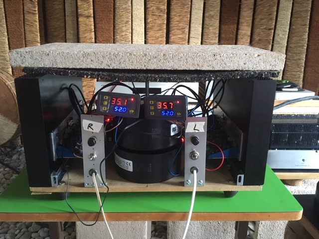

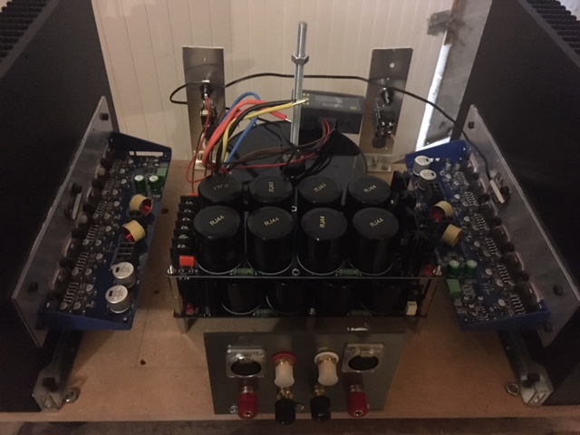

Hello Tom,
Some photos and my first listening impressions.
This is of course a provisional layout, that's why the power cables are
still long.
I have not yet decided if I keep a single double mono block or 2
separate mono blocks.
The bass is very beautiful and very tense, the whole is dynamic, the
stereo image beautiful and ample. I have not yet pushed the amp too
much, to its limits.
The medium is not aggressive, even on digital signals. Maybe a little
less warm than on my Primaluna tube amplifiers, but we feel a real
impression of available power.
I haven't tried vinyl records yet.
4 ohms speakers with 2x36 volts power. Unbalanced input.
More news in a while.
Thank you for the technical support and this great achievement of
amplification cards.
Jean-Luc

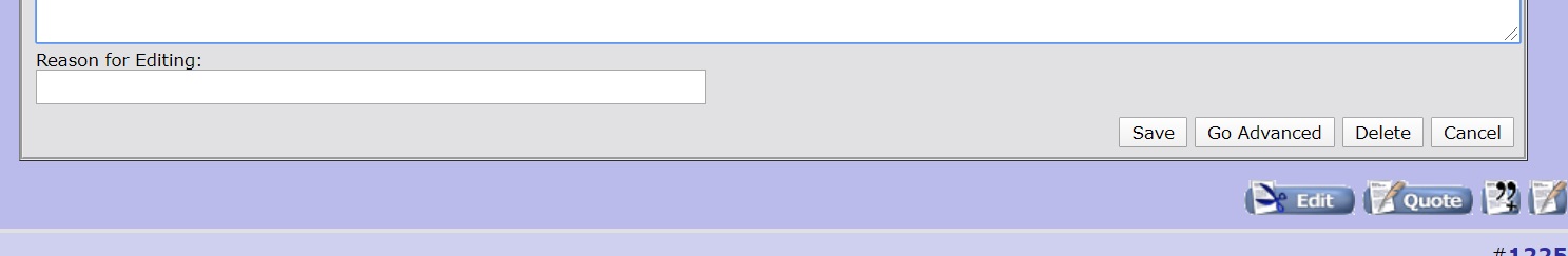

Jean-Luc,
You images are not showing - can you please try to attach them by going into "Go Advanced" and adding them with "Manage Attachments" under "Additional Options"?
Thank you sharing some early listening impressions. I have a Modulus-86, and my impressions are similar. 🙂

You're very welcome. Thank you for sharing your build pictures so far. I hope we get to see the finished amp as well. Nice work!

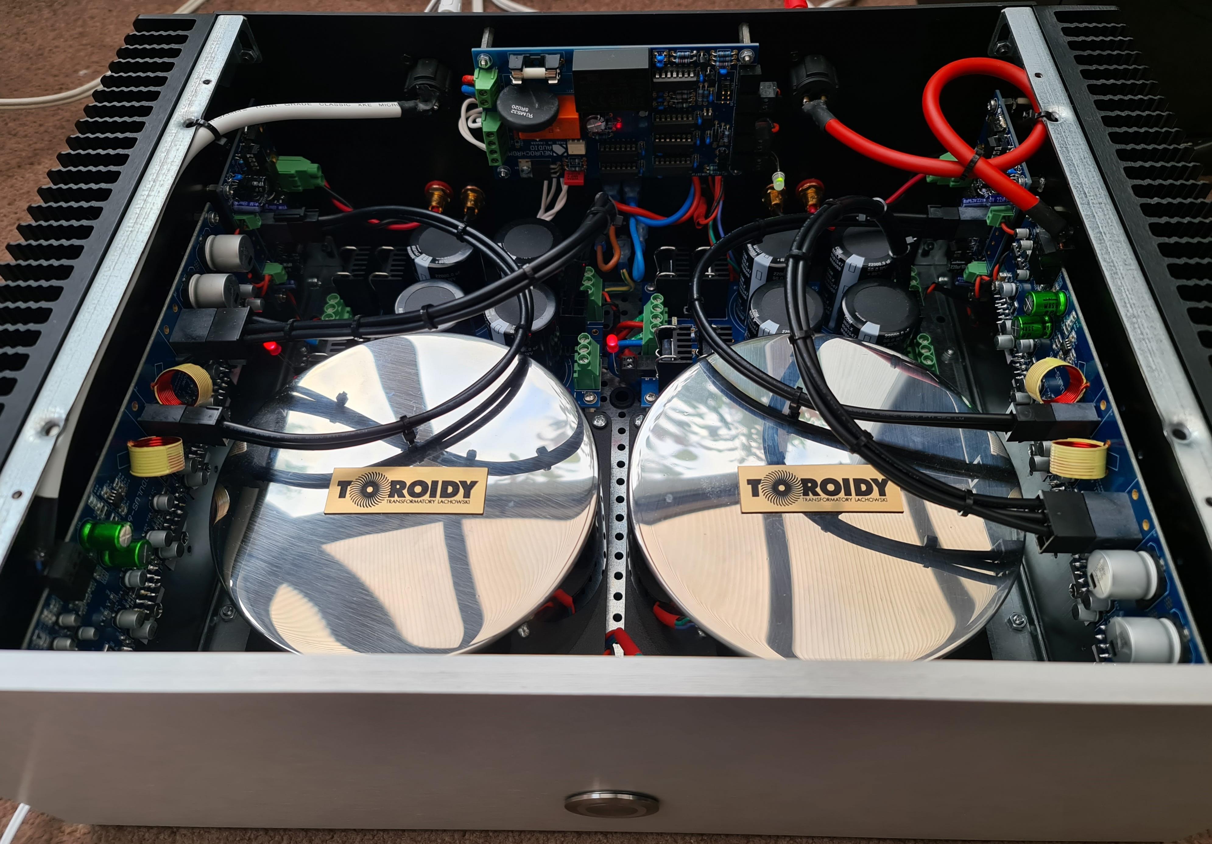

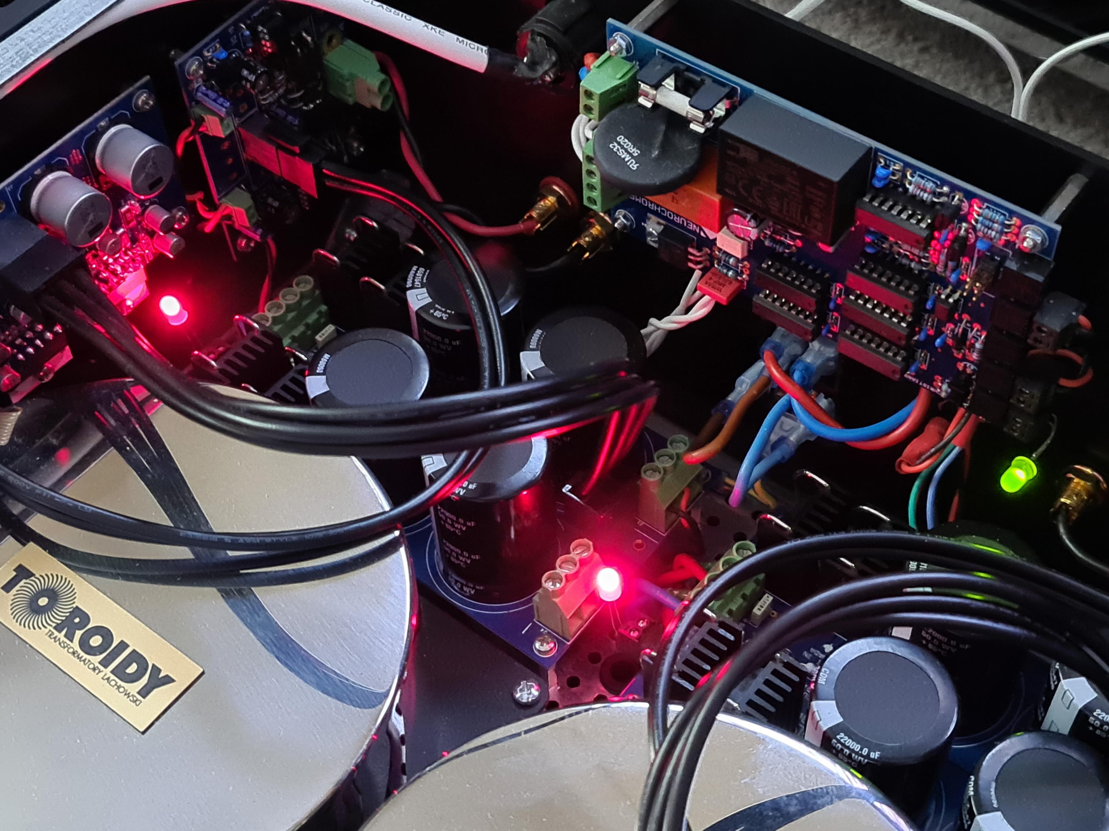

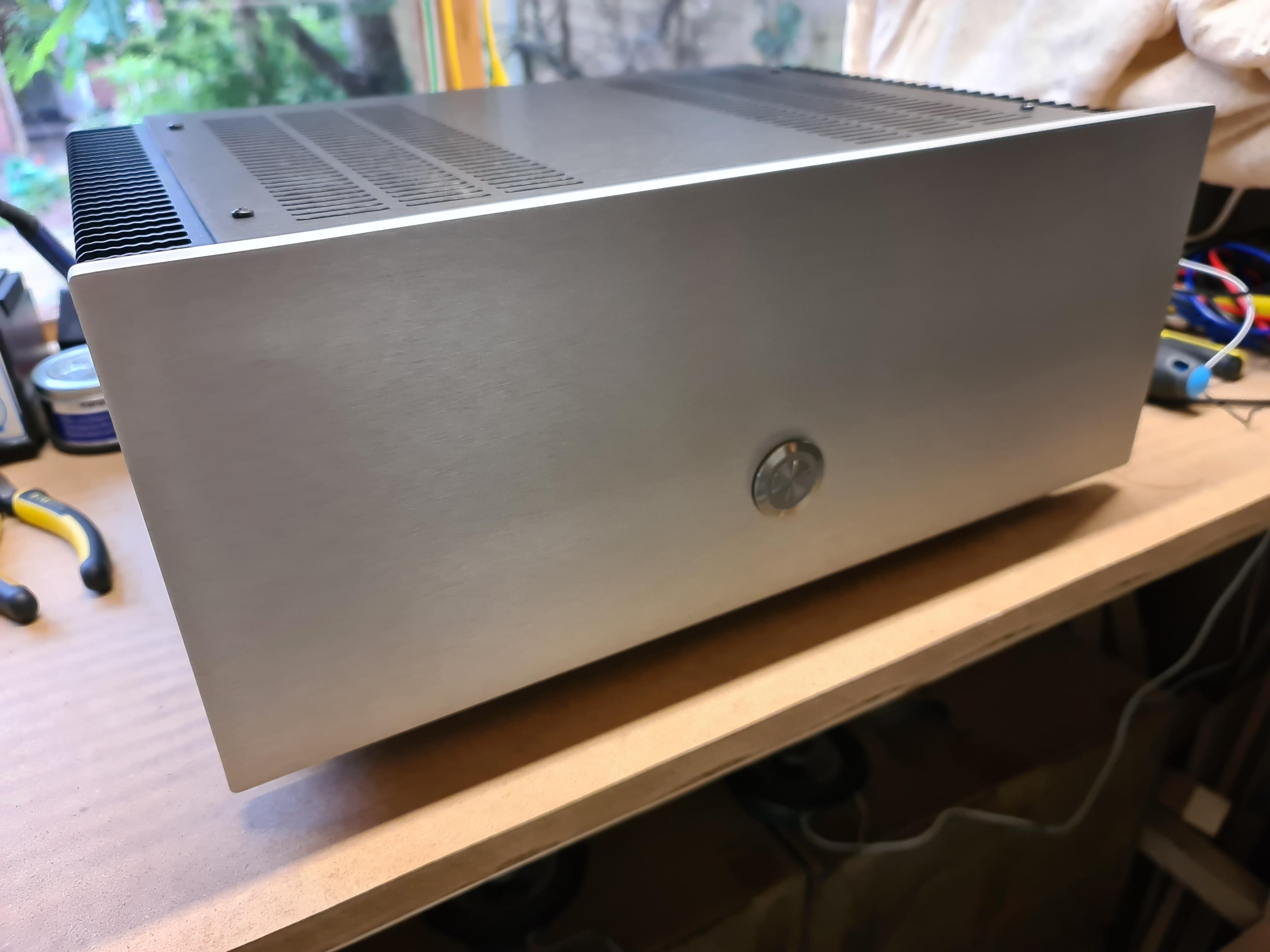

Hi All,
My dual mono block Mod-686 build is coming together, slowly.
Did some initial testing and found no problems with interference, a little surprising as it is quite compact in places.
Still trying to decide how to wire the LED in the front panel switch before the lid goes on permanently.🙂
More pics later.
Andy
More pics later.
Andy

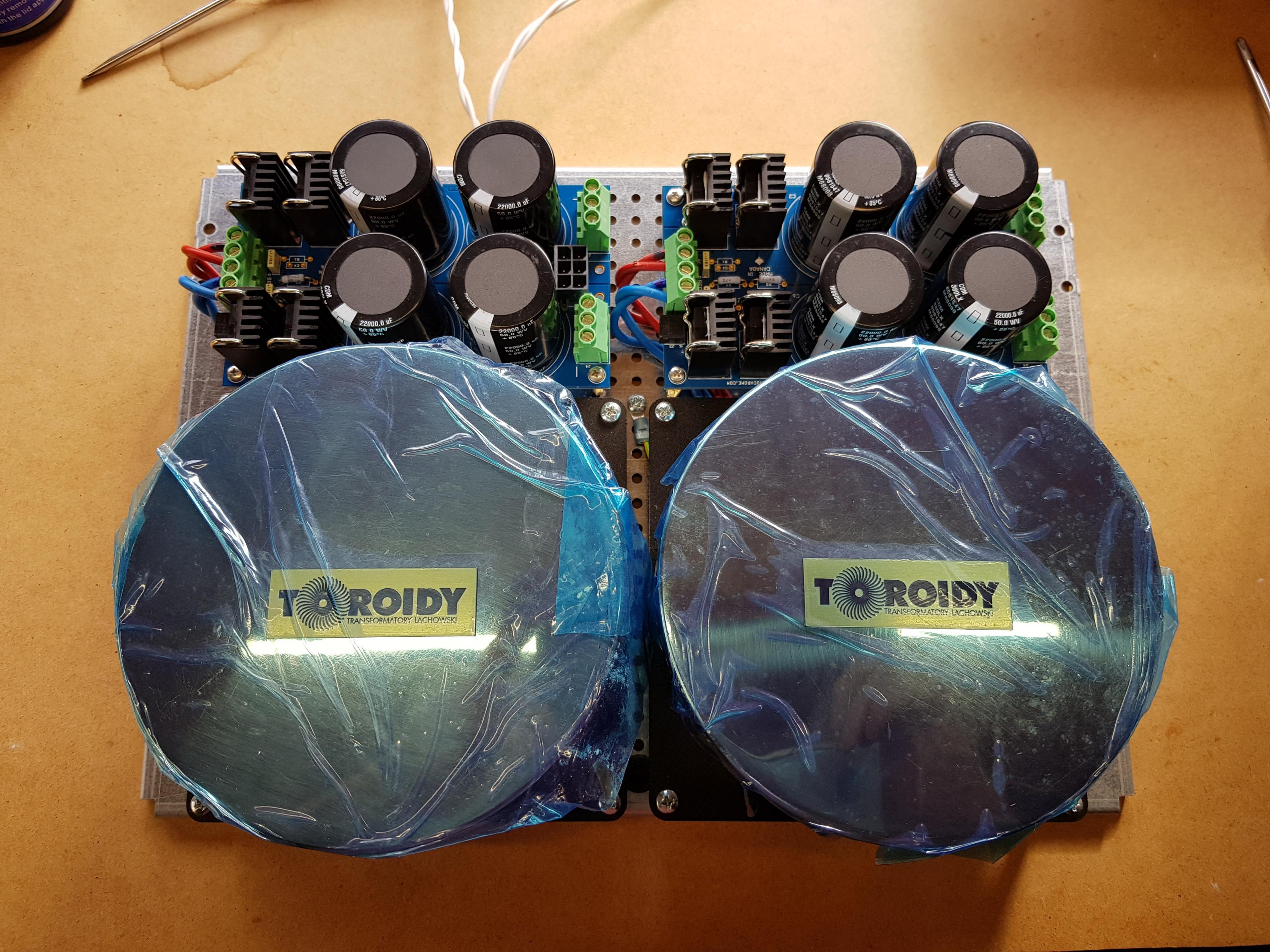

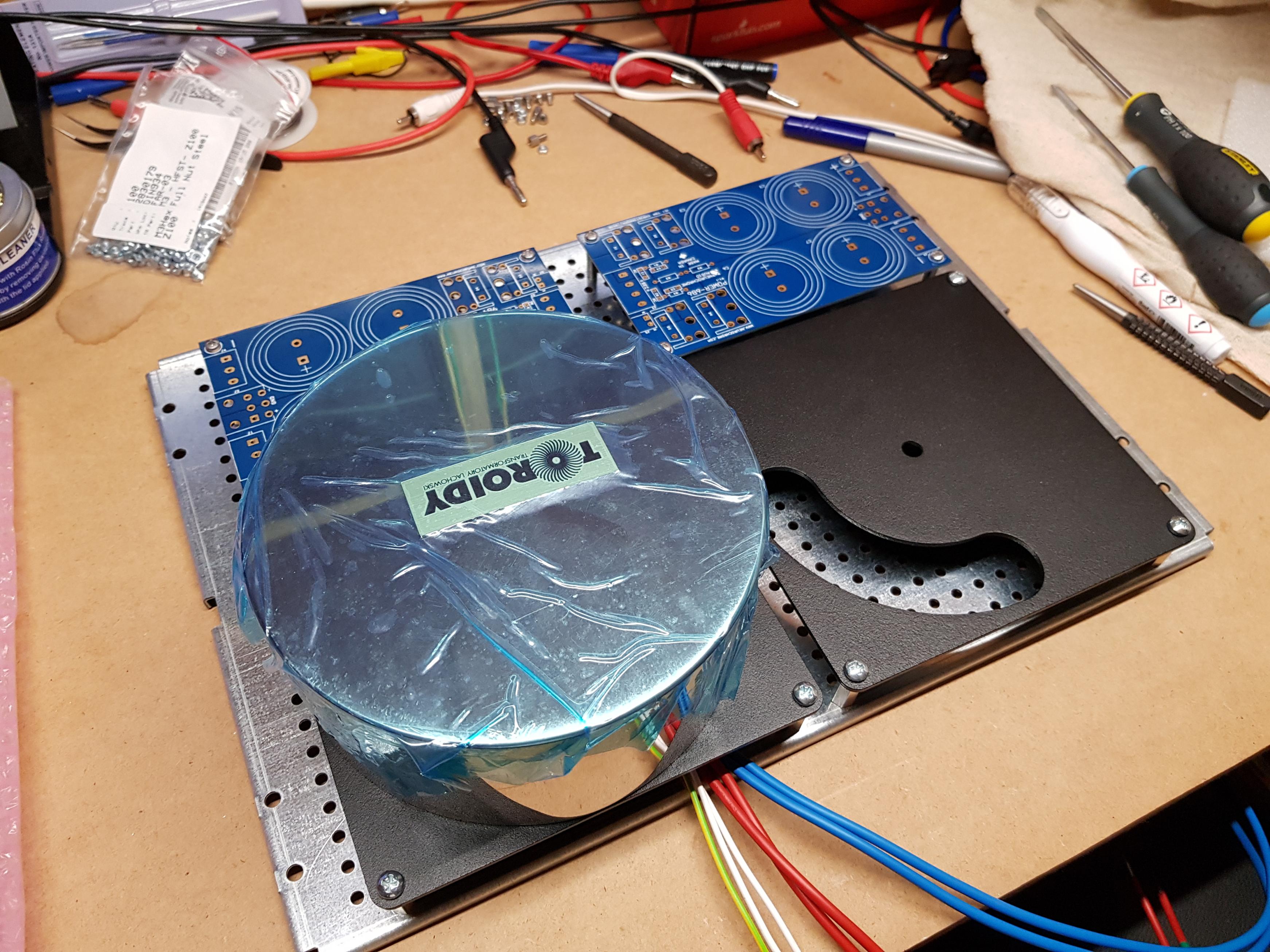

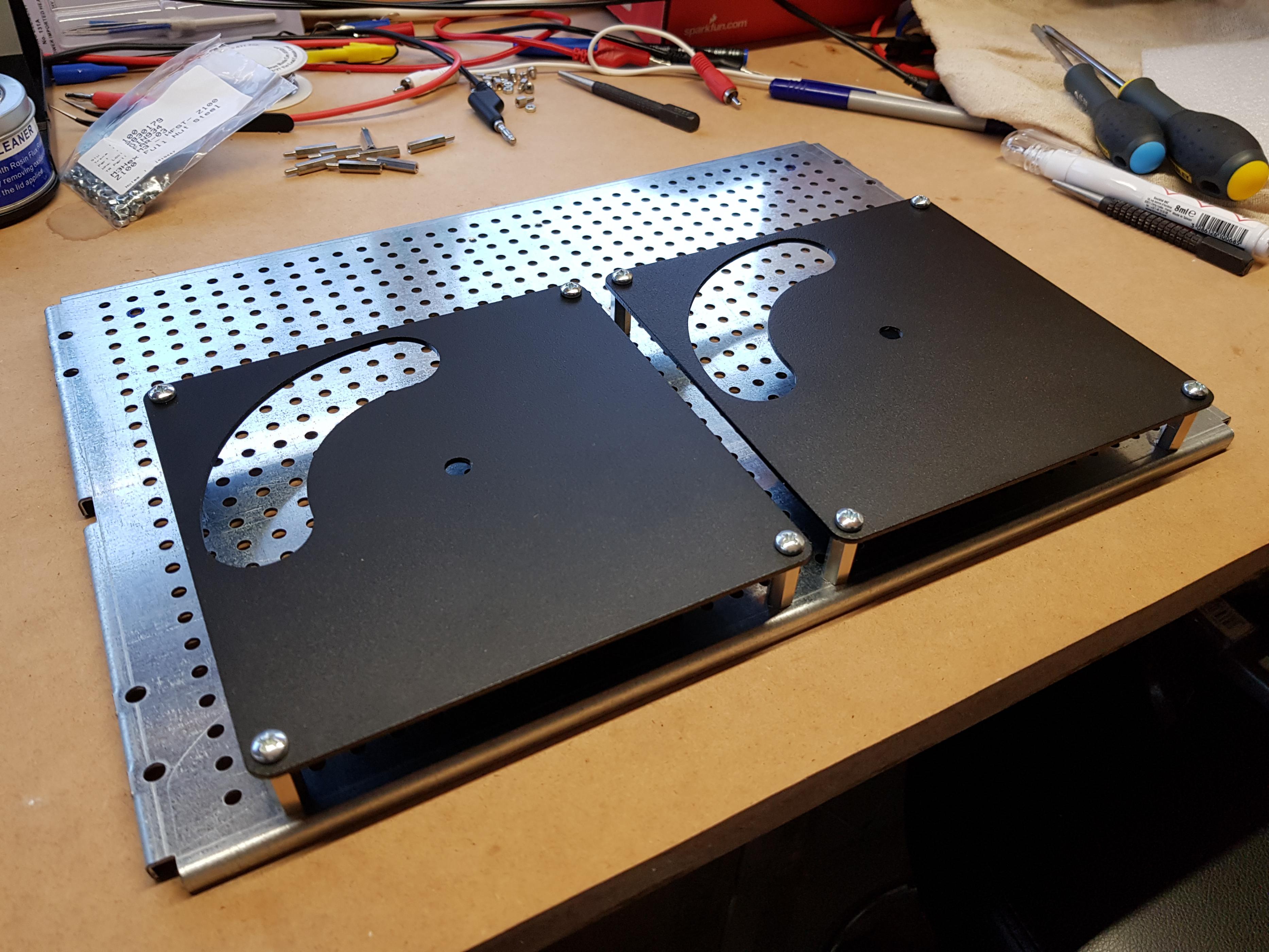

I've just purchased all the bits from Tom to build a dual mono in one case, I've got a lot to live up to! What value Toroidy transformers did you use?
Toridy transformers are TSAS 400VA - 2 X 25 V
Would have gone bigger if I could 🙂
I have made a little photo blog of the entire build journey which maybe of interest. Just tidying it up and fixing links etc then I'll post it here.

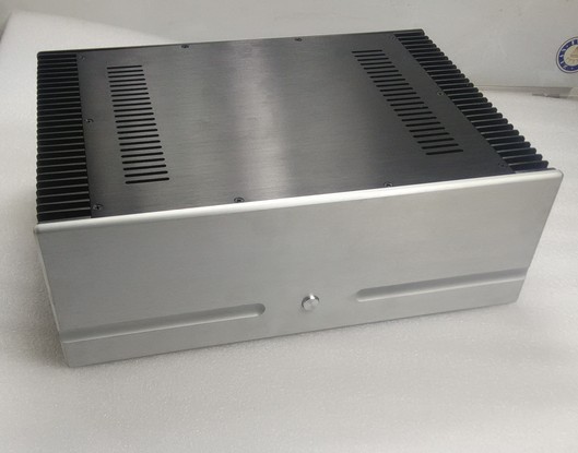

Where did you get the transformer mounting plates, I like them. edit Ah, found them on Toroidy, can't see how to buy them separately though, looks like they are only available with the supreme audio transformers. Also, what case did you use?
I had ordered one of these from China but it appears to have got lost on it's way to me and the price is now £40 more than when I ordered so looks like I'll be getting one from Modushop instead, pity as it's a nice case.
They couldn't get you a replacement instead of a refund?Where did you get the transformer mounting plates, I like them. edit Ah, found them on Toroidy, can't see how to buy them separately though, looks like they are only available with the supreme audio transformers. Also, what case did you use?
I'm pretty sure the "mounting plates" for the transformers is an option when you order. It's not a separate item. I bet it's secured to the transformer with the potting compound.
