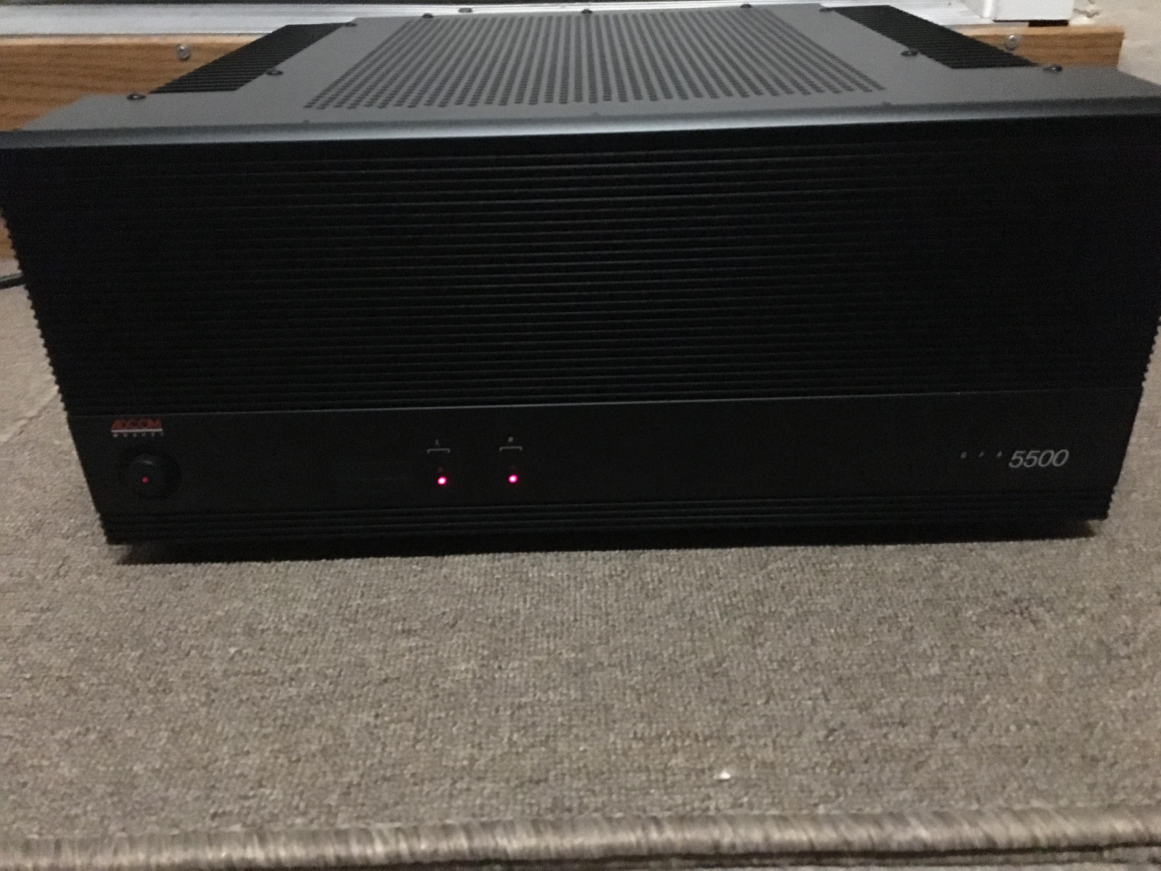

A nice Modulus-686 build turned up in the Chipamp Photo Gallery thread: Chip Amp Photo Gallery
This builder repurposed an old Adcom chassis with heat sinks. His build turned out really nice, so I thought I'd crosspost here.
A few teaser images (there are more linked to above).

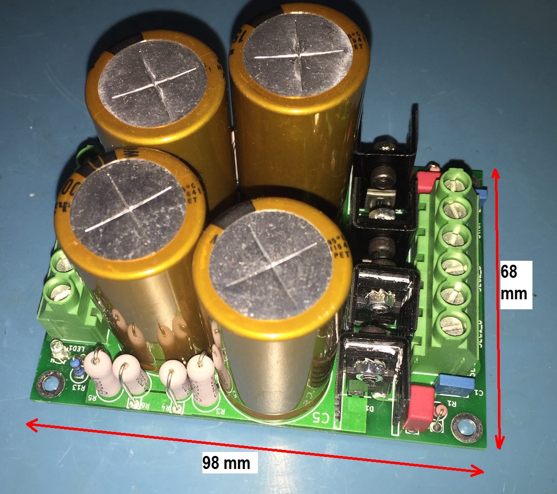

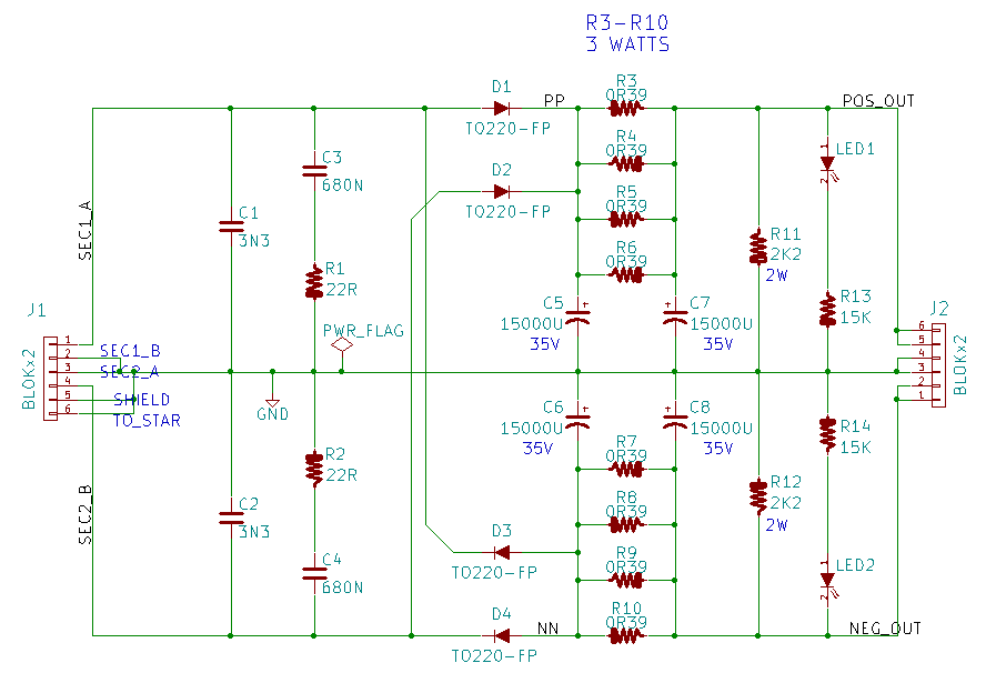

If you don't mind dropping down to thirty thousand microfarads per rail (2 x Mouser p/n 647-UFW1V153MRD), and if you also don't mind laying out a new PCB, then you can get something smaller than the Power-86. Here's a little design study that I did last year, which dropped the PCB dimensions down to 68mm x 98mm board size. The mounting holes align with the 1 cm grid drilled in the floor panels of diyAudio store / Modushop / HiFi2000 chassis: 6 cm X 9 cm. The Nichicon UFW goldsleeve caps I used are pretty tall, check the Mouser datasheet, maybe they're too tall for your application. Some people would of course replace the 0R39 3W resistors with jumper wires
Do it yourself; consider laying out your own board to meet your own needs. Mine, for example, includes CRC snubbers and indicator LEDs. You may not want those.

If you cook your own supply, I definitely recommend going with 50-63 V rated caps. The 35 V types in Mark's design don't quite cut it - especially once mains variation and part-to-part variation in the power transformer are taken into account.
I'm one of those who would scrap the CRC filtering. The added R does hardly anything for filtering (the cut-off frequency with the values shown above is 109 Hz), but causes a lot of supply bounce on the signal peaks. Sure, you can add wire links, but that adds inductance. I'd rather have a low-inductance plane connecting the caps.
Further, I would lay down the snubber resistors to minimize their lead inductance. If you're going through the trouble of adding CRC snubbers, you may as well make the snubber work well. I'd scoot the caps away from the heat sinks, so you don't cook the caps. Even a few mm of room goes a long way.
I can't quite tell from the picture, but it looks like the heat sinks are just dangling from the diodes. I would prefer that they were soldered or otherwise mechanically tied to the board to prevent their solder joints from failing over time.
Tom
