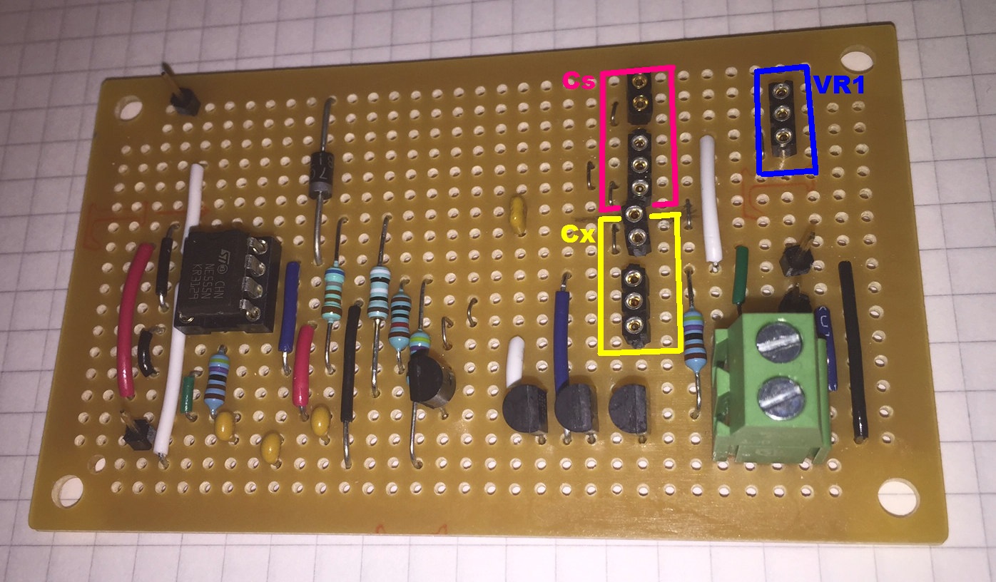

You could of course replace the fixed 10 ohm snubber resistor on your board, with a 50 ohm 25 turn trimpot. Then dial it for least ringing as viewed through your highpass filter. Saves time compared to disconnecting the trafo and attaching it to a Quasimodo. If the least ringing you can get, all the way across the dial, is still comparable to (or worse than) the other candidates, you're all done. If it's lower, but not much lower, you're probably all done. If it's quite a bit lower, now you can recommend values for either a 2-component snubber with ringing X-amount, or a 3-component snubber with ringing far-less-than-X-amount.
By the way, you want to do the test with a hefty big load current being pulled from the supply. You want those diodes to be working hard, slamming on and off vigorously. I recommend at least 60% of max permitted load current

Whoops. I realized I swapped Cx and Cs. It should be 10 nF || 150 nF + 10 Ω for Mark's snubber. My bad. I've included all the results below so they're easier to compare. You can find the test conditions a few posts back. I forgot to mention that this measurement was taken with 8 Ω resistive load on each rail, resulting in roughly 275 W of dissipated power.

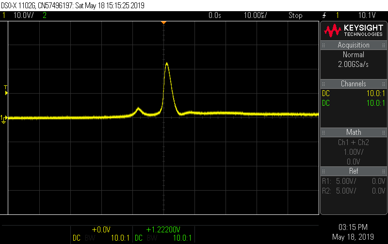

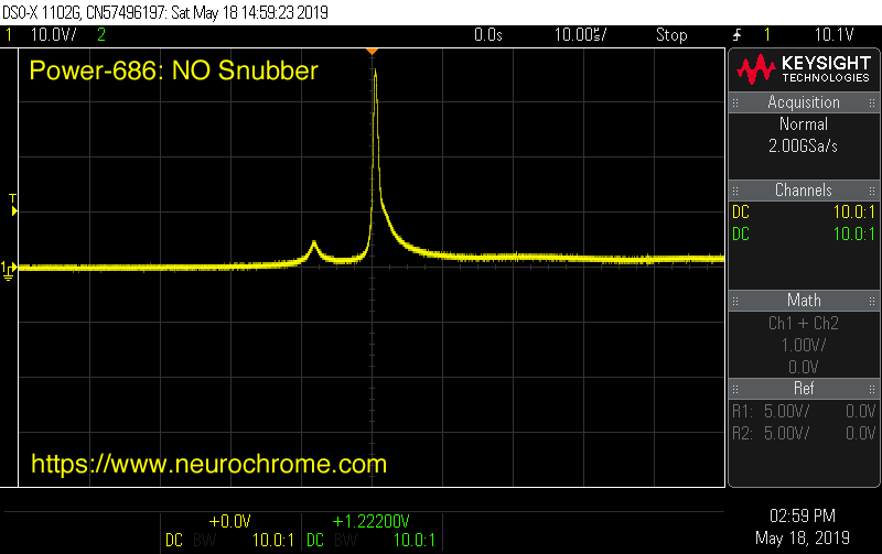

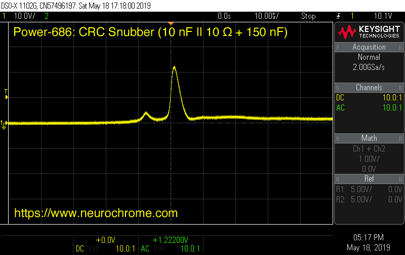

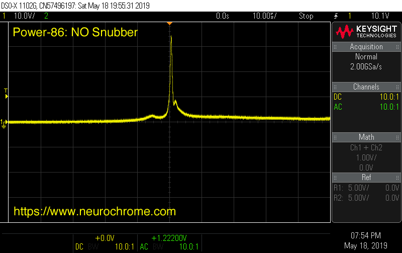

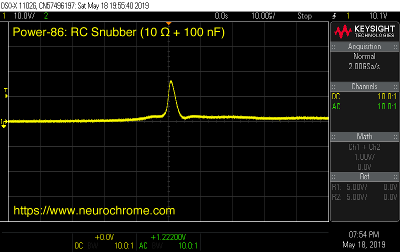

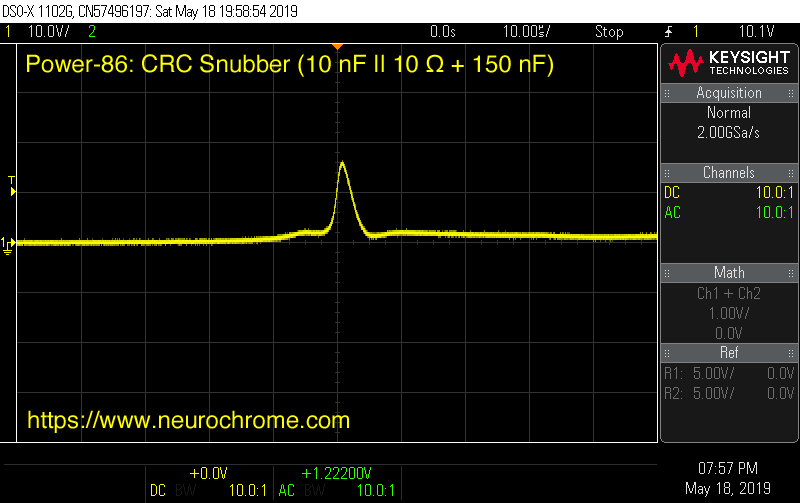

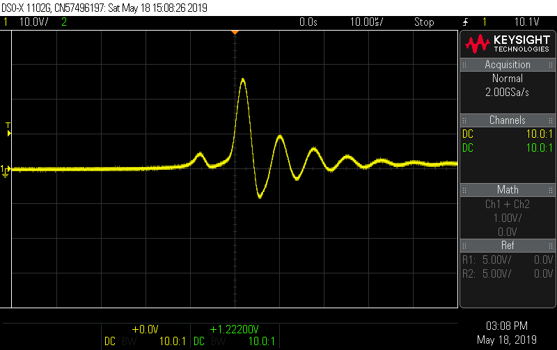

Since I had the measurement setup running anyway, I decided to postpone the IPA consumption for a little bit.
Attached show the Power-86 in three conditions:
- NO snubber
- CRC snubber (10 nF || 10 Ω + 150 nF) - Mark's design
- RC snubber (10 Ω + 100 nF) - Rod's design
Transformer: Antek AN-5225
Load: 8 Ω on each rail (275 W)
Conclusion: No ringing even without snubber. No ringing with Rod's snubber. No ringing with Mark's snubber. No issue. No fix.
I shall drink beer now. I think I'll have one of the Yellow Dog.
Tom

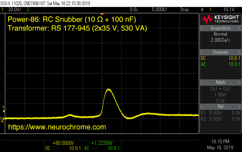

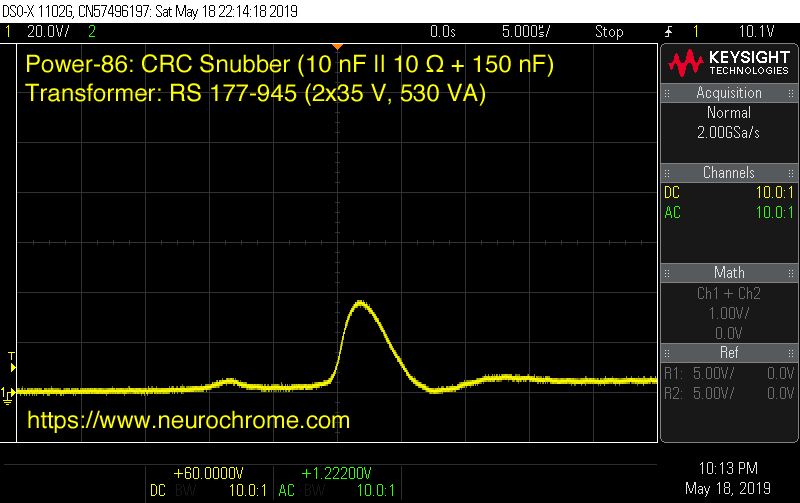

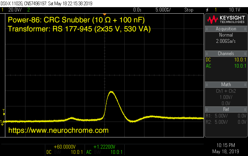

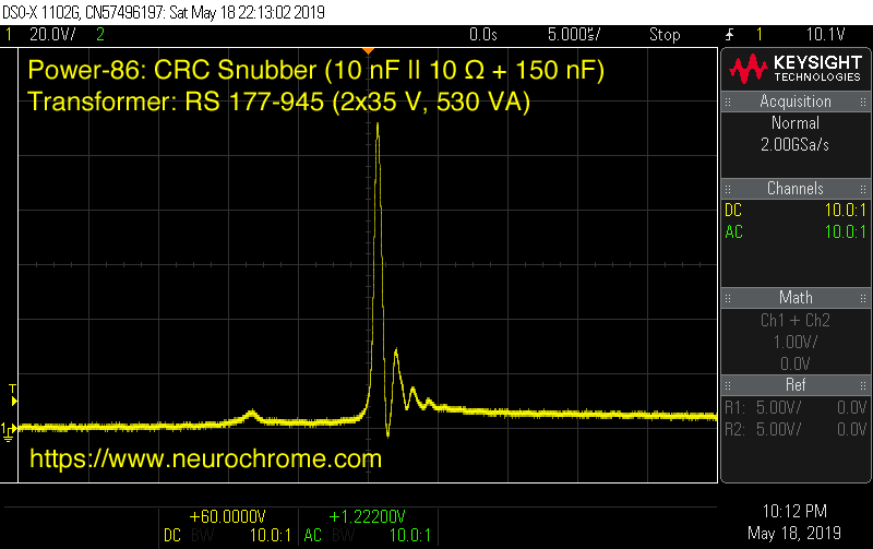

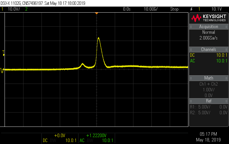

That could be. Thankfully, one of the transformers in my arsenal wasn't one of the self-damped ones. It's a 2x35 VAC, 530 VA toroid. Quite good quality. It came from RS Components some 20+ years ago. P/N: 177-945.
I hooked it up to a Power-86 and tried the three snubber combinations:
- NO snubber
- CRC: 10 nF || 10 Ω + 150 nF (Mark's)
- RC: 10 Ω + 100 nF (Rod's)
Results:
- Some ringing without snubber. The ringing dies pretty quickly. I'm not overly concerned by it, but also don't see any harm in removing the ringing.
- CRC snubber: Dampens out the ringing nicely. Lowers the flyback amplitude dramatically. I could reduce R if I wanted a tighter response, but it looks good as-is.
- RC snubber: Same as for CRC snubber.
My method takes place in situ, with the mains impedance reflected by the transformer, requires only an RC highpass filter (1 kΩ, 10 nF) and an oscilloscope, and requires only two snubber components.
You're right that the components are only 20 cents each, so it's not a lot of money. Still, using three components where two will do the job just as well is just not my cup of tea. Each to their own.
You're certainly free to keep arguing. I'll keep reading. At this point, though, I think I have enough data that I should focus on getting it onto my website (Snubber page) and into the design documentation for the Power-86 and Power-686. :micdrop:
