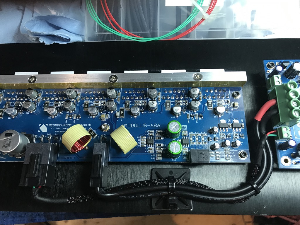

Started the wiring of the left channel module. I'm missing some standoffs and will order some this week. Protection circuit power is wired under the PCB for better cable routing.

I like the module setup you have going. I like that you put the Guardian-686 on the heat sink. That's become my favourite mounting method as well.
Thanks! Yes, it also makes it cleaner for the cabling.
Do, very tidy and methodical work - can't wait to see the final result.

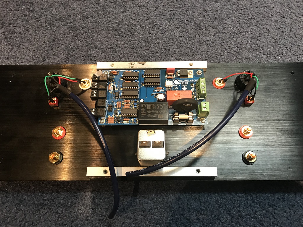

I wish the RCA connector holes on my backplate were not already drilled when the chassis was bought... I find them too close to the AC on the ISS module...
Yeah... It would have been nice with the RCAs on the other side of the XLRs.
I also prefer the speaker binding posts to be 3/4" centre-to-centre and side-by-side rather than one atop the other. It puts less torque on spade terminals and such. But that's me.
Maybe I will turn the 4 positions connector to the inside so cables going to the transformer stay away from the RCA jack...
That's worth a try. The connector footprint is asymmetrical so it may not work, but you can always solder the connector on last and see if it'll fit in that orientation. There are also 45º and top entry connectors that'll likely fit that footprint. Those could help (assuming they fit).

Which SMPS did you go with?
Hi Tom,
The SMPS800 that you had suggested. I recapped them completely since only the output caps were of good quality. The cheap Chinese caps were still working properly but for the long run, it is better to use quality caps.
Cresnet uses only quality caps in his designs. All the SMPS I got from him had reputable brands. I still have a few of his SMPS but they are higher voltage and are reserved for other projects.
Today I will test the amp with a scope and output some sinus and square wave before I plug it into the speakers. I will post pictures of the final build shortly.
