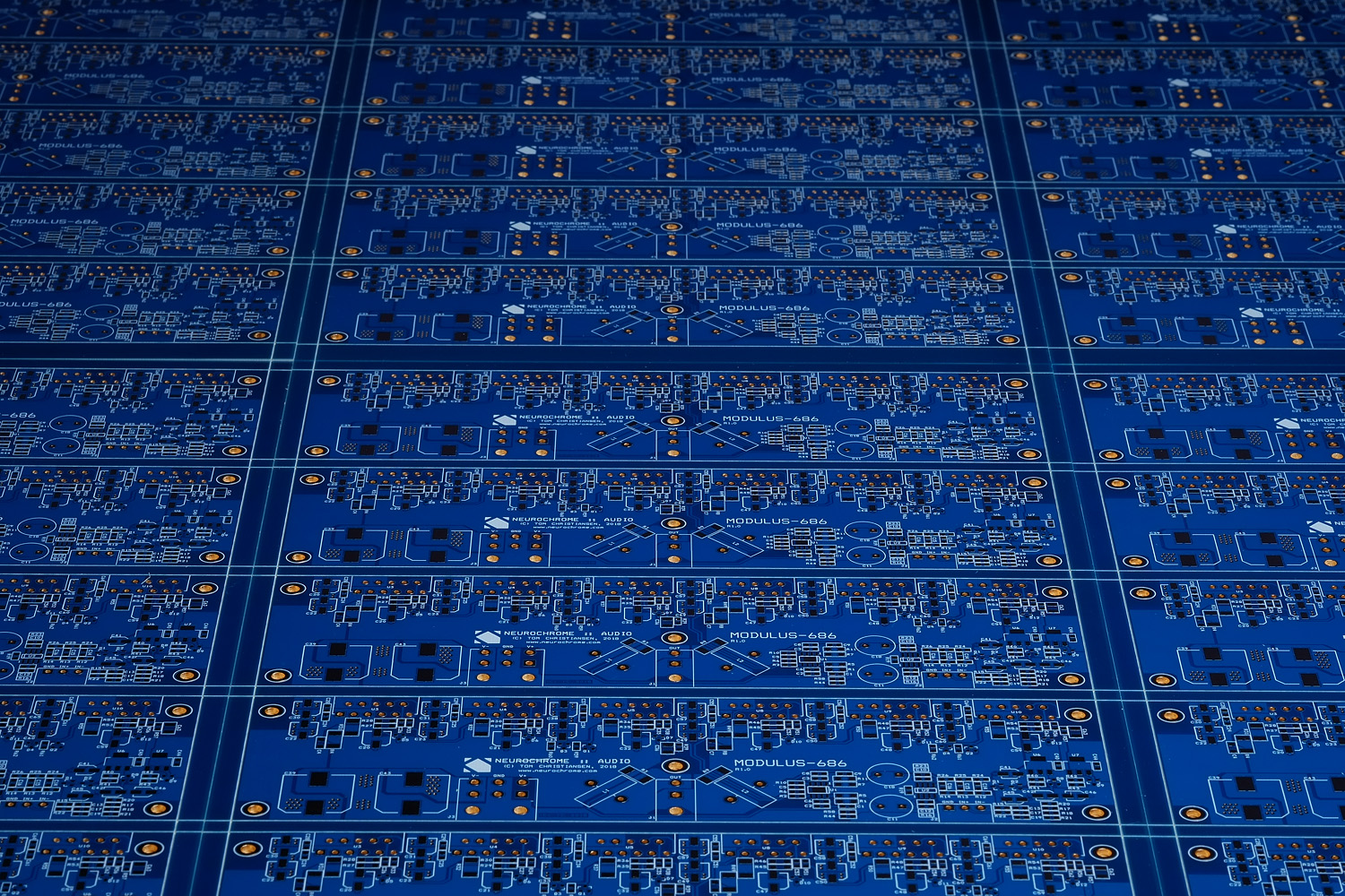

FedEx delivered the PCBs almost a full week ahead of schedule. Love FedEx.
Now the boards will go off to assembly. That's expected to take about 20 business days (so almost a month!). Pardon the delay. I'm confident it'll be worth the wait.
I must say that I rather like the blue-on-gold colour scheme. While it is pretty, the gold plating was not chosen for aesthetics. The gold is easier for the assembly folks to work with. It also makes the boards ROHS compatible.
Tom
Tom
Tom,
Regarding the gold platings, is it just on the pads or is it on the traces too? When referring to “gold” are you referring to true gold or the commonly used chemical gold?
I use ENIG, which is a chemical process of gold plating that forms a thin layer of gold on the copper of the PCB. I'm not aware of anything called "chemical gold". Gold is gold and there's enough of it on the pads to prevent surface contamination and ensure a good solder bond. That's the point of it.
I don't know if the gold is on the traces or just on the pads. You wouldn't need the gold on the traces, so it would seem like a very reasonable cost reduction to dunk the boards in the gold plating soup after the solder mask has been applied and only get gold on the traces. I imagine that soup is pretty expensive.
I'm not aware of anyone who is depositing gold onto circuit boards through sputtering or the like. It'd be an annoying process as gold doesn't want to stick to anything. In semiconductor manufacturing, an adhesion layer of chromium is commonly used to make the gold stick to the aluminum pads on the IC. Fancier layer stack-ups are pretty common too.
Tom

Expanding on what Tom said, ENIG is a very thin chemically-applied plating to prevent oxidation of the pads. The gold is very real but it's not robust as a traditional gold-over-nickel-over-copper (not chromium). These days you only see that selectively applied to edge connector fingers. Solder mask these days is almost always SMOBC (solder mask over bare copper), so I doubt you'll find gold on the non-exposed copper, though you're free to carefully scrape the solder mask and look for yourself.
Or ask your PCB manufacturer what their process is. 🙂 Given that the gold is not needed on the traces, I highly doubt there is any gold on the traces. Less gold -> lower cost.
There is another plating process out there that involves a fancier layer-stack. Electroless Nickel, Electroless Palladium, Immersion Gold (ENEPIG). So the same as ENIG but with palladium added between the nickel and gold layers.
For those interested in reading more about gold plating of PCBs, there's a ton of information available here: PWB Processes: ENEPIG nickel-free PCB coating
Gold fingers for edge connectors came to mind for me as well. Even for those, the gold layer is often only 300 micro-inches (gotta love the metric-imperial mix/match units) or 7-8 µm thick.
Tom
