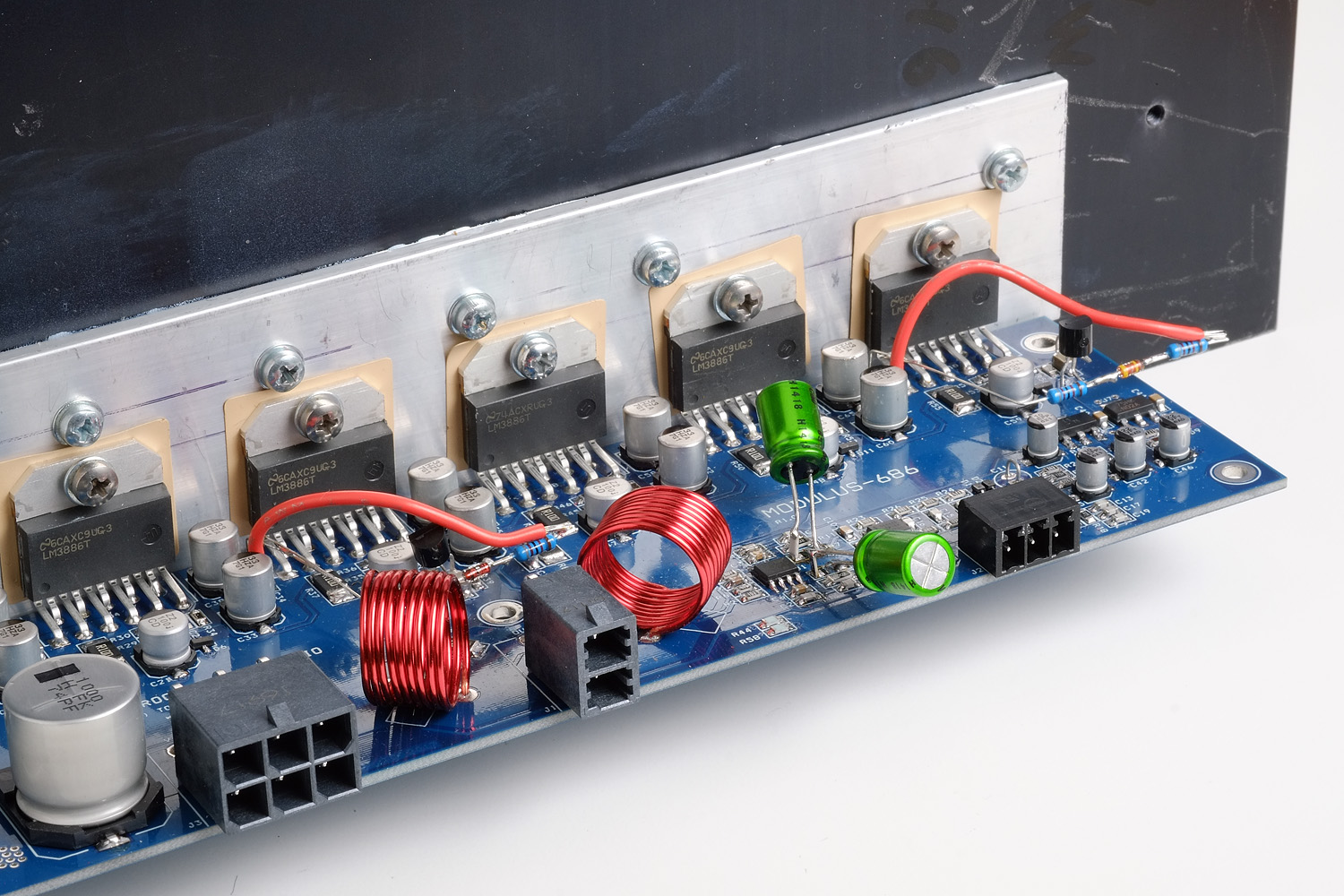

Attached is the Modulus-686 MacGyver Style. The prototype has had new additions of duct tape and bailing wire since this picture was taken. Needless to say, I would rather wait another few weeks and get the final builds than spend time making pretty plots of the prototype knowing that I will have to redo all the work when the final boards come in.
I fully expect the professionally assembled boards to show better performance than what I show on the prototype. That's what I was trying to say.

I noticed you use the LM3886 with the metal casing in your prototype.
Does that improve heat transfer or could one use also the plastic casing in the final built?

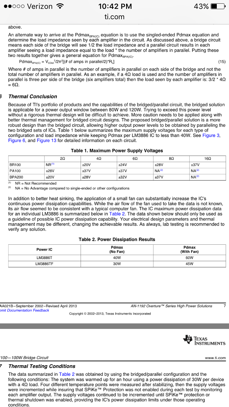

I am looking at the heat sink contact and wondering if heat transfer to the heat sink can further be improved. There are some surface treatment used for insulation and improved thermal transfer.
Good question. I don't know the answer yet. I will build one MOD686 sample with the LM3886T and another with the LM3886TF and measure the difference (assuming there is a difference).
I would prefer to use the 'TF' (plastic) version. It's just so much easier to work with mechanically. No need to worry about burrs and metal chips shorting the package to the heat sink (and chassis).
The TF has higher thermal resistance that the T version, for obvious reasons. However, once the additional thermal interfaces of the isolating pad are added, I'm not sure how large this difference is in practice. I do intend to find out and make recommendations based on my findings, however.

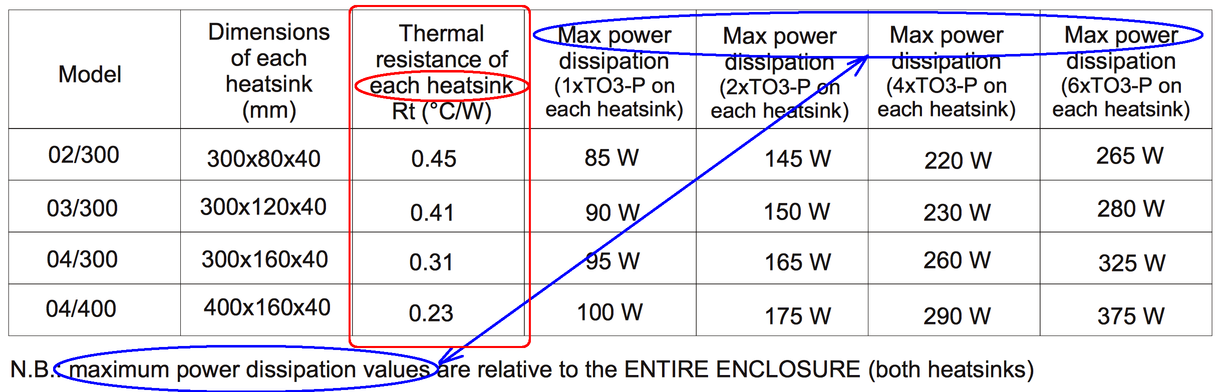

TomIt all depends on how uncomfortably hot you want the heat sinks to get and which operating conditions you intend to operate the amp at.
Math says:
Ambient temp: 25 ºC
Max. heat sink temp: 60 ºC
Supply voltage: ±35 V
Crest factor, music: 14 dB
8 Ω, sine wave: 0.32 K/W
8 Ω, music: 0.46 K/W
4 Ω, sine wave: 0.17 K/W
4 Ω, music: 0.25 K/W
That says you want a 4U Dissipante chassis if you want the amp to be able to handle playing music continuously into a 4 Ω load with the peaks reaching clipping levels without having the heat sink temperature exceed 60 ºC.
Of course this will mean that under normal operating conditions, the heat sink might reach lukewarm if that. I consider that good thermal design, but some builders seem to be disappointed by cool heat sinks. 🙂
I chose 60 ºC max as that's really rather hot to touch. It won't burn you instantly, but don't expect to be able to hold your hand on the heat sink for more than a few seconds at a time at that temperature.
In addition to the user's well-being, one should also consider that the SPiKe protection of the LM3886 will start to kick in at the max output power if the heat sink gets much beyond 65-70 ºC.
I linked to the data sheet for the Dissipante heat sinks back in Post #7.
Tom
The specs for the Dissipante chassis say the rating is for the entire enclosure i.e.
Both heatsinks. I was talking a about a 0.4 K/W heatsink for mono, i.e. For just one channel.

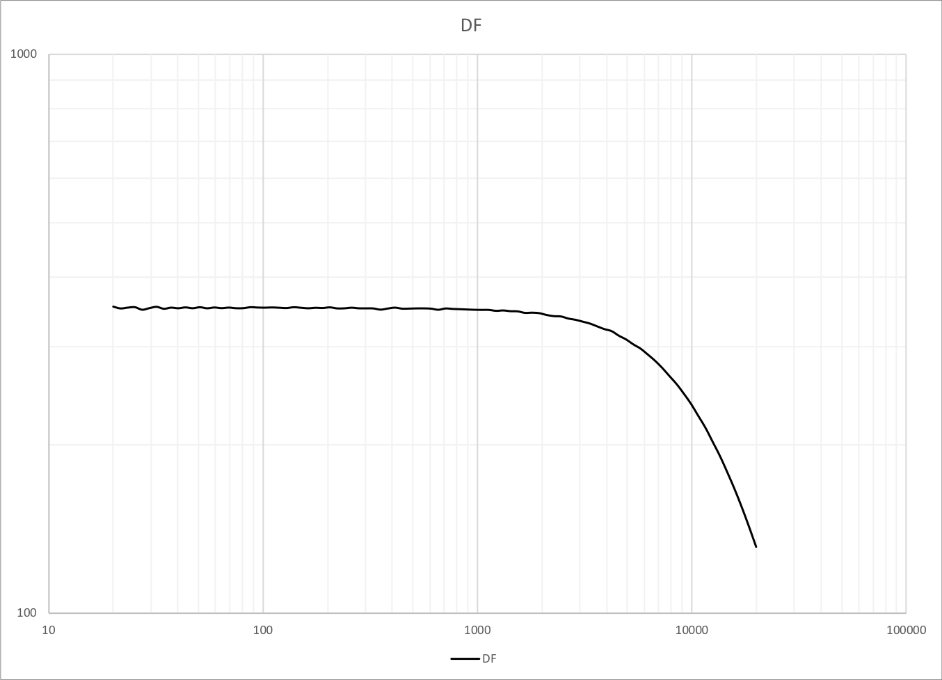

What about the damping factor?
Any figures?
See attached. My guess of 400 was pretty close. Measured value at 20 Hz: DF = 354.
The output impedance starts to rise above the DCR of the output inductors as the loop gain of the amp is decreasing with frequency.

Even with the T version, if you add that layer of insulation, doesn’t it add to thermal resistance as well? Wouldn’t it have a total of similar thermal resistance as the TF version?
Using a thermal pad between the LM3886T and the heat sink will add thermal resistance. The question is whether it adds more thermal resistance than the plastic of the LM3886TF package. That's what I intend to find out.
With a 60 ºC heat sink temperature, I find 40 W of dissipation in the LM3886TF is the maximum I'm willing to tolerate. Math says 46 W dissipation per LM3886TF in the MOD686 at the worst case dissipation driving a sine wave into a 4 Ω load. This indicates that the TF is probably fine for builds intended for music reproduction but will overheat eventually with sine waves.
A perfectly reasonable solution would be to recommend using the TF version and noting that those who really wish to push the thermals can use the T version.
In the end, the choice becomes a matter of how much mounting hassle the builder is willing to accept and how confident the builder is in his/her ability to drill and tap the heat sink without leaving any burrs and chips behind. You don't want to risk having an LM3886 short to the heat sink.
If I can get, say, 220 W into 8 Ω and 350 W into 4 Ω at clipping with the TF, I'd be perfectly content with that.
