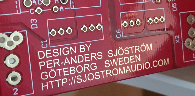

The gold surface is a bit "un-shiny" but I think this comes from the chemical process. Remember that you (normally) have nickel between the copper and the gold. And yes, it's true gold, 24 carat, but an extremely thin layer.
I have always ENIG on my boards just because it's looks nicer but as a side effect it's easier to solder.
BTW: tomchr, your pcb looks wonderful.
Tom,
Regarding the gold platings, is it just on the pads or is it on the traces too? When referring to “gold” are you referring to true gold or the commonly used chemical gold?
All exposed metal surfaces get this gold layer. Personally I write text in the solder mask if there is copper beneath, then I will get text in gold.
That's a neat trick. OSH Park does the same thing. As a Husky (or at least UW graduate), I find it deeply ironic that OSH Park, located in Beaverton, OR, uses the University of Washington purple-and-gold colour scheme. Something tells me that was a conscious choice. 🙂

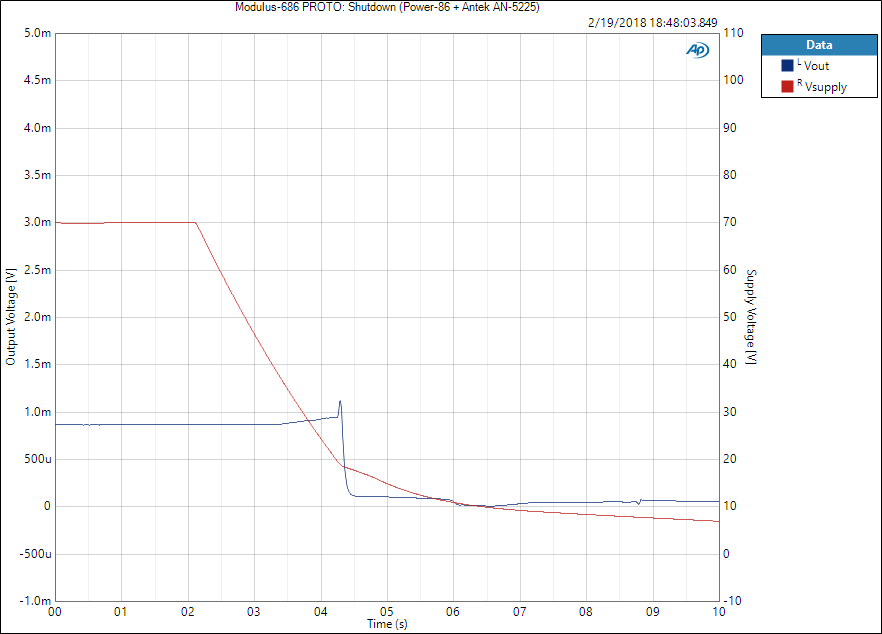

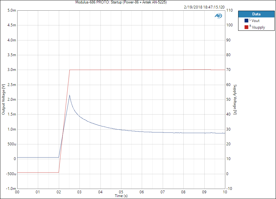

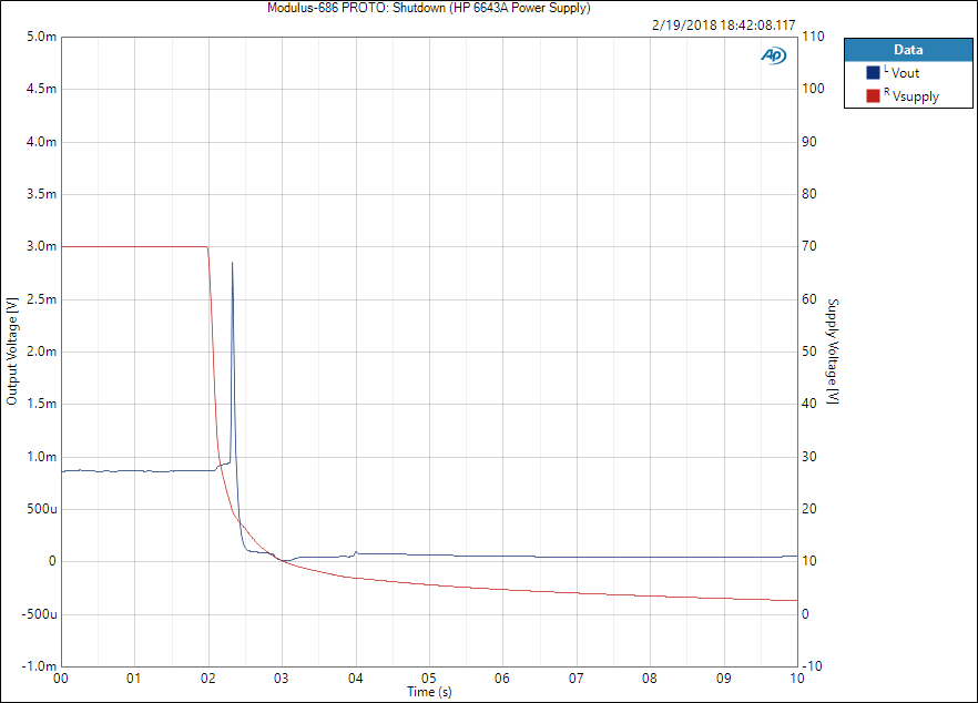

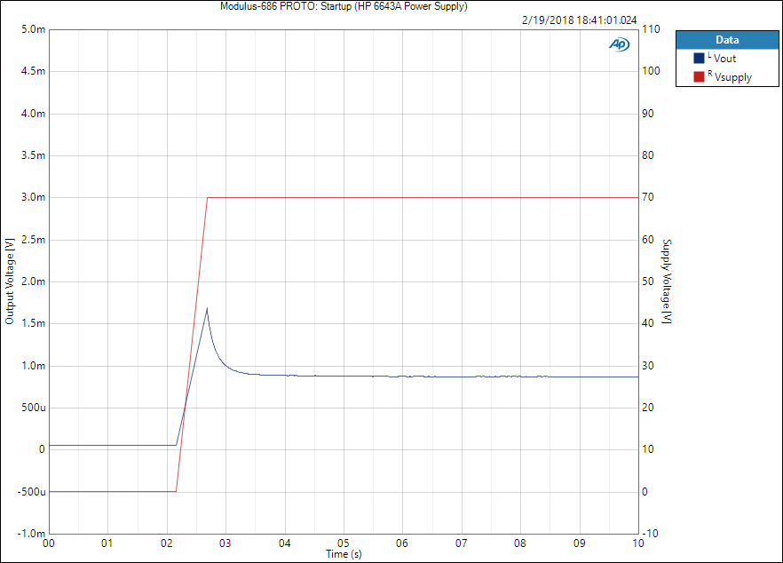

The promised measurements attached. The output voltage is in blue and indicated on the left vertical axis. The supply voltage is in red and plotted against the right vertical axis. The horizontal axis is time in seconds (10-second span). The supply was turned on/off at the 2-second mark. I did this by hand, so my reaction time is included here as well.
The startup and shutdown transients are a few mV for the Modulus-686 prototype. I think it's fair to say that the Modulus-686 starts up and powers down without any audible clicks or pops.
You get a little more of a turn-off transient with the lab supply as it discharges faster when it's turned off. The softer response of the Power-86 and Antek transformer is a bit gentler on the output transient.
Note that we're pretty far down in voltage here. We're talking a few millivolt of pop, max. The 800 uV output offset voltage provides a nice sense of scale. 🙂
I did measure the Modulus-86 Rev. 2.01 for comparison. The turn-on transient of the Modulus-686 is ~30x better than that of the Modulus-86 Rev. 2.0, which is ~2.5x better than Modulus-86 Rev. 1.0.
Told ya I was learnin' an' improvin'... 🙂
Tom
