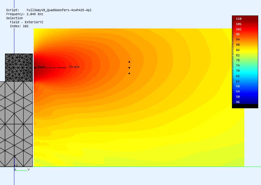

I tried a sim to limit the vertical MF energy hitting the floor. I placed the 2" dome into an impromptu "waveguide" and the speaker is on a carpet. An improvement but I still have some residual floor bounce and diffraction from the woofer edges but it's better. I should try with a proper horn / waveguide and round out the woofer edges.

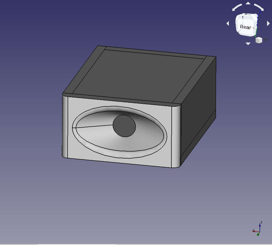

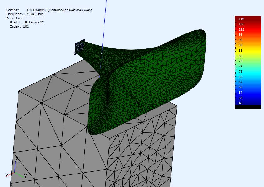

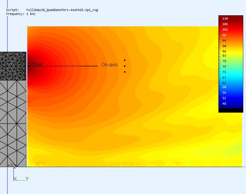

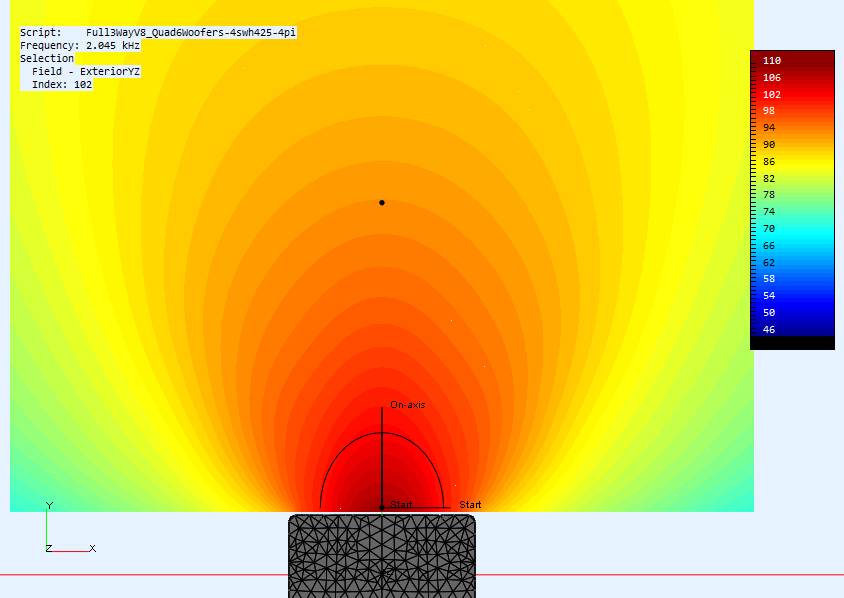

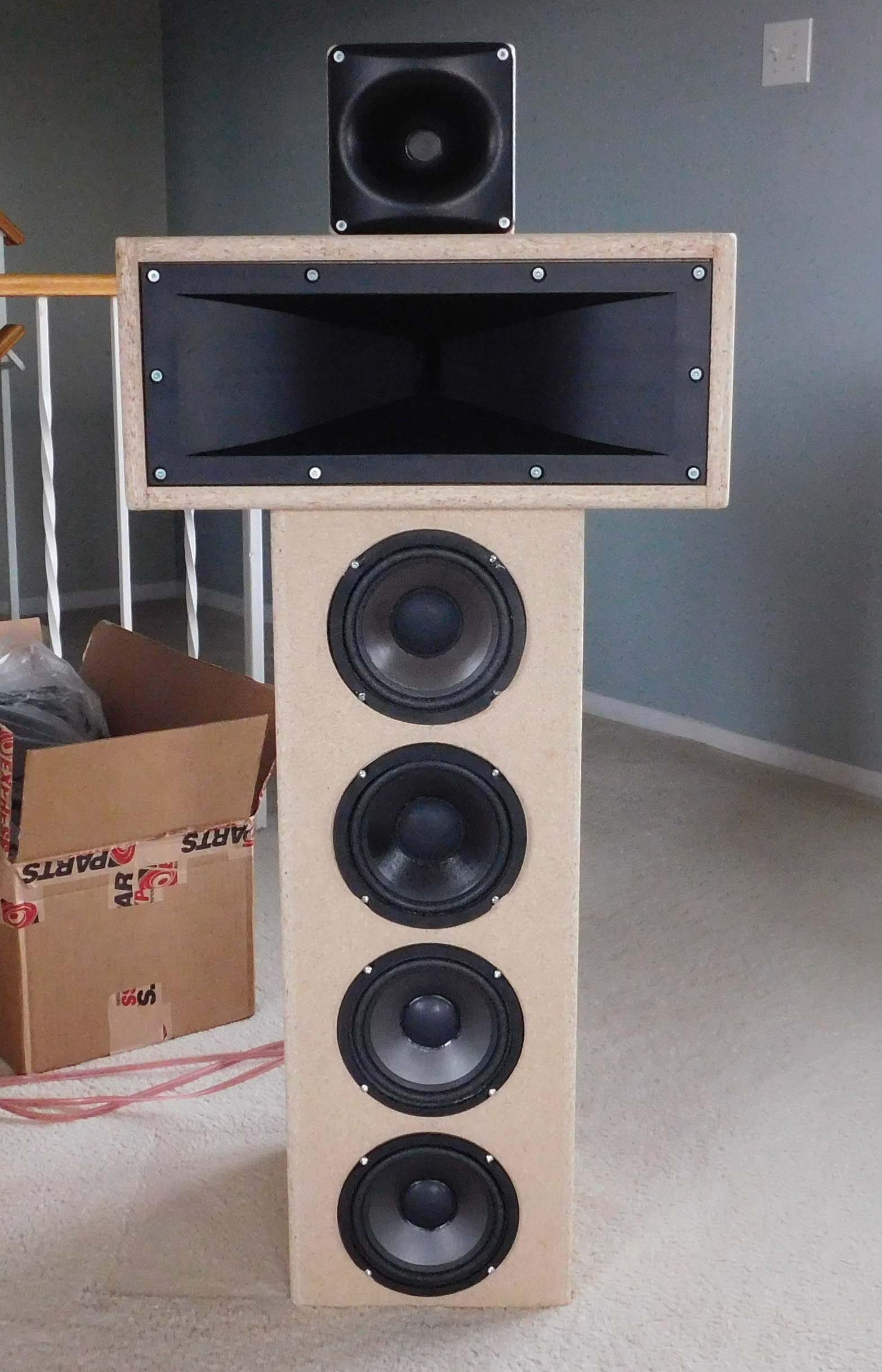

MF horn floor bounce
This sim is with a proper horn.
The horn profile was generated by @docali using the spherical horn calculator DrBA horns at sphericalhorns.net . This spherical horn has fc=425Hz, Lamé exp=8, sin based stretch factor 1.94 and no projection (ie. flat mouth).

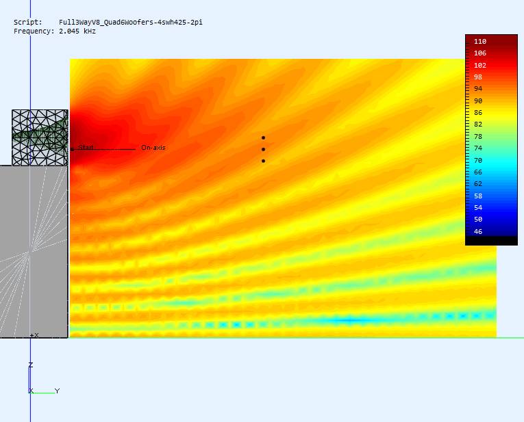

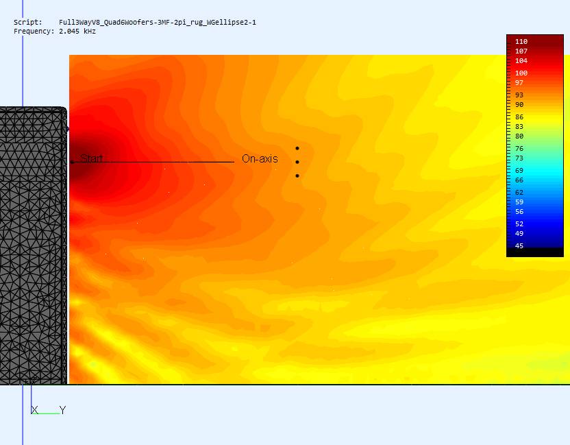

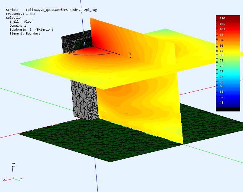

I have mounted the horn in a simple case and elevated it using an ABEC shell cabinet. The replacement woofer cabinet is the same size as the earlier quad woofer cabinet but it's faster to simulate 🙂
Pic#1,2,3,4 shows the horn in 4Pi space, the wavefronts are spherical with some minor effects from the lower cabinet. I would also get the same minor effects from an upper tweeter cabinet.
Pic#5 is 2Pi space (ie. concrete floor) and has floor reflections but maybe the nulls are not as pronounced as before.
Pic#6,7 is 2Pi space with a carpet, and there are subdued reflections but it's the best wavefront so far. At 2m the field is nearly uniform.
Best of all,.... it's starting to look like an Inukshuk 🙂

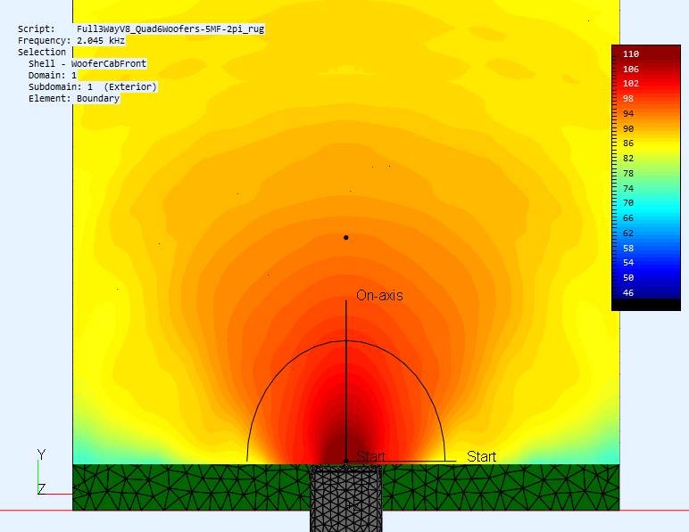

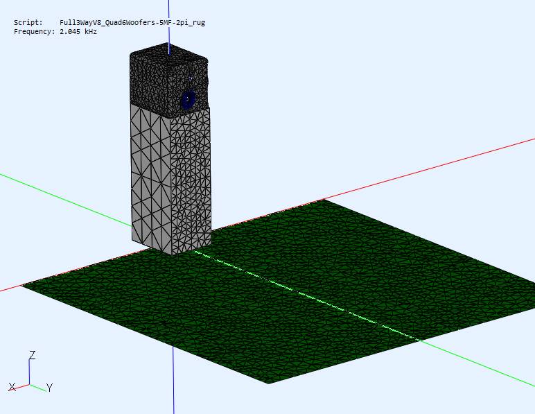

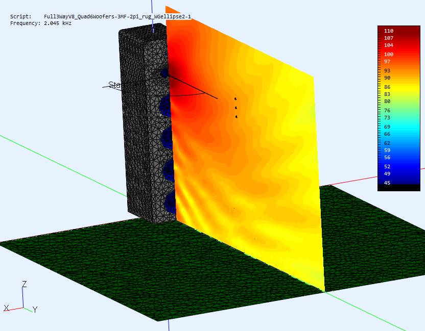

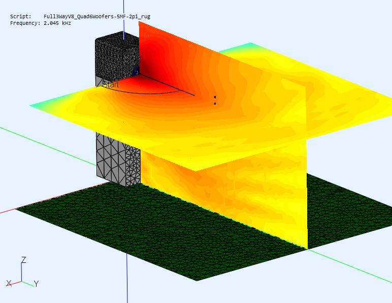

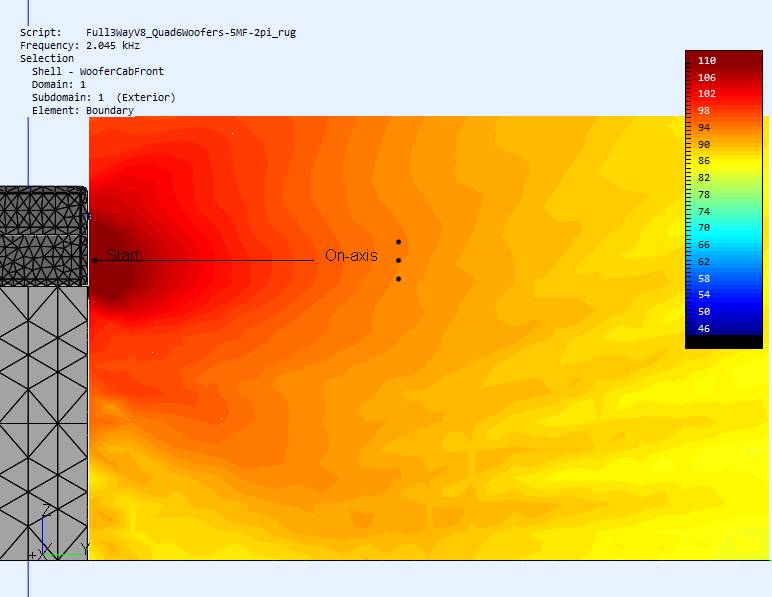

... MF cone and floor bouce
I also tried a 5" midrange cone to see how it performs. It's modeled after Dayton RS125p which is not a strict midrange but it goes high enough and is supplied with enough data to model it.
Although vertically wider than the previous spherical horn, it's narrow compared to a 2" dome. It's not too bad if a rug or carpet is in front of it.
Pic#1 is the model on a carpet.
Pic#2 is the vertical field on a carpet
Pic#3 is the horizontal field showing floor bounce effect

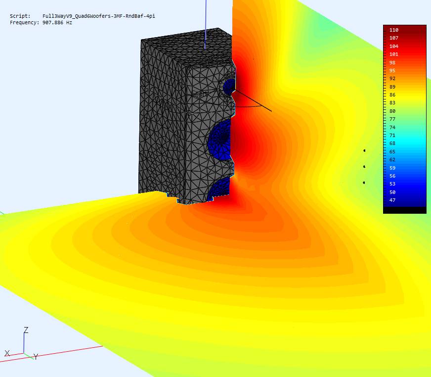

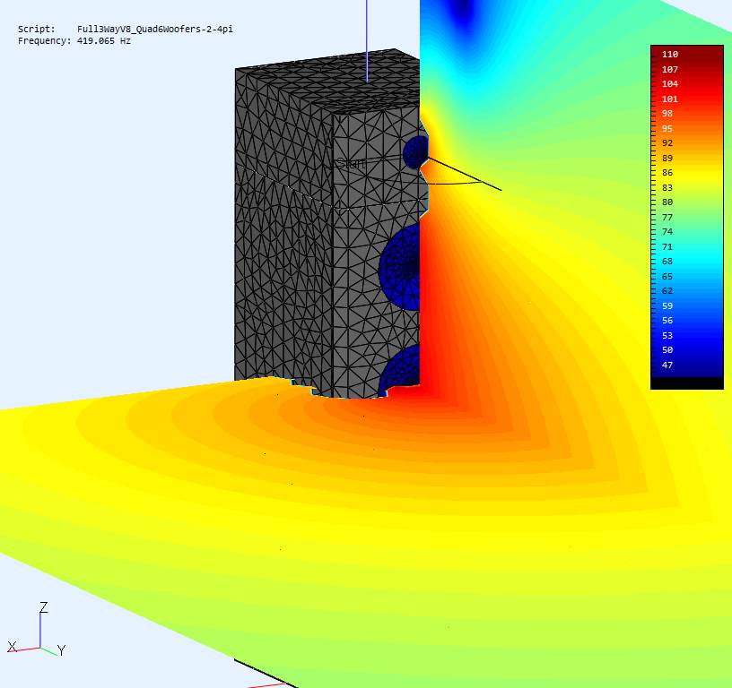

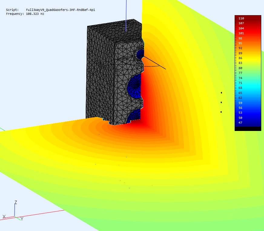

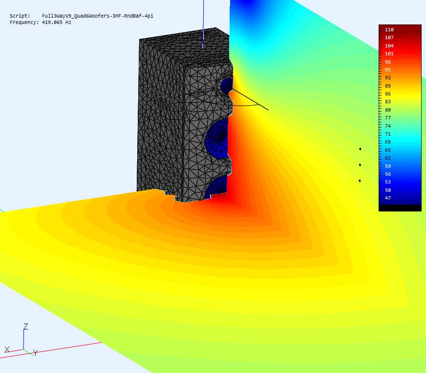

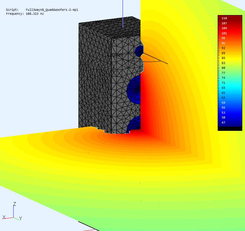

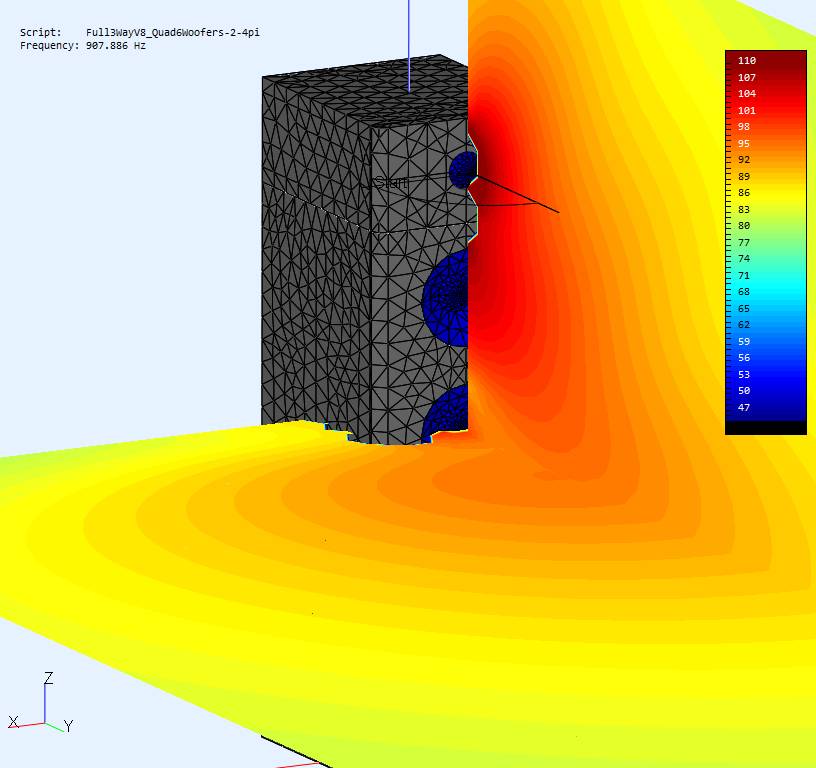

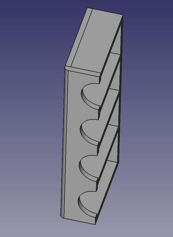

baffle roundness #1
I had a change to look at some of the concepts in the the Magico reference Modular active 3 way - work in progress
The first is my planned woofer stack (4 x 6.5") in a simple box with R-16mm rounding on the box edge. Woofers sit flush with the front. Simulation is in 4Pi space.

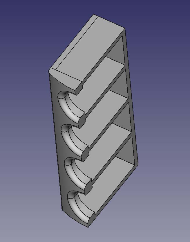

baffle roundness #2
Now applying the industrial design from the Magico to my quad 6.5" woofers stack. These sims are in 4Pi space.
There is a minimal reduction in edge diffraction from the additional rounding. Keep in mind this is for the woofer section and I would not expect much change because the wavelengths are still big.
Interesting, if the woofer is recessed it changes the dispersion (polar) characteristic like a shallow psuedo waveguide. I think mine are exaggerated because I recessed them 2-2.5cm from the curved baffle. This narrowing is starting to show at 900Hz which is probably high for a typical 3-way's woofer.

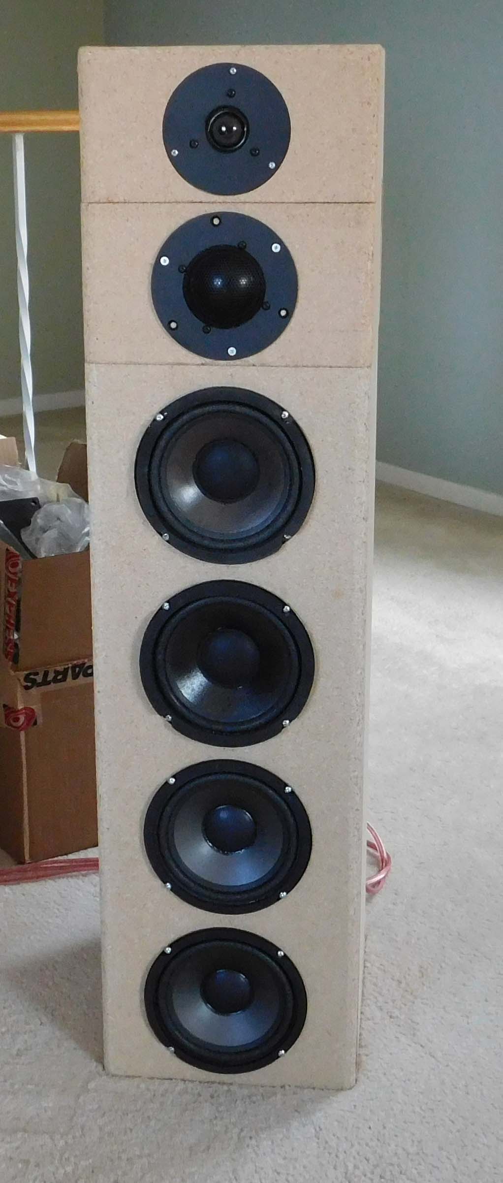

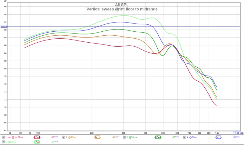

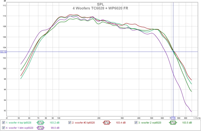

Quad woofers
I build the quad woofer cabinet, based on the sim from Modular active 3 way - work in progress to see I could tell the difference with less mid bass floor bounce.
The woofers were tested (pic#2) separately in their 9L chambers. These are still budget woofers (TC6028, WP6020) and the 9L chamber results in Qtc=0.9 which is higher than I'd like but fits the space I wanted to put it in. The consequence is a sloped FR which I will EQ out later. One of the woofers has a small problem with voice coil friction (minor sticking). It was mostly freed up after exercising it but still has reduced bandwidth.
A vertical stepped FR sweep (pic#3) was measured at 1m distance, indoors and on a rug, with gating 2/10ms. It basically shows what the simulation indicated. The midbass is fairly even but louder as you get near the floor. You can also tell its more even as you move around. Now for some listening. 🙂
Inukshuk
The short woofer stack provides very even and clean bass and mid-bass in the room.
Now for the mid and high treatments using horns "like" the sim in Modular active 3 way - work in progress The tweeter is a Fane-CD130 + Dayton H07E and the midrange is PRV-D290PyB + B52-SH402. The SH402 is cheap and goes low enough to try for this experiment. I would prefer a midrange horn shaped more like the H07E.
It's eq'd for the FR flatish sloped and the voice coils are nearly aligned by shifting the boxes.

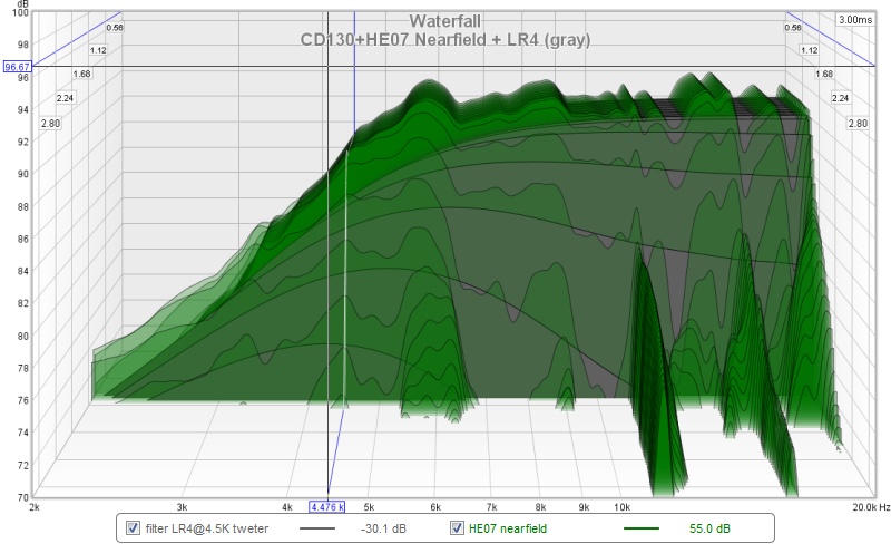

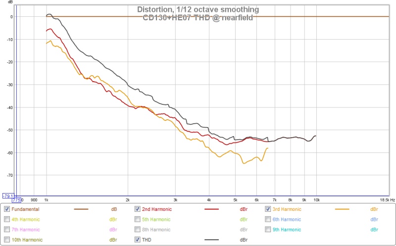

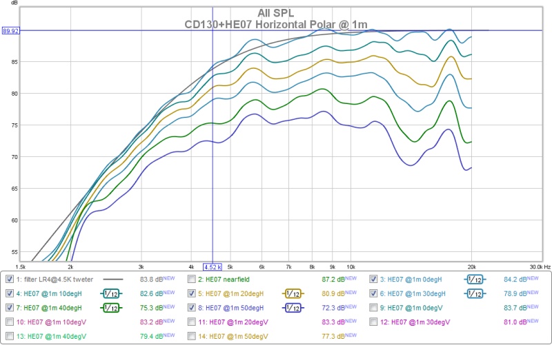

HF horn tests - FaneCD130 + Dayton H07E
These are some measurements for the Fane CD130 with Dayton H07E horn. I wanted to compare them to the previous tweeters I measured.
The CSD waterfall has the ideal LR4 filter (grey) included for comparison. I have some resonance points at [11.4K, 16K, 19.9KHz] . Not sure if they are from driver's titanium diaphragm or the plastic ringing. I don't notice them when listening. I'll probably investigate later.
The horn is advertised 80x50deg and my measurements (0-50deg, 10deg step) tend to agree. My tests were indoors gated [-1,3ms] and taken with no baffle around the H07E horn as shown.
It sounds very clean and detailed.
