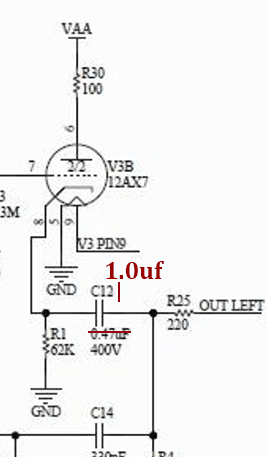

So, what options could I use to alleviate the problem other than a larger capacitor?I don't know whether or not the schematic is an accurate representation of the PCB layout. Assuming it is...

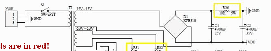

That looks like pin 9 is grounded to 0V signal ground. I see no voltage divider for lifting the ground of the heater supply. I think that's referenced to 0V.
The schematic for the heater supply...
...shows a "15V - 15V" winding that is not center tapped. What does that mean? I don't know. I assume it's a 15VAC secondary. Assuming that's correct, D1 will rectify that to about 19V DC. It looks like that's grounded on the positive side, so that means it's a -19V DC supply, with the voltage drop from 10R 5W (R26) subtracted. With three 12A*7 tubes' heaters as the load, that's 0,45A, so 19V - 4.5V = 14.5V DC on the heaters? Maybe there are more losses than that. It could be that the raw voltage is only 17V so the final DC voltage comes out to -12.5V. Let's assume that's correct.
1. The DC heater supply is grounded on one side. No center tap. That will increase the chances of hum from the heater supply. Since it's grounded on the DC side, you do not want to ground it again on the AC side, so you can't put in a voltage divider to balance the secondary.
2. There's not a lot of ripple filtering on the heater supply. 10 ohms * 4700uF, and just one stage of RC after the reservoir cap.
3. It could be that the hum is coming from the heater supply. I've never had good luck with a simple rectified DC supply like that. I either go with AC heaters or a decent regulator (LM317, 7812, LT1085, etc.). Unfortunately, the designers of this product spent their money on a 10R 5W resistor instead of a voltage regulator IC. Wouldn't that have cost about the same?
Maybe increasing the value of C2 would help. It could be 10,000uF 25V. But that might not be enough. I have my doubts, but I certainly don't know for sure.

Do you think a 10000uf or 22000uf capacitor in C2s position would possibly help the poor filtering?I don't know whether or not the schematic is an accurate representation of the PCB layout. Assuming it is...
Yes, more capacitance would filter more 60Hz and 120Hz hum from the heater supply. But would it be enough? I don't know.
As I wrote, I've never had a good experience trying to get a quiet DC heater supply without regulating it.
What is the DC voltage at the negative terminal of C1 (in the power supply schematic)?
What is the DC voltage at VDD?
I’ll check sometime today and get back to you. Remember, I had a bad c2 cap originally out of the box. I replaced both caps with like value.

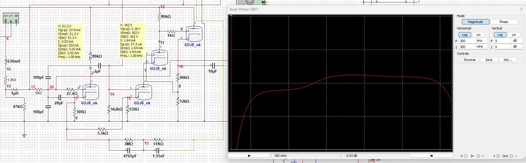

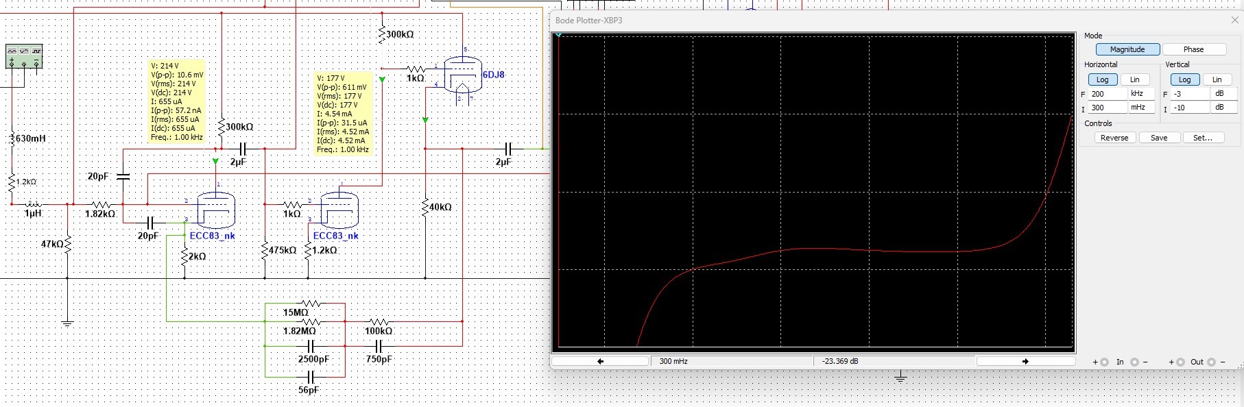

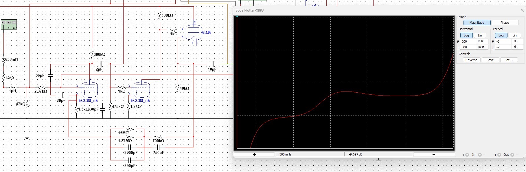

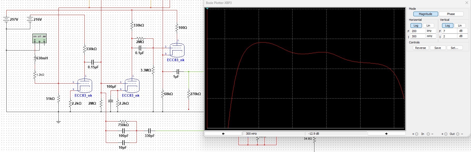

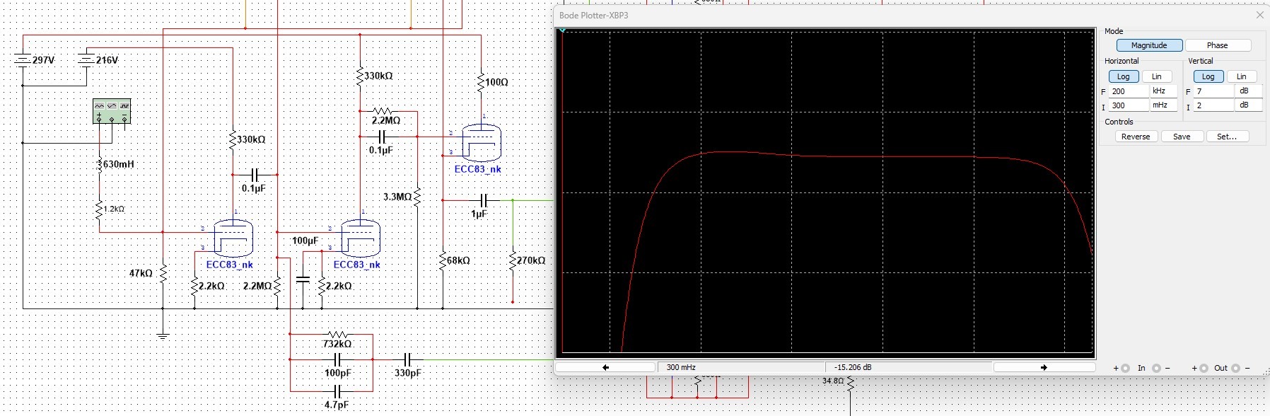

Since I already simulated EAR834P in Multisim I couldn't resist to for Little Bear too.
First picture Little Bear 1,4dB diff
Second picture EAR834P original 0,8dB diff
Third a linearized EAR834P 0,2dB diff

Just for comparison...
First picture: Audio Research SP6C (7,8dB down to standard RIAA, diff 0,3dB)
Second picture Audio Research SP8 (5dB down to standard RIAA, diff 0,7dB)
Third picture: Audio Research SP10C (2,8dB up to standard RIAA, diff 0,5dB)
SP10C are here simulated with half the count of tubes and RIAA network adjusted accordingly.
SP10 have parallelled tubes in all places.

The measured voltage at C1 was 18v. All three tubes measured about 6.03 v. I got impatient and replaced C2 with a 10,000 uf capacitor. This dropped the dc voltage to around 17.8v. All three tubes measured about 5.95v. This did drop the amount of hum considerably. I’m going to connect to my turntable and amp sometime today.Yes, more capacitance would filter more 60Hz and 120Hz hum from the heater supply. But would it be enough? I don't know.

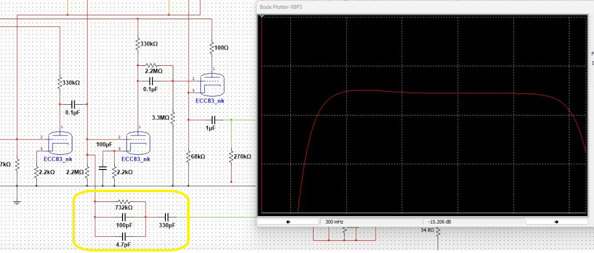

From post #73
This looks the best to me:
732k resistors are available (e.g., https://www.digikey.com/en/products/detail/yageo/MFR-25FBF52-732K/13688)
If you want to use resistors you already have,
You can put a 680k and a 51k resistor in series to get 731k, which would be plenty close enough.
Or series up a 511k and 221k to get 732k.
Note that the 10pF cap is changed to 4.7pF.
