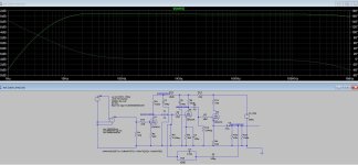

I was curious about this inexpensive phono preamp, so I took the schematic and simulated it in LTspice. There's something I want to show you.

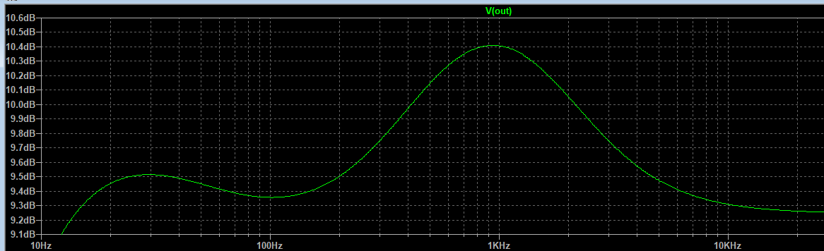

With the parts values as shown, this is the frequency response the simulation predicts (into a 50k ohm load):
The response is a full +1dB at 1kHz compared to at 100Hz and 10kHz. You'll definitely hear that, and it might not sound good with some kinds of music. I wonder if the simulation is close to reality. If it is, this could definitely be improved. So...

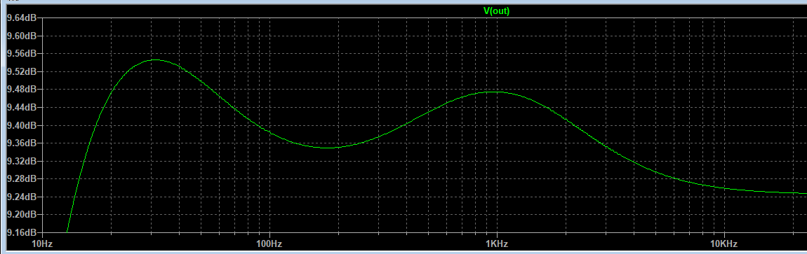

I changed R29 from 910k to 750k ohms, and this is what the simulation predicts:
Notice the big difference in the scale (in dB) on the y axis. The frequency response is now within -0.25dB of the output at 1kHz across the audio band.
It's just a simulation, but the difference is pretty big.

Interesting as the EAR834 uses a 750k in that position and I wondered if that needed to be changed but I didn't want to spend any more time on it. Looks like changing that to 750K might be worth trying.

Definitely. All three time constants are wrong with 910k. They're a lot closer with 750k, although these designs that rely on limited gain can never be very accurate at frequencies below 500.5Hz.Interesting as the EAR834 uses a 750k in that position and I wondered if that needed to be changed but I didn't want to spend any more time on it. Looks like changing that to 750K might be worth trying.

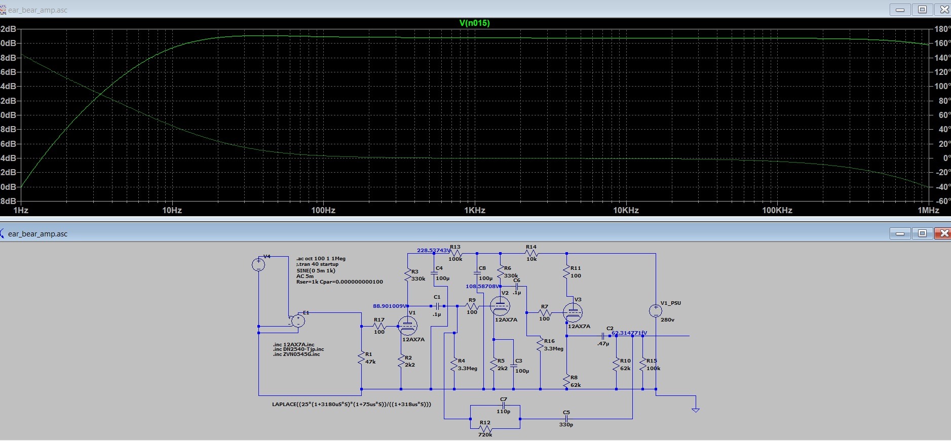

Here is a simulation using 720k in the RIAA feedback loop. Using higher values ends up in a 1kHz bump. I actually measured the RIAA and it came up quite flat with these values. Note - the second RIAA feedback 110pF capacitor is really critical. If you mount it on a circuit board, consider that the board itself may have a few pF capacitance as well. Higher values for this second RIAA cap reduce frequencies above 1kHz.

Attached is the circuit as modified (mostly) but with 720k in the RIAA feedback loop.
True. To get the most accurate values, a measurement using an inverse-RIAA network is needed. Also, in the original schematic the input valve especially runs at a somewhat low plate voltage. This means the user will discover quite different sonic variations when changing that 1st valve with other manufacturer samples, etc. The RIAA correction also relies on the plate resistance of the 12ax7....

It’s not just component values. To get an accurate curve, a parallel resistor is needed, and much more open loop gain. Without that the curve can never be right. It is algebraically impossible for this circuit to deliver accurate RIAA.
Right, I noticed that the first stage 12AX7 runs at very low plate voltage and plate current. That means gm will be low, rp will be high. There's also cathode degenerative feedback, which reduces gain, which reduces Miller effect capacitance (which is a good thing) but PSRR of that first stage will be degraded (a not so good thing). Lots of interesting compromises made in this circuit.
6N2P has lower Cp-g than 12AX7, which means that first stage could be made to have lower input capacitance. That would help it work with less of a resonant bump in the treble from modern MM carts and SUTs. I made a 12AX7 preamp and found it was pretty sensitive to what cartridge was driving it. The Audio Technica MM carts I like don't like being loaded with 300pF or more of parallel C (Ccable plus Cmiller from the 12AX7 input stage).
In the feedback loop, you could put a 680k and a 39k resistor in series to get 719k ohms, which would be about ideal. Reduce the value of the 39k to introduce a midrange scoop around 1kHz.

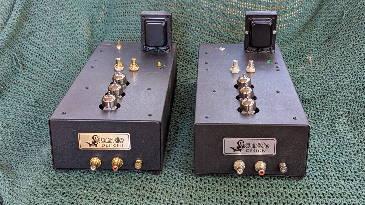

I love the sound of mine. I build mine using the black and gold Zhili Audio boards found on ebay. Yeah it does have a bit of bass boost, but IMHO most vinyl sounds better with a big of bass boost. I use short cables and drive high impedance tube amps so the 12AX7 follower is fine, but it will struggle with low impedance amps. It does have a lot of gain, which I don't mind either. I also don't mind if changing the brand/type of tube (mainly the 1st tube) changes the sonic signature a bit, allows for tuning to your taste/system.

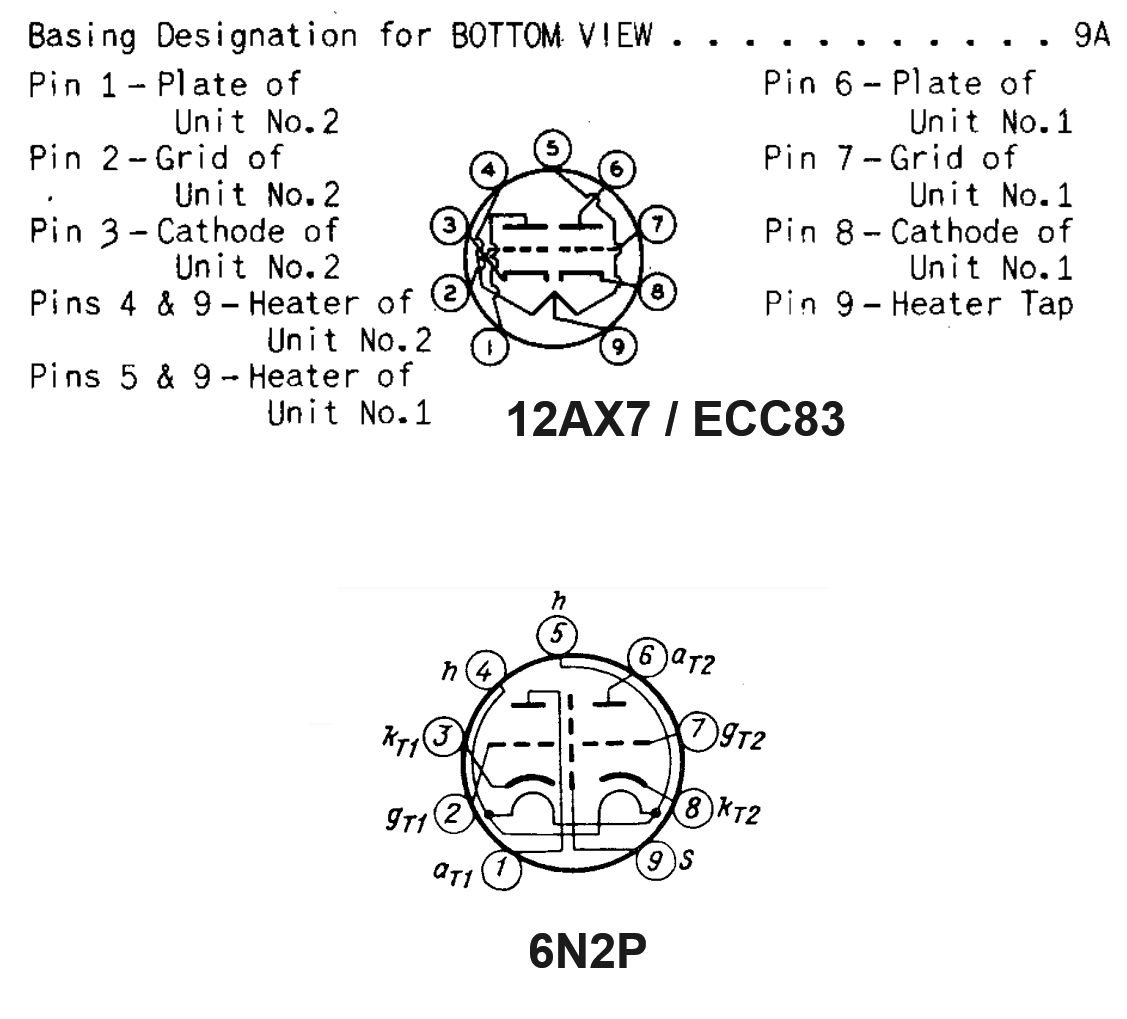

Okay, what happens when a 6n2p is used? There is no center tap heater wiring on that tube.Check that the heater windings oming from the transformer have a grounded center tap, either a direct wire or a pair of 100R resistors to ground.
Read up on ValveWizard
With 6.3V heater supply:
- for 12AX7, pins 4 and 5 are shorted (+6.3VDC goes to that), pin 9 goes to ground. (No shield)
- for 6N2P, pin 4 goes to 6.3V, pin 5 goes to ground, pin 9 is the shield and can go to chassis or 0V signal ground.
Where you see the word 'ground' in the above, that will be at the junction of the voltage divider resistors (at +76V). Make sure the bottom resistor of the voltage divider is fully bypassed by a capacitor.
The internal shield in the 6N2P needs to be connected correctly. If it is connected correctly, it should provide some shielding between triode sections, so perhaps better channel separation (less crosstalk) and maybe a bit lower hum.

I was referring to the windings from the transformer. There must be a reference to Ground in the heater supply, unless it's Elevated, in which case the DC voltage will be applied at the center-tap.Okay, what happens when a 6n2p is used? There is no center tap heater wiring on that tube.
And the shield (Pin 9) is more useful when the tube is used as a composite gain stage, where the cathodes may sit apart by dozens (or hundreds) of volts.
