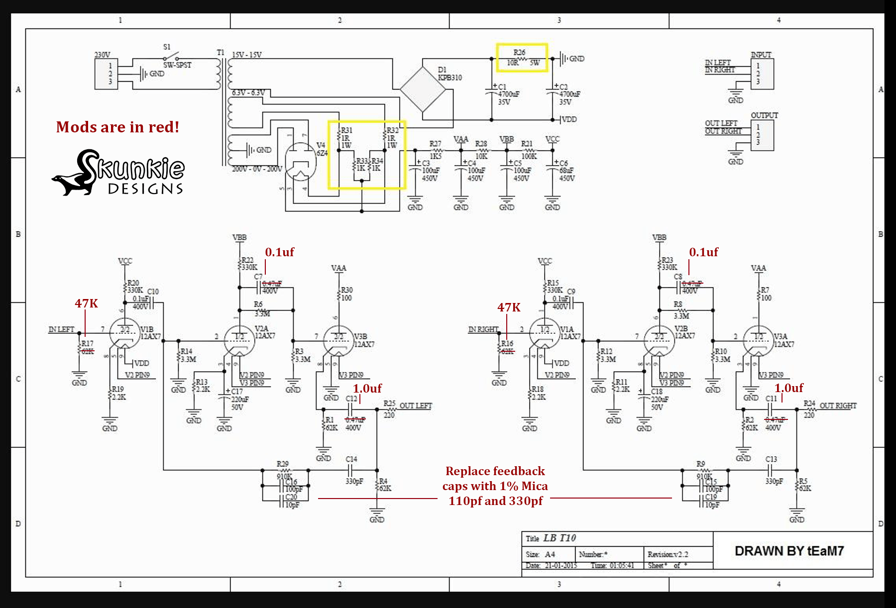

It looks like emulating the EAR834 RIAA using a 750K resistor along with a 110pf and 330pf is a step in the right direction. I personally like the bass bump this curve (and the EAR834 clone itself) has, but if that bothers you, lower the 750K down to 732 with a 105pf appears to flatten it some. I do like the sound of mica caps in this network.
Also in my experience sometimes what looks best doesn't always sound best, especially from a sim, so I would experiment and listen.
From post #73
This looks the best to me:
732k resistors are available (e.g., https://www.digikey.com/en/products/detail/yageo/MFR-25FBF52-732K/13688)
If you want to use resistors you already have,
You can put a 680k and a 51k resistor in series to get 731k, which would be plenty close enough.
Or series up a 511k and 221k to get 732k.
Note that the 10pF cap is changed to 4.7pF.

If one have bought the Little Bear kit there are a few more parts to change than just adjusting the RIAA feedback circutry.
Some more important than others. Output cap can be changed to something bigger if output have a lower resistance load.
Bass rolloff is set by the 0.1uF so output cap can be increase quite much without effecting RIAA tracking.
732kOhm is a standard value in E96 series which most supplier have.
Same if you go with the original EAR834P emulation. More than just the 750kOhm resistor that needs to be changed.

Just out of curiosity, when you did these simulations and looked at their frequency responses, did you apply a load to the circuit? I look at the circuit with a load on it of 10k (simulating contemporary solid state amp volume controls), 50k (simulating older solid state amps), and 100k (simulating tube line amp volume controls). The low end is going to be different with all of those, so either one needs to optimize the circuit for the particular load to be expected, or massage the circuit values to work well enough for any load the preamp is likely to see.
Also, in simulation at least, increasing the output cap (1uF) to 4.7uF actually reduced the output from below 20Hz up to about 100Hz. It looks like the output cap, being inside the feedback loop, influences how much gain there is available for feedback. That makes this a pretty touchy circuit. Changing parts values seems to change the response quite a bit. That's not usually considered a positive attribute, because it implies that varying tube parameters will also change the response quite a bit. The frequency response is likely to change as the tubes age.
I came up with these changes. The response looks like it should stay the same into 10k, 50k and 100k ohm loads, with only a slight drop in output into 10k. There's a small bump in the low bass centered around 35Hz, but the forecasted response there is only +0.15dB above the output at 1kHz. Otherwise the response is forecasted to be very flat (+0.05dB at 100Hz, then within 0.01dB from 200Hz to above 20kHz). Of course the frequency response of the cartridge will change that, and the Miller capacitance of the input stage will also change the frequency response a bit. The input stage 12AX7 is not inside the feedback loop, so its Cmiller will be that of an unbypassed 12AX7, about 100pF or so, in addition to any tonearm cable and input wiring capacitances.

@rongon
Yes, I loaded them according to schematics.
62K for Little bear
270K for original EAR834P
270K for my adjusted version.
And yes it's easy to change a bit here and there to get a better result during simulation.
ECC81 is also a better cathode follower for this circuit since it can handle more current. Not much of difference in sonic signature between ECC83 and ECC81 cathode follower.
Thus it should be no problem to load it with 100K instead of 270K as the original.
Less change in frequency response once connected to a preamp.
Select output cap size accordingly.
I would select a preamp with no less than 50kohm input impedance to not stress to much.
I fetched up the circuitry of my audio friends EAR834P and he had his modified from 1uF to 2,2uF for output cap and let the 270kohm fixed load remain.
Your curve seems dramatic, but it's actually just a 0,15 dB rise at 20 Hz.
A rise at 20 Hz of 1 dB or so will probably not be detected.
Linearity from 50-20000 Hz is where linearity matters most, so getting inside +/-1dB at 20 Hz is in my eyes good enough.
50-20000 Hz I would aim for as linear as possible but would be very satisfied with +/-0,25dB in real life.

The graph I posted is really zoomed in. Each horizontal line is only a 0.02dB step. The entire graph is well within 0.5dB.
By varied loads I meant the volume control you're likely to find on the input of the line stage after the phono preamp. That volume control's input impedance will appear in parallel with the pulldown resistor on the output of the phono preamp, which means it doesn't matter much what value that pulldown resistor is, the volume control's input impedance will likely define the load. Like in this input stage for an SE power amp I scrounged off the innerwebs:
The input impedance of that volume control will be 100k ohms, which will be the load presented to the phono preamp driving it.
That 100k ohm input impedance will be in parallel with the value of the pulldown resistor on the output of the source preamp.
If there's a 62k ohm pulldown resistor, and the input impedance of the load (driven stage) is 100k ohms, that will make the load on the phono preamp's output those two in parallel, or 62k*100k/62k+100k = 38.3k ohms.
If that volume control was only 5k ohms (as in some class D amps these days), that would be 62k*5k/62k+5k = 4.63k ohms
That's an 8 to 1 difference!
A 12AX7 cathode follower will have an output impedance of something like 1k ohms. The 220R build out resistor (on the output of the preamp) will add to that, so the Zout is 1250 ohms.
Into a class D amp with 5k ohm input impedance (yes, some are that low), that means the 12AX7 cathode follower is running into a load that's less than a 4:1 load:source impedance ratio. We'd like to see 10:1, so that 5k volume control is going to load down the 12AX7 cathode follower quite a bit.
A 12AT7 cathode follower will have an output impedance of somewhere around 250 ohms. Add the 220R build out resistance to that and the Zout is still less than 500 ohms. That will still get us close to our desired 10:1 load:source ratio even into that really low 5k ohm volume control.
That's why I like the idea of a 12AT7 cathode follower on the output, and why the pulldown resistor should be fairly large (if possible).
That's also why the output cap should be a higher value than 1uF, but that's a simple frequency response issue, which is a different matter.
Please feel free to critique my thinking here, and let us know if I'm misguided. Thanks.

No critique from my side 🙂
You have the necessary knowledge to make your own choices of design.
Regarding output cap, I would spend my money on a really good 2,2uF foil capacitor instead of a metallized 5-10uF capacitor even if it cut of deepest bass half a dB or so.
This circuit deserves good caps and resistors.

Completed the skunkie mods last night with a 750k resistor and quality mica caps. The difference is very significant and in my case has turned this little preamp into really something special.
There is a significant bass boost - I've completely removed my sub from my 2 channel setup). Mids are more forward (the way I like it) and highs more detailed and airy. I was about to start a 834 build, but no longer need to.
