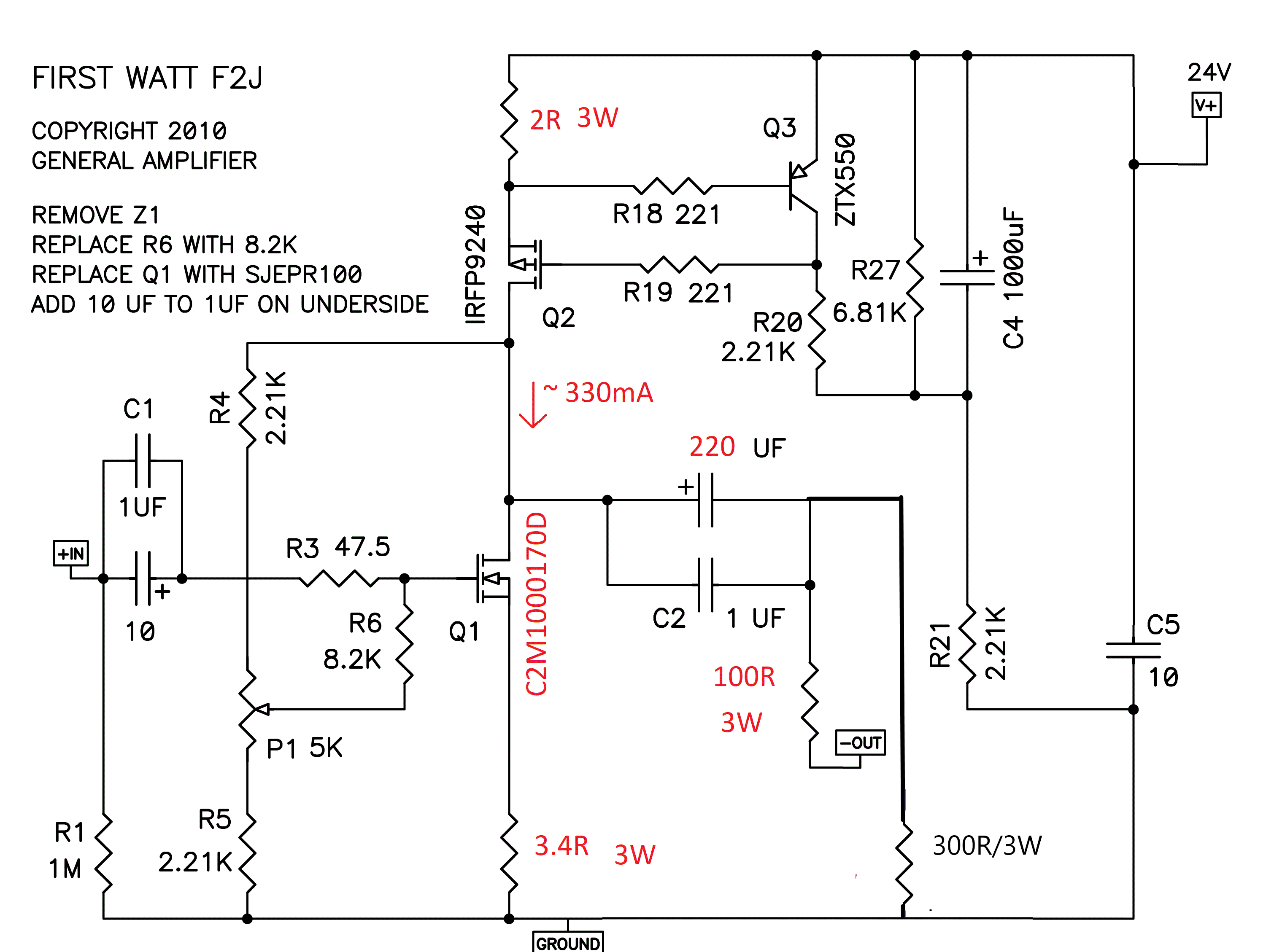

use whatever you want (gnd or rail ) as common ....... bleeder is always connected between hot and cold contacts of output terminal , practically in parallel to load ....... headphones in this case
Now I ´m using a Nichicon UKA 2200uF. In this case the Nichicon UKA has a leakage current of 4uA
With 330r offset is arround 1.62Vdc (-Out and positive rail as common). With 220R arround 1Vdc. I´m not sure if I´ll continue to decrease this value since I am affecting the output frequency. I'm wrong?
How should I calculate the value of the bleeding resistor?

1V6 through 330R is bloody big 4.9mA , not uA
something is wrong with your measurements , not with construction or cap itself

OK, I have finally decided to use ground as common. I´m not sure why it does not work having B + as common 😕
I changed bleeding resistance (300r) from B + to ground and yes, here it´s work. I have just about 20~0mVdc offset.
I think that the final layout is this:

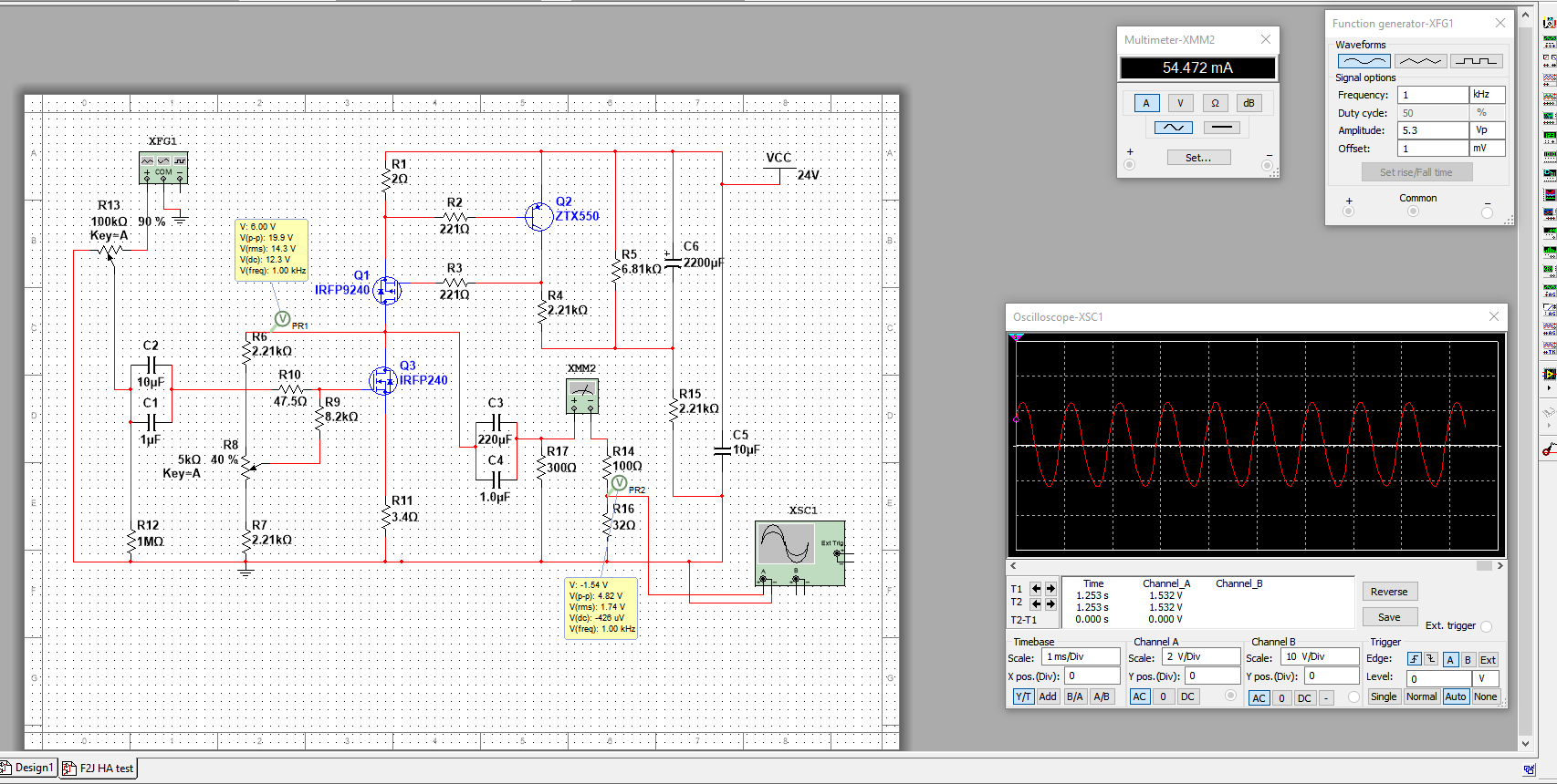

Second channel is working now. Same configuration (ground as common), Bias 12,6Vdc and 0Vdc offset.
Transistors are a bit hot so I need to use a box with not very large heatsinks.
I´m listening music with my headphones for test and all is correct, nice sound and total silence!! I want to try it with low capacitance and low sensibility headphones. 😎😎
I'm surprised at how well the C2M1000170D works. I had already used it in other designs but I had my doubts about using it here.
I have had both channels working all night. I used my radio (Does anyone still listen to FM?) and a 10K volumen pot with my test headphones (35 Ohm): Bias is totally stable and the temperatura is about 30 ~ 35º using a small heatsink.
I need some days to test it properly but my goal was to use this amp with headphones and now I´m thinking in adding some terminals and test monitors.
The only thing that will limit me is the power of the transformer. I am using right now (T80VA 0-18v X2).

it is working good but the transconductance of C2M1000170D is only 0.8!
Yes, that's why I had my doubts, but it works... at least with headphones. 😉😉
Without 100r on the output the amp is better. I checked arround 1.4W with a 20r heaphones (I use a simple 10K pot like preamp).
It only has one problem, without the 100r I can hear a very low "fffffff" that I identify with the background sound of the amplifier ¿?

I am a but confused.
So is it a F2, or a Zen V9 ?
Zen V9 is about using the LU1014 in a triode cell.

Sorry Patrick, I tried to fix the post at the time but I could not edit. It is an F2
