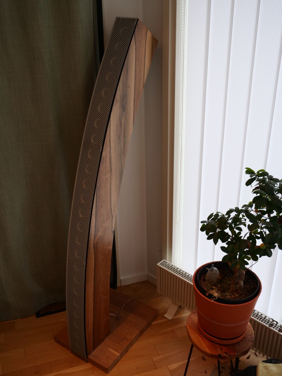

I dont really wish to put them on the sides of the arrays due to the windows in my listening room 🙂
Oh, that makes sense. In that case, just stick them behind. You probably won't go very low with those so your enclosures won't be large. You could design them to compliment your curved CBTs. If you want lower and larger subs place them somewhere else because it won't matter.

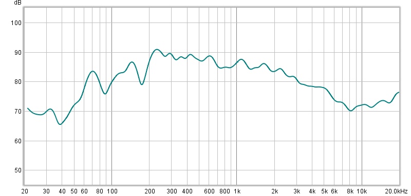

Oh boy what a difference some equalizing did. I was happy with the sound before, but after doing a first measurement and letting REW create a filter to flatten the response I am now floored!

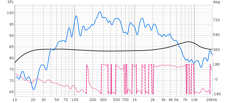

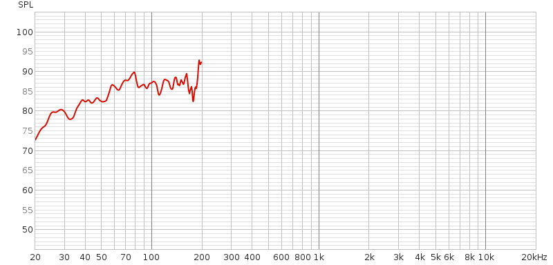

Here is the frequency vs spl graph I measured for my first try using REW (1/6 smoothing applied).

Did you finish your subwoofers yet? Did you place them behind the arrays or in a different configuration?
Your arrays are beautiful, btw.

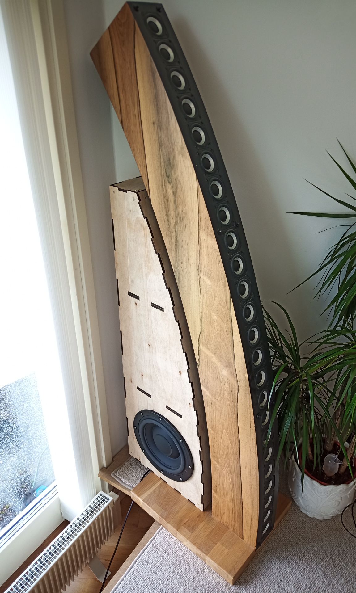

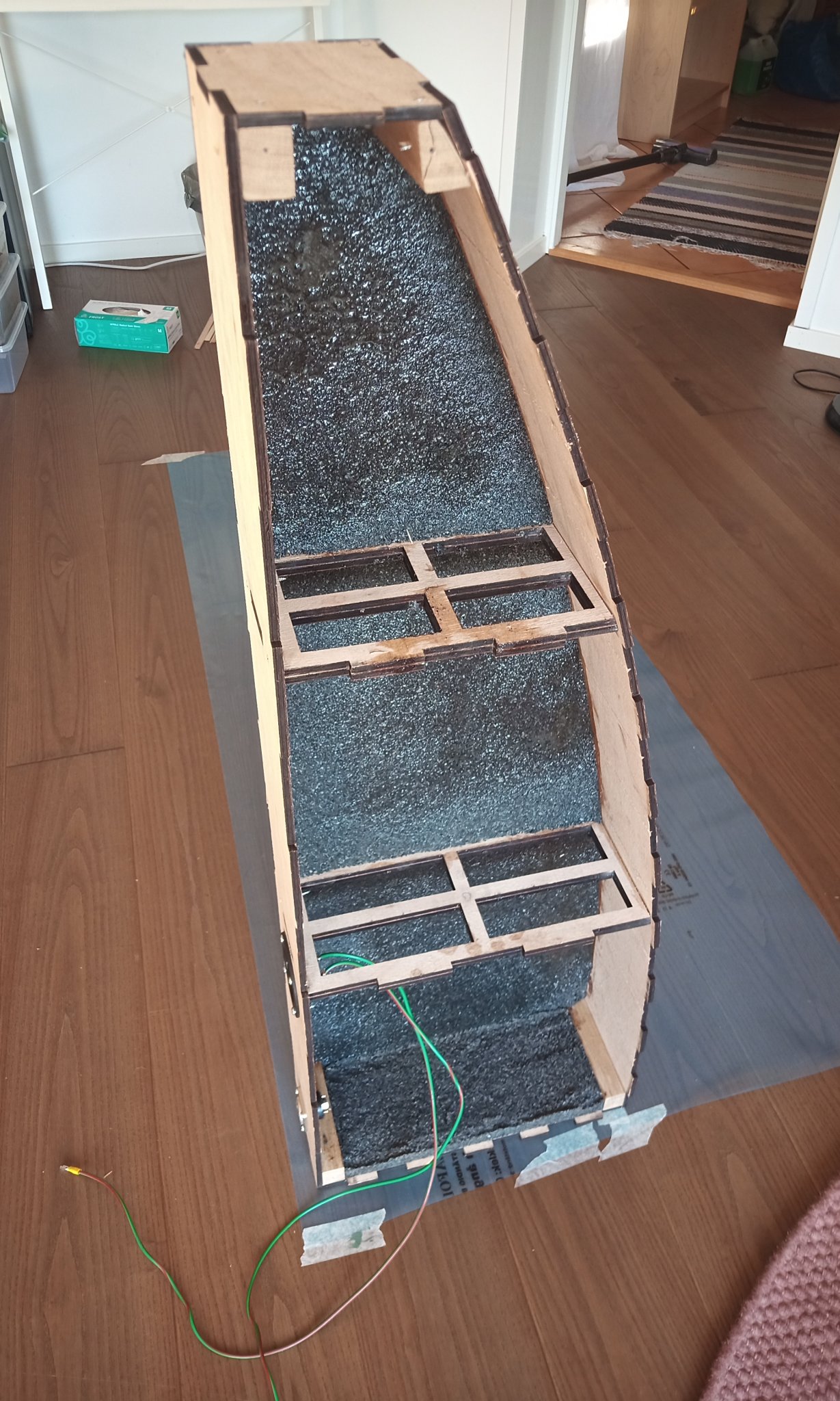

Not yet I'm sorry to say, but I have finally started building them, sealed box, 43 liter internal volume. I need to make them more stable, I made a quick first box from what material I had on hand but it flexes way too much. But now that I have gotten a first iteration built I think I will make progress quite a bit quicker^^

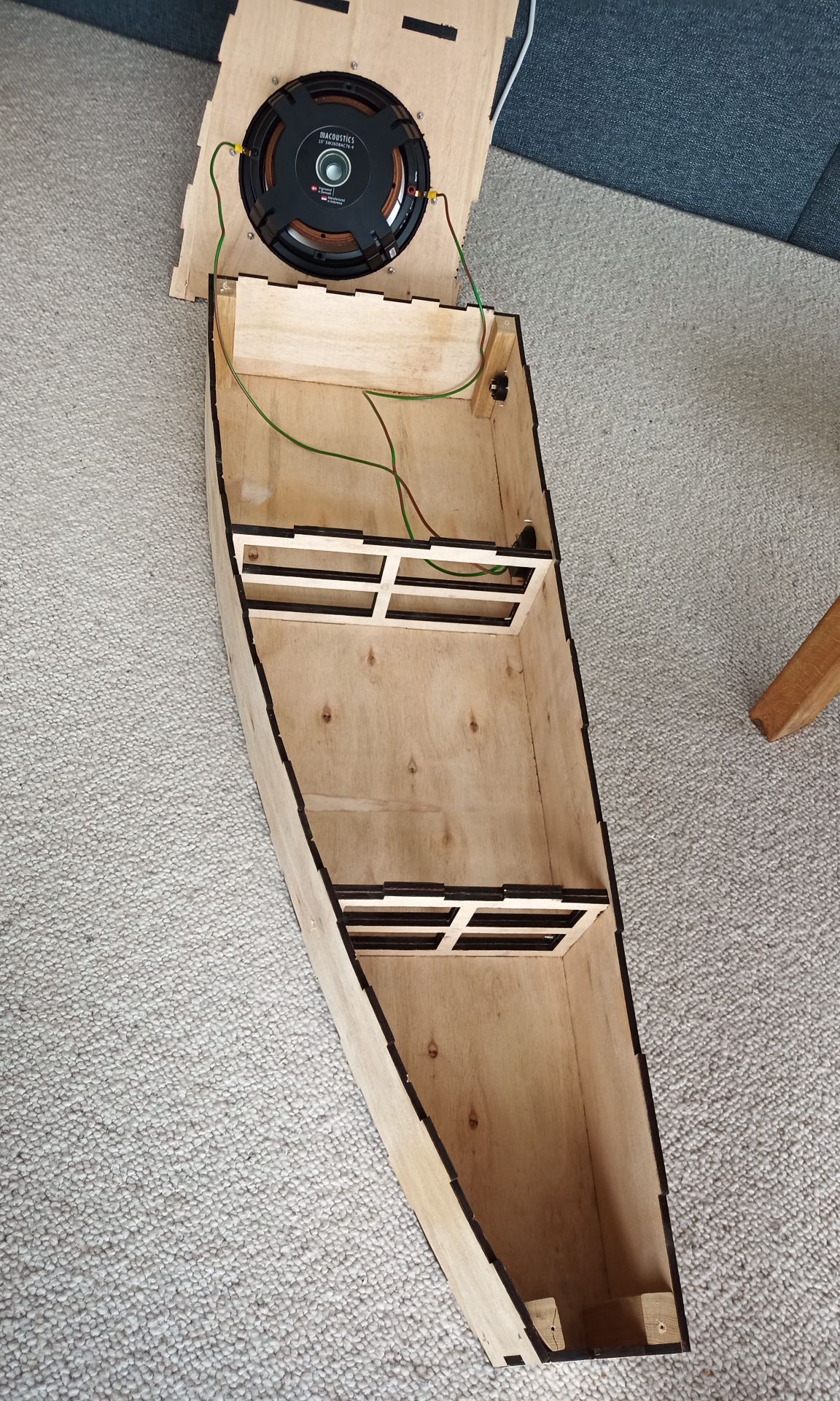

Just use leftover wood and brace it. It helps a lot.Not yet I'm sorry to say, but I have finally started building them, sealed box, 43 liter internal volume. I need to make them more stable, I made a quick first box from what material I had on hand but it flexes way too much. But now that I have gotten a first iteration built I think I will make progress quite a bit quicker^^
View attachment 1322072View attachment 1322071
Now it doesn't rattle any more😀
I reinforced all walls with "epoxygranite" (80% sand, 20% epoxy), somewhere around 5-10 mm on each wall. I have been looking for an excuse to try it on a box for a while.

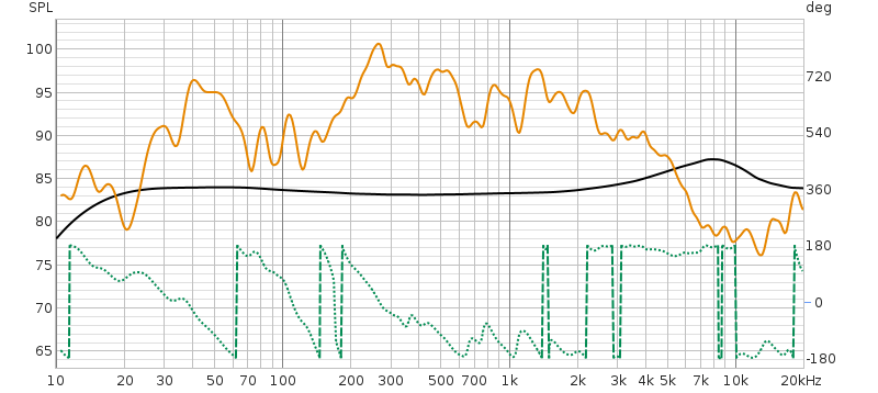

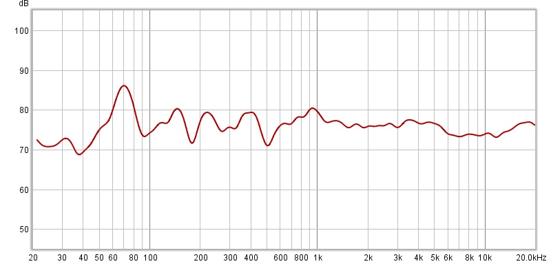

Did some quick measurements:
Left is just the CBT24 with no eq, right is CBT24 + sub (no eq), cutoff point for the filters at 140 Hz.

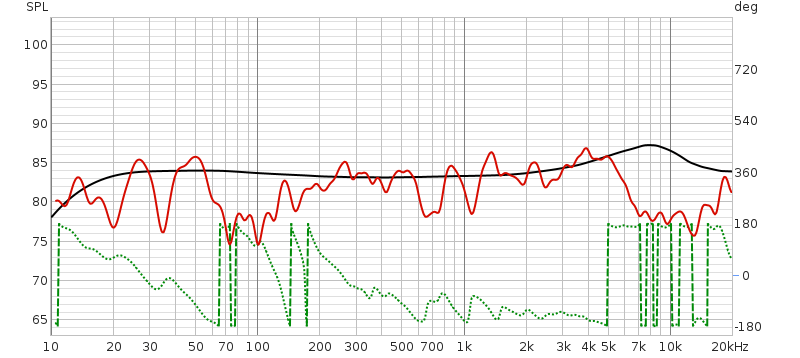

And this is the CBT24 + sub with some eq applied.
Need to build one more box and apply some veneer to the box to make it look nice, but quite happy with the result.

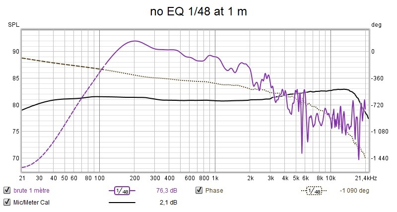

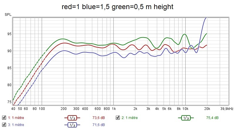

Look at the measurements of my own CBT24 with 5 EQs ; all measurements gated ( thanks to these "floor friendly speakers" you can obtain long windows of anéchoïc measurements )
One trick is to have apply a high shelve with low Q 0,3 but with miniDSP you'll have to load biquads from REW .
