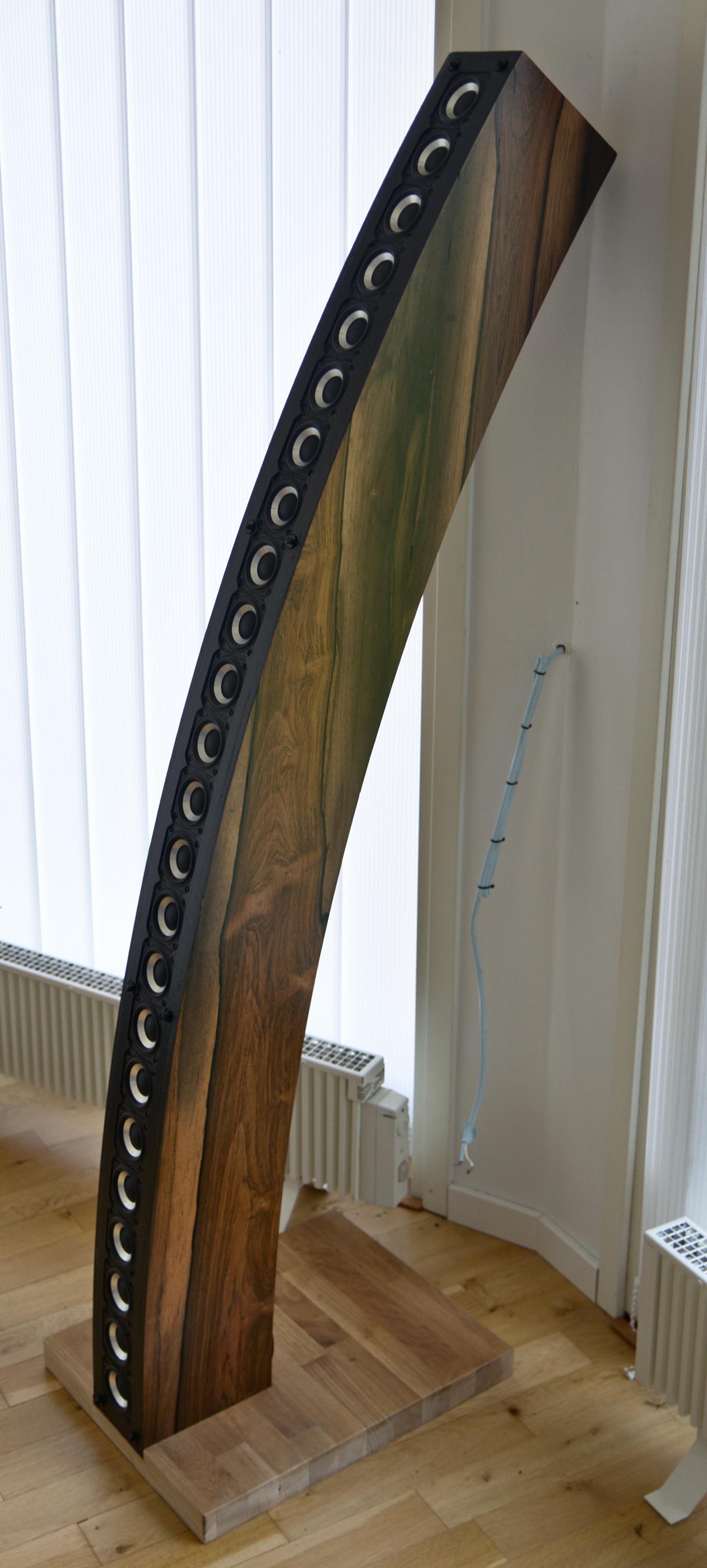

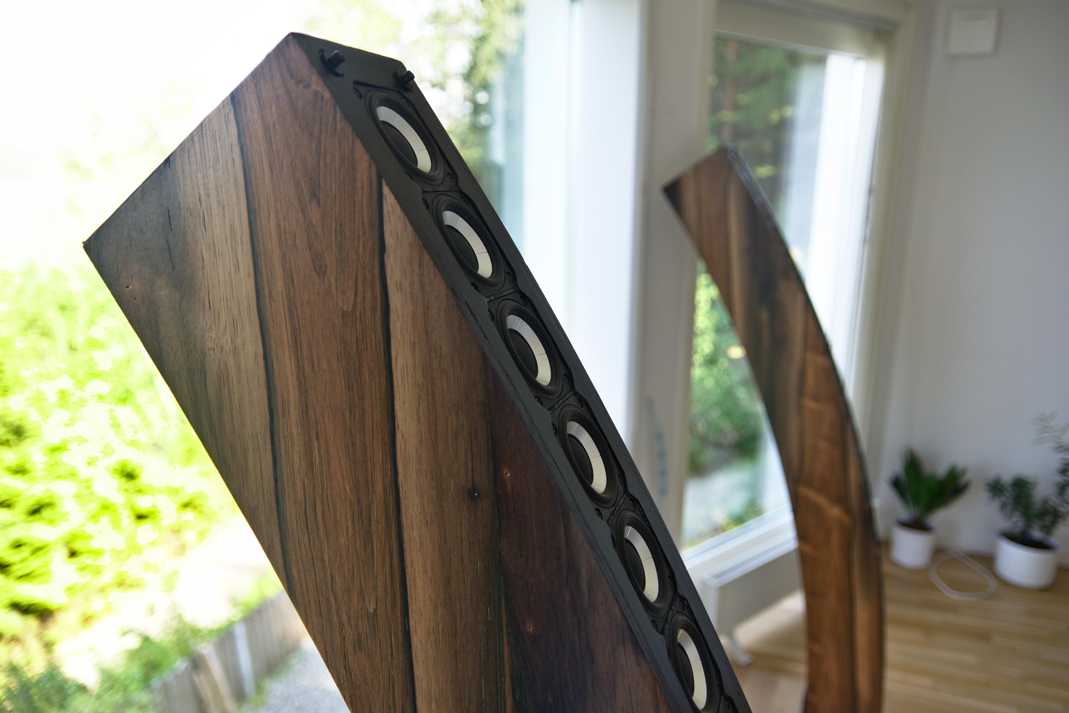

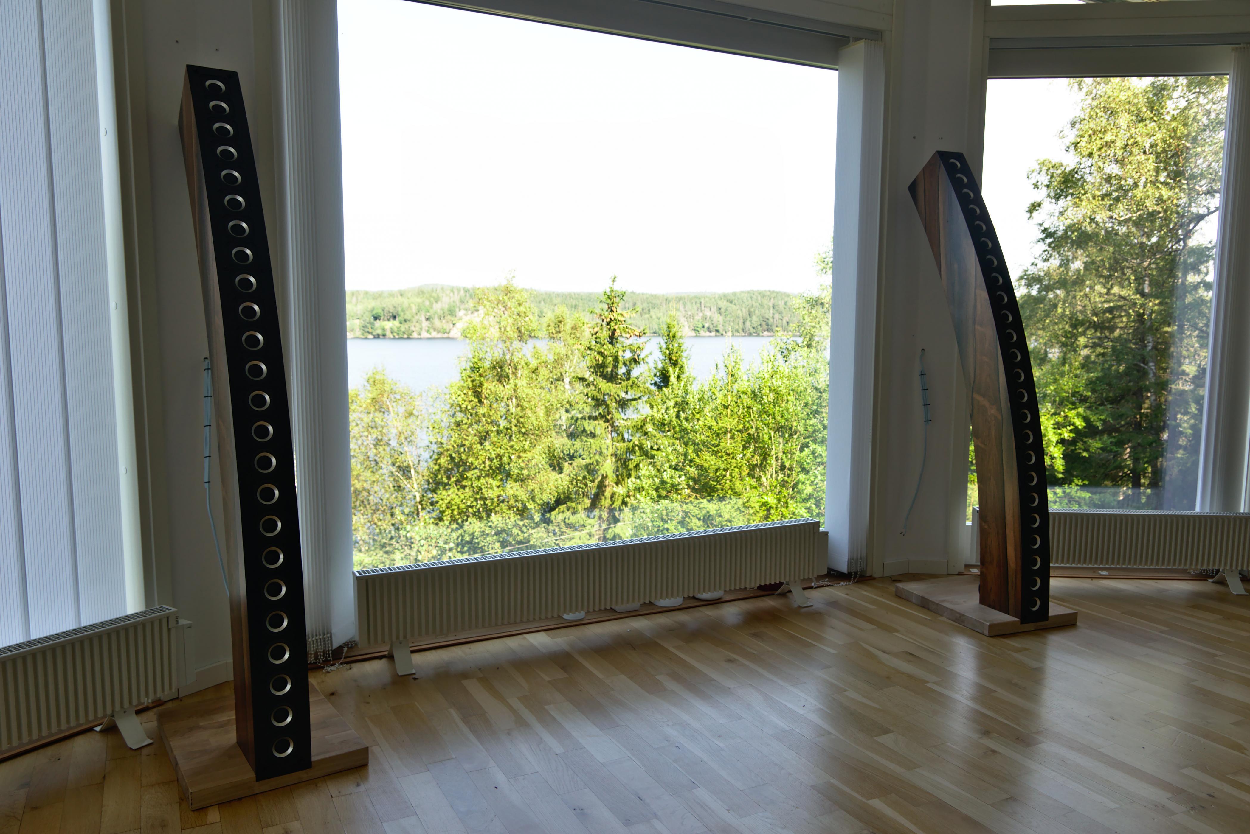

They are done! (Almost... still wish to build a speaker grill so I can cover the elements when needed.)
I am happy with how they turned out, one out of the 48 elements was bad (I assume from factory as there was no visible damage). It sounded very bad when playing high frequencies (could make the bad sound disappear by lightly placing my finger on one of the elements). After changing that one everything was awesome!
Now I just need to get a microphone and measure them and try some DSP

Wow, Sweden has some beautiful scenery. Your CBTs look great.
I'd like to know if my experience with a Flat 3 Bank CBT carries over to the physically curved CBT. I'm not sure how to describe it, but with 5 Banks I perceive a more vertically defined soundfield. That means I hear the music as though it is coming from speakers placed directly at ear level whether I am sitting or standing in front of the array. With 3 Banks it sounded like the soundfield always came from the center of the array.
I don't think the difference is very important in terms of enjoyment. Both are enjoyable. In fact, the 3 Bank might even be more enjoyable in home theater because I'd describe the soundfield as enveloping.
I wish more people built CBTs. I'm certainly glad you did.

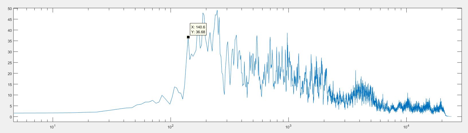

For fun I took a Zoom H1 microphone, placed it 2 meters away from the spekers, 1 m from the floor and played some white noise to get some rough estimate of how the frequency response looks. Looks like there is very little under about 140 Hz. Not accurate measure by any means but shows a little. Seems to be a hump at 4kHz as well.
bradleypnw: If you mean that with 5 banks it felt like you were listening to music in headphones and that the music more feels like it comes from somewhere between the speakers for 3 banks. Then I think your impression is similar to mine It really doesn't sound like headphones even thought the sound follows you around.

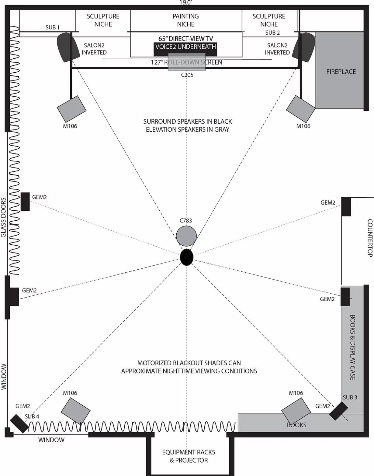

Here's an illustration for Floyd Toole's house. He places his subs in the four corners because he uses a specific Harman/JBL technique called Sound Field Management. Earl Geddes uses a different technique but I don't have an illustration of his room.

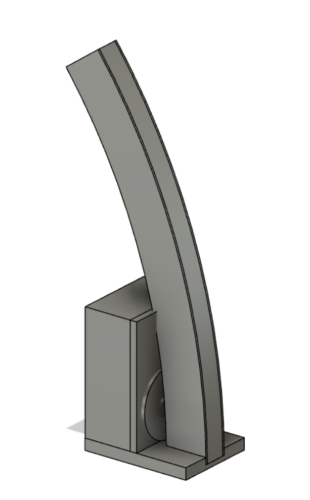

Ah yes sorry about the drawing, not meant to be attached.
Just read through this thread: Small active 3-way floor stander with a punch
So now I am a bit curious about SB Acoustics low profile subs. And making something thin and high that can be placed behind the arrays but side firing.
I dont really wish to put them on the sides of the arrays due to the windows in my listening room

So maybe something like this, with height adjusted according to how much volume I need (and again, not physically attached to the arrays, just placed close behind).

I like your idea about inserting the subs in the space behind the arrays.
Before you become too involved with Vituixcad, you might investigate the proposed sub woofer design you suggested. Some box modeling of the SW26DBAC76 (if that is the first choice you are considering) in various enclosures (sealed, ported, etc.) would be useful to determine their performance vs your needs. The available volume behind the array enclosures can be calculated and compared vs. performance of the box models.
