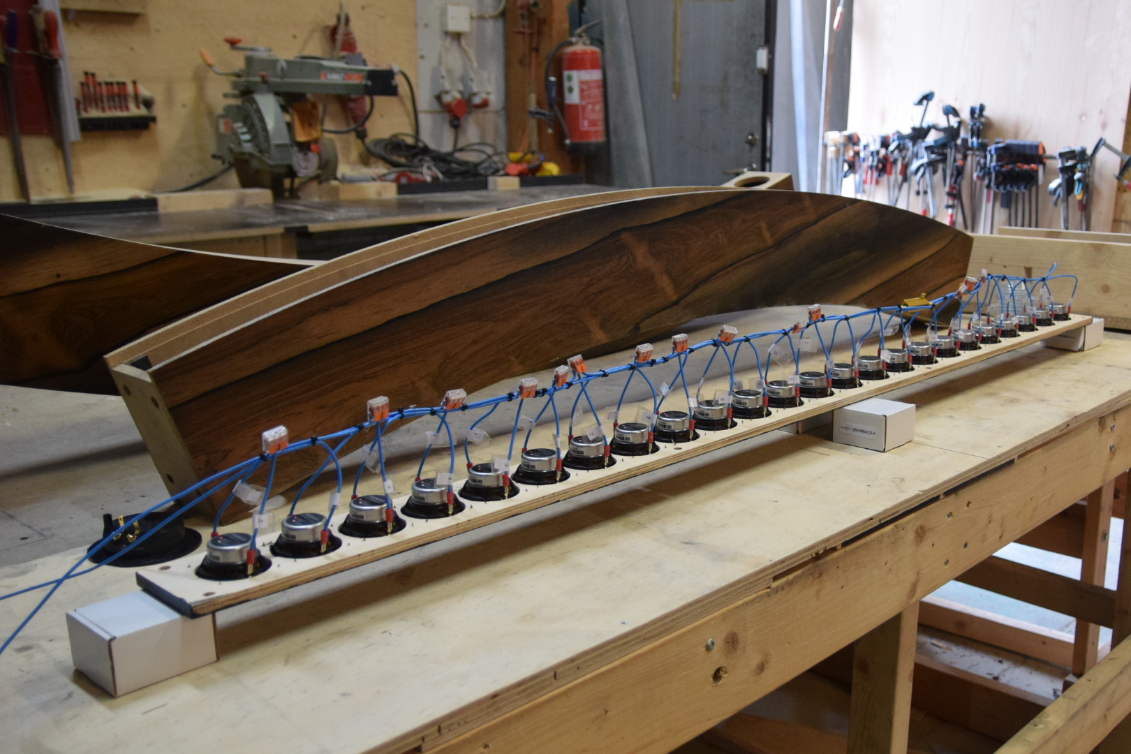

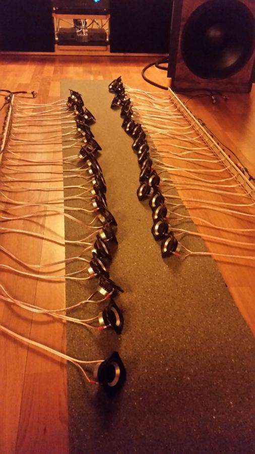

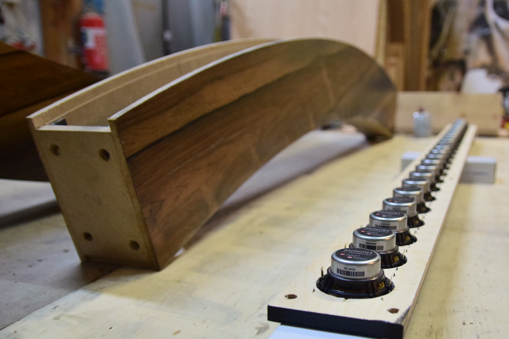

I did the wiring according to the pdf you posted in your build thread, with 8 ohm and 25 ohm resistors.
Yeah, I will try to install everyting first and then glue the baffle, but I will try it with one speaker and make the next wireharness once that is complete, would be boring to have to remake both if I feel the wires are too short.

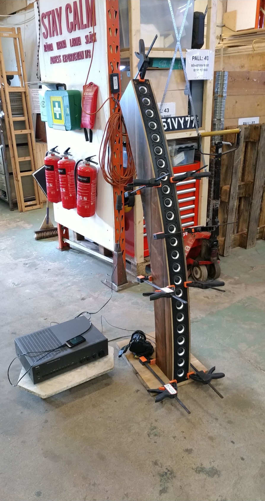

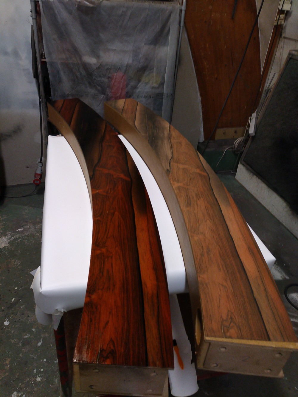

Made the front baffles also now. Now it is just the hard stuff left, making the finish look nice😛

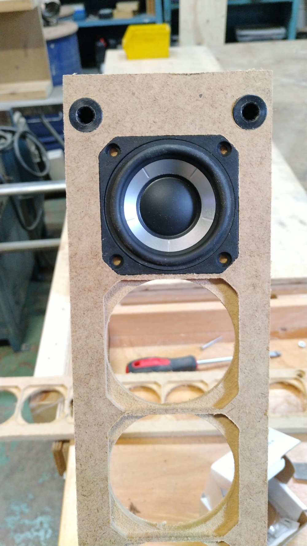

Are those plastic grill anchors in the upper corners of your baffle?
I would be interested to follow how you implement the grill frame as I may add a grill to my arrays. I have been thinking of using extruded metal pieces (akin to screen window frames) but I haven't worked out the details. I have used magnets in the enclosure body in the past to attract the metal frames with either steel washers or properly polarized magnets glued to the frame.

Instead of a 4-way I can use an additional 3-way, I made this (see attachment) before I got the presentation from you Jim that showed how Don Keele made it.
Yeah, removable rear baffle adds unnecessary complexity, I meant that I would assemble the wire harness and put it in the enclosure before gluing the baffles in place 🙂

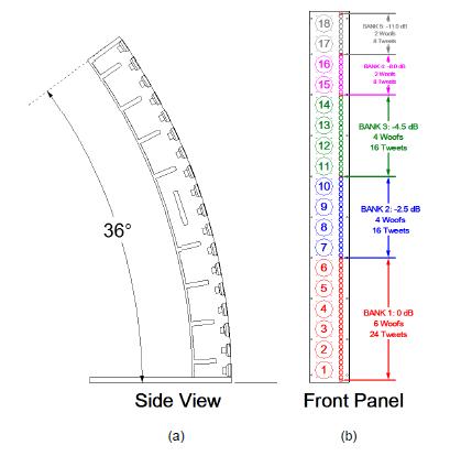

Do you know what your decibel shading is for each of the three banks?
Concerning the weighting networks for Keele's (Dayton Audio full range driver CBT24) and my Modified CBT24 version:
The weightings are the same levels (see hka post just above). But the drivers are not the same between these two designs. Keele's design uses a P-E 16 ohms driver while my design uses the 4 ohms
SBA65 unit. See my thread for the weighting network diagram for my version.
Bradley's diagram is for another CBT design (perhaps Keele's two-way CBT for an earlier kit offered by P-E).
