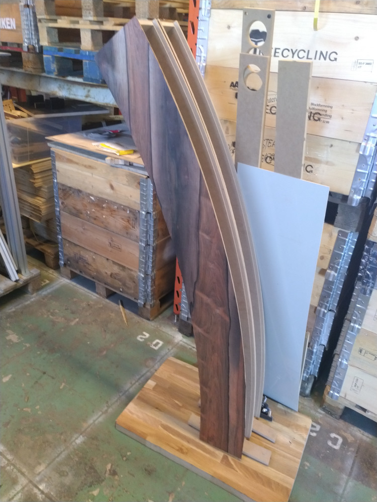

But inspired by Jim Griffin here I have started building my own (duplicating his build).
I have started cutting out parts for the enclosure (going to build the enclosures before blowing $1k on drivers 😛 ).
Image of the routing.
More images as the build progresses 🙂

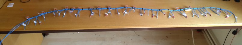

Jim,
I'm going to get started on the wire harness soon, two questions for you.
1. Did you put any dampening around the wires, and/or attach them to the inside of the cabinet?
2. How much stuffing did you put inside? About 1 kg for each enclosure?
Hjalmar

I estimate more than 100 feet of 16 gauge wire were needed for the weighting network cable assemblies in my prototypes. I decided to construct three separate wiring cables for each speaker enclosure. The cable assemblies are for the bottom 12 drivers, the middle 6 drivers, and finally the top 6 drivers. These three sets of cables were intended to be tied together near the bottom of the cabinet close to the terminal plate location.
I used six colors of cable to help me discern each cable set as I went along. These color coded cables and the driver connection pins were assembled to scale outside the enclosure and then pulled through the cabinet into position. I stretched a line of painters tape along my work bench to allow me to mark at the driver placement dimensions (2.625”center-to-c enter between the drivers) for assembly of the wiring harnesses before insertion into the cabinet. I carefully labeled the various wires so that the destinations and polarities were clear as the wires were as placed into position. I used wire ties to tie the wires together as I went along this layout. I allowed extra length so that I could later attach the wires to the drivers outside of the cabinet and leave enough length to connect the wire together at the bottom of the cabinet.
As many three-way connections were needed for the weighting networks inside the cabinets, a common 3M Scotchlok connector was modified from a 1 to 2 way connection to be a 1 to 3 connection by hand drilling out the through wire stop.
With the cabinet standing vertically in my shop, I was able to use gravity to pull the wiring harnesses into place inside the cabinet with the wires emerging from the drivers holes.

Jim:
I think maybe I will install the wires before closing the enclosure. Lots of labeling and colors will be needed, quite complex wiring for a speaker😀

Concerning my use of the 3M Scotchlok connector: Normal this connector has one input wire and two outputs but with the stop removed it becomes a one input and three outputs connection. Thus you can make those one to three connections which are needed for my version of the weighting network. Essentially, you need to have this 4-way connection capability.
The connection block you linked appear to have the capability that I'm suggesting in some of the more complex models but it is more than a three way connection.
On assembly of the speaker: Yes, I do suggest that you wire and stuff the cabinet before you screw the drivers into the cabinet. I'm assuming that you have a closed back. Note that the speaker holes are small but you will need the ability to reach and guide the wires inside the enclosure. Small hands or reaching tools can be useful. Now a removable rear baffle would be nice but that adds more complexity. Make sure that you maintain the polarities of the connections as in the wiring diagram.

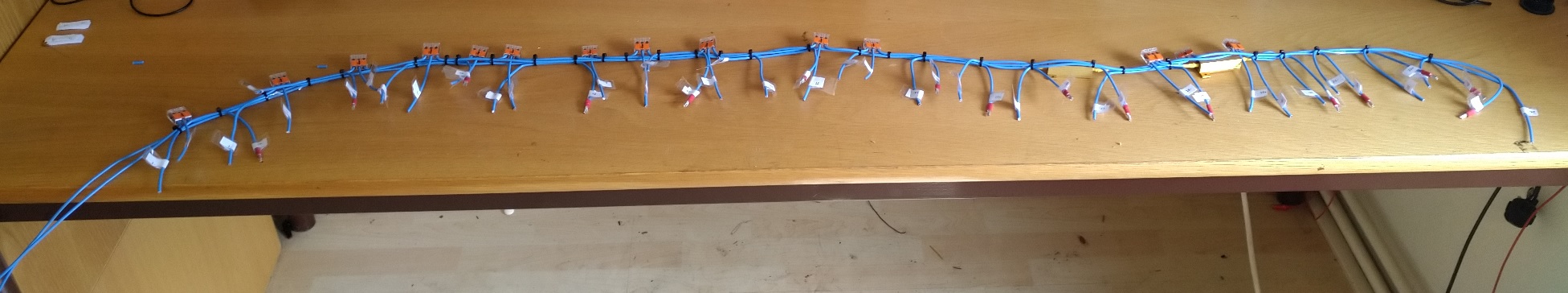

Instead of a 4-way I can use an additional 3-way, I made this (see attachment) before I got the presentation from you Jim that showed how Don Keele made it.
Yeah, removable rear baffle adds unnecessary complexity, I meant that I would assemble the wire harness and put it in the enclosure before gluing the baffles in place 🙂

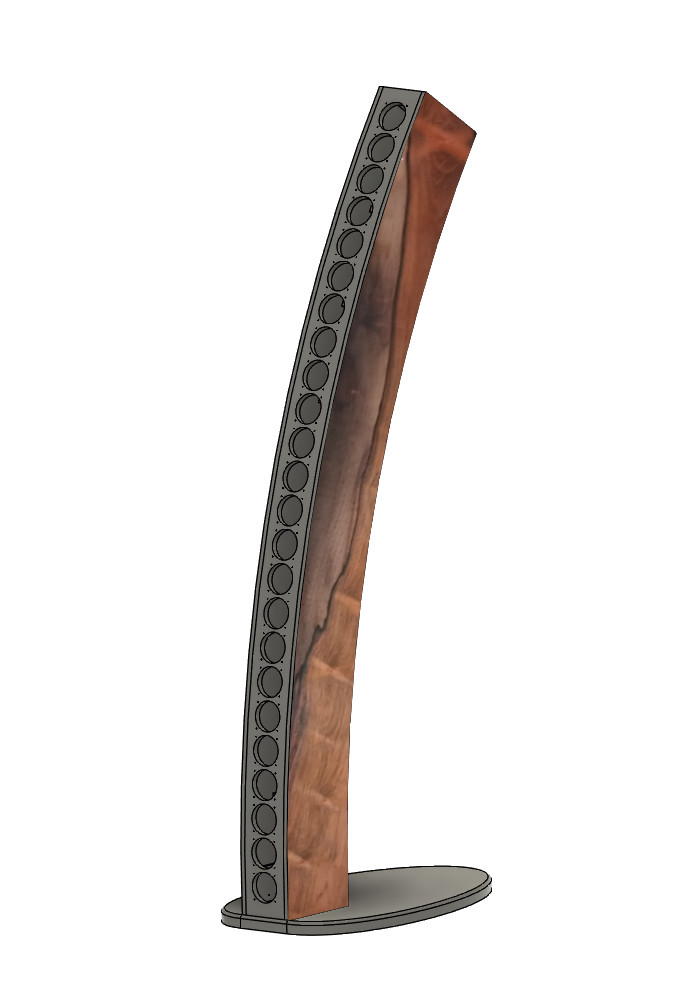

Looks like the veneer will be fine. Anyone want to give input on how I should align it? ^^ I made two variants by pasting the photo over the model in GIMP.

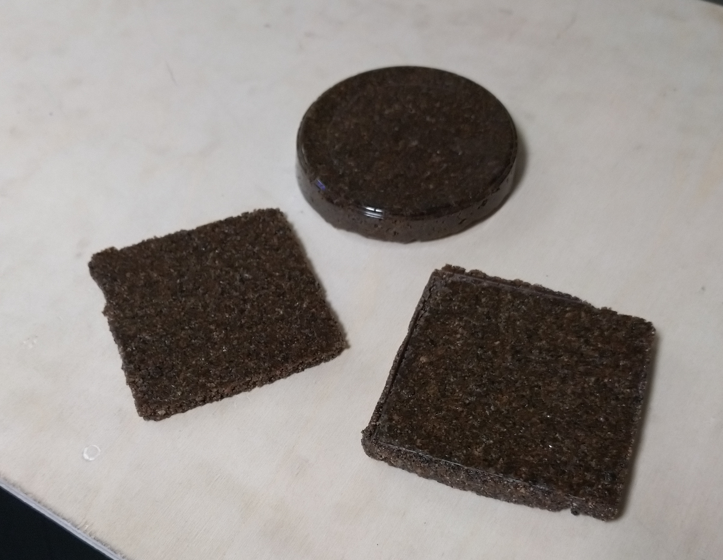

And wesayso, I think I will just take some ideas from your build and do a little bit different design. The frequency response from the Scan speak 4558T00 looks really nice, but I have been wanting to test making something out of epoxy granite, so I will probably use that for the enclosures. I did some tests with just stonemeal and epoxy (5 parts stone, 1 part epoxy). If I make the enclosure 15 mm thick, total weight should be about 30kg.

Yeah, I slightly preferred first one as well (as did my wife so was not much to talk about really), the second one would have been easier to make as I would get the entire side as one piece of veneer with no joint.
But it went well 😀

Very neat wiring harness! Great progress.
My connections to the drivers were likely longer than yours as I made sure that I had more than adequate length for all connections outside the cabinet. I wanted to have room to insert the wiring harness, place the harness in the back of the cabinet, fill with the damping material, and then have enough space to make the connections. If you glue the baffle into the cabinet after these operations, should allow you to have shorter wiring vs. my procedure.
One note on more careful reading of your comments in Posting #15: My Modified CBT24 weighting network is for the 4 ohms SBA65 drivers which has different wiring vs. Keele's design with his 16 ohms drivers used in the Dayton Audio CBT24 version. I haven't compared your diagram to my wiring schematic but be sure to test your harness before final installation in the cabinets.
