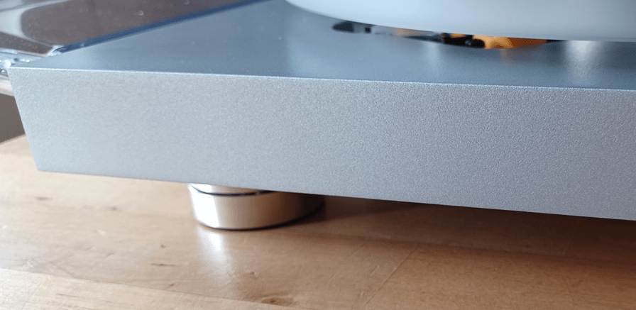

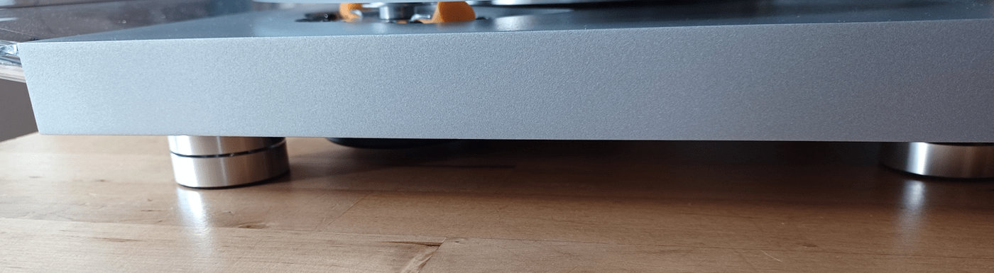

I've recently been playing around with the old Pro-Ject Audio Debut III esprit (an entry level turntable):
More mass!
More mass!

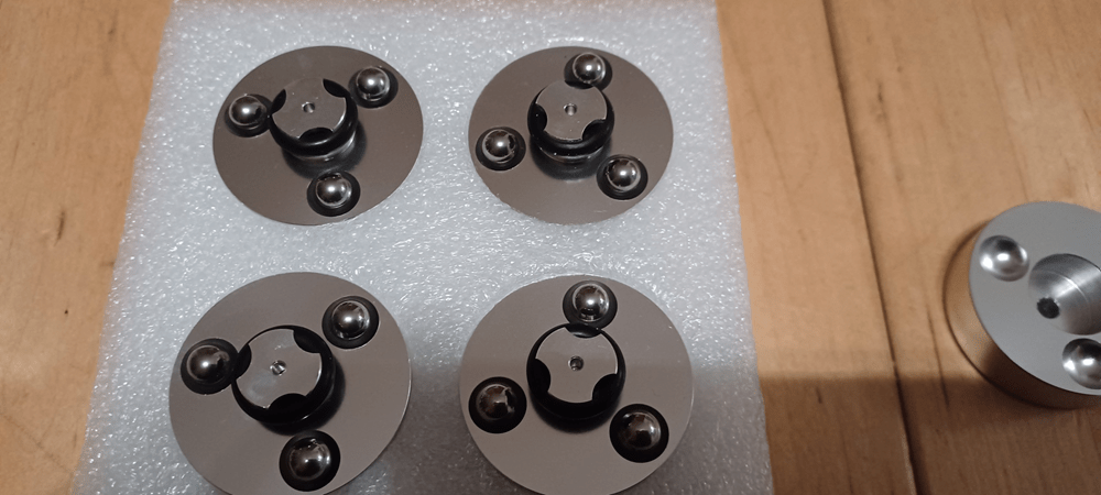

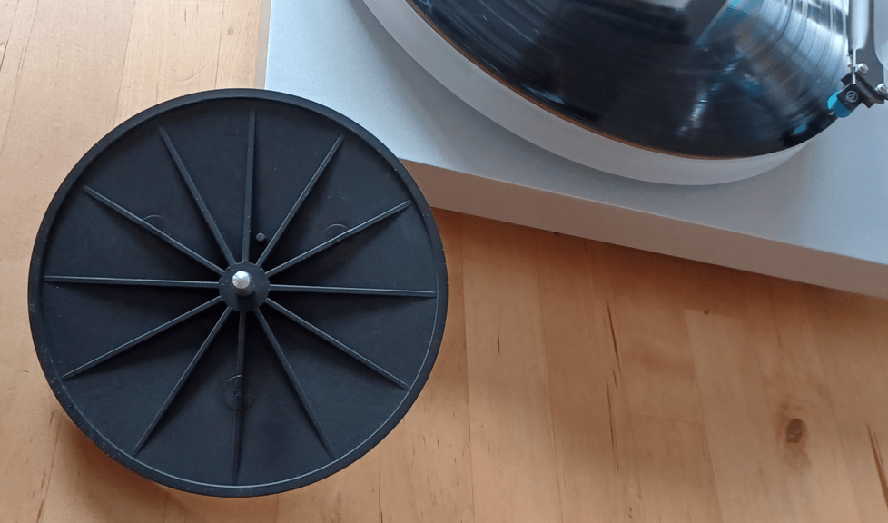

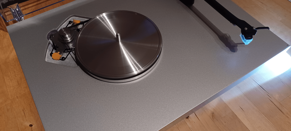

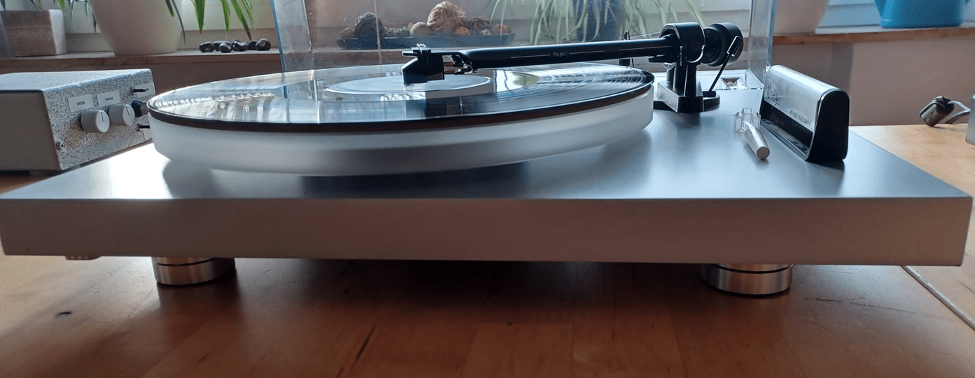

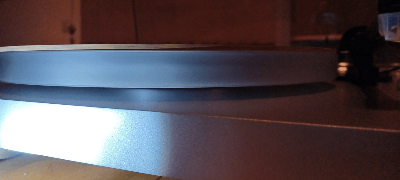

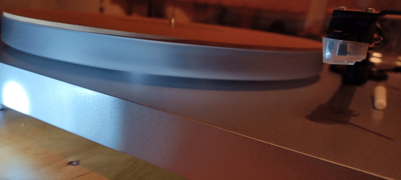

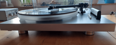

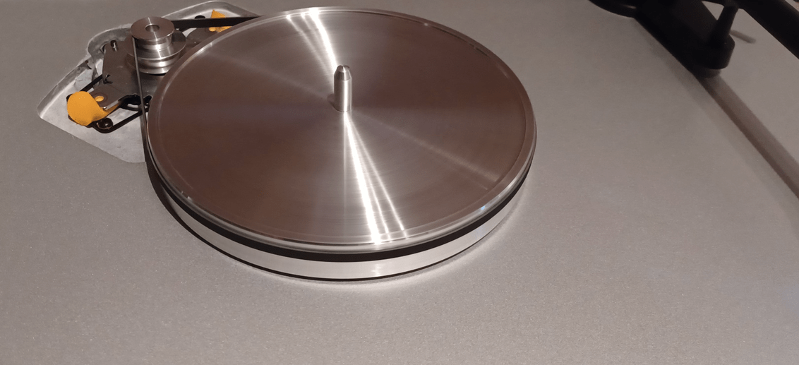

The toy is still electrically powered by my analog Speedbox, a makeshift solution.
First things first, the sound has changed fundamentally - whether it's a psychological phenomenon, I don't know. But my first impression confirms the physics, namely F = m * a. The most delicate external vibration, let's say impulse, is transmitted to the tactile sensor, the MM cartridge. This was to be expected, but the previously disturbing groove noise (as if listened to with a stethoscope) is no longer pronounced - this disturbance has disappeared and the overall sound now has a completely different foundation, much better and seemingly more natural. However, this change really costs a lot of money, subplatters and feet add up to a lot, this upgrade is not cheap. I also have to come up with something for the inevitable decoupling from the floor, perhaps a bamboo board with the original rubber feet - or, if you do the math correctly, an analysis?!
The manufacturer states a total weight of 5100g (without a support mat), I have weighed the following components:
Acrylic platter
m1 = 897g
Cork-rubber mat
m2 = 130g
Plastic sub platter
m3 = 134g
4 pieces of plastic rubber damper feet
m4 = 56g (in total)
New total mass;
Aluminum sub platter
m3' = 695g
4 pieces of aluminum (with steel balls, multi-piece) feet
m4' = 288g (in total)
Total = 6023g.

The turntable bearing
Pin, axle - diameter 6mm - length approx. 34mm, effective 19mm,
i.e. there is no more than 15mm left for the brass bushing, at the end of the tube is a tiny stainless steel ball (or is it a teflon mirror?).
The bushing is mounted in a strange plastic part ...
Strange - and this is supposed to be able to carry the weight of almost 2000g in the long term - CEO Heinz Lichtenegger is always coming up with something new.
I filled the huge cylinder bore at the bottom to accommodate the bearing yesterday with sand, these tiny garden pond stones, and sealed it. One less cavity ... more silence now.
The mount and holder of the steel ball (of the entire bearing) is really tiny, the visible steel disk on the surface desk is only cosmetic. At some point the plastic end will break.
As the next upgrade idea I would already know something "bear it", among other things with a ceramic ball and a can from the solid.

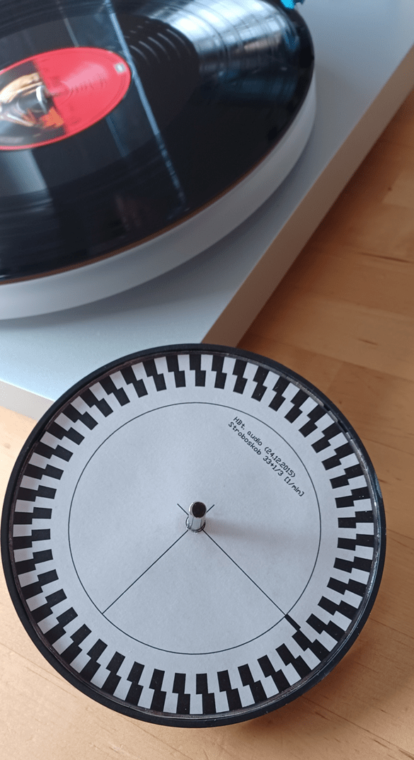

After a few days of listening, I'm completely amazed at what this "simple MDF board" can do. The smoothness and stability is astonishing -> why not like this right from the start?
Rumbling, synchronisation fluctuations and groove noise are now history - a better tonearm plus 2-phase synthesis electronics and "the board" would have grown up.
The only thing I can say about the 651P equaliser is, that its taste and function are now completely fine, without any faults.
In conclusion,
no matter which equaliser you use, an MM doesn't mutate into an MC - but as an entry-level combination, it's really not a bad choice.
