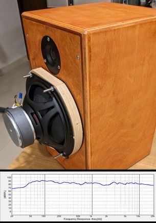

I had a piece of Dual Peerless SDS-160F25PR01 (8 ohm) into one Isobaric design. They sound all-right. Though in ported 15L box and with TIPD134 analogue X-over and TPA3221. Probably not the best design.
sorry the speaker wire is not well attached in the pic
