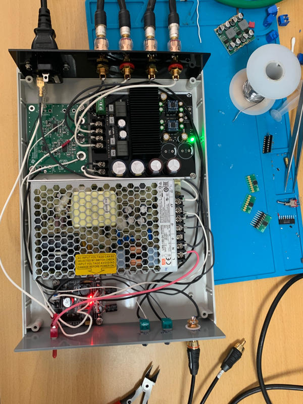

for DSP/Digital-X-over, there are certain options in ASR or Digital-Line.
But I found one Analogue Active-X-over pretty good, the TIPD134 from Texas Instruments. Though it's designed for 2-way. In Taiwan, one finished board (print, have someone to install the SMD things on it) is around $40 USD. If you refer its simulation software, one should be able to modify for 3-way designs. I installed it with TPA3221 board and they works great.
And I heard Sylph Audio is also planing the OP-based Active-X-over with Pre.
Upper Left = TIPD134 (the green board)
Upper Right = TPA3221
Middle = Meanwell LRS-150-24
Bottom = DC converter, 2 VR, RCA input*1
