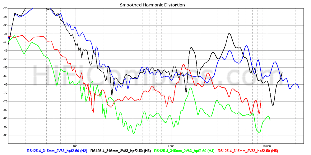

Thanh, the measured HD magnitude on the RS125-4 was with a normal healthy and unmolested drive unit.
Interestingly, here's Hificompass's measurement of the RS125-4
Reference:
https://hificompass.com/ru/speakers/measurements/dayton-audio/dayton-audio-rs125-4

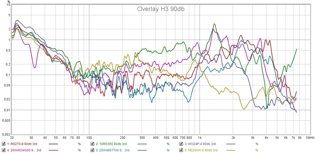

That's often my experience with Faital drivers. While they look good/great on paper they never compete with the best in class.
And I never measured the same as a Faital or Dayton (or TB Speaker) "Data"sheet ... other companies give more reliable data.
I also wonder if the high H3 of SB Acoustics at low frequencies is intentional done? H5 and higher is still low, H2 is good. Strange.
Some H3 at low frequencies sounds good! It suggests "tight" bass.
(I just remember now - that's what a quick listening comparison of SB29NRX75-6 to my ScanSpeak 8" also showed. The SB was more "tight", ScanSpeak more "black")
