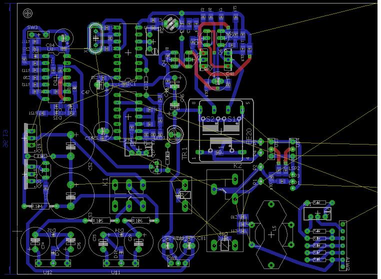

I have made some progress with routing PCB, degausser will be on main PCB,there will be daughterboard that will have relays or rotary switches depending your preferences.
You can use google translate or some addon for web browser to translate text on that forum. Language is serbian and croatian.
I have made some progress in routing PCB. I didn't put any ground plane or put some effort in routing ground traces i'm atm just fiddling with components layout. All components that require tweaking(according to Elvee alignment guide) are tht including resistors for range selection i think it's easier to measure and change tht component then smd.
So far i have placed components for degausser, clock generator,group of those 5 transistors and first "switch" for range selection, but i think i'll have to make some serious rearrangement cause trace that leads from pin 8 of CD4069 to CN4053 is gonna be really long. I knew this is gonna be long process when i decided to design PCB so i'm not rushing.

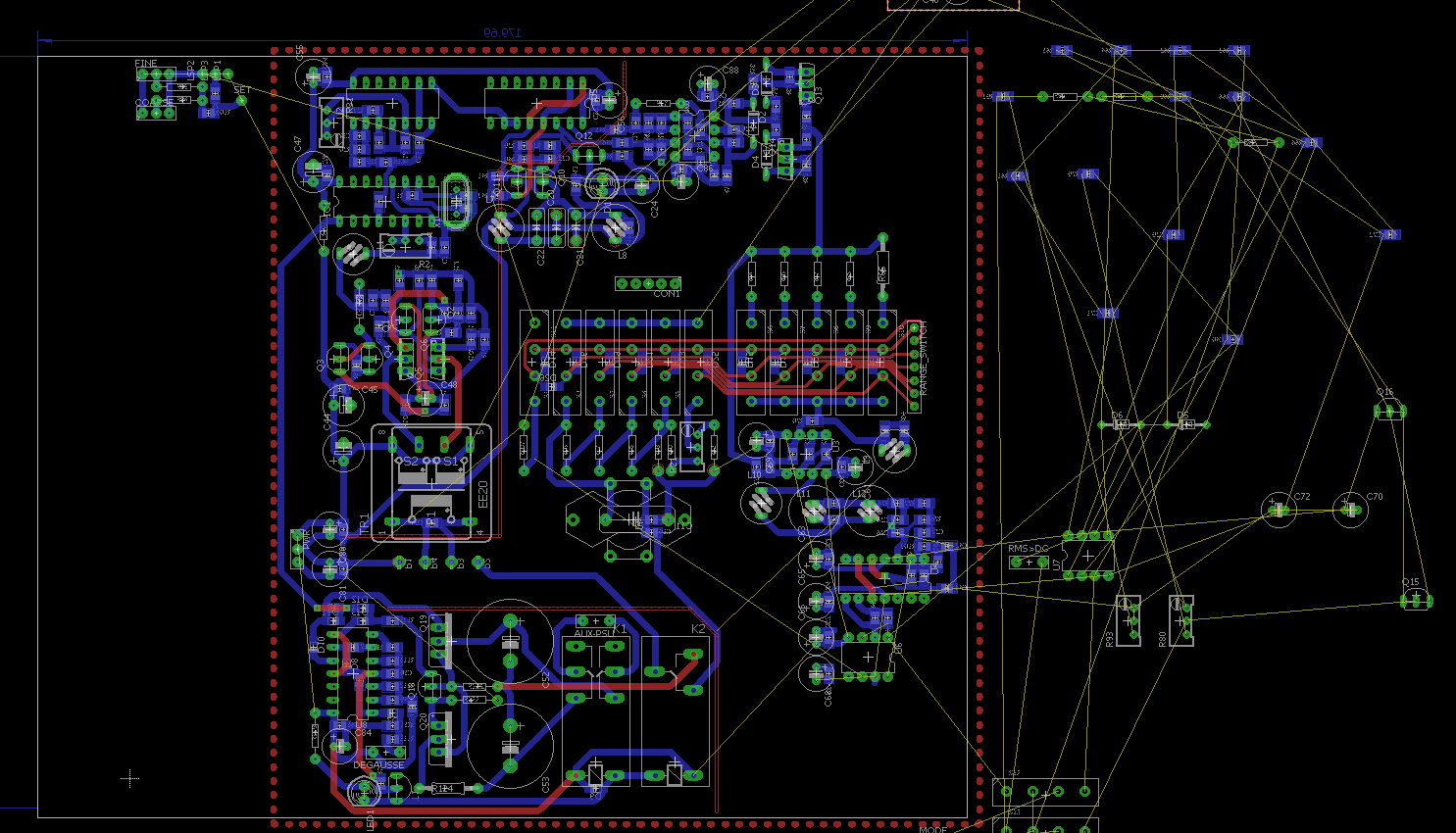

A bit more progress in routing PCB.
Now i have come to part where decision what kind of relays for switching ranges and type of measurement we gonna use. I need to make daughterboard that will fit mainboard so i need to know what relay we gonna use. Ofc there will be option with rotary switch daughterboard but since there are non 3P6T PCB mount rotary switch i will need to work out a bit more before i come up with some solution.
So relay option.If i counted correctly we need 19 of them. I was thinking about reed relays in SIL package cause they are small and you can put them a lot on small area. Example of them is in link below.

Number of relays you can check in Elvee schematic. Switches in schematic are marked S1 A/B/C and one that is not marked that that one switches what type of measurement you take(AC,ACrms,DC,...)
Signal/current that is measured is switched with this relays/rotary switches etc.
Decision for choosing SIL reed relay or DIL DPDT. I was thinking about SIL reed cause they are cheap, a bit thinner then DIL. I heard both story about reed relays, but can't think some solid reason why some people say they are good and some that they are bad. I guess its cause contacts in reed relay needs to be magnetic so maybe material doesn't have good mechanical characteristics.
Method for control switching relays on/off i'll leave to individual. I plan to use normal rotary switch mounted on front panel and switch control voltage for relays with it. Simple as possible. I can make room for some CMOS switch so if somebody plans to use those he doesn't have to add extra board.
Amount of relays that would be turned on would be 5 in worst case scenario.

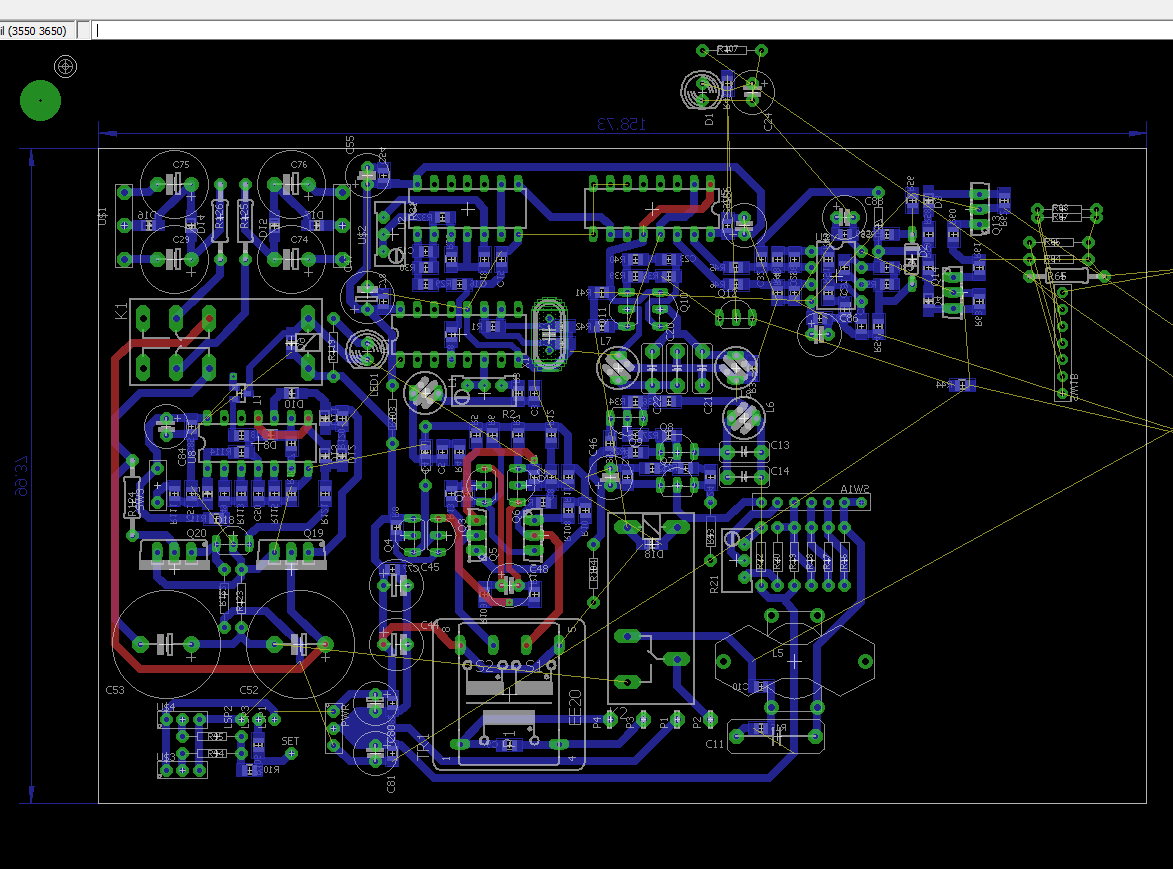

I have stopped a bit cause of other work i have, but i think i could start working on this project again really soon.
"Really soon" became almost delay for over a year. Sreaves contacted me couple of weeks ago asking did i made some progress with PCB and made some suggestions. That gave me some motivation to start again with this.
Sreaves suggested that i go back to reed relays switching,which i did and said he's gonna make trueRMS converter. Plan is to put everything required for this project on same board(PSU,trueRMS converter,main board,"preamp board") and you snap off those boards from main one and place them where you want them to be depending what enclosure you have. There will be place on main board where you plug in "preamp board"(preamp is part of schematic that contains Q7,8,9 and designated parts around them). That board is gonna be small and should be easy to shield it like Elvee suggested.It's up to individual how they gonna shield it.
I have done most of the layout and what is left is mostly power supply lines for OPamps. Some grounds will go to ground plane and some have individual trace to ground center point.
