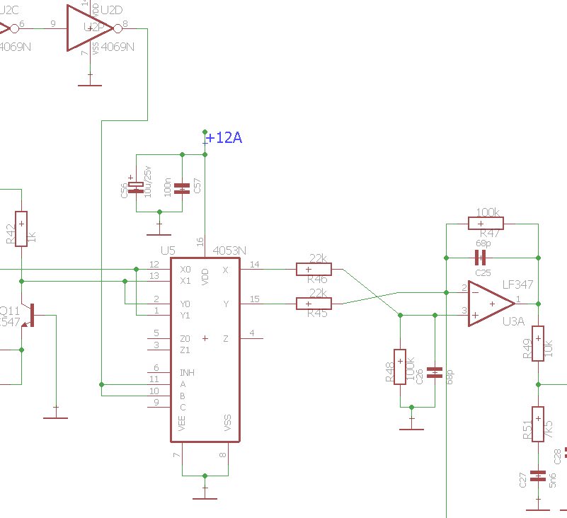

Here is picture of 4053 and how i understood it should be connected. Is this correct?

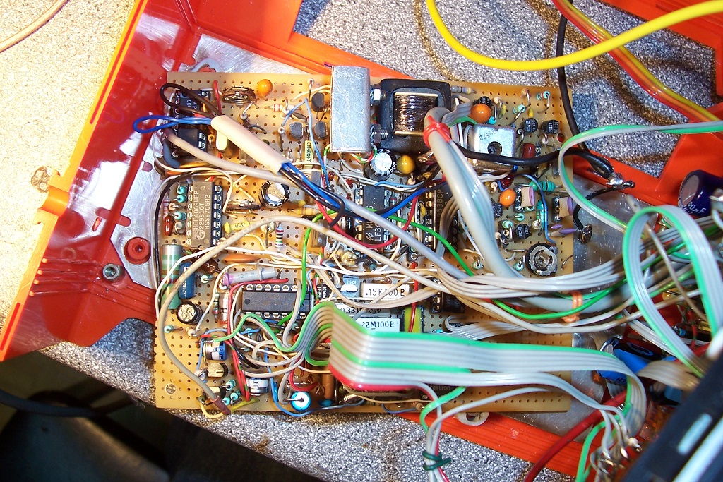

The only exception would be L5: you can see it on this pic (top right):
You will probably have to wind the transformer L2/3/4 and the coil L5 yourself.
For L5, I was lucky enough to find a ready-made one from an old TV horizontal oscillator, but that was unlikely.
Again, for information about winding, use HAM informations.

Got some more questions now when i saw picture you posted.
I see there are quite a few parts in sockets on right side, should i consider that while designing PCB or it's not needed. I know sockets are there cause you probably changed values of elements while adjusting device but is that really needed?
I forgot to ask earlier about 200uA range. I see there are three sections of S1 switch. My guess would be that on 200uA range S1C is connected/shorted and when you change to 2mA range S1C opens,is that correct?
About PCB design, i was thinking doing SMD(mostly 0805 size) with ground plane on one side. I got some experience with that. Ofc i wouldn't make it too small cause of reasons you already said. I'm not sure how people feel about soldering SMD on this forum but on mine we don't have much problem with that.
And i was thinking adding rotary switches directly to board or at least using some adapter board with rotary switch that would attach directly to main board, i'm not sure how would that be possible layout wise but as idea i think should be good.That would mean less wires that could cause and catch some interferences. Recently i designed that way board for analogue function generator and proved to be really good.

The INH pin on U5 should not be left floating but instead should be tied to logic low to make the function reliably active. Good practice would also tie the C pin to ground to ensure low current draw.

For some, yes I think so otherwise you will have to use high precision L and C components (0.1 or 0.2%), which will be costly and inconvenient.Got some more questions now when i saw picture you posted.
A few are explicitly indicated (R106 for example), the rest are the padding capacitors across the inductors: C20, C21, in my case 1n8 as the main cap and 330p as padding, but you might need other padding values and C13 (main cap) + C14 (padding).
Reread carefully the whole thread and the alignment procedure, there are probably indications on how to select them.

Yes, it goes without saying that the usual rules about CMOS (including what to do with unused inputs/operators) have to be adhered to, but this is not a project for beginners, and those experienced enough to embark on it should have at least that kind of basic knowledgeHi Khadgar2007,

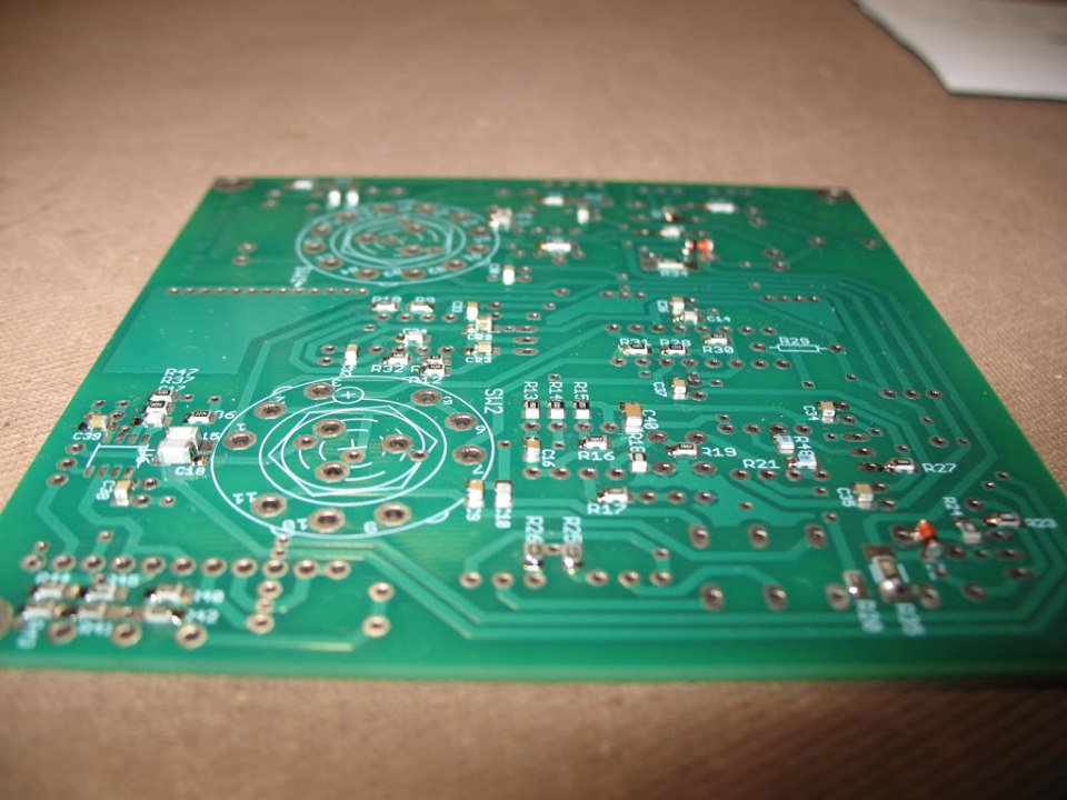

I have reread entire topic to refresh my memory and came to interesting puzzle.
S1 switch, needs to be 3P6T,i completely forgot about it. So i did some search and coudn't find PCB version of it so i guess some creative thinking is needed.
Plan is to look at any kind of rotary switch that is 3p6t or more(4p6t) and mount it like on PCB like on front panel with a screw then with short wires connect it to PCB.
For other switch ordinary lorlin 2p6t pcb mount should be fine.
So far this is layout, a lot of work to be done. Atm i'm fiddling with transistors q1,2,5,6 and how to route traces around them. And ofc Q4,5,6 should be thermally connected.
Btw my M.O. when i'm making layout is that i place components,route traces and after i'm satisfied with that then i modify traces width,distance between components and traces etc.
