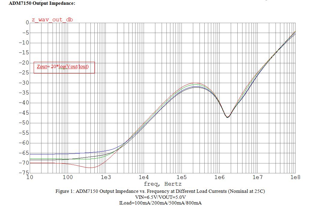

Hi all,
The designer of the ADM7150 was kind enough to run some simulations of the ADM7150 output impedance for several load cases. I've attached the simulations results to this response. As can be seen in the simulations, the output Z of the ADM7150 is well under 1 milli-ohm up to 3KHz smoothly and rises to about 18 milli-ohms at 100KHz. The output Z is somewhat load dependent, especially below 1KHz, because the open loop gain of the LDO is load dependent.
There may some confusion about the difference between these simulations and the test data shown in the datasheet figures. The simulations assume a 1 milli-ohm interconnect resistance while the actual part under test probably had 5 to 10 milli-ohm PC board resistance between the LDO output pin and where the output voltage was measured.
When the native output Z of an LDO is so low, the interconnect resistance can dominate to output Z, and therefore load induced noise, of the total system. Great care must be taken to keep impedances as low as possible if the best possible performance is to be attained.

Thanks for the very useful input 🙂 I fully take your point about the load transient plots telling the large signal story whereas we're really interested in the small signal condition. I was rather clutching at straws in getting a handle on the missing info about Zout.

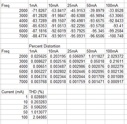

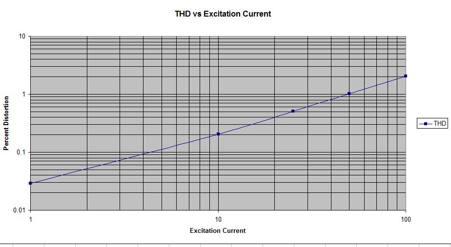

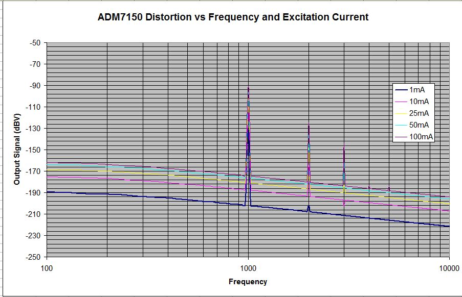

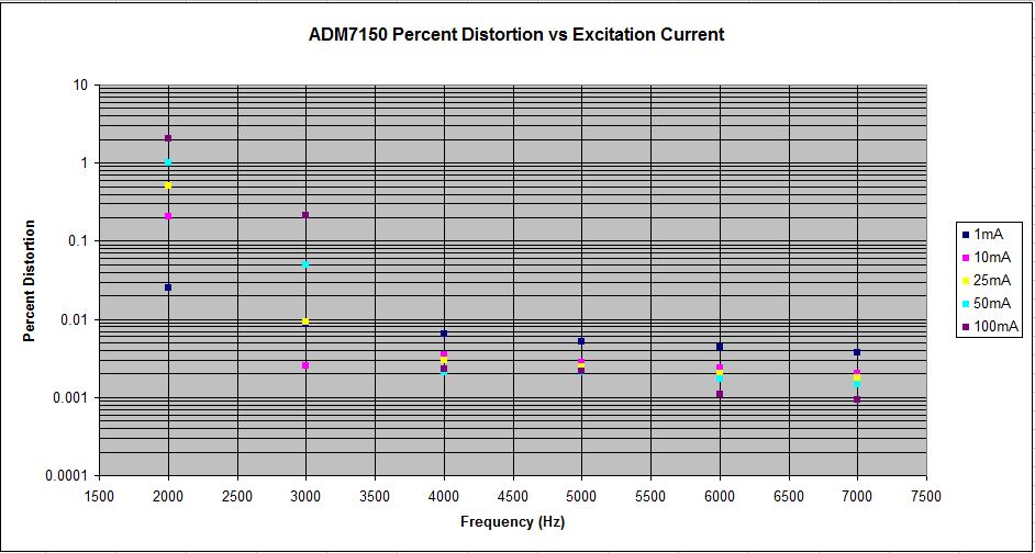

Hi all,
I've been able to get some simulations for the THD of the ADM7150 for different excitation currents at 1KHz. The attached tables below shows how may dB down the harmonics are from the 1KHz fundamental.
I'd like to know what you all feel is a reasonble level of distorion for a power supply.

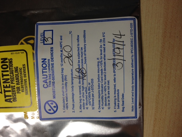

The storage requirement for low humidity is to prevent moisture from entering the device package and causing the part to crack when it is sent through a re-flow oven for soldering.
If you are planning to hand solder or re-flow the ADM7150 on a hot plate, I recommend pre-heating the part for several minutes to ensure that any moisture is driven out of the package.

Thank you for your response. Please advise I should bake the component at what temperature?

Baking the parts at 125C for at least 10 to 15 minutes should suffice in driving out most of the moisture. Obviously, the longer the bake the more moisture is driven out.
If the parts have been exposed to room humidity for a long time, say over 1 month, bake times longer than 15 minutes will be required.
If the parts are used immediately after being removed from their packaging, baking will not be necessary.

Just curious about the necessity to bake the component. If the component is soldered to a circuit and the circuit was being left in room humidity for months without turning on, what would happen?
It's only necessary to bake the parts prior to initial assembly. After that, the normal operating temperature won't exceed 125C.
