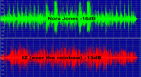

OK, here is Nora Jones. The 1st track. Not as hot as I thought. Average level is -16dB below peak. That's Ok for this type of music.
Also you will see (in red) another track that sounds "hot", but the average is about the same as Nora. Much more even, tho. Interesting.....
That is exactly the same pattern as what I found of 'Don't Know Why'.

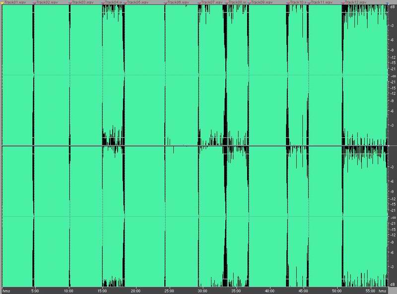

Datz Nutz! No wonder I don't listen to that stuff. How can that possibly sound good?
Maybe I'll need to go CD shopping for something bad.

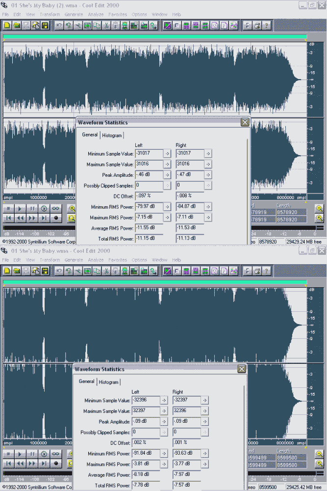

I already owned vol.3 but not vol.1 so I bought it. Well as I suspected the mastering engineers destroyed it. Here is a comparison of the original vol.3 track1 against the "new-and-improved" vol.3 track1:
I'll only be shopping at used record stores from here on
