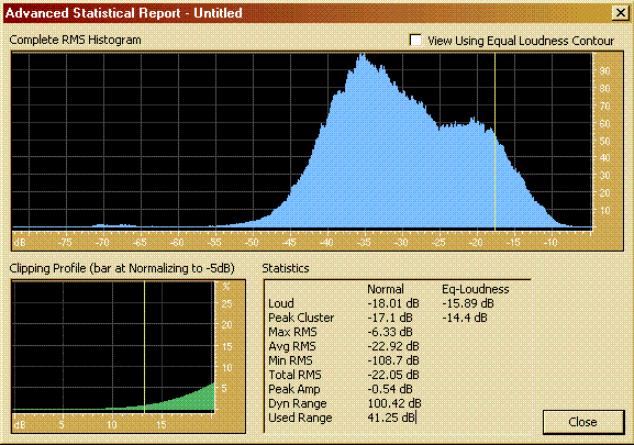

Small correction on manipulation
I reread my notes on this recording and I saw that noise reduction has been applied.
More precisely, the soundcard noise has been removed. This of course explains the very low Minimum RMS power figures.

Well, looks to me like your soundcard offers an actual dynamic range of 100 dB, of which your LP player uses about 50-55dB. That's not too bad for an analog record player indeed, but it's just not comparable to what a good digital recording can offer you in dynamics.

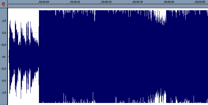

Re: Re: Modern cd's - over compression
This is absolutely a problem, and I've seen it all over the place. I've been extremely disappointed with some of the recent releases. My girlfriend likes some of that catchy pop music on the radio, and I'd love to give it a try- but it sounds horrible on my stereo.
Take this as an example:
The above image represents a direct digital rip of two tracks. Their scale is identical, and there was no manipulation other than copying the one stereo track from each and copying into a blank file as a comparison.
The top track is Know Your Enemy, by Rage Against the Machine, 1992. The bottom track is Maneater, by Nelly Furtado, 2006. I think that this is a fairly typical representation of where the recording industry has gone in the last 15 years. It was no mistake that the Sound Forge capture of the vinyl and CD songs made the CD look terrible by comparison.
If anybody out there knows of a list of well recorded CDs, I'd love to hear about it. I can keep buying and hoping, but it would be nice to pick up some more CDs that actually let the music come through.
4fun said:
I must question that Soundforge screen capture for CD version, is it done right?
I know about over usage of compression on todays records but that is just to much.
See some dynamics on fade out but not in middle, looks like graph is "clipping" and not the music.

The posted recording levels show an odd co-incidence where all those peaks just happen to be the same level.phn said:I have been raving about the Beastie Boys: Ill Communication CD. Not only is it one of the best albums ever made, it's perhaps the best sounding/produced CD I have ever heard. The Beastie Boys were apparently not only aware of what format they were working with, they seem to have been very self-conscious about it and what they were doing. It couldn't have been released on vinyl. Or, rather, it would have been a different album if it had been a vinyl album. This is how CDs should be mastered--as a format completely alien to vinyl.
If I hadn't been told I would have suspected over-recording had chopped the majority of the peaks off at the same digital level.
Phn,
Please tell us it really sounds better than it looks.

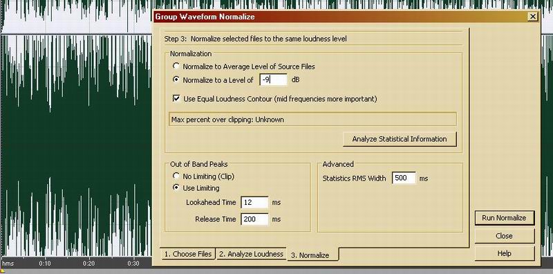

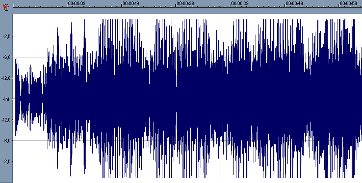

In the hard limiting process, one can tell the software to normalize tracks to a level just below 0dBFS.
When a limiter is used, the signals is prevented from reaching a specified threshold level so that the waveform is not clipped.
However, the original dynamics are lost if the treshold level is set too high.
The picture shows a just acceptable level of hard limiting/normalizing, which is -9dB.
/Hugo
