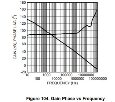

The problem with 1612 is its output phase starts to shift sharply under 1KHz. This makes the mid bass a bit dry and thin.
On paper, looks like LME49720 is a good replacement. The THD is still very low and the phase shift keeps flat in the audio band. MUSES OP output phase runs up a bit in the HF area, still not too bad. Teac uses MUSES in their UD players which are AKM based. Probably MUSES and AKM are a good match? It's worth of a try.

The phase is only 90degrees in the open loop condition - see the attached plot. All opamps have such a phase shift in the open loop condition, they only vary in the frequency. Its guaranteed by them being dominant-pole compensated. Closed loop there is no such phase shift apparent.
So what was it which made OPA1612 such a poor choice?

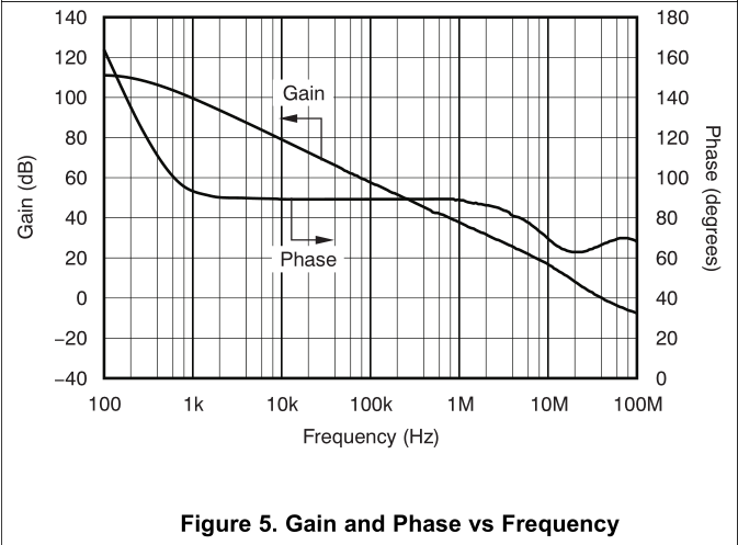

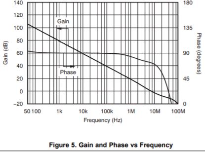

Look at how flat OPA1642 and LME49720 are at audio band:
They're stuck at 90degrees throughout the audio band - but if your theory about time delay was correct, the 90degrees phase shift they show at 100Hz means they too must contain a delay of 2.5mS. So what gives?
