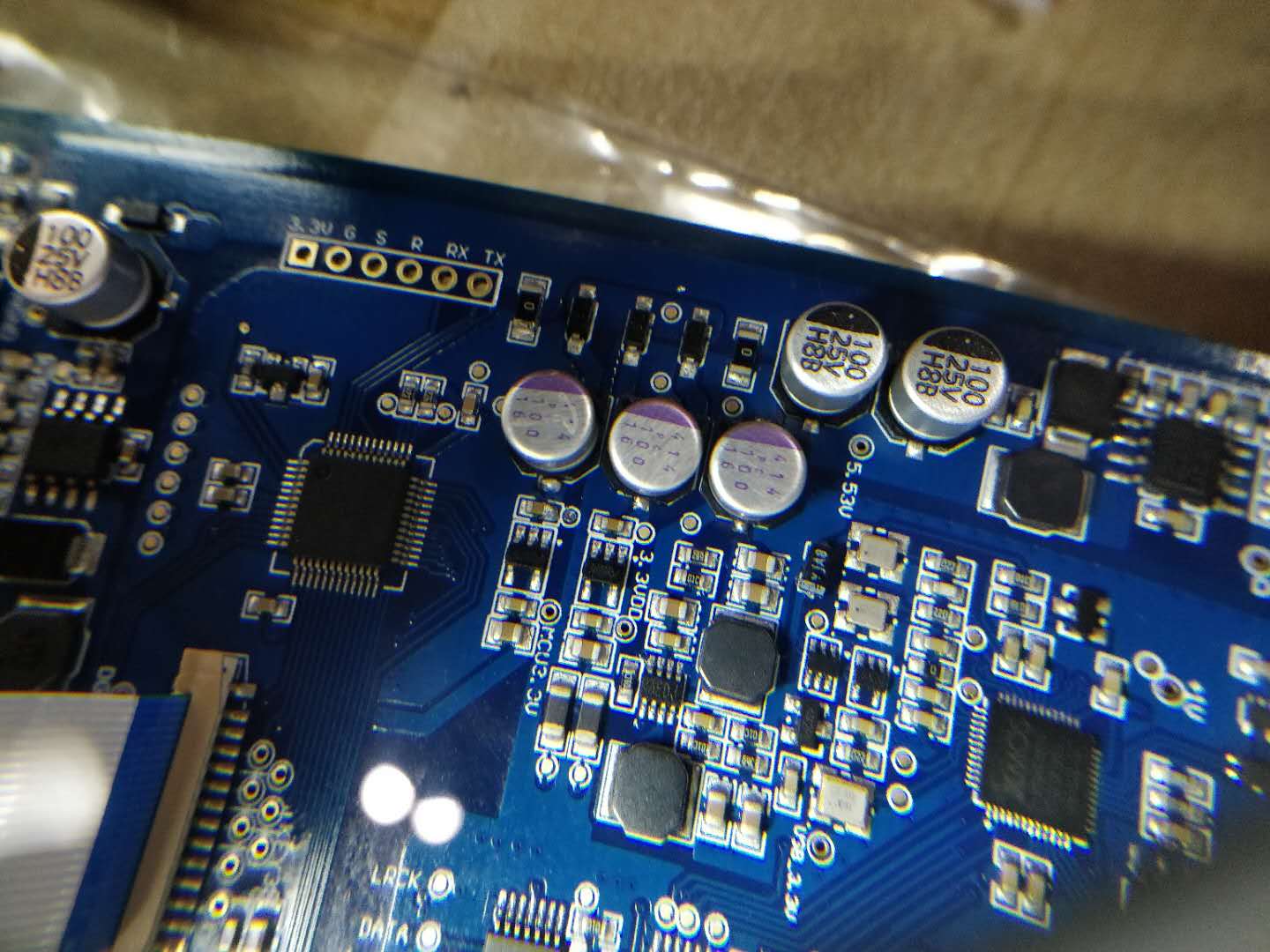

Replaced the three e-caps in USB section with Oscons.
Like discussed above diminishing returns. No real audible difference other than it didn't harm the sound in any way.

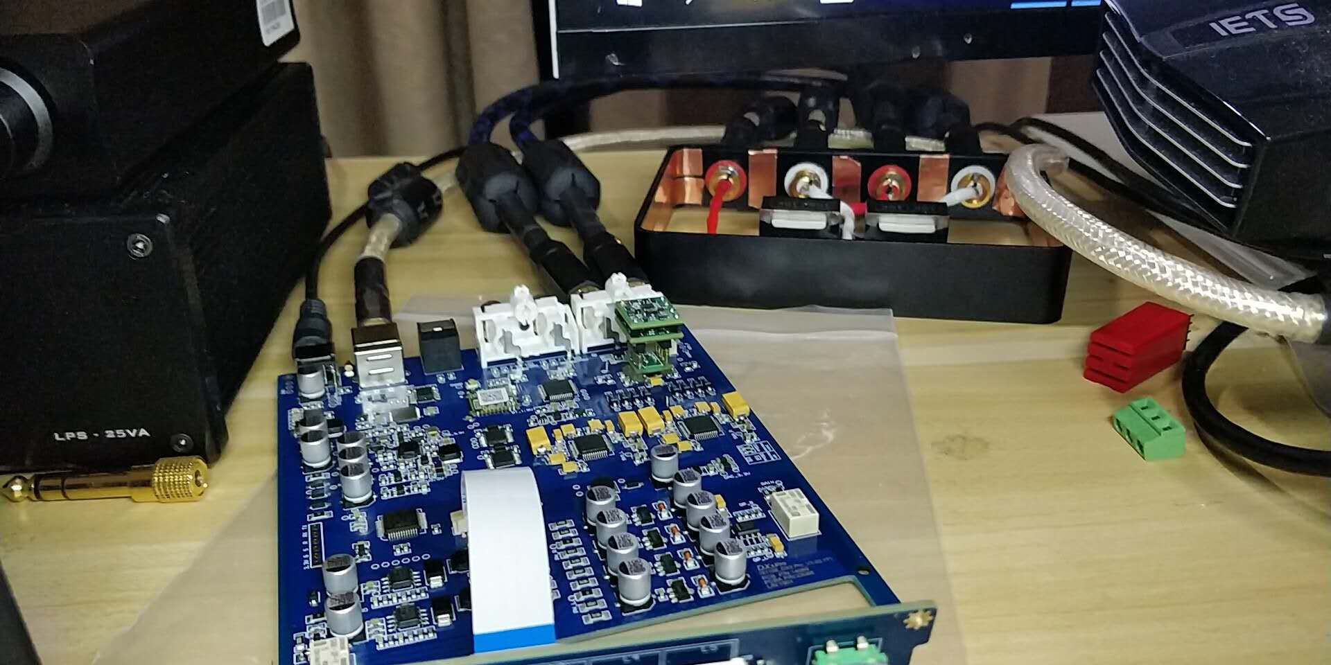

On another note I add in the transformers after the opamp. Next step would be connecting it before the opamp and see how that sounds but it was just a little try.
I did have to shortcut the ground signal or else it would keep humming. so ground is bypassing the transformer.
attachment.php
Result: it smoothened out the edgy highs a little bit. Still same transparancy i'd say.. Not much other to say about it. I'll have to do some more precise listening. Today I've just been playing music mostly and looking for new music and enjoying it.

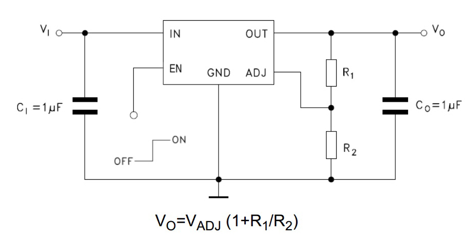

XMOS XU208 needs clean 1V power to pin 39 (PLL_AVDD). So, feed it. Difference is remarkable (Topping D10).
OR
Make simple RC filter:
(From XMOS datasheet)
"The PLL_AVDD supply should be separated from the other noisier supplies on
the board. The PLL requires a very clean power supply, and a low pass filter (for example, a 4.7 Ω resistor and 100nF multi-layer ceramic capacitor) is recommended on this pin."

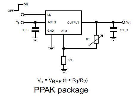

LDO - LDK130
R1 - 1.3kOhm
R2 - 5.6kOhm

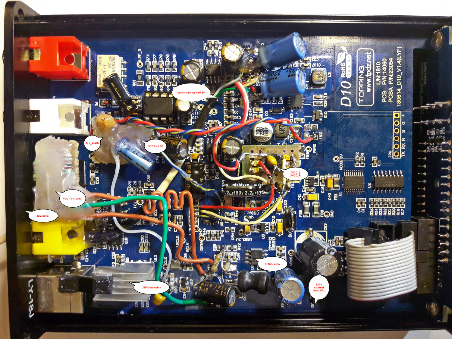

I have used lt3045. Sound is more fluid and less harsh. Problem is that 99% designs use internal 1v regulator and this is then filtered out with small ferrite and capacitor. But huge amount of noise goes into the gnd and this gnd is then polute all other lines trought caps back. You must use heatsink because 4v and almost 150ma is qute heat for a regulator.
Of course you must disconnect 1v supply that comes out of xmos ic.
I modified stock SPSU (1V) to 2.95V to power linear PSU (LDF - 1V).
So, XMOS VDD is powered from linear PSU (1V).
But PLL_AVDD is powered separately (LDO 1V)

Subjectively...
Airness, better channel separation, sound is more natural. Sounds somehow light, soundstage is more transparent...
I am not sure, but I thing that best results we can achieve when we power separately DAC, DAC VREF (H, L) & XMOS and op amp's with linear PSU's.
SPSU is not for audio.
