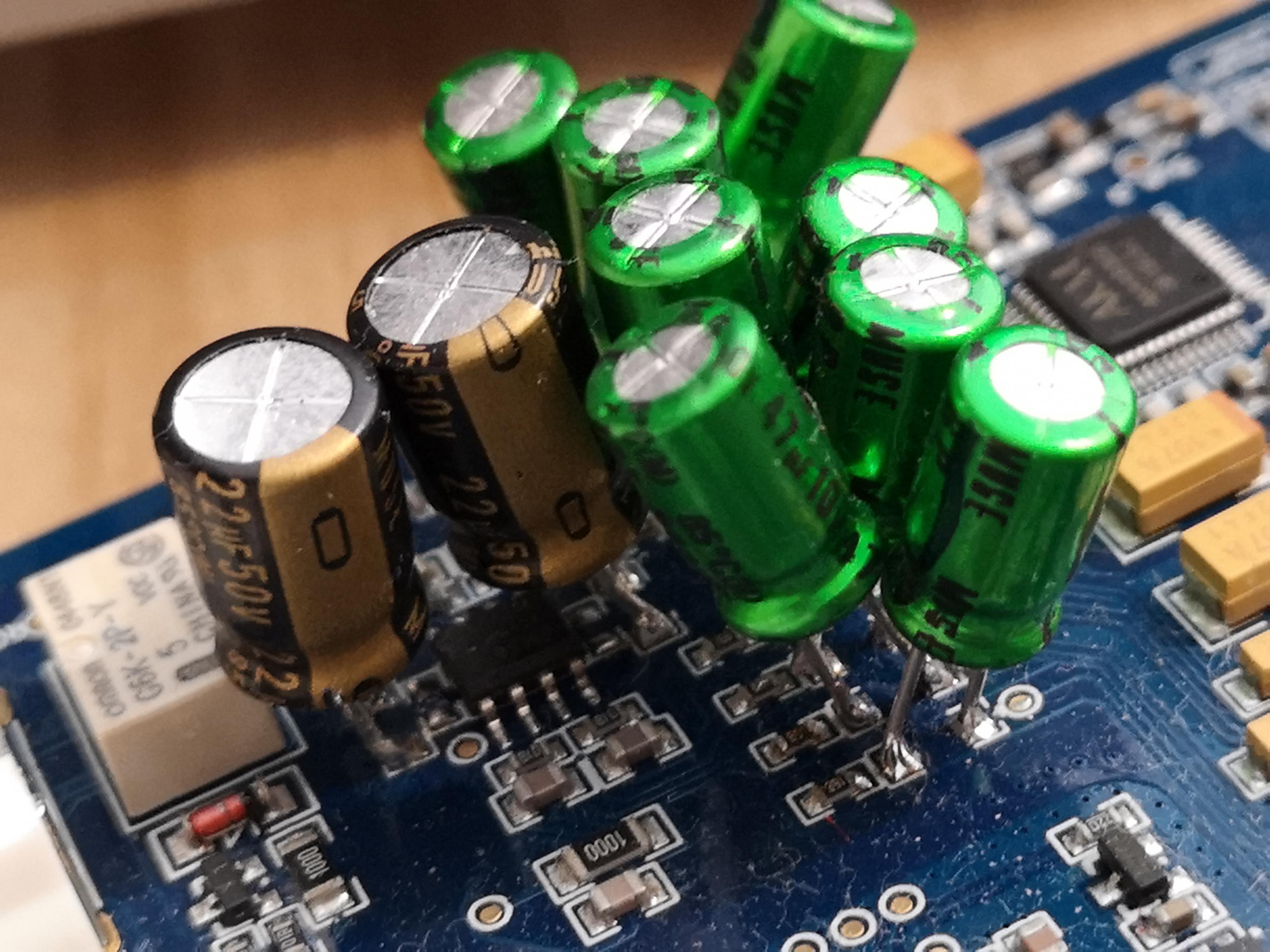

For small coupling caps, I prefer the Nichicon Muse ES. I also recommend you remove the ceramic cap decoupling the opamp. I remove both the ceramic and the tan cap and replace with Nichicon KZ and the mod give a less clinical sound.
The sparkos already removes the clinical feeling of the sound. But just curious which value KZ did you use?

I used 47uf 10v for the 8 coupling cap and 22uf 50v KZ for the opamp

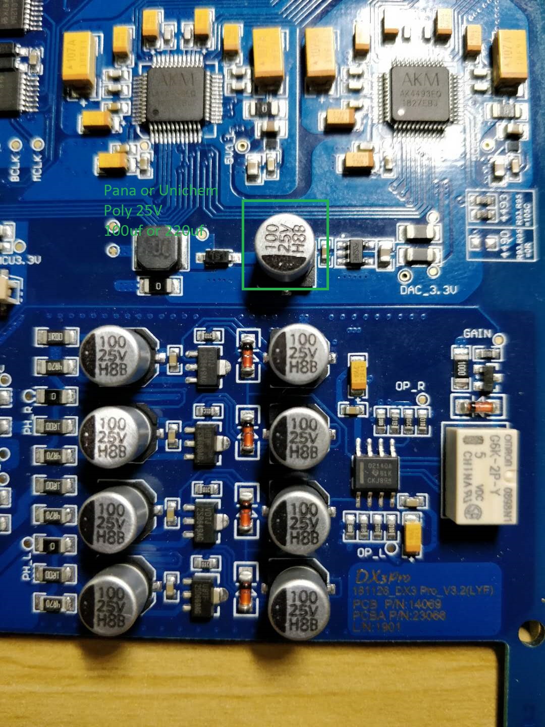

Except for the transformers they are small mods and I except deminishing returns after this. I think the biggest design flaw was the use of those small 33uf caps at the DAC output. Replacing them and increasing the caps at the opamp voltage rails really improved most.
What I miss now is deep bass. My quest continues for deep bass frequencies.
I have to clarify, If I play my plasticman tracks which have great extended lower frequencies I do hear a tight firm bass but it's just not that deep and chest pumping as with my ES9018. The QMS Q5 (also sold as Emotiva Airmotiv 5) are famous for their powerful low end and I used the have this WOW feeling of feeling the room vibrating and my chest pumping. That is gone. Like it doesn't go as low in the frequency spectrum. I still hear the windows resonating and screws vibrating on the desk. But clearly not the same.
The ES is highly tuned and using only high-end caps. and I/V stage has CCS.
The question is if this difference is chip related or circuit design related.

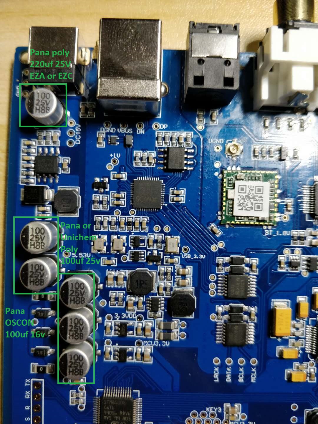

What I can do is replace the PSU input cap with a 220uf polymer and the other 2 on the 5V rail with two 100uf polymer caps for the USB input. And for the 3.3V DAC input also increase in size to 220uf poly or just same value 100uf poly.
What do you think?
What do you think?
In you image above the ak4493 dac, I did a search on the ak4493 ldo "S2RA" and I think it is the chinese MicrOne LDO. Maybe can replace this ldo to something better?
The input is 5.5V and outputs 3.3V to the dac. There is also a 5V supply somewhere.
https://datasheet.lcsc.com/szlcsc/Nanjing-Micro-One-Elec-ME6211C33M5G-N_C82942.pdf
