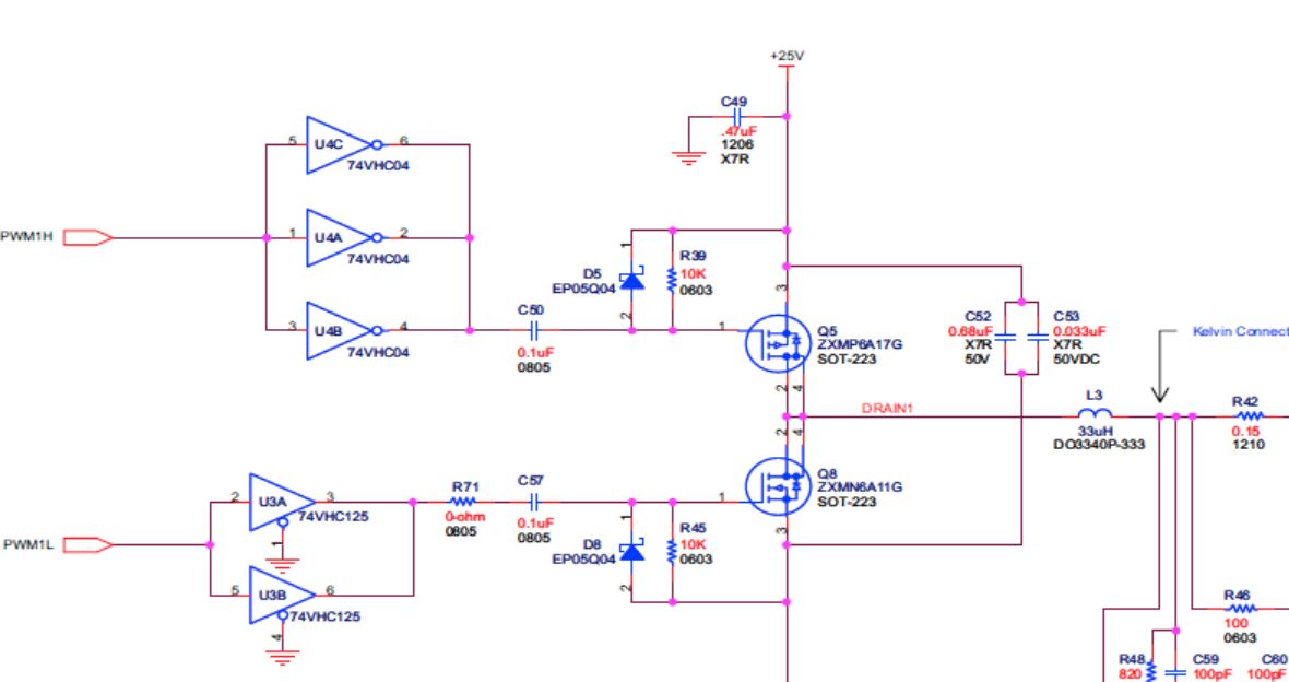

I have add 10nf to one channel and the difference is not that large. I notice Intersil app note for another D2 chip c50 position uses 100nf (note I am just guessing its the same function the 2.2nf cap as in d2p)
I wonder if that cap can go up to 100nf as well.
https://www.intersil.com/content/dam/Intersil/documents/an14/an1435.pdf

When you say the difference is not that large, were you looking on a 'scope with a load attached to the output? There, the difference is huge.
Good find with the app note. 100nF is huge overkill in that application though its probably an X7R which means at 25V its capacitance is much, much less than advertised (10nF potentially).

Upping the 2n2 to 15nF would produce a significant increase in volume into a normal speaker for sure. That's because the FET when driven via the 2n2 barely gets switched on, it can pass roughly 1A before coming out of saturation.
