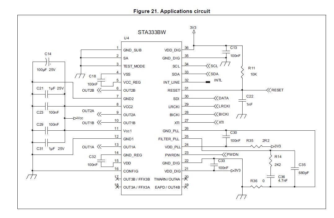

I think I've found one problem, it looks as though I've been over exuberant and removed caps C1 and C14 (see the images in post #167), which are C18 and C32 in the attached extract from the STA333BW datasheet, attached below.
I guess I should start by reinstateg them - let's see if I have any 100nF caps of the right size.

Looking at the STA333 datasheet more carefully I suspect that reinstating these caps should fix the issue - we'll see when they arriveand can troubleshoot further if necessary.
The next big challenge is actually very small - hand soldering the 0603 sized caps.
I re-instated the two caps and I now have music but it is heavily distorted so I'm not there yet.

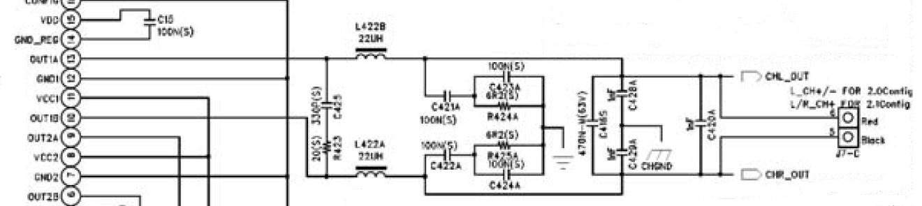

Hi Richard. After unsatisfactory results about a year ago with using my STA333BW board as a HPA I got a bit disillusioned and it gave way to other projects and and it has been dormant and unloved since. Clearing out a drawer I came acorss the output transformers you supplied along with the spare STA333 board so I thought I might give the project another go. The problem is that I've lost the modified STA board (pictured above) along with the notes I kept and, to be honest, it's really not that clear from this thread what modifications I need to make to the STA board. My use case is to run 32ohm headphones and I'm hoping you might be able to point me in the right direction...
The transformers you provided to me have 1300turns on the primary and 243turns on the secondary.
Attached is a schematic of the output arrangements from the STA datasheet, which my STA333 board follows.
IIRC the required output filter is 8.2uH and 5nF in front of the transformer primary and a 68nF cap across the secondary. I also need some 470uF bipolar caps to keep DC out of the transformers? Are you able to confirm that I have that correct?

Hi Ray,
I've been giving this some thought, from first principles as my memory is rather hazy (could be virus brain fog added to that, not sure). The idea of the trafo is to match impedances and reduce the output level, hence reducing noise and improving subjective dynamics.
So given that you remembered the turns numbers we can do the math - 243/1300 means a voltage ratio of 0.187 and impedance ratio of 0.035. Knowing the impedance ratio allows us to calculate the output filter component values. With a pair of 32ohm HPs, the filter at the STA333 output will see about 916ohms. This gives us an output inductor value around 630uH (22uH/0.035) but this isn't very critical and the trafo's own leakage inductance might provide enough. The secondary cap I have found in my simulations, its 200nF.
So overall, I'd not worry about putting L and C before the trafo, let the trafo be the filter. If you're feeling a bit paranoid then 10R resistors in series between STA333 and trafo will provide isolation from trafo parasitics. Yes to the 470uF bipolars between STA333 and trafos.
I hope this is clear, if not, shout!
Thanks Richard.
I'm off work at the moment with a really bad head cold so also suffering from brain fog but, as well as I was able to concentrate yesterday, I did a bit more research and managed to find the STA333 board I modified before - this was unsuccessful as although I had music it was badly distorted. Having checked it out I can see that I removed from the STA333 board all of the output components shown on the application note a couple of posts back so the arrangement is the same as your suggestion except that I only inserted one bipolar cap per output (I replaced one inductor with a cap but simply bridged the other inductor pads) and I think that was a mistake? I'm also missing the caps on the transformer secondaries. What do you think? I guess I can remove the bipolar caps from the board, link all the inductor pads and reinstate the caps on one channel to check it out.
