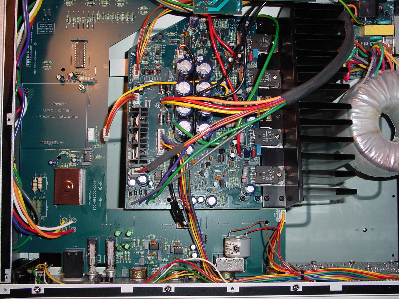

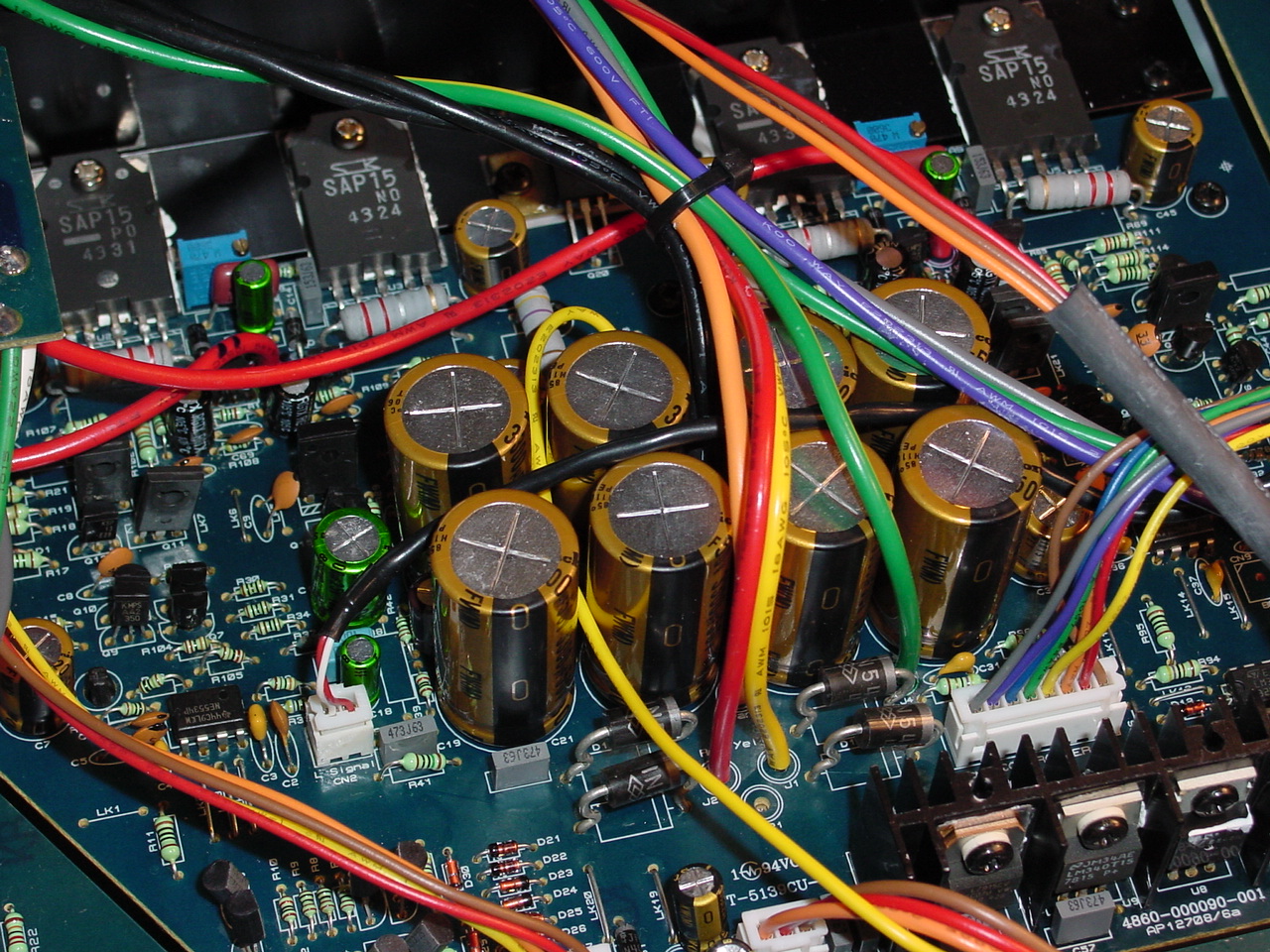

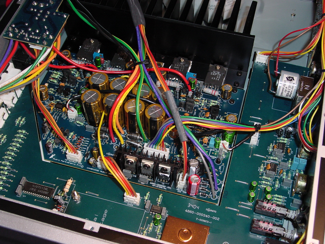

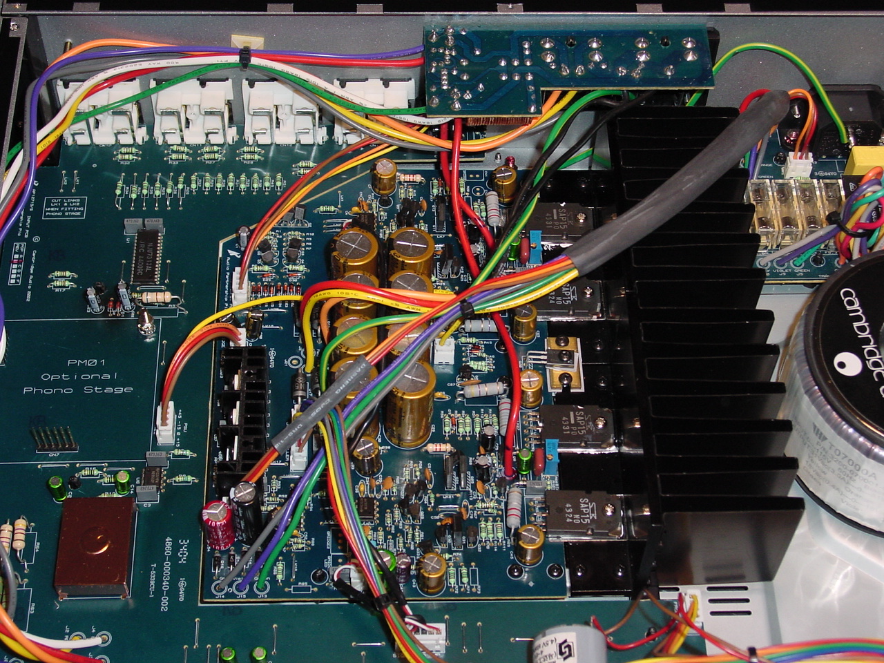

Updating my Azur 640A v1, here are the starting pictures. I am replacing most electrolytics Non-polar with Nichicon Muse ES (the emerald green) and other MUSE.
The 8 main power caps are getting upgraded to 3,300 uF each from 2,200 uF. Build quality is not as bad as I thought, soldering is OK, but the rest of the unit seems pretty good. I am not sure about the quality of the Acon capacitors as I am not familiar with them.
Thought about replacing the op amps with OPA2134, but I am thinking of leaving them alone since I like the sound of the TI NE5532 & 34 op amps (bass especially) that are in it.
This is a really fine sounding integrated.
Some pics:
Some pics:

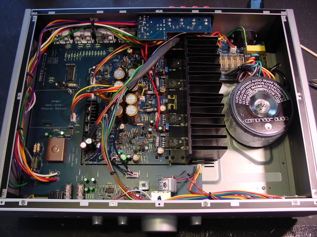

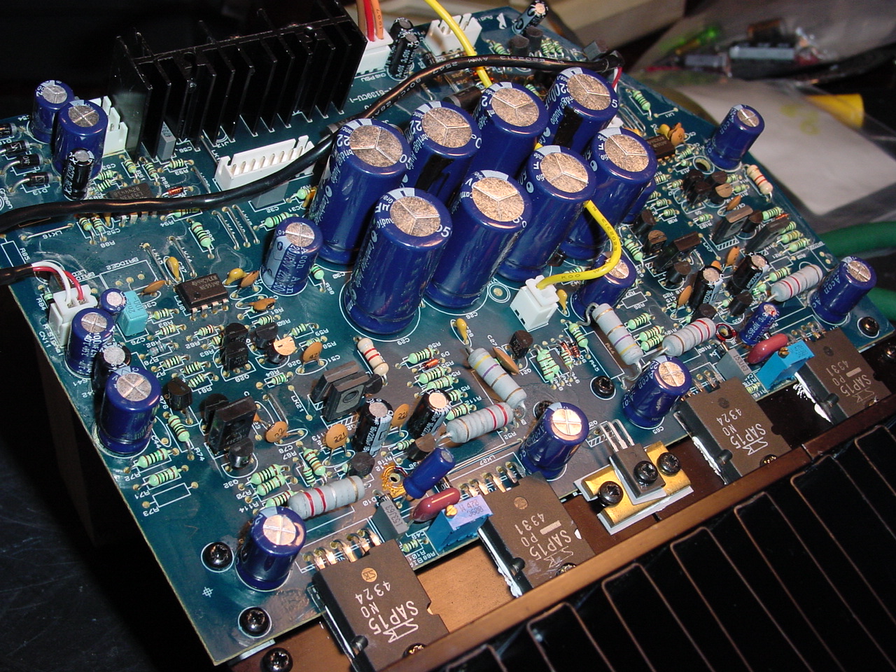

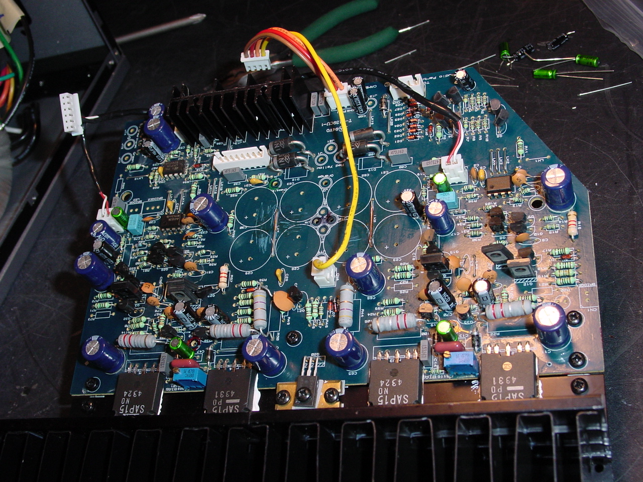

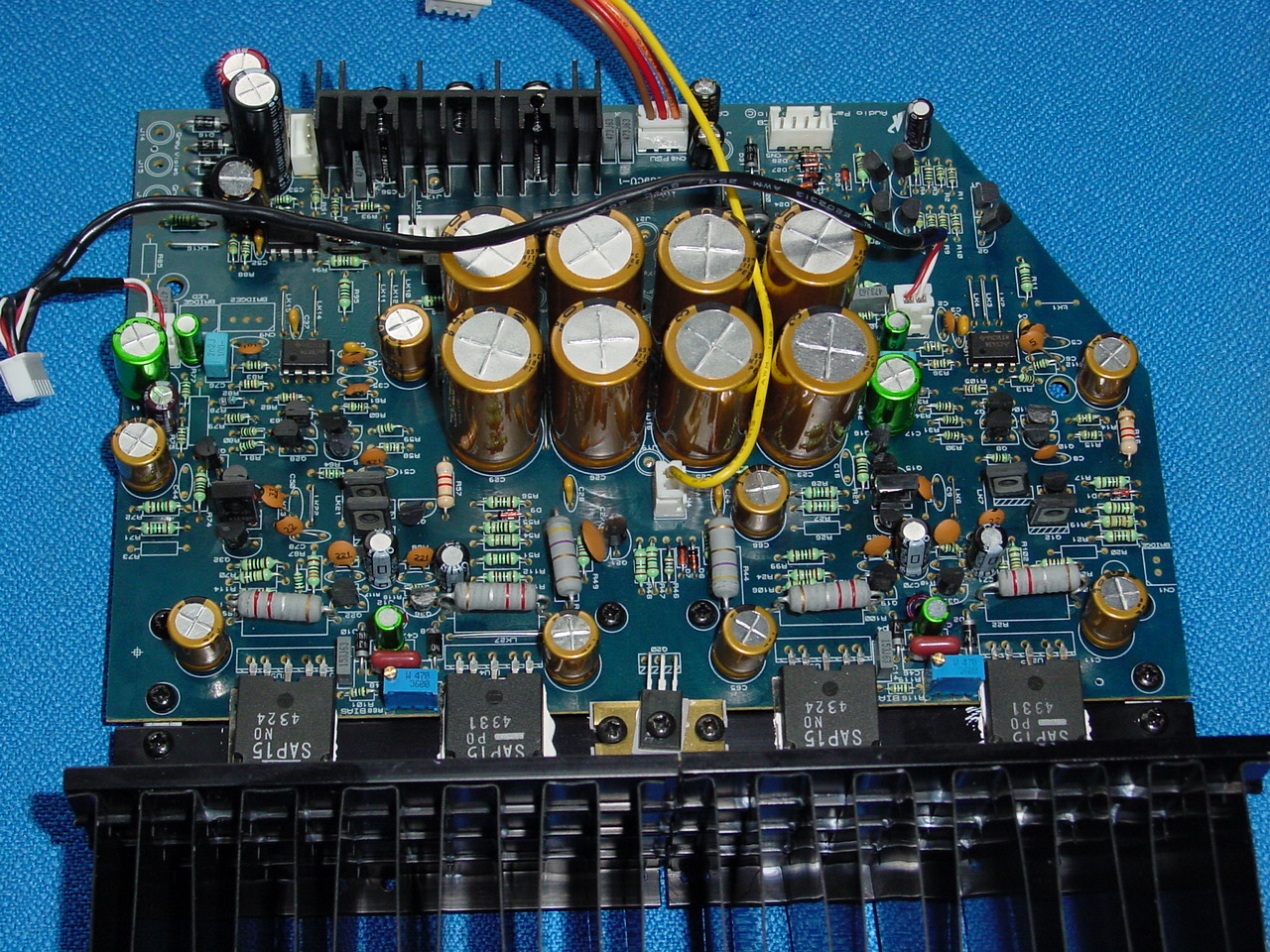

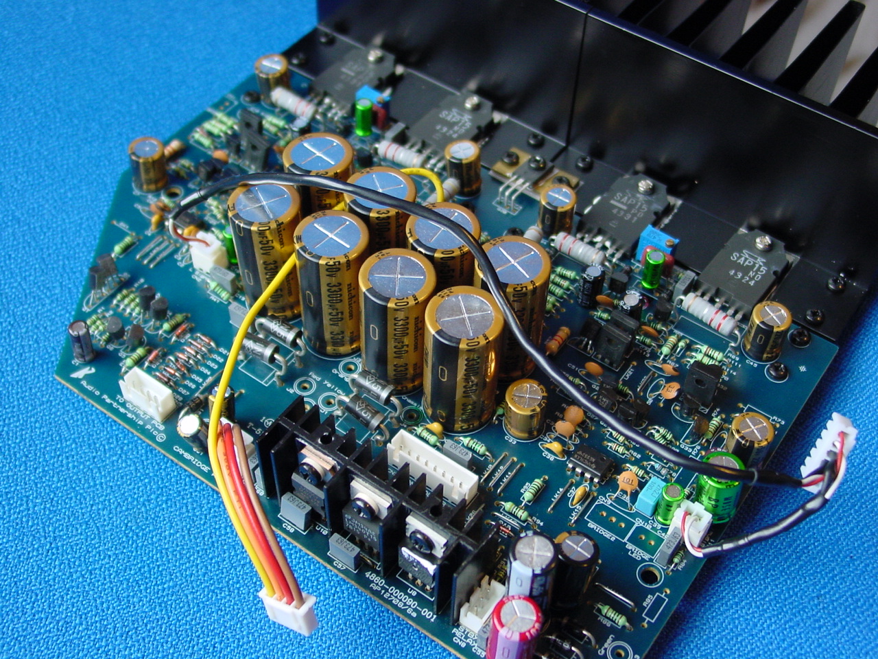

Here are some pictures of the completed recap. I used Nichicon FW, Nichicon MUSE ES, plus a few others.
The verdict on improvement is out until the 200 hour burn-in period is completed--at least I did not blow up anything.
The main power cap reserve was increased from 17,600 uF to 26,400 uF, should have enough power for dynamics. Took the opportunity to clean the boards.
Had a really nice solid aluminum heat sink to add, but could not fit it in the case.

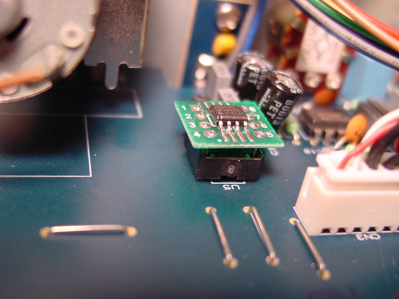

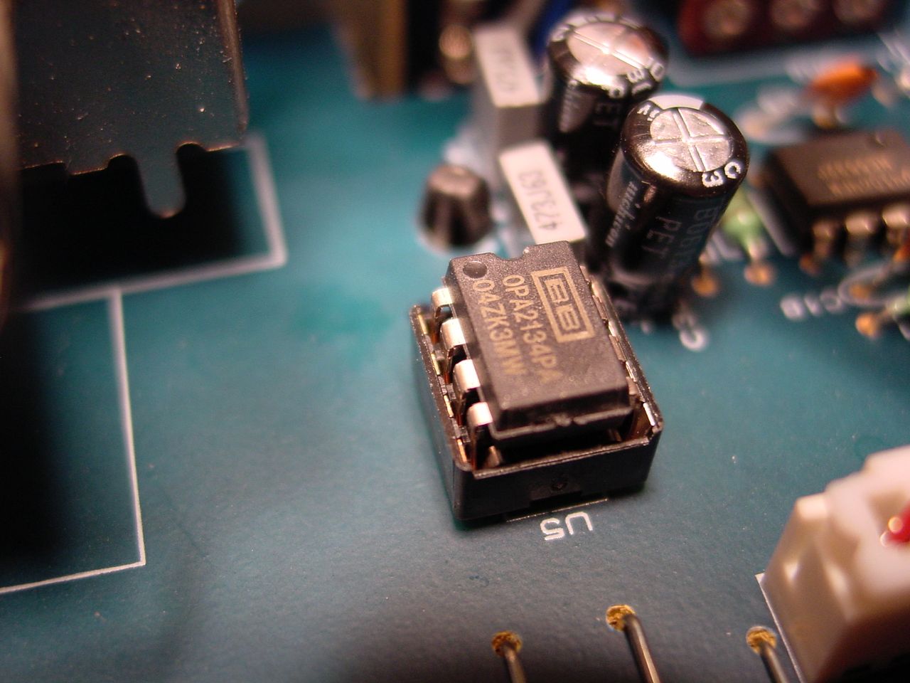

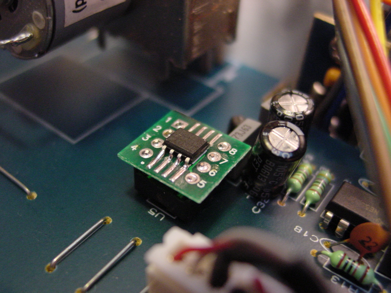

OK, I installed it. I ordered it plus a socket so I can roll the op amps. My next one is the AD8599 (SD mount) on an adapter, I think will be the top dog.
Here is a pic of the OPA2134 in the socket. Sounds quite nice, a bit more forward than the NE5532, I think I like it better.
The AD8599 op amp arrived today. I immediately installed it. I did perform before and after evaluations. The AD8599 is a few levels above the OPA2134 to my ears. I do not have the audiophile lingo to describe it, but the Azur was not the same afterwards, it was much improved. The bass becomes less bloated and more impacting, the mids come forward in a very nice way, and the highs clean up ever so nicely. Take my word, this op amp is worth a try. Is not that the OPA2134 is that much lesser, you would be very happy with it until you hear the AD8599. It is a great op amp.
As you can see, it only comes in surface mount and you need to install it in an adapter. If I were not using the 8 pin DIP socket, it would probably not clear the square capacitor next to it.

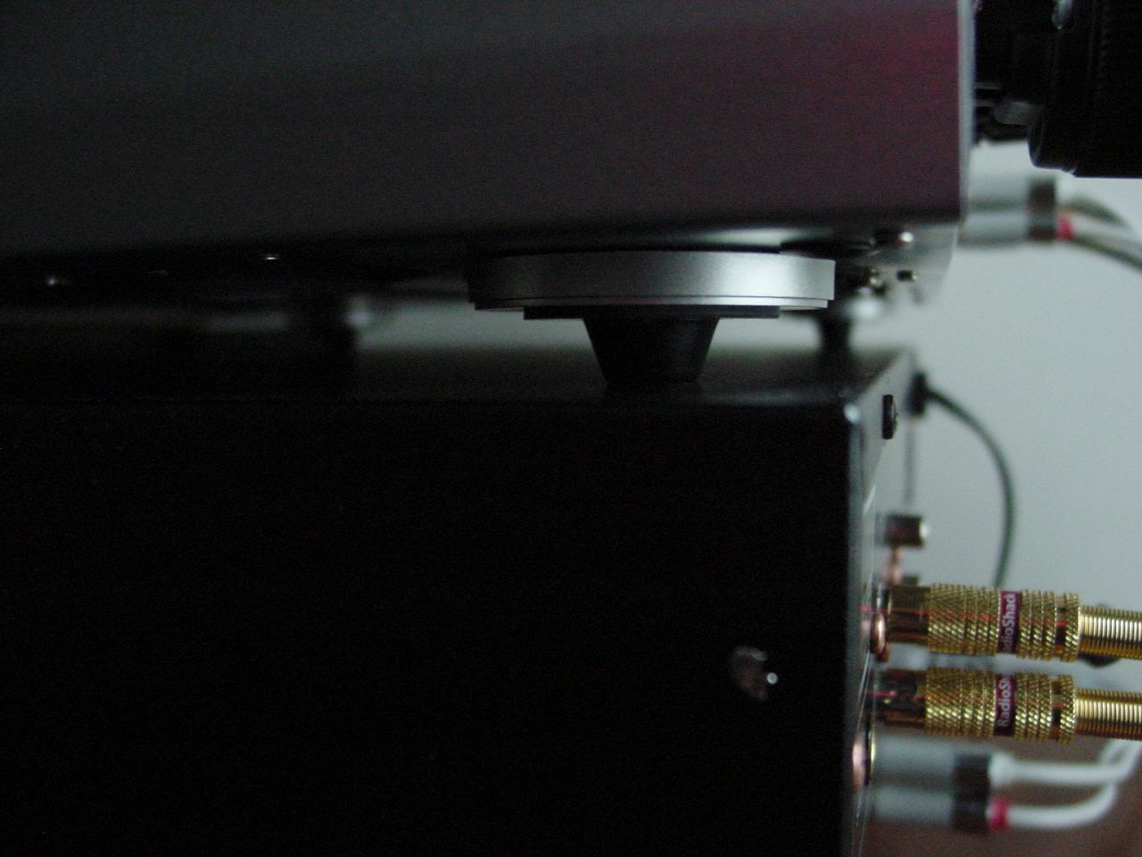

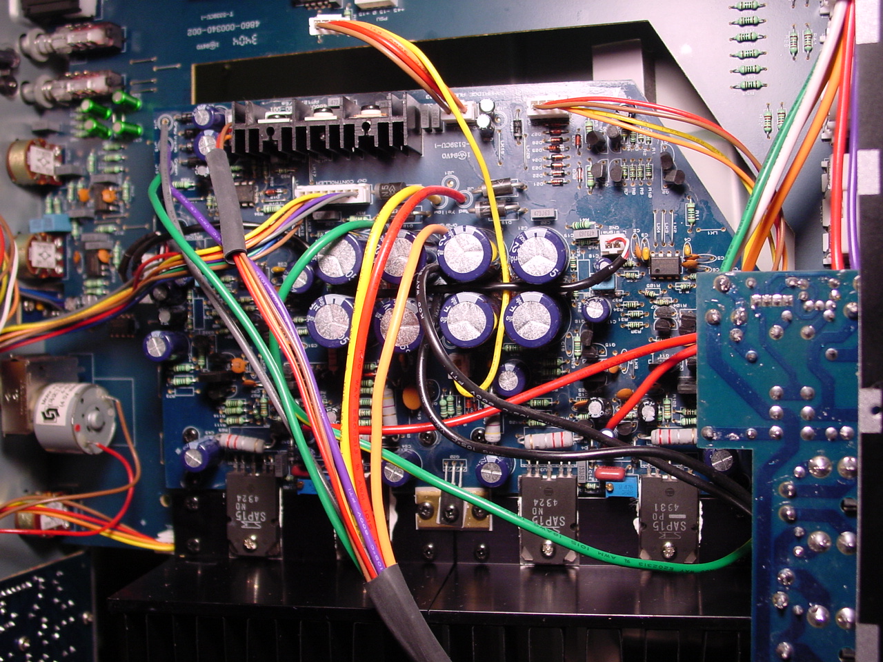

Poor Man's Cooling Improvements for the 640A V1
This amp has a sub par part sheet metal heat sink and heat can be an issue if driving the amp hard. Here's a couple of cheap tricks to help its cooling.
1. Raise the unit by adding some feet.
2. Route the wires to the side of the heat sink rather than above it. See before and after photo.

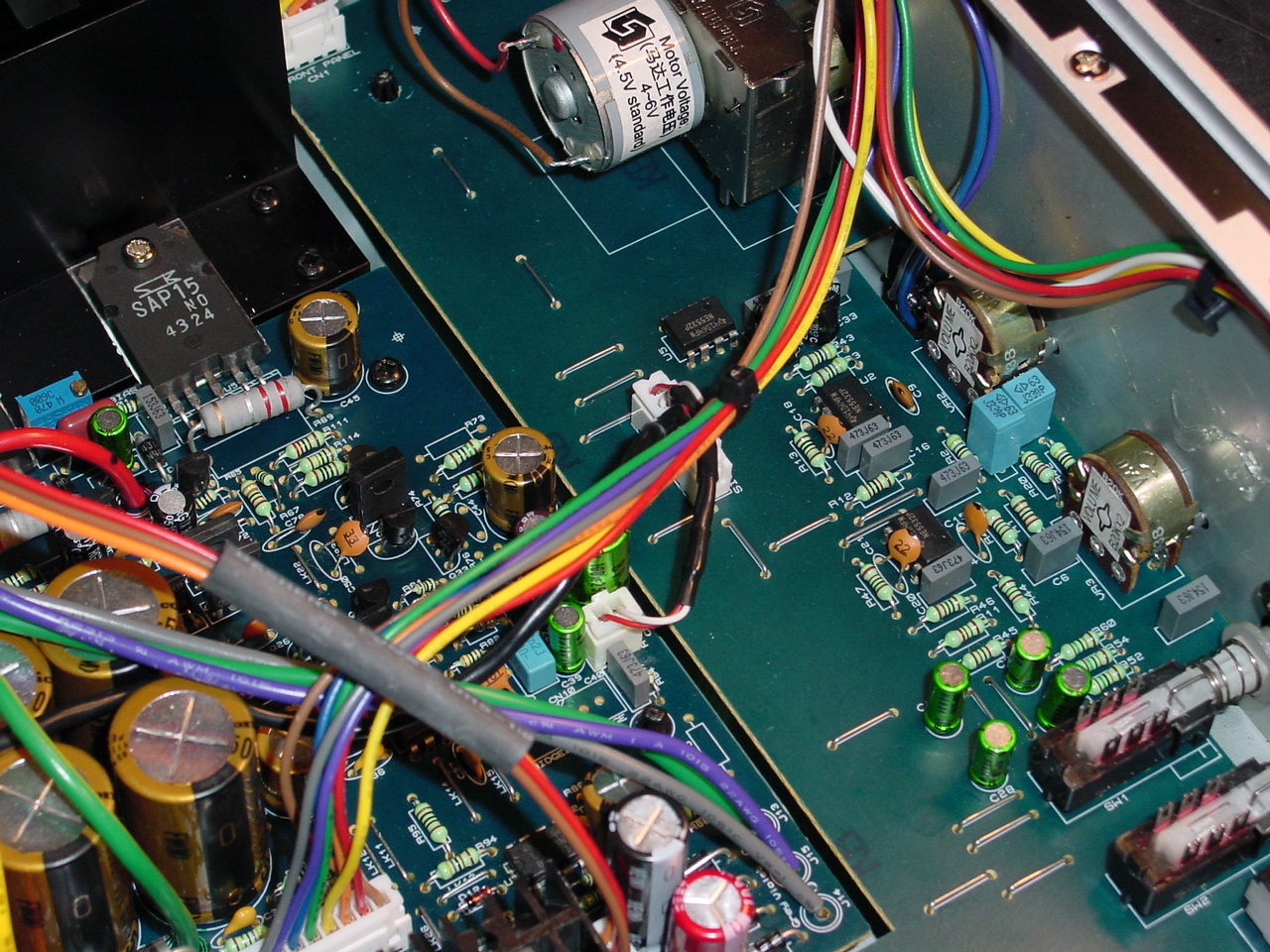

Thanks for pointing that out skidude, I will go back in and install the OPA2134 there and in place of the two tone control NE5532 op amps. So far so good.There is another opamp in the signal path, U3 which is located under a copper shield can.
I placed the OPA2134 in the audio path under the copper shield at the beginning of the preamp. Also proceeded to replace the 2.2 nF bypass capacitors at the entry into the power amp from the preamp with 1 uF stacked film cap (these bypass the 10 uF non-polars). I also installed an OPA2134 in the pre-out circuit to replace the NE5532 there.
It was a total failure. The sound became restrained and very sibilant, reminded me of Dolby C on a tape. I could not stand it.
Had to revert back to the NE5532 into the entry of the preamp and then the AD8599 at the output of the preamp. The other two NE5532 work the tone control and are fine and can be bypassed but do not affect the sound negatively. Also, since it is a lot of work to do this, the 2.2 nF went back in just in case that had anything to do with it.
A learning experience. Sometimes it is better to stop when you are ahead. Hopes this helps someone.
Sorry to hear it didn't go well. The op amp you used is unity gain stable so should have been ok as a buffer stage. The NE5532 is bipolar transistor compared with the OPA2134 which is FET input. My guess is the op amp was oscillating (unstable). The circuit must be quite sensitive as CA used a copper shield can.
