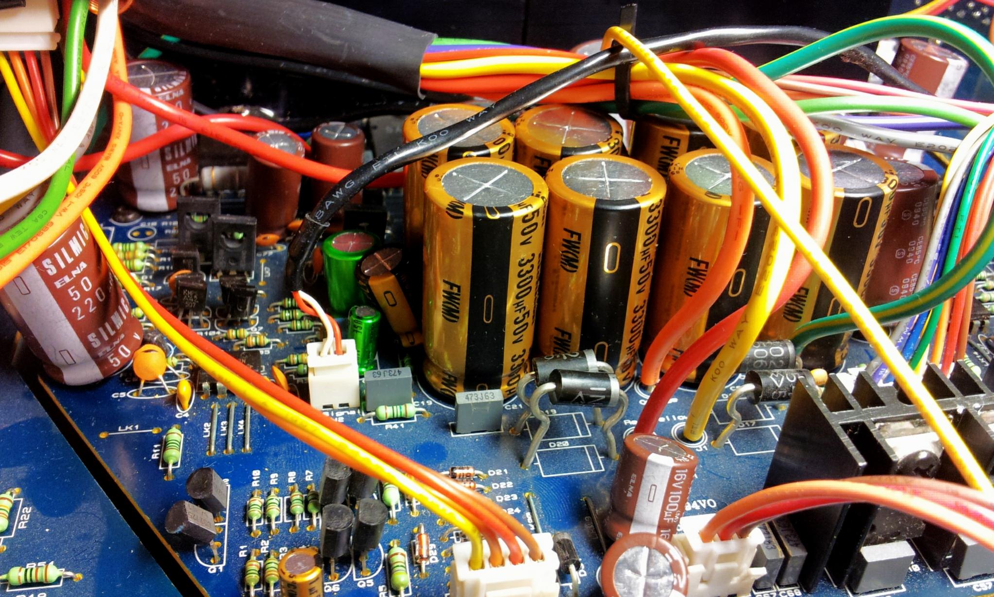

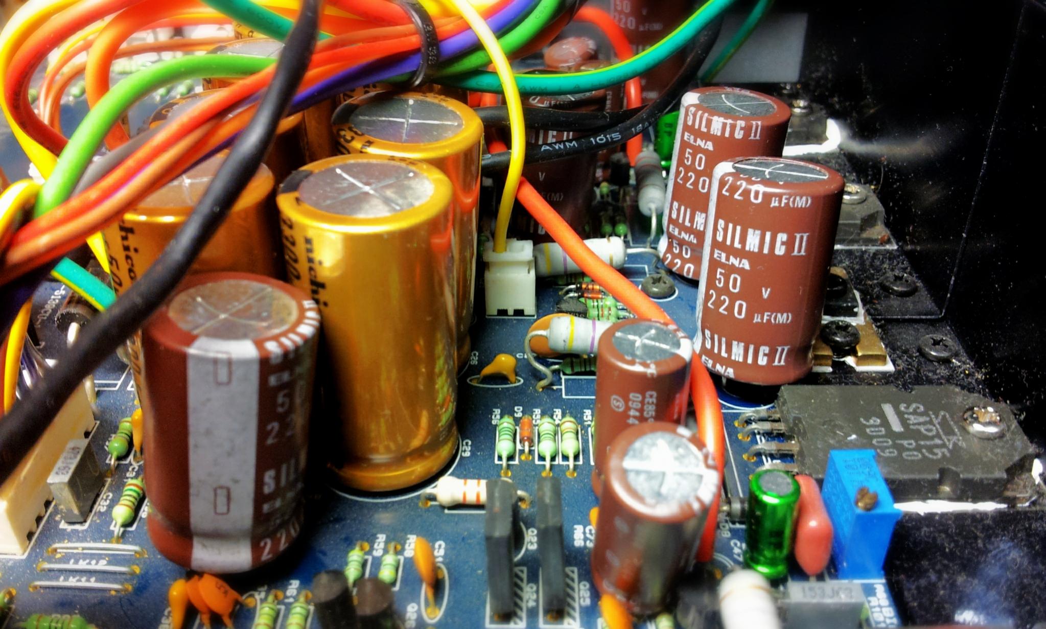

replaced 8 x 2200uF caps in the power supply with Nichicon 3300uF FW series.
full list of caps i used:
10 Nichicon ES 10uf / 25v
8 Elna Silmic II 220uF / 50V
2 Nichicon ES 100uf / 25V
1 Nichicon FG 1uf / 50V
4 Elna Silmic II 220uF 16V
2 Elna Silmic II 10 uF 25V
2 Elna Silmic II 100 uF 25V
1 Elna Silmic II 100 uF 35V
1 Elna Silmic II 47uF 16V
2 Elna Silmic II 100uF 16V
2 Nichicon KZ 47uf / 50V
1 Nichicon FG 470uf / 35V
8 Nichicon FW 3300uf / 50V
first impression after i turned it on - WOW!!!1
after 10 years of almost everyday use i can notice the difference now.
smoother, easy driven bass, clearer sounding overall.
then i changed op-amp in U5 to LME49860, it gave more air and space; don't know how better to express my feelings. although, that impression might be blurred by full recap i did before installing op-amp.
anyway, here are some pics:

I think you are correct, it is U7 from what I can tell in your pictures (marked as 4). I did not have good success replacing op amps except for this last one buffer op amp before the power amp, nearest to the volume control. I would use a socket so it can allow you to try the "best fit" sound and "roll" some op amps. I found Burr-Brown OPA2134 was good, and AD8599 was great. Both much better than the stock NE5532. Changing the tone control op amps was a waste of time, I had to revert back to the original and that goes for the rest of the op amps in the unit. Keep in mind though that I have V1. While you are in there, organize your wires away from the heat sink.
