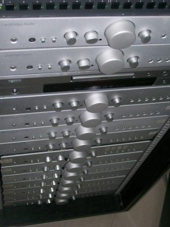

My post picture is just for rest and relax for yuo're all problem with CA 340A/640A. Actually I'am already sold many unit about cambridge audio ( 340,540,640 ) so far so good! and think to mod power supply ( Capacitor section ) unit is good way!

Agus Widarto,
Whats that rack of 340A's for then? Are you using them for a multi channel HT setup?

Thats rack is costume, hand made!😉 no Iam using them for multi room aplification controled by amx
