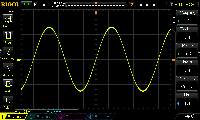

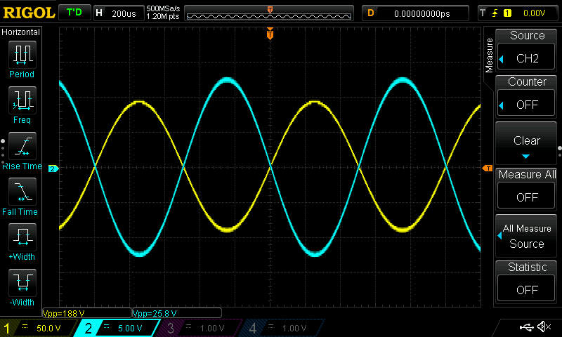

My previous experiments showed that I could get a clean 50 volt peak-to-peak signal out of the preamp when driven by my test oscillator at maximum output. I have an old Acurus preamp that I know to have low distortion so I set up a test with my test oscillator driving the Acurus preamp which fed into the United SiC preamp.
On checking the output with my oscilloscope, I was very pleased to see that the 1 kHz sine was amplified to about 190 volts peak-to-peak before noticeable distortion was visible. The Acurus preamp supplied about 26 volts peak-to-peak to the United SiC preamp. That encouraged me enough to get out my distortion test rig and take some measurements.
To make things simple, I set the preamp chain to output about 100 volts peak-to-peak for the FFT test. I figured that would be enough voltage swing to drive the follower output stage to 100 watts output with some safety margin. The results show a nice distortion profile with 0.029% Total Harmonic Distortion. This is significantly lower than the expected greater than 1% THD from the amp output stage at full power. So, this was good news.

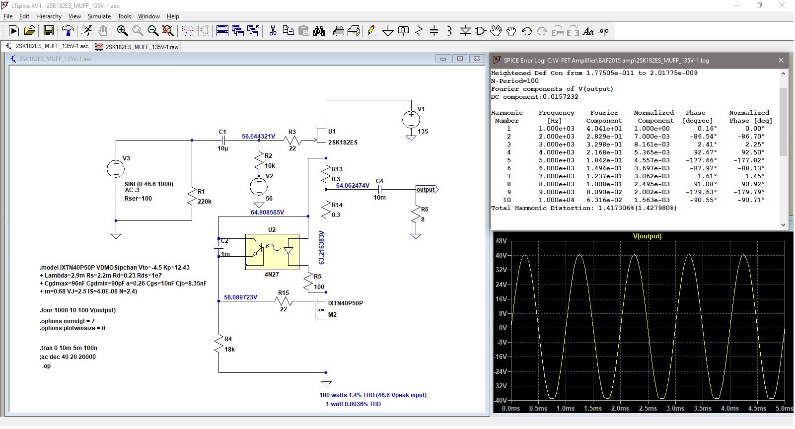

YES, you're talking my language now! The 'easiest' (not cheapest) way to do it, would be common source choke loaded. I have similar intentions of sending it to the moon. I used the BAF2015 circuit and just replaced the current source with the choke, simple enough. Keep it alive with water cooling maybe...?
This was one of the topologies that I modeled with LTspice. Unfortunately, I could only get power output in the area of 90 - 100 watts with much higher current which would have exceeded the capabilities of the Tokin SIT. The 2SK182ES is rated at a maximum power dissipation of 500 watts. I think this device was designed for switching applications and I don't know what the DC Safe Operating Area is. As it is, I hope it can handle 200W with fan cooling.

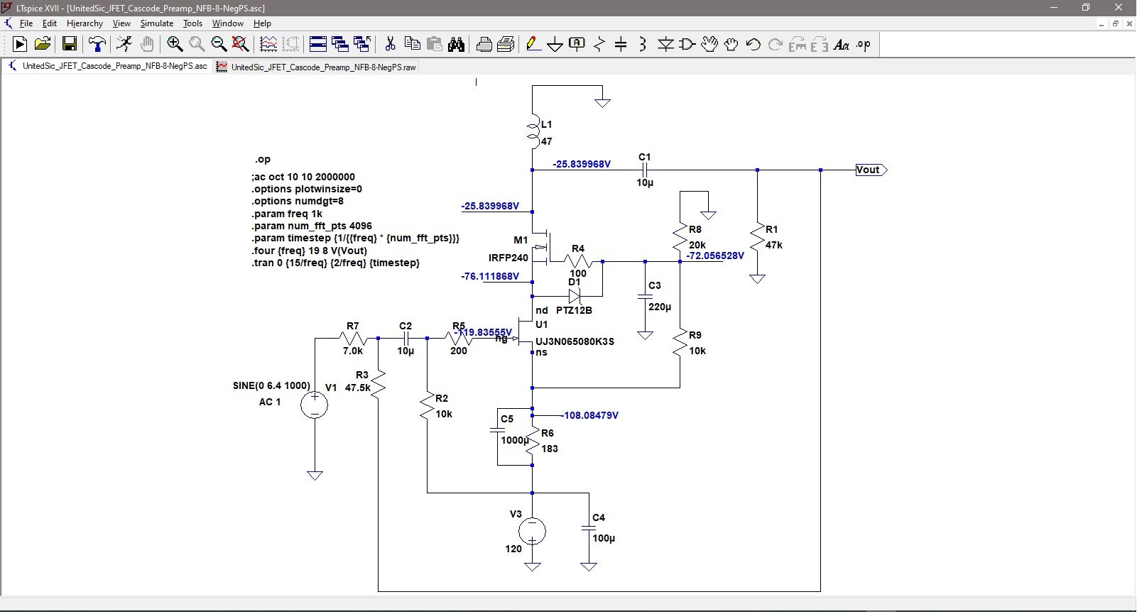

I've decided to use a positive ground for the output stage so the drain of the SIT is grounded. This requires a negative voltage power supply. I intend to use the same power supply for the voltage amplifier stage, since the voltage for it and the output stage are pretty well the same. So, I redesigned the United SiC cascode voltage amp for positive ground.

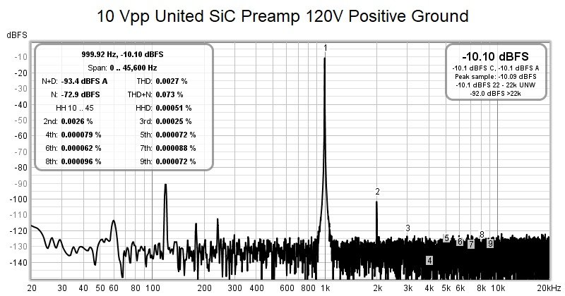

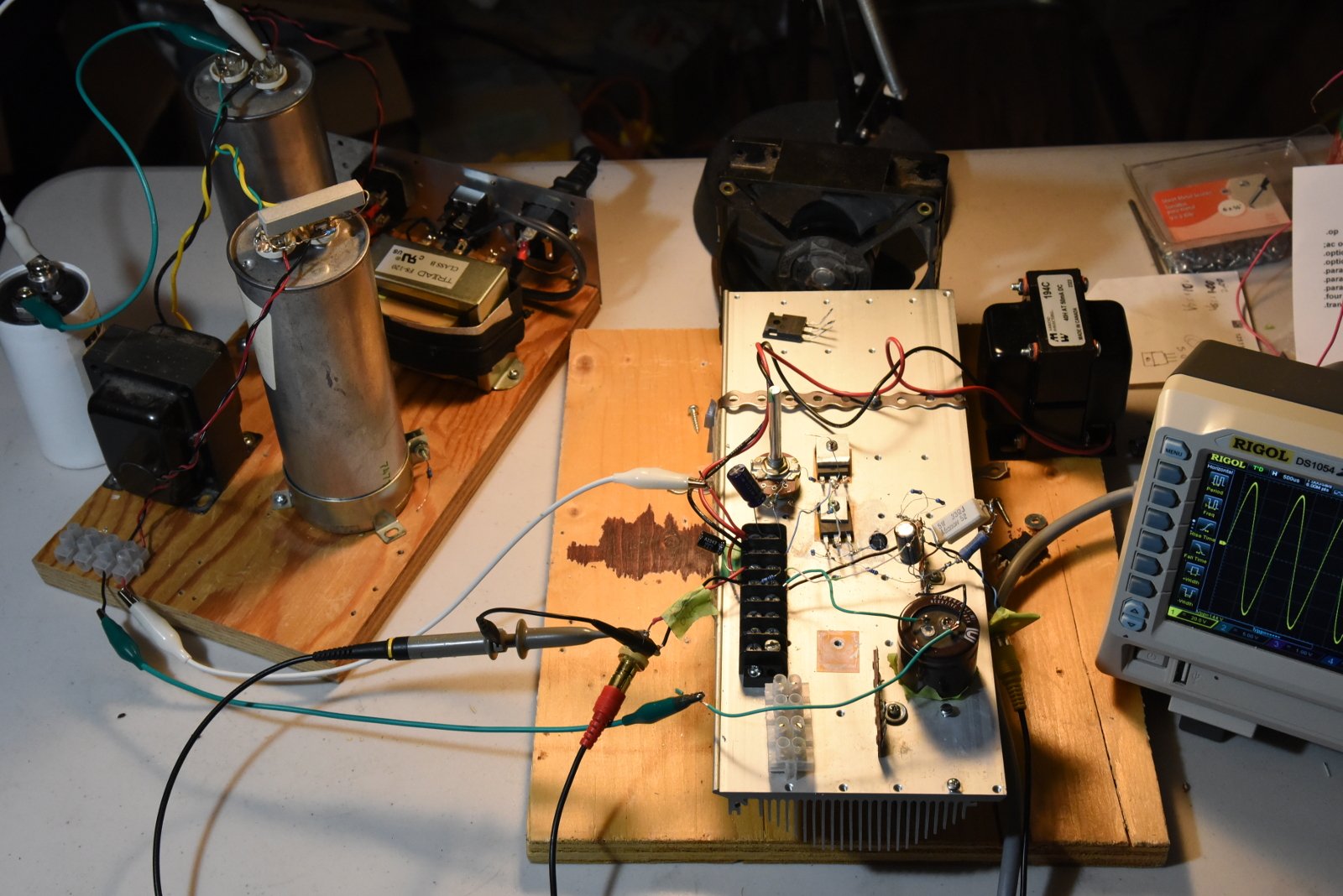

I fired up LTspice and after a bit of playing around, I got it figured out. Of course, I had to verify the design in real-life, so I disassembled my working negative ground prototype and reconfigured it according to my LTspice design. I slowly fired it up using my lab power supply with current limiting and all went well. Connecting my 1 kHz oscillator to the input confirmed that it was functioning. Voltage measurements more or less agreed with LTspice.

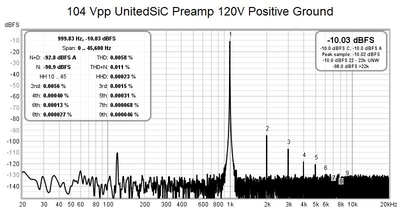

For the subsequent tests, I set the power supply voltage to 120 volts. This will be the realistic achievable voltage that my existing power transformer will supply. I conducted tests to check the maximum output voltage swing and measured distortion at 10 volts peak-to-peak and at 100 volts peak-to-peak with a 1 kHz signal.
Observing the output waveform on my oscilloscope, I saw beginnings of second order harmonic distortion at about 180 volts peak-to-peak. This is a bit lower than my initial test using the negative ground prototype, but I think the power supply voltage was higher in that case, somewhere around 130 volts.
The FFT result for 100 Vpp is better than the first go-around, 0.0058% versus 0.029%, but there are enough variables in the test setup using REW software, soundcard, voltage attenuator, and various cables that all I can say is that the new design appears to have lower distortion.
This time around, I also measured the THD for an output of 10 Vpp, and that came out to 0.0027%.
Overall, I'm happy with the results. Especially since my test prototype is a pretty dodgy affair with poor layout which would contribute to noise.

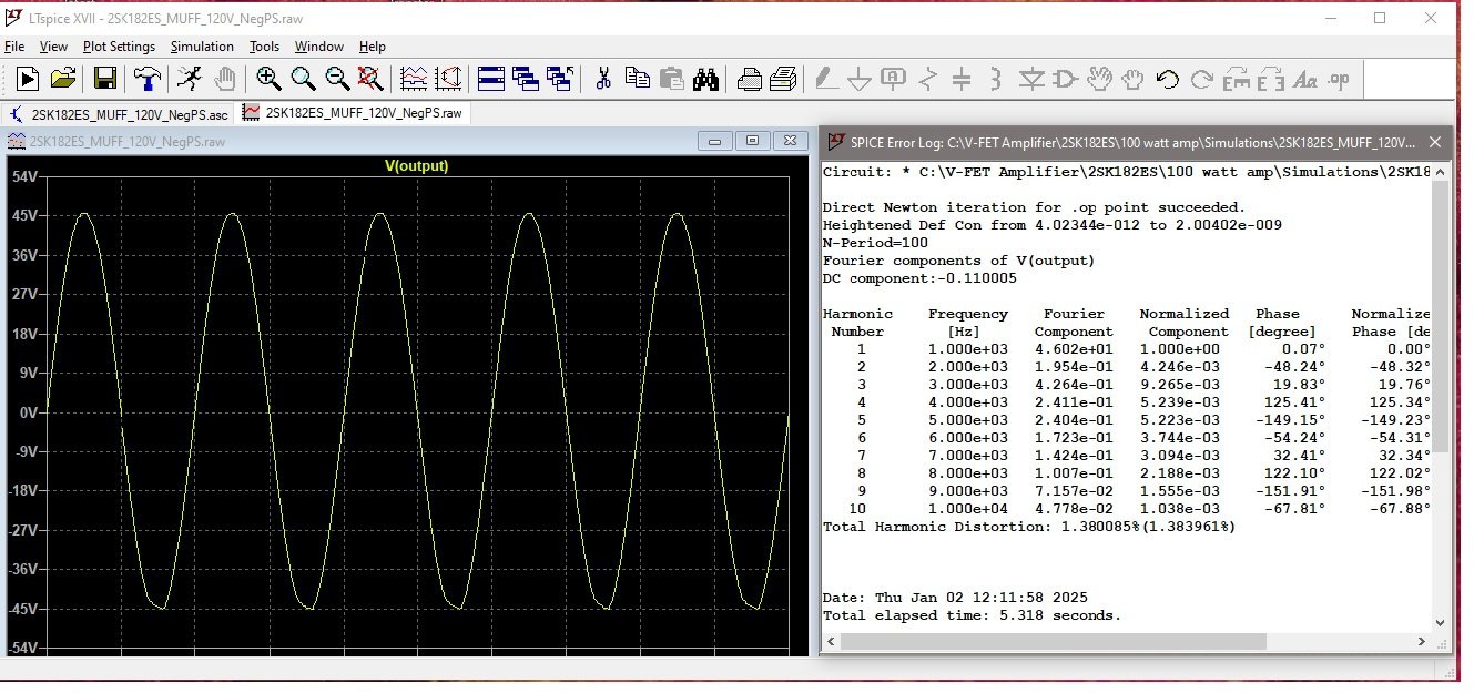

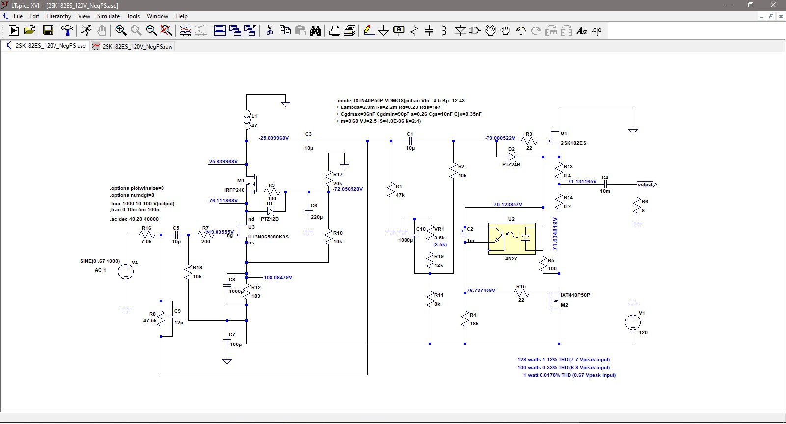

I changed the LTspice output stage to 120 volt positive ground power supply and reran the simulation. After adjusting some values a bit, I managed to get about 90 volts peak-to-peak out into 8 ohms at 1.38% THD. This works out to about 128 watts. Other simulated power outputs: 100W at 0.32% THD and 1W at 0.0174% THD.
Given these results, I think that the goal of 100 watts out into 8 ohms is a real possibility. Time to buy some parts and test the output stage design.

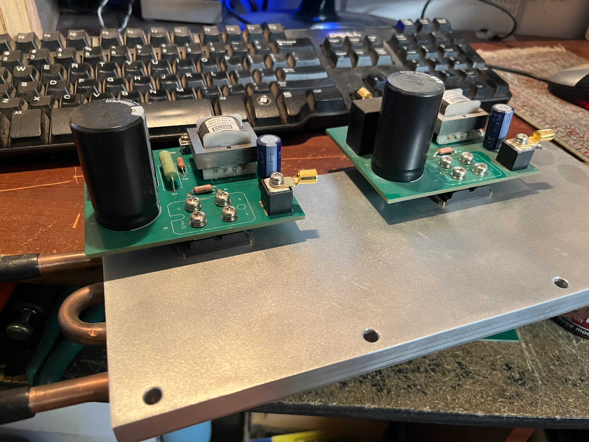

I disassembled one of my BAF 2015 THF-51S monoblocks and started the conversion to the new 100 watt design.
First, the two 50 VAC power transformer secondaries were rewired in series instead of parallel connections to yield 100 VAC out.
Next up, the CLC filter, which uses 4 x 22mF 80V capacitors, was reconfigured with pairs of capacitors wired in series to get 160V DC rating. 16k ohm balancing resistors were added across each capacitor. The end result is a new CLC filter of 11 mF - 10 mH - 11 mF.
After cautiously powering up the new power supply and verifying that it was working correctly, I connected a 40 ohm load to it for a real test. Under this load, the voltage settled in at 120.5V. The current through the load works out to 120.5V / 40 ohms = 3.0 amps. The new amp is designed for about 2.5 amps, so with another filter section to come, the end result should be close to 120 volts.
I was tending towards using a capacitance multiplier for the final filter section, but I managed to find a good deal on some Hammond inductors so I will use another LC filter. This should bring the final ripple to below 1 mV.
I'm trying to reuse as much as possible from the BAF 2015 amp, and it turns out that I won't have to make a new board for the CCS. Because I'm going to a negative power supply, I will be changing from an N channel MOSFET to a P channel MOSFET. However, after studying the two schematics, the only difference is in the wiring of the opto-isolator. I had been expecting to have to totally redo this circuit, so I'm very happy about this.
I've got most, if not all of the critical parts now, so I can proceed to getting the rest of the amp built. To be on the safe side, I've ordered two more 2SK182ES SITs from pras1170. I've still got two pieces but you never know. This is uncharted territory for me, so it's better to be prepared. I believe in the 6 Ps: Proper Preparation Prevents Pss Poor Performance.
Attached is a full schematic including the UnitedSiC voltage amplifier.

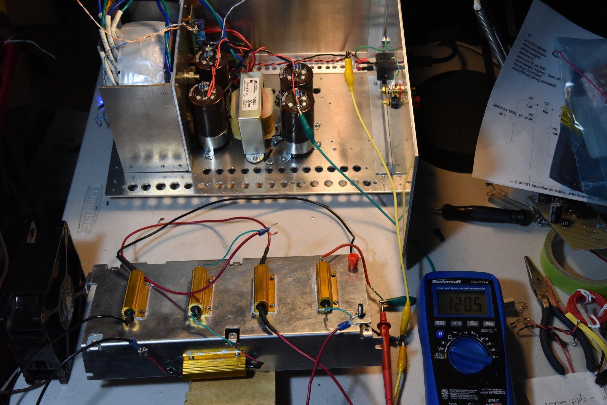

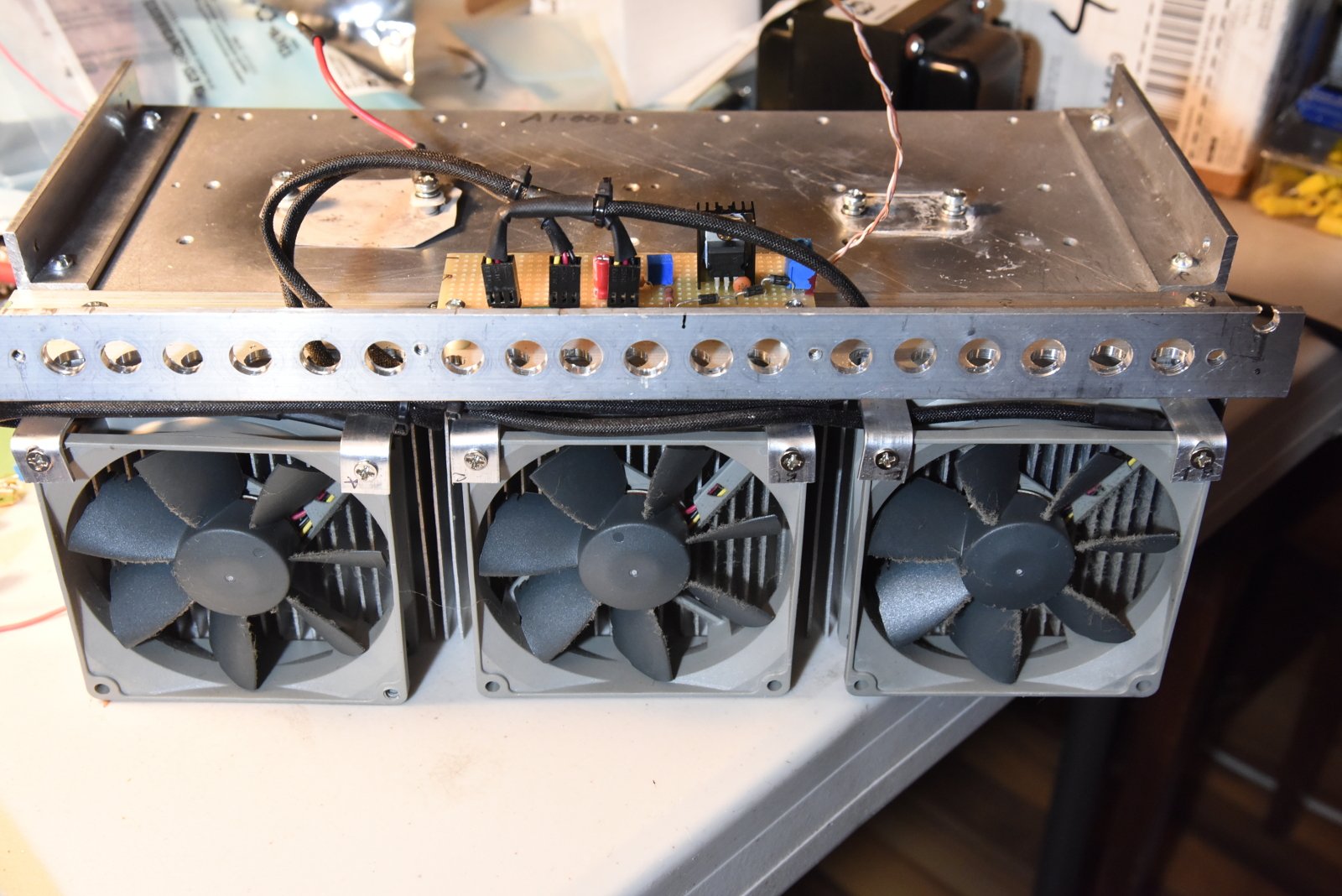

Wow! This is cool. Is the fan running full blast?
Yes, the 4 inch diameter 120 VAC fan was running full blast, and the resistors were getting very hot. They were almost too hot to touch. The resistors are rated at 100 watts each heatsinked, but my heatsinking was not up to par. That's around 360 watts dissipated so it's a lot of heat. I only ran the power supply full bore for about 5 minutes. Just long enough for it to stabilize and take measurements.
The amp will have better heatsinking. My BAF 2015 amp barely warmed up the fan-cooled heatsink when dissipating about 150 watts, so I don't think 300 watts will be a problem.
