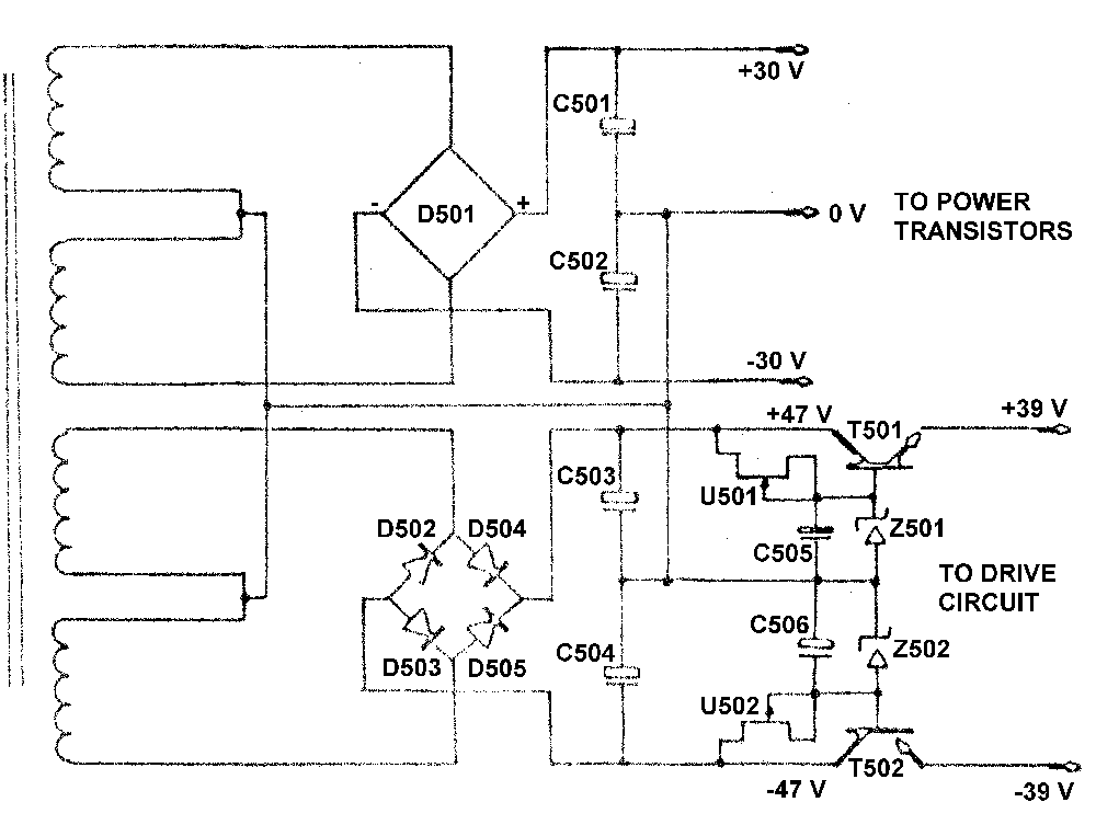

I am rebuilding an Electrocompaniet Ampliwire II and it needs a regulated voltage of ±39 V in the drive section. I have a voltage of around ±47 V available after the filtering capacitors. Is the differential voltage high enough for the Mini Regulator ? The current requirement is around 100 mA.

The sample are still available.
If you use dual mini reg, please change R7 & R17 to 9K/0.5W .
