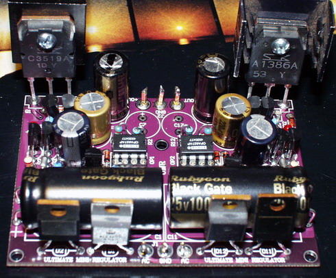

If you want to use plain opamps the regulator must be redesigned a bit but it's in theory possible at least.
It's apparently easier to order a free board than to actually do something with it once you have it 🙂 Mine arrived last week looking all sexy and ready for action.
Now, i've known about Jung's circuit since the time i was subscribed to AA and never felt a serious compulsion to do anything about it. Don't ask me why - it's more than 20 years ago and i've largely forgotten.
Anyway, followed Coffin's instructions and used all the prescribed transistor types, MUR860 and a bit lower filtering capacitance as the current draw is very modest.
Having read about Per Ander's experience with the board i cautiously installed a couple of vintage 5534s into the sockets. Input DC was 20v for 12v output.
200mA load; no oscillations. Getting more brave i tried a 627. Still fine. Similarly stable at currents between 0-200mA were AD8610, AD8065, AD825, OPA637.
An AD797, otoh, drove the regulator wild. If i really wanted to know i could have removed the 100nF smd at output and tried a few tricks to calm it down but do i really need a 797 based regulator?
In the listening tests i used the +- 12v to feed a simple opamp based phono stage which was previously powered from a very nice discrete circuit. 627s were used.
After giving the BGs a chance to settle down a bit i gave it a listen. Very, very nice indeed. A lot more detail and precision compared to my discrete reg and all this without sounding artificial.
Briefly tried the AD825 but it didn't work too well - the sound lost liquidity and became a bit strained.

Coffin,
After looking more closely, I was wondering if 2) LM329 6.9v precision zener diodes (in series for 13.8v) could be used at IC1/2 instead of the 15v 1/2W zener (this is for +/-75v).
R1/2 can easily be adjusted slighty to get to 75v. My concern is proper power/current rating for 2 of these in series.
Any thoughts?

LM329 can be connected in series but it's easier to increase the gain instead. Current > 1 mA is OK.
clarify
When you say "increase the gain", do you mean to simply use ONE LM329 and adjust the R1/2 ratio to compensate?
Yes! The trade off is half the speed.
You can connect the LM329 in series and it is no disadvantage to do that as long as it fits.
Re: other parts substitutes
Hi
IC1.IC2= LM329 6.9V ( ONLY ONE )
R1=29.6K 0.5W or 0.6W
R2=3K 0.5W or 0.6W
cheers
Coffin

wrong voltage: 40v out, not 75!
Coffin,
I used the LM329 6.9v zener and R1/2 values of 28.5k/2.9k which should give me +/-75 v out. But I get +/- 40.5 v out!
From BOTH plus & minus rails, this is too much of a coincidence. It almost seems like the 39v of ZD1 prevents any more V out. I first turned it all on with a variac, and got fine results until Vin got over 45v: then I kept increasing it but Vout stayed at 40!
Any idea what's wrong & how to fix?
-izzy
Coffin,
-izzy

Sure, I'll only list the changes/substitutions I made (aside from what I already listed--the LM329 & R1/2 change):coffin said:Hi
Can you prcisely list all the parts value you use?
cheers
DUH! I feel dumb--I inadvertantly swapped R1 & R2!!
I corrected it, and now I have too MUCH voltage! 82V out (84 in), and the LED's are blown. But ripple is low on one rail (10mv AC) and moderate on the other (140mv)
Hopefully nothing else is damaged. Will replace the LED's and see what happens.
