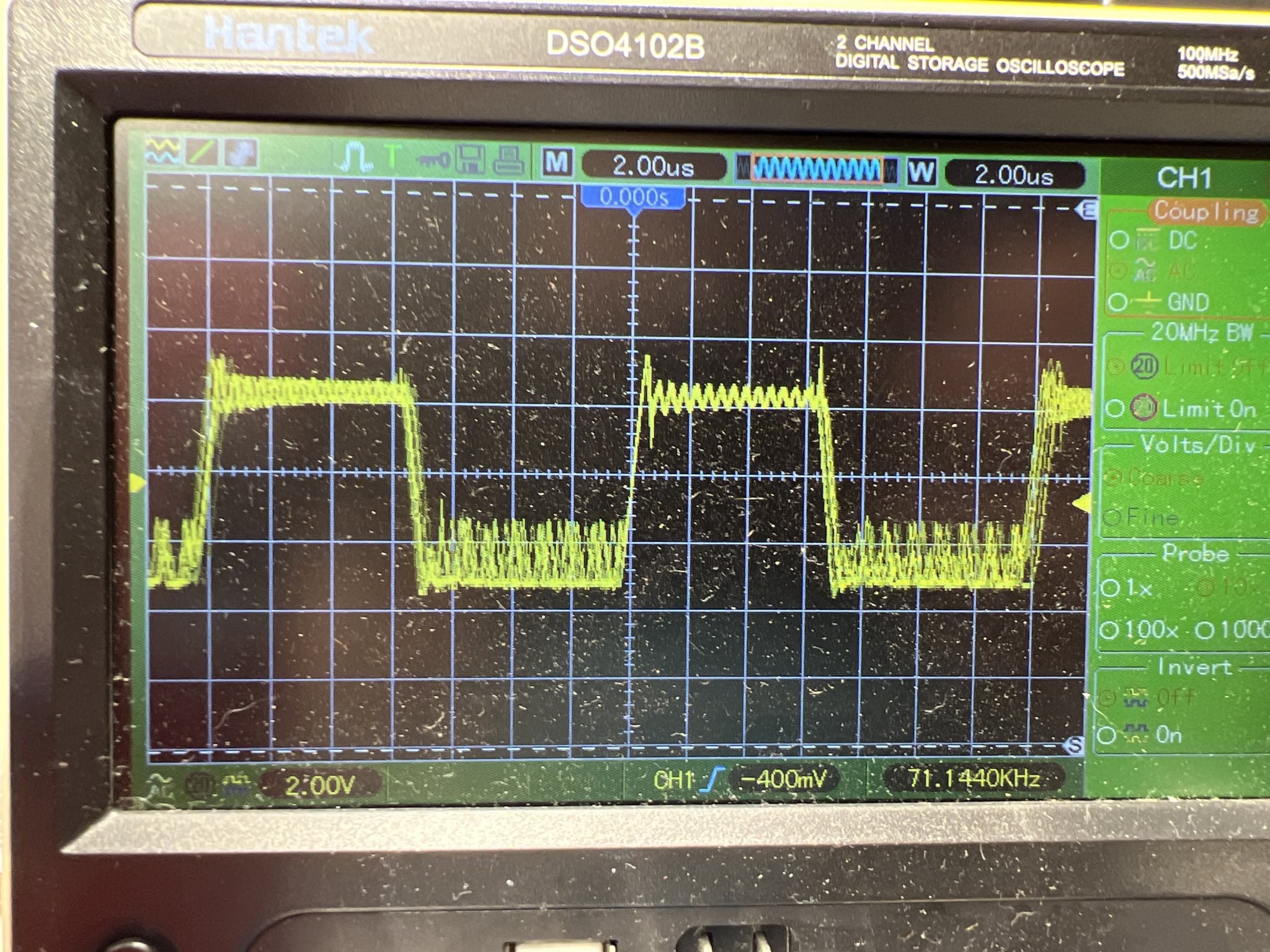

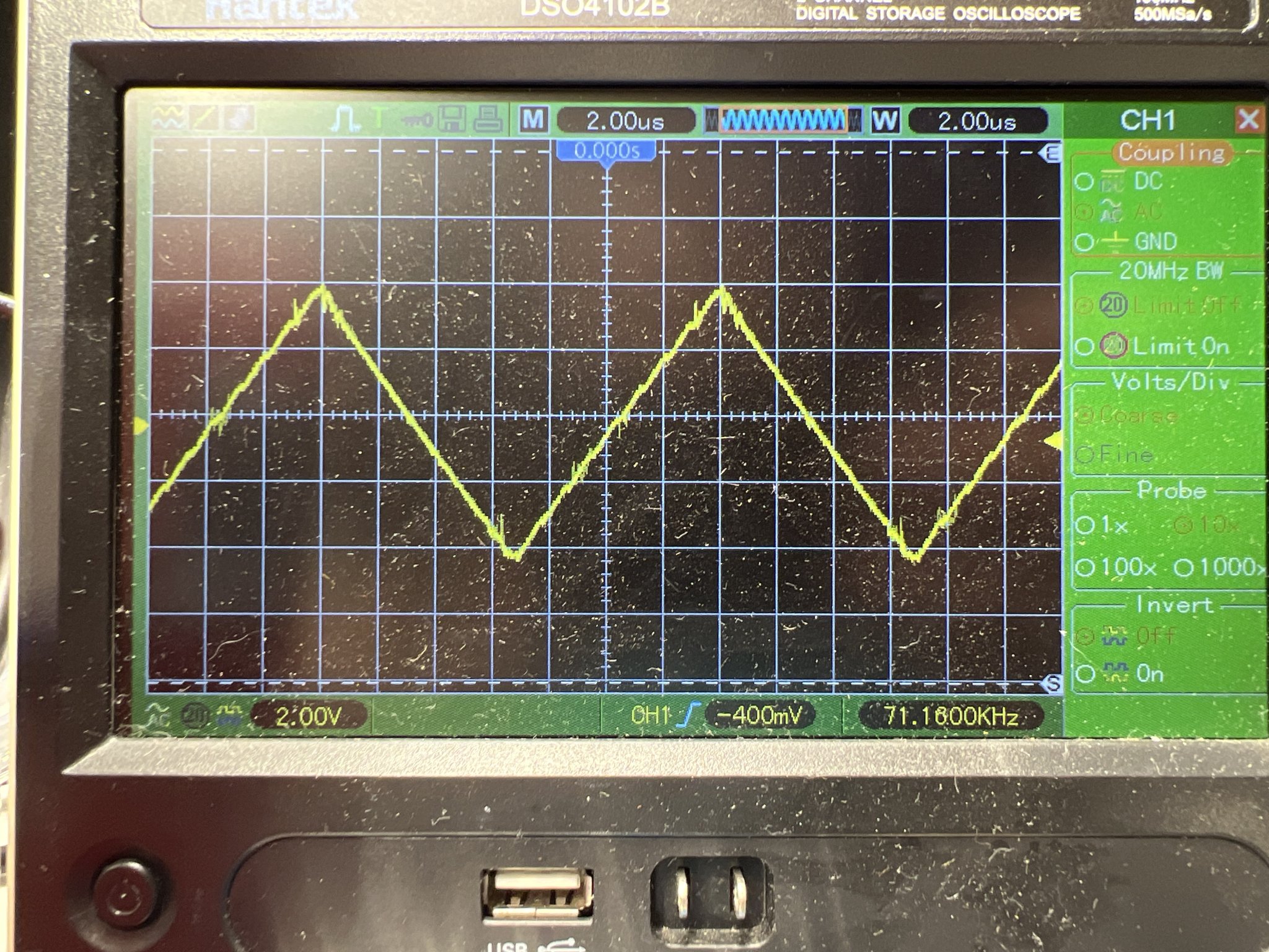

MMats D700.1
Triangle on pin 8
Noisy square wave on pin 7
0.087vdc across pin 5 & 6

Check the cap across terminals 6 and 7 of U2. The output of that op-amp shouldn't have a triangle waveform that large.
On the end of resistors NOT connected to U2, R14 and R16 (PHD2 diagram), is the terminal of either of those resistors noisy?
I don't remember and can't find the waveform, did you say that pin 7 of the 4080 had a triangle waveform?
