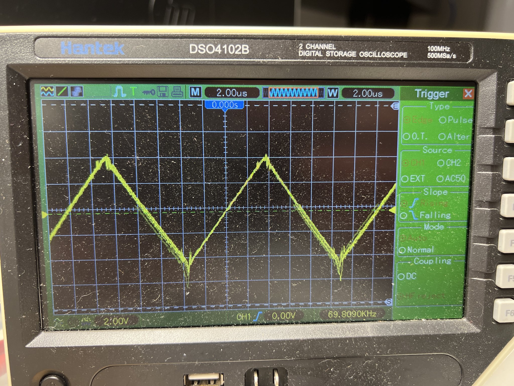

MMats D700.1
1st - Pin 6 triangle

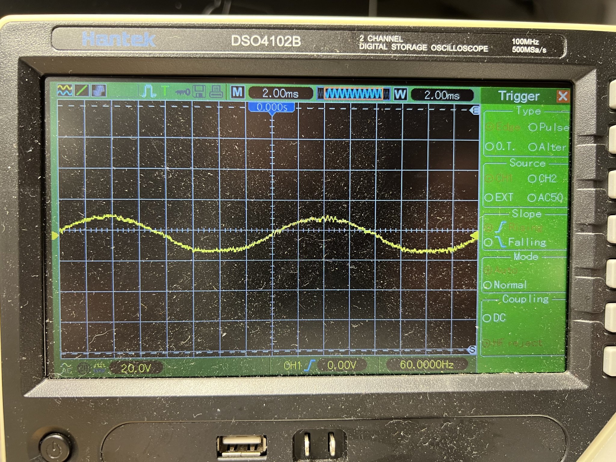

2nd - output audio no load

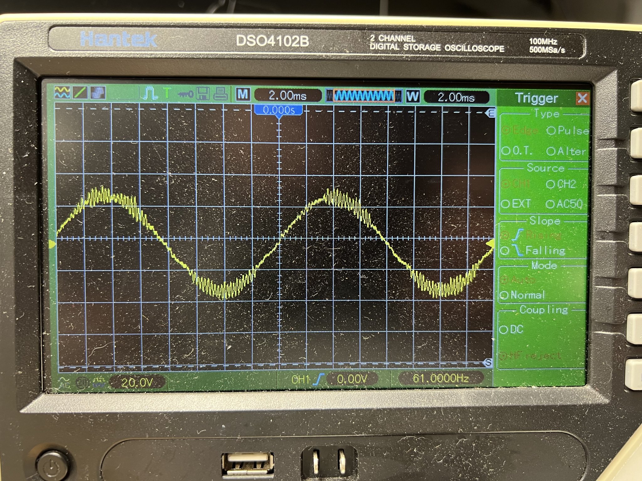

3rd - output audio gain turned up until distorted audio waveform.
